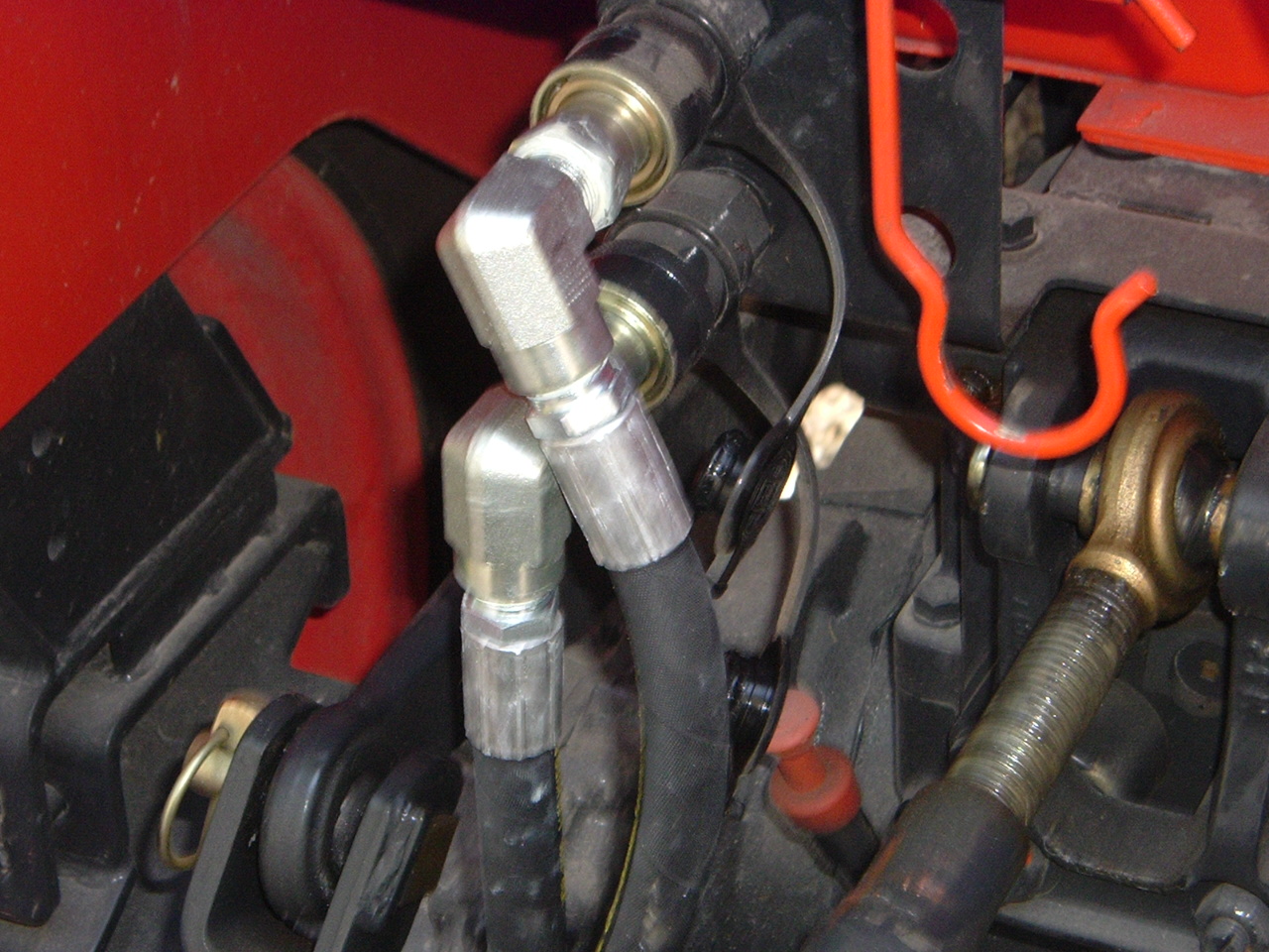

Also one reason I like my Rear remote valve setup for my grapple lid, I can feather it's closing speed. But the main reason I like the rear remote solution is because I am cheap! I have $150 bucks or there-abouts total in hoses and fittings and QD's. I made the torque tube mounting bracket myself out of old Kubota scrap metal. Of course I HAVE a rear remote valve. If you don't have one already on the tractor, then the other options start to look a lot better money wise.

No point at looking at the front of your tractor, you can look at the rear of your tractor and see if you have any Quick Couplers on the rear.. Now I will tell you that a Kubota L3400DT does not have any as standard equipment. However it can have some as an option. But if you don't have a control valve lever by your side and at least 2 quick couplers on the rear of your tractor then you don't have any.

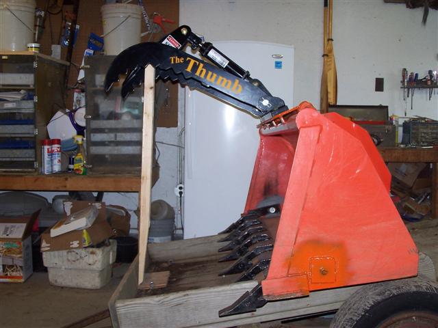

With several lengths of thumbs available, what would be a good length to get to fit my bucket, I measured 2' from the top down to the cutting edge, so that must mean I should get a 2' thumb, I thought so.
   / "The Thumb" Bucket Grapple questions #48
My bucket on my L4240 was the HD roundback version.I went with the 28"Thumb.I can't get to the bucket right now to measure it(3ft.of snow).
You want the Thumb to close on the bottom edge of the bucket.I had to add a piece of angle and roll it to be able to close completely.I also added a tooth-bar.This combo works very well.
I welded the nuts to the bottom of the angle so the Thumb can be removed easily.
I have 3ft.&1in. of snow on the ground, makes me the winner, I cant even go in the woods with my tractor and I have chains on. You must have your snowplow on instead of your bucket, I'm quite sure your bucket is a lot bigger then my L3400. Good idea adding nut so it can removed, that's how I have all my tractor add-on's.
