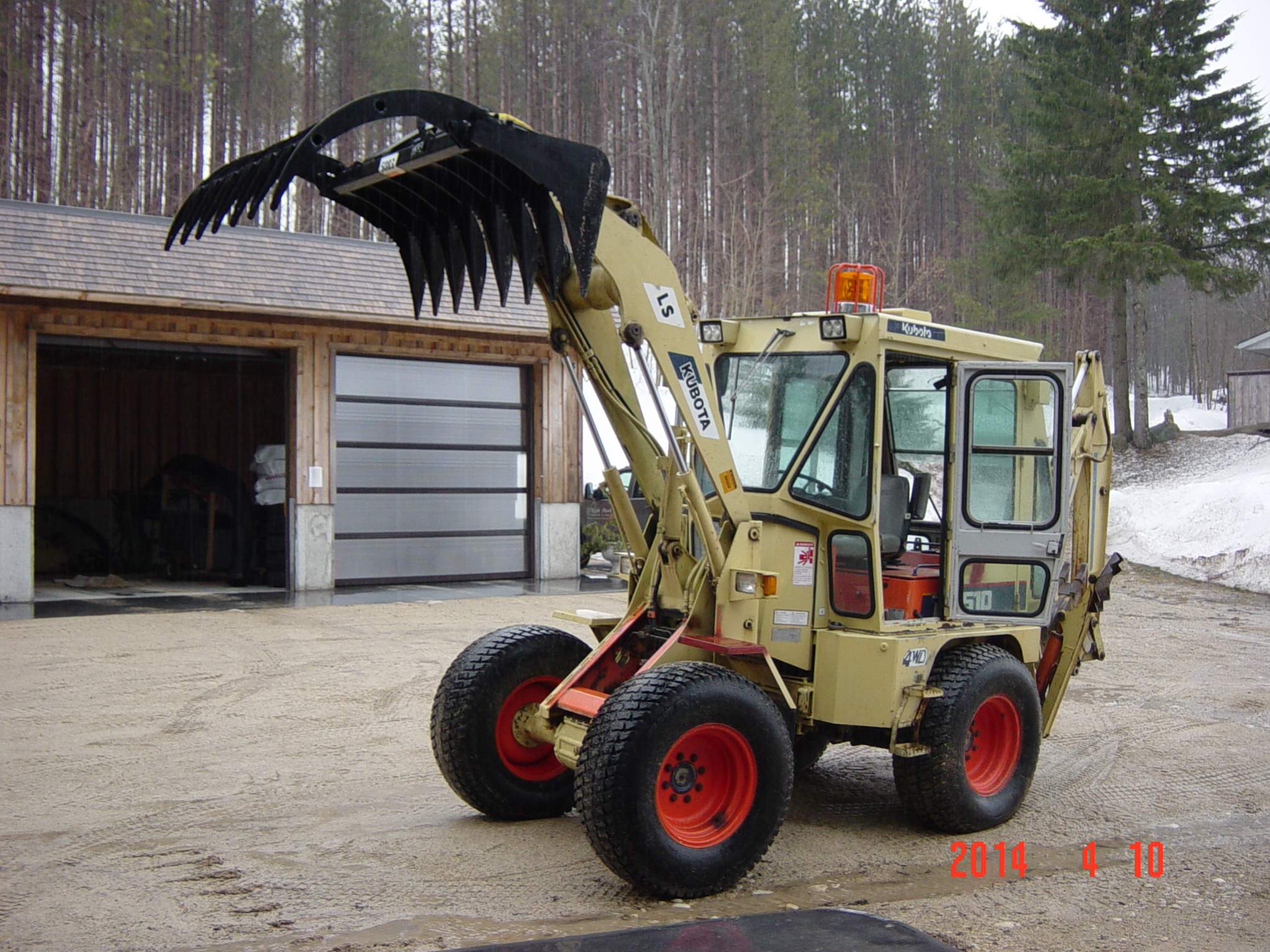

I wanted a grapple of this style for the longest time. I could not afford the one I wanted and I have friends (with lasers) that could have made me one, but with high strength A400, I still could not afford it.
Anyway, a friend spotted the above in a super shopper magazine. Some guy had bought it NEW at a Richie Brothers Auction in the States and brought it up to Canada. Paid $1200.00 Cash CDN (Thats about 65 cents american). I was not terribly impressed with the quality but I needed one ASAP. And you know what, against my impressions, I have not been able to break it! I have used it to handle logs, brush and stones, all up to the lifting capacity of the machine. I wish I had gotten one of these years ago!
The only thing I would prefer different, is to have dual grapples at the top, as a single one does not hold irregular shaped stuff very well.[/QUOTE
If I had one like yours, I'd want dual grapples to. I cant quite put my finger on it, but your Kubota looks different then my L3400, even the orange paint looks really really faded.
