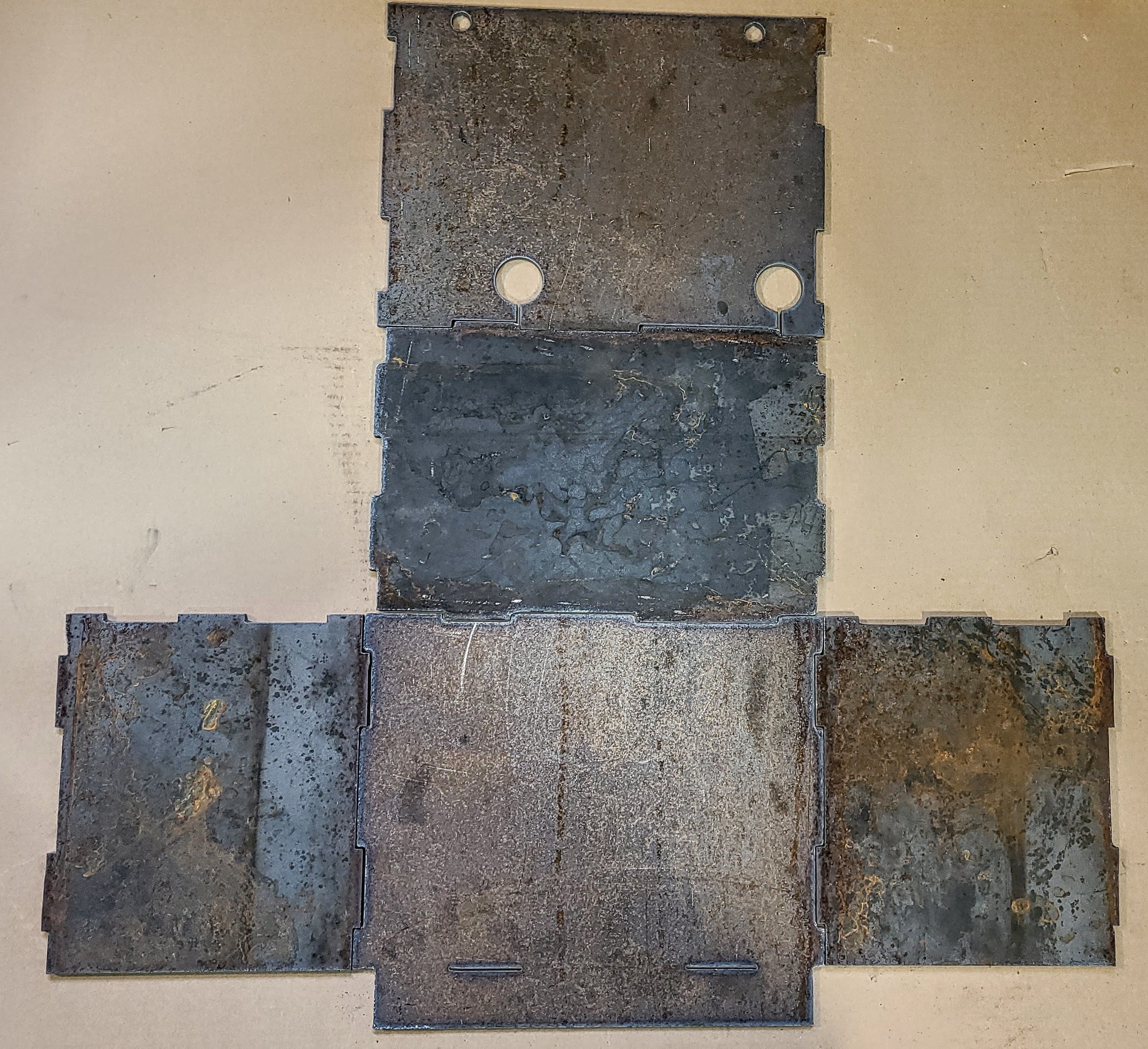

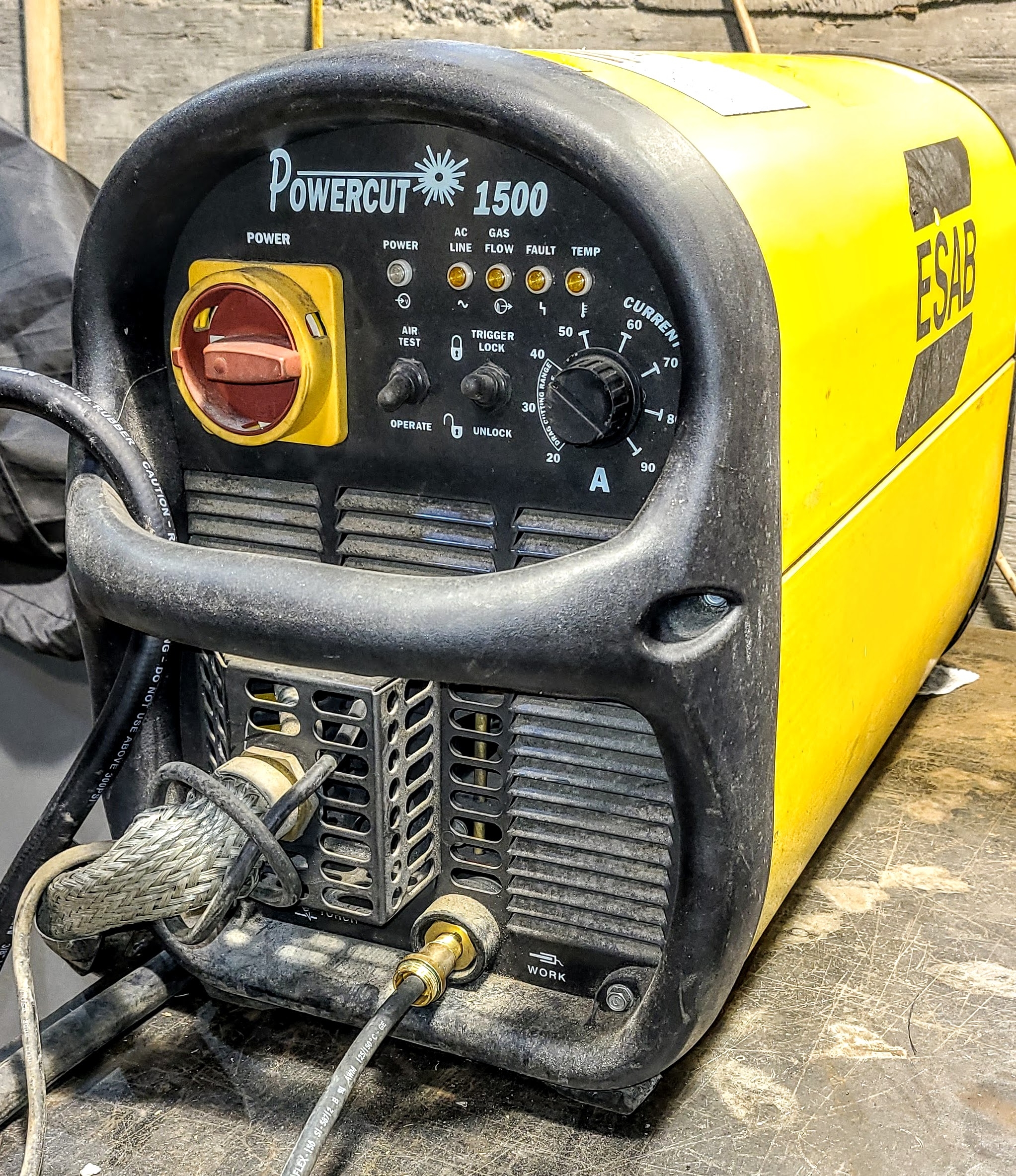

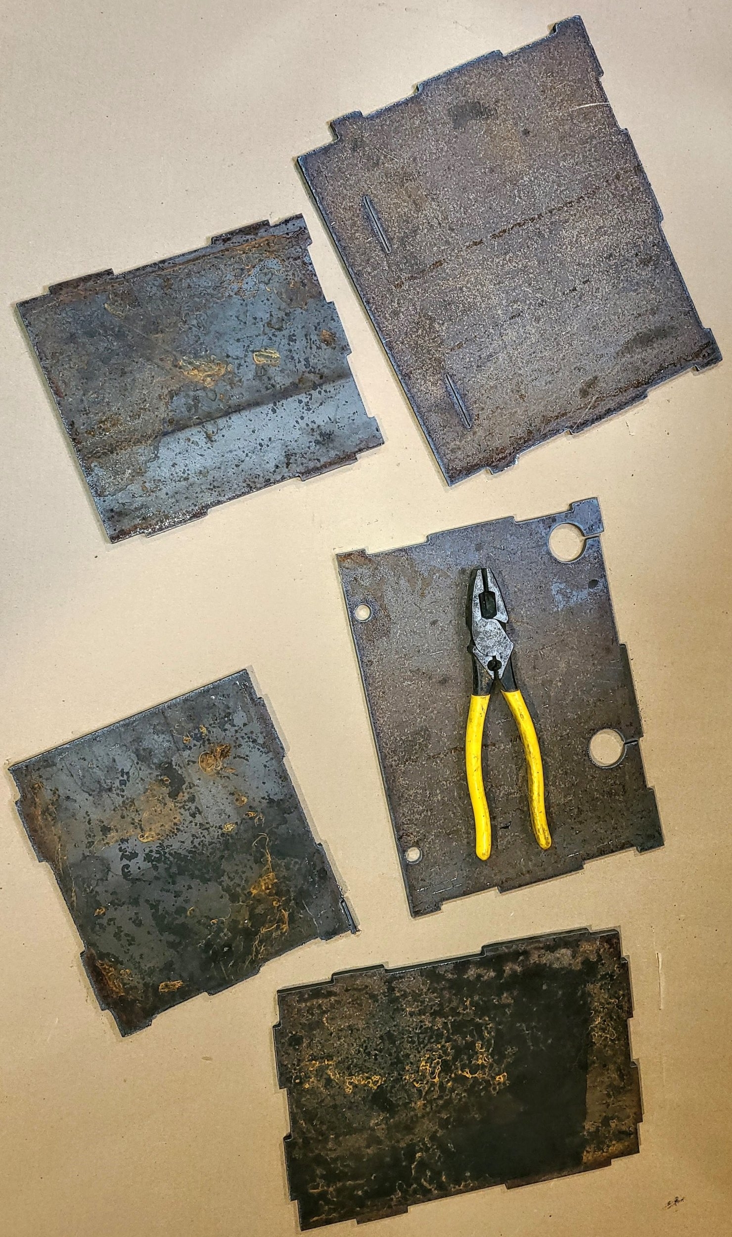

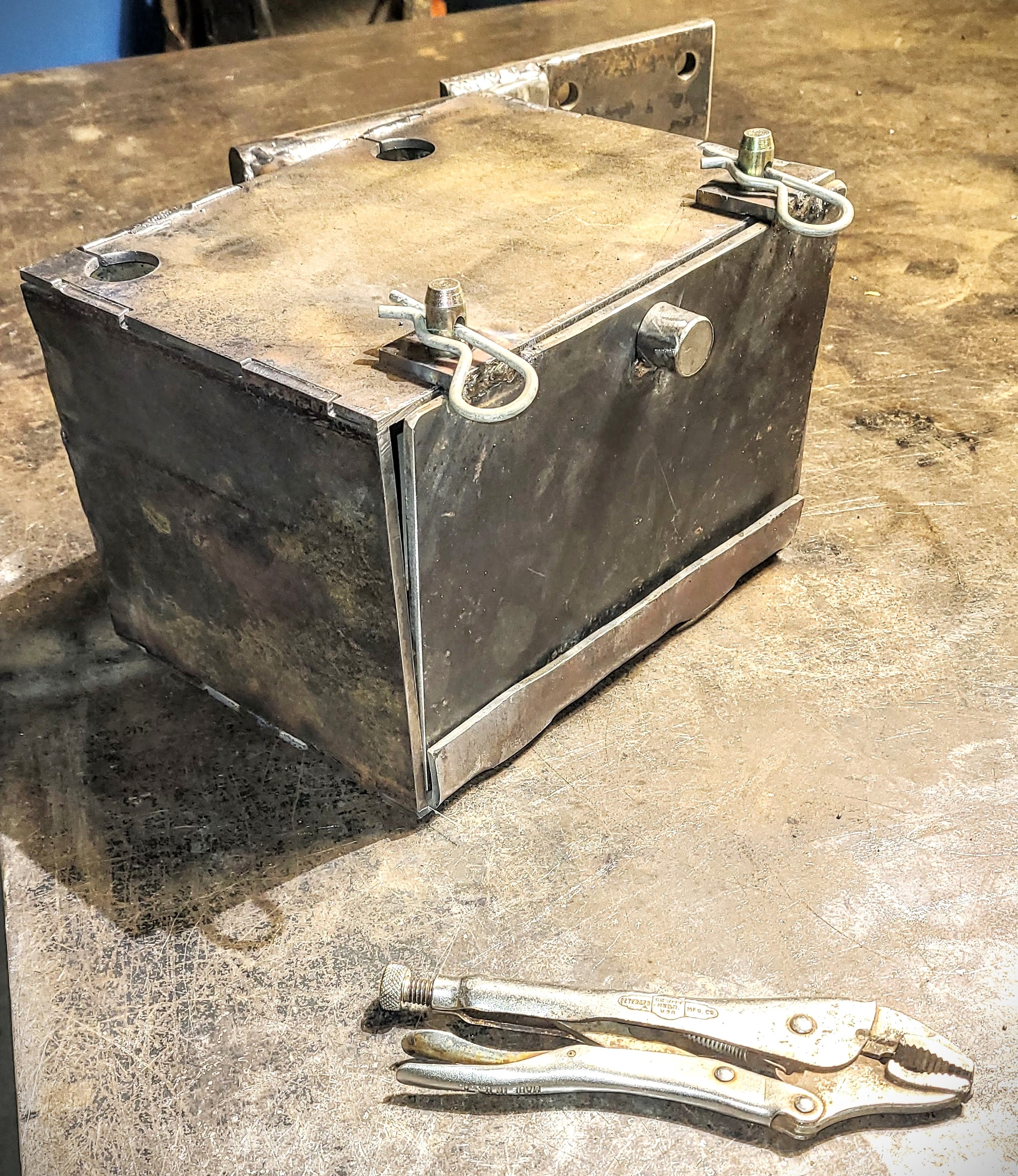

I have two 220 volt cutters,,
this one,,
and a Hypertherm 45XP,,
The ESAB is over 20 years old, I sorta retired it and use the 45XP,,
Both cut nice,,
