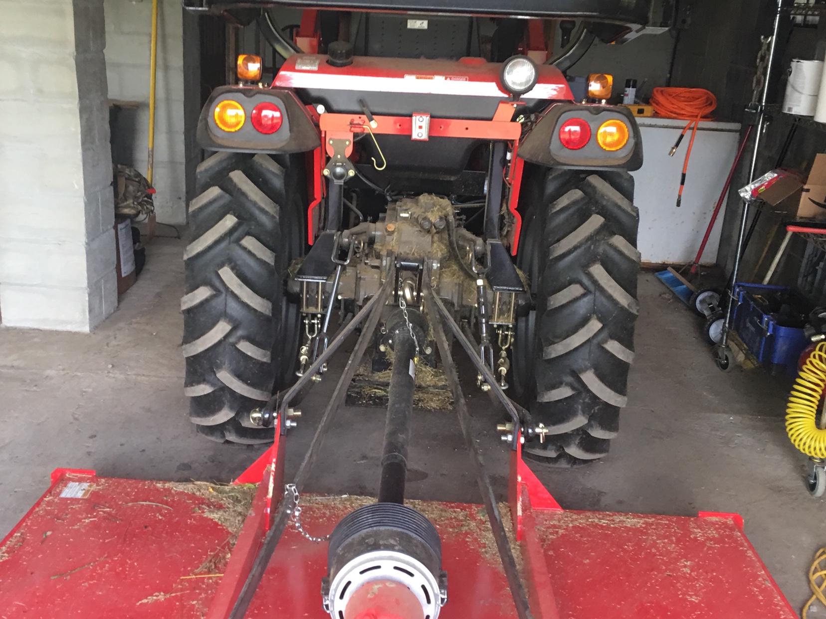

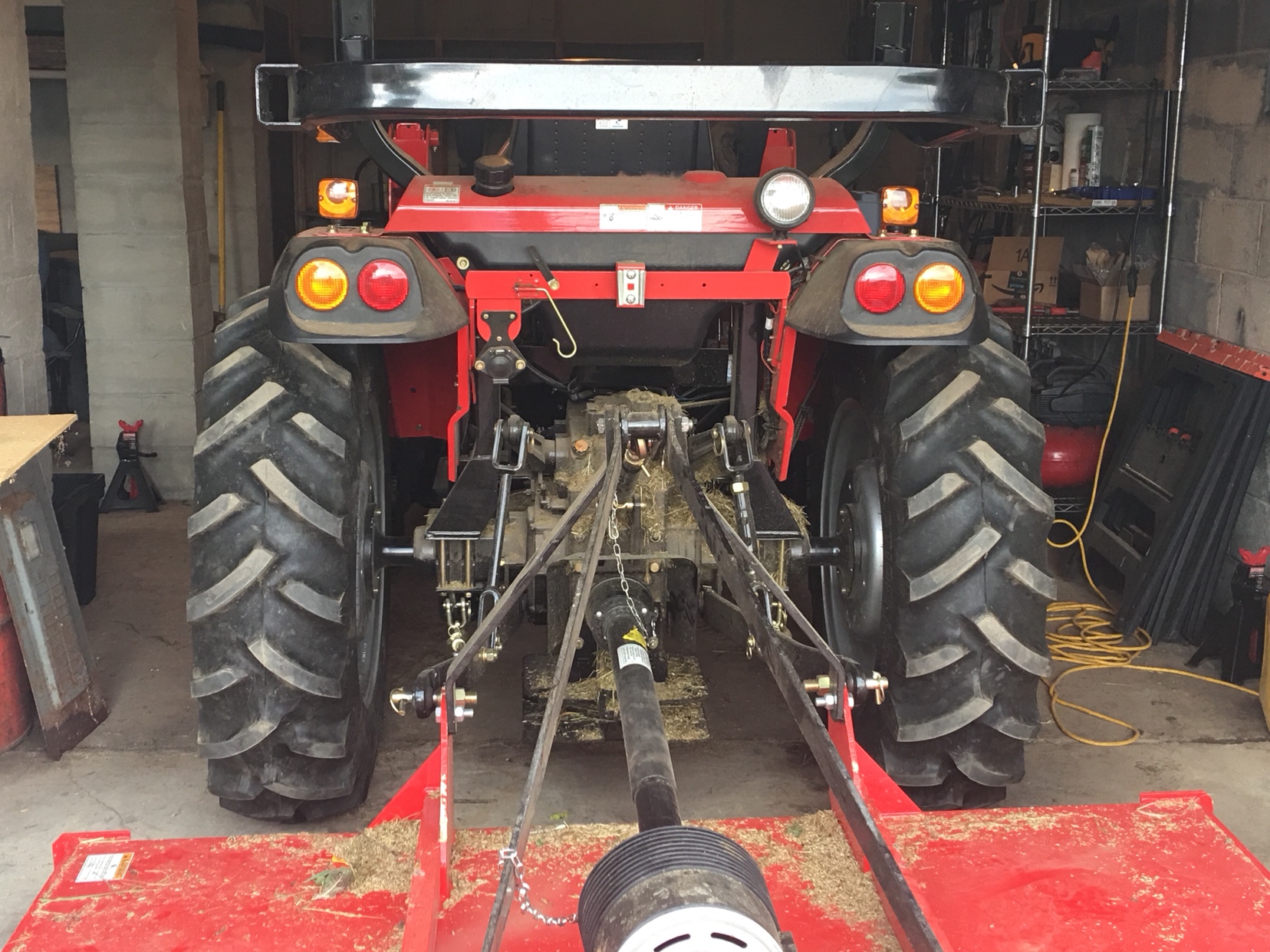

I’m in WV as well and have plenty of hills to deal with. I ordered my RK37 with AG tires but didn’t know you could also order it with the wider stance. After reading the manual I swapped the rims around myself and gained about 6 inches per side. It makes a big difference in stability.
Pictures can be seen here:
https://www.tractorbynet.com/forums/rk-tractors/398660-rk-37-wheel-spacing.html

Wow! Thanks! That does look much more stable. I'm guessing you like it much better too. Thanks for posting !

Thank you very much for your interest in RK Tractors. With respect to the RK37 trade at our Parkersburg WV location, it is a trade, not a return. The customer had the hydro and decided that the shuttle was a better match to his land, which is hilly, but the trade had nothing to do with his concern about the tractor being tippy. He traded it for the same tractor, just a different transmission, and you can apply more power when needed in hilly operations. If he was concerned about it being tippy, he would not have done that. As for the R1 Ag tires being wider, they have flip-center wheels, so they can be mounted conventionally or flipped to widen the stance. If you decide to purchase that RK37 that was traded in, we are happy to provide and mount the R1s for you. Hope this info is helpful, and again, thank you for your interest.
