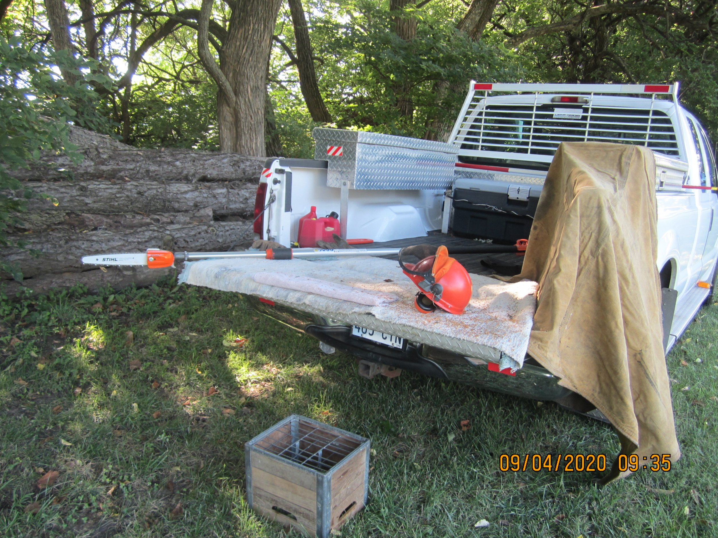

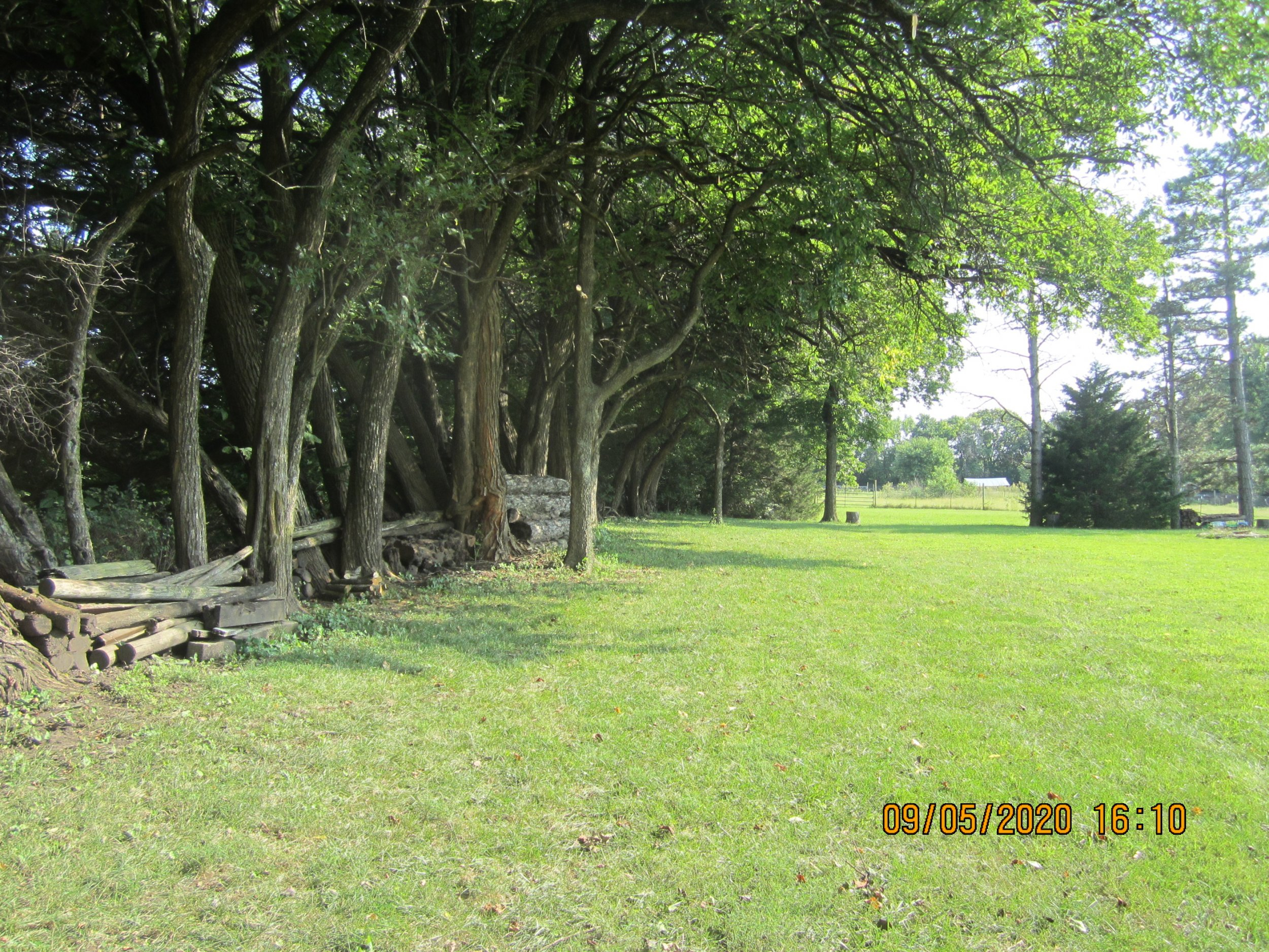

I have done the same thing when younger and dumber. I wouldn’t do now but still need trees cut. Know your limitations, trust your experience and get better equipment and expert help when in doubt.
We had a cat0 tornado come over us. Had some insurance and out of pocket expert tree cutters. I disposed of trees on site. Most of the remaining trees down in driveway and around would have been $40-50k if professionally done. 1.5 years later about 70% cleaned up. Some big trees were made leaning but took over a year to come down. Some still leaning.
Installing a soft ride system on the tractor helped carrying off debris.

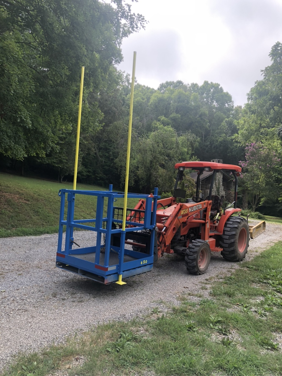

Made a pallet platform to hold tools and me safe. Long manual and battery power polesaws. Fall protection. Wanted sturdy rails to lean or brace on.
It’s still dangerous work but not worth dying over a tree or money.
We have orchards and berry patches to maintain too.

I have an metal ICB crate that I tied down to forks frame and use that very similar not as heavy duty but works just as well and I can lean over a bit without worrying to fall out
I actually got a ICB tank to consider. It’s not a bad option but would have required more work for some of the other jobs planned.
Carrying fence supplies, staging (660# helps), generator, tools, and slight bigger.
Also wanted to try safety legs. One will support the platform with me jumping up and down with no hydraulic pressure. Two gives higher safety margin. The only steel not bought as scrap were the safety legs. Do I always use them, no. 12’ is a little hard to get in and out of the tractor shed and way too tall where it is stored. M59 tractor like a lot of backhoes have loader hydraulic cylinder brace when raised also.
Using the backhoe outriggers helps to level or lean over some which is helpful for the platform position.
Still high hazard work. “When you run out of brains it’s always good to try to borrow some. Woodrow Wilson”

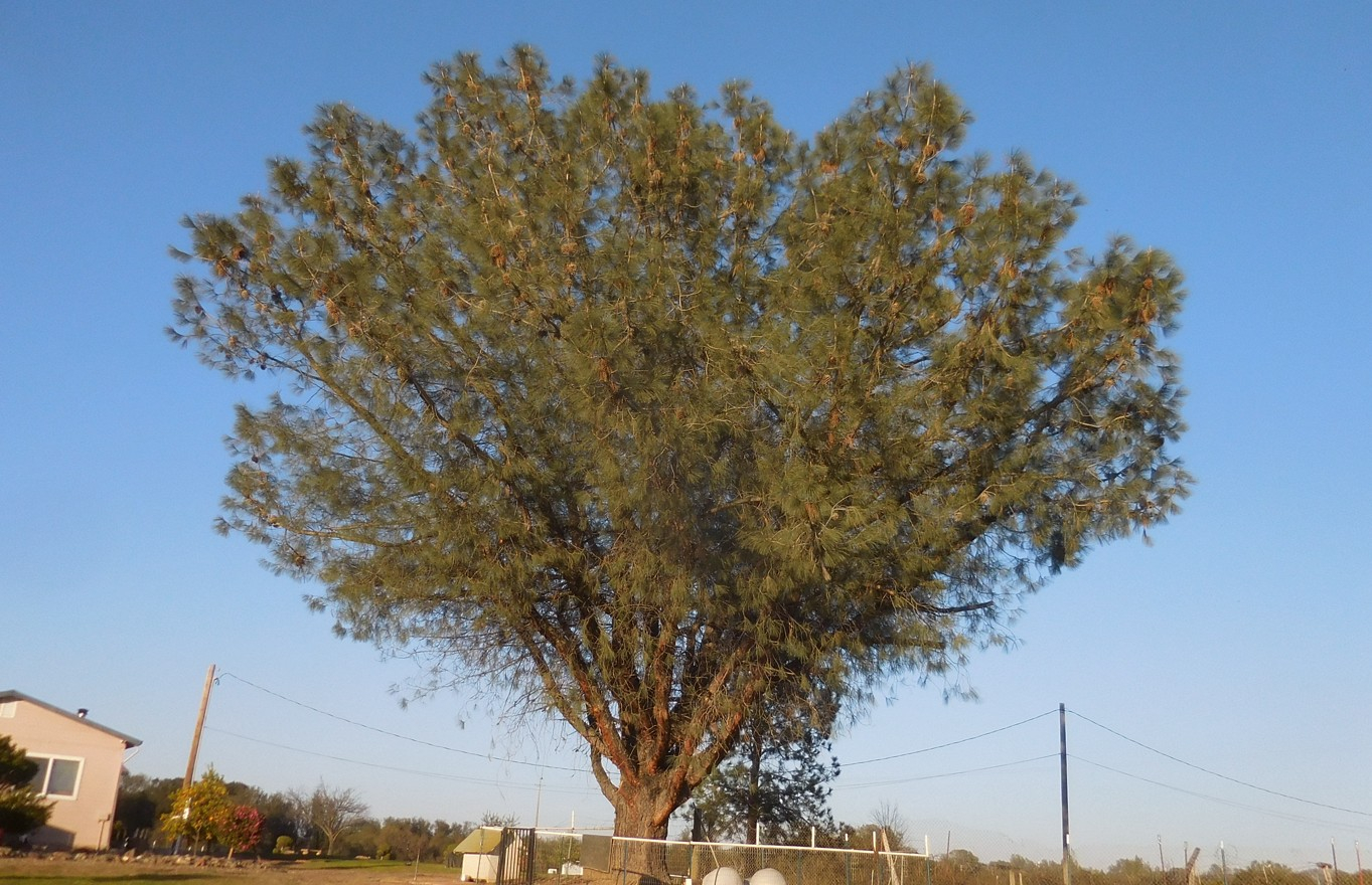

I have a digger pine tree next to my house that is more than 100 years old.
It needs to trim the agley branches which look so ugly.
It is quite high, about 30ft or more.
So, I had to utilize my Ryobi pole saw, a Husqvarna 450 chainsaw and John Deere 410 backhoe.
It was very dangerous to cut the branches and would be the last cutting for that tree in my life.
