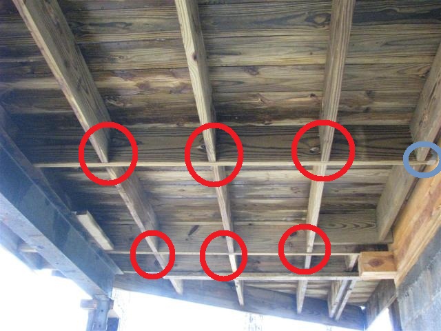

Yes, as I stated in post #727 I chose to use hangers directly attached to the logs...no header. This side of the house has a 4' overhang but will get exposed to weather, and a header would trap moisture against the logs, something I did not want. The first cross joist is 4" off the house and all joists are 2x10, deck boards 2x8.
Arrows show joist hangers and circled is where the joist is directly screwed to the end overhang logs:
I see the joist hanger on your ledger board and circled it in blue on the picture. What I dont understand is why you didn't use them where I put the red circles. Are you relying on nails or screws into the end grain to hold them in place over the years?

Eddie, I have never used hangers in the middle of a deck and never had one fail in 30 years(that I know of :)). That being said I have also not built one 12' off the ground...about 4' is the highest one. I know it's not a bad idea but have you seen an issue when nailed with 4 - 4" galv nails on each end?

I'm not Eddie, but I would definitely add joist hangers to the areas that Eddie mentions. At least for piece of mind with the deck 12' off the ground.
Eddie
I addition the the hangers Eddie was referencing... it looks like there would be a lot of weight bearing on the (1) treated 2x12???. I am sure it will hold up but there may be some sag over the years and I would think some bounce in the deck. I would have recommended doubling up the 2x12... but that is just how I would have done it. I probably would have ran joists from the house to the beam every 16" but then the deck would have to go the other way.

Its not the way I would have framed the deck either, however unless you are going to drive your Kioti on it, it is not going to fall down. You would probably be ok without joist hangers, but the way I look at it is you probably have more in nail and screws already invested than the joist hangers would cost. For $20 in hangers, it would be an improvement.
Im more interested in the way the ledger is flashed to the wall of the building. This is an often overlooked or improperly done detail and that is usually without the complication of doing on logs. It can cause a lot of damage on a stick framed building. It could cause a lot of very difficult to repair damage on a log building. Can you share with us?

Darin, I ran them that way because I ran the North(creekside) deck the "correct way" and I wanted the deck to match as it came around and turned the 90 degree corner(all deck boards run West). Which 2x12 are you asking about? the angle from North deck to West or the 2x12's that are the final joists on the West side out over the 32' Ibeam?
Box, again ther is no ledger(I called it a header board) on the logs...just joist hangers(5).The first actual nailer joist is 4" off the side of the house...does that make sense? I did this specifically to avoid moisture damage cause between a "ledger" and the logs.
I will pick up some more 2x10 hangers & nails, I don't mind overdoing it every now and then;)...no problemo.
