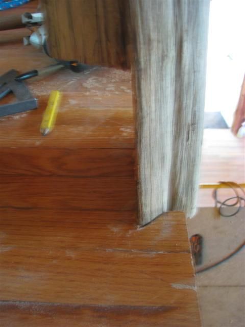

Ok, so the County inspector is stopping by tomorrow hopefully to sign me off on final which gives us our C/O which means we can apply for re-finance. So today I worked on the loft railings.

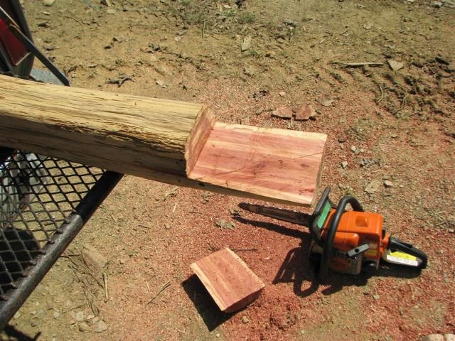

Cutting out the post notches:

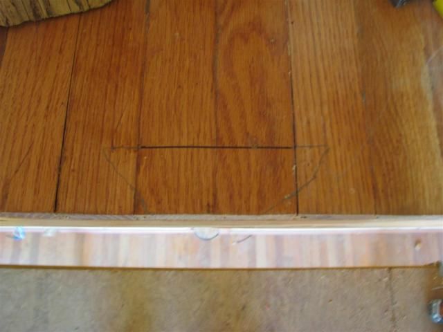

Scribing that dovetail type notch on the floor at the edge:

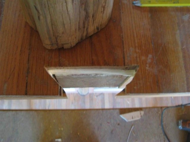

I cut the notch with a jig saw:
   / The Log house Project begins........
#1,549

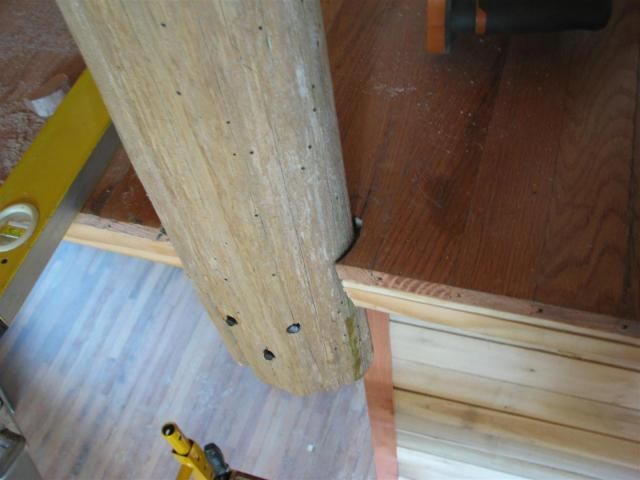

Post installed:

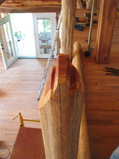

Then I notched the top of the post to receive the top rail:

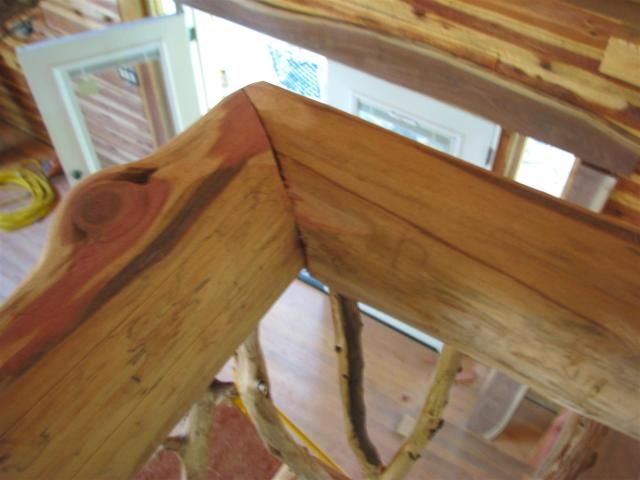

Then installed(I 45'd the corners):

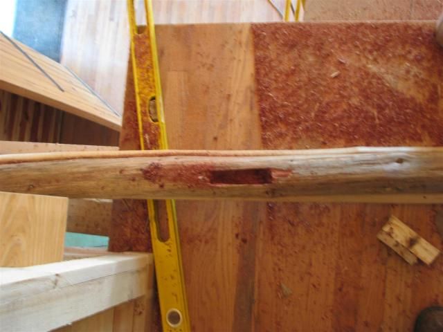

I wanted to cover the edge of the loft deck/floor, so I set the bottom rail right on the floor and cut a "L" notch it's entire length:
