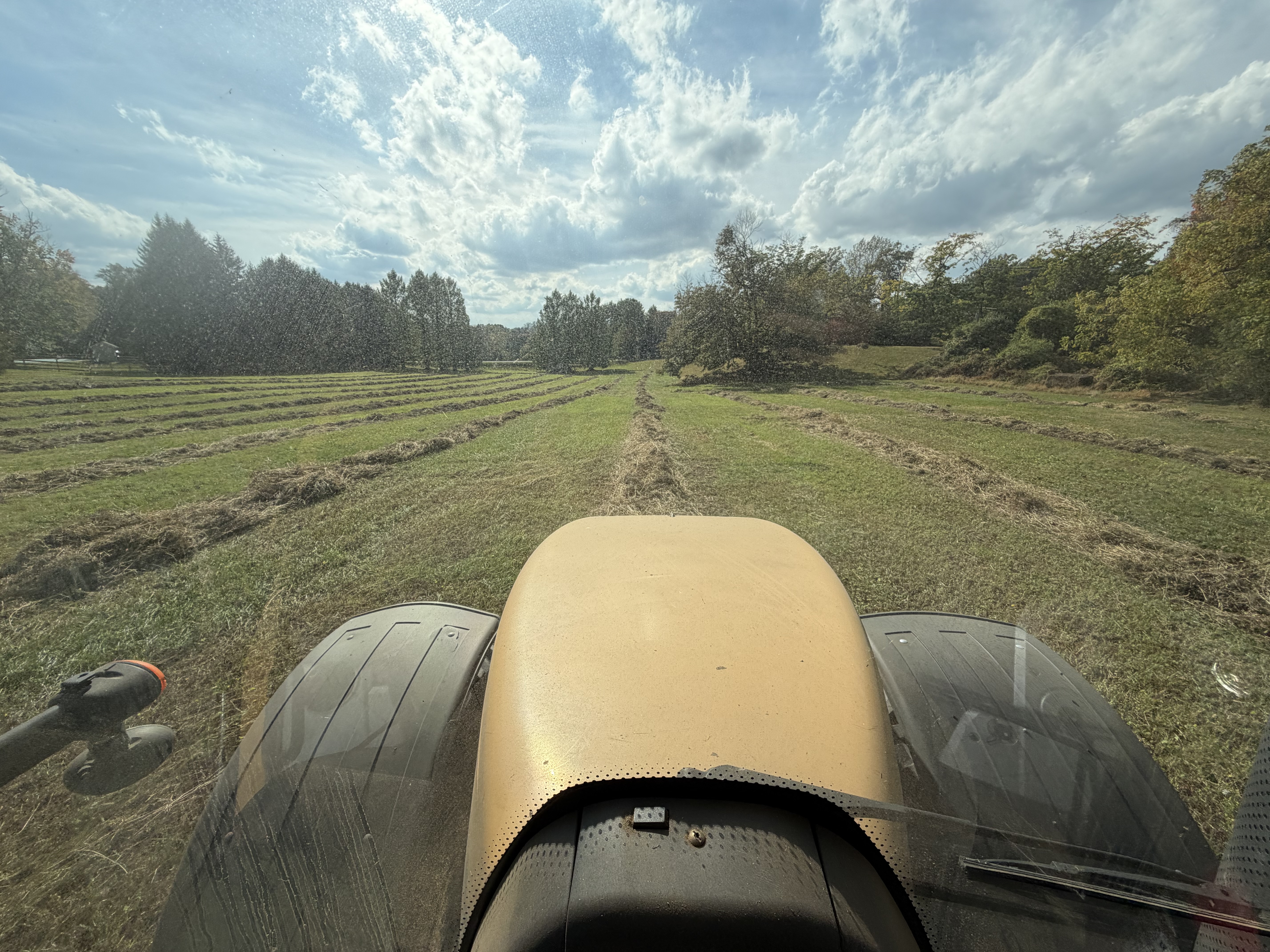

Finished the last 2 pea patches. I listened to the Eagles game here and there and tried to enjoy it, rather than be grumpy about the repairs.
Sorry for the weird lookin photo. I got a I phone 17 to replace my sorry-azz 5 year old crushed & mangled phone and my new phone makes photos look elongated or not show up at all.
After I took the baling tractor back to the shop for the last time, I already knew I would miss hay & baling. Would love to make another 100 bales, but sure would be nice if everything worked without breaking.
Tinker around with the camera settings. You should be able to default to a size and quality that works for you. And hopefully turn off exif data.

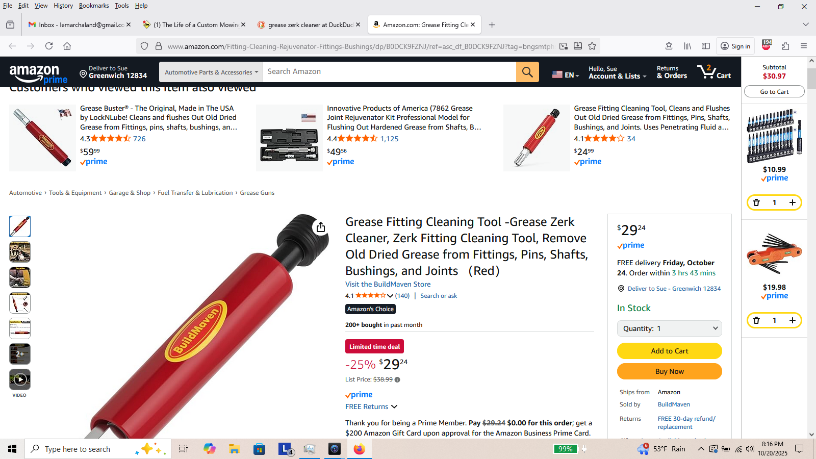

One of these by any chance;
I have never used grease in one always a light oil or diesel to try and clean a zerk out. With success maybe 30% of the time.
