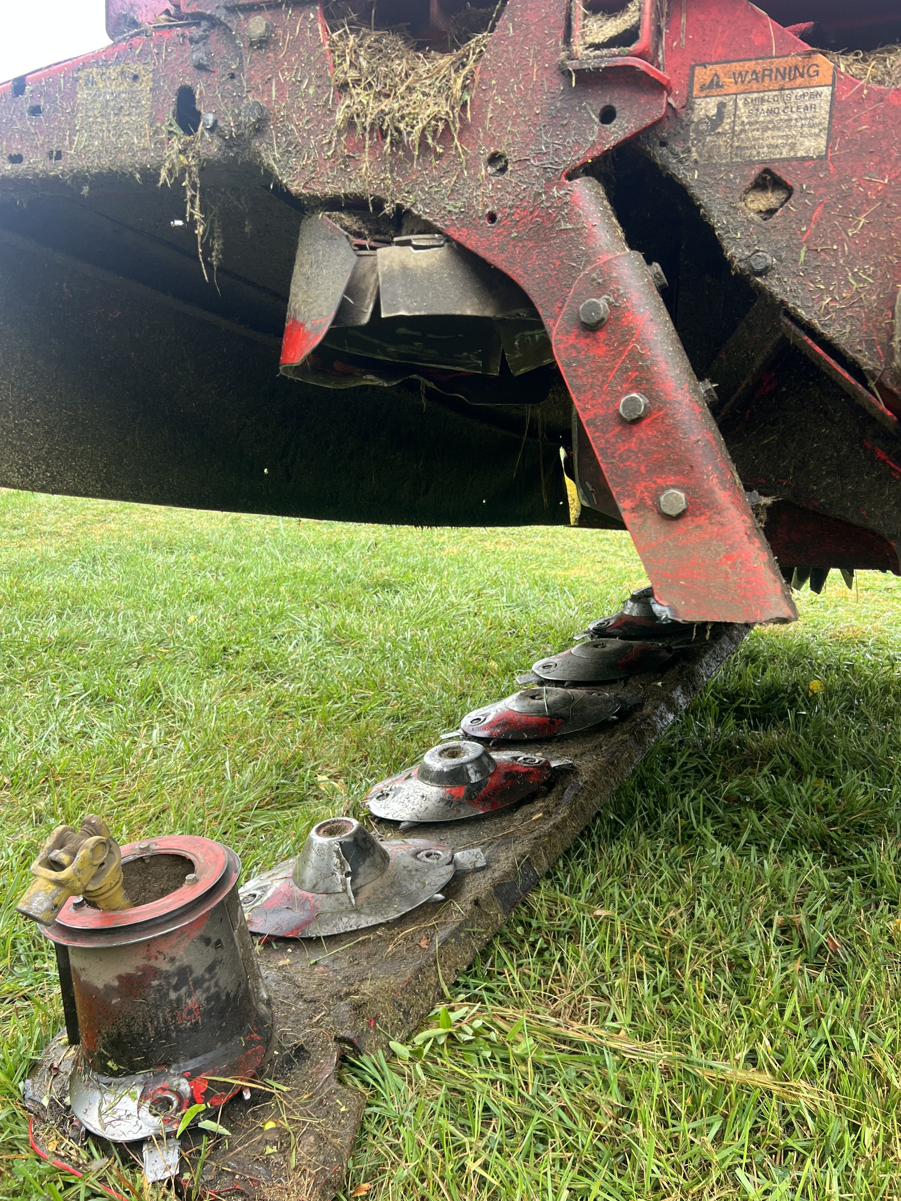

Today was one of those days that’ll make a man out of you.
Was cutting hay in some drizzle, then this happened.
The vertical strut connecting the cutterbar to the mower chassis experienced “metal fatigue” and simply broke off.
Called Agriteer/Pottinger parts and they said thats a known problem area and there’s a replacement kit- “only” $631 per side for updated, beefed-up supports. Pottinger offering them to me for 50% off since they have had numerous failures. Service advises replacing both sides, especially since mine are the older/weaker version. Luckily the cutterbar is still ok and the driveshaft, although a little beat-up is probably going to be fine.
THEY have to install it to receive discount :rolleyes: of course. And at “only $150/hr. I guess I can’t complain too much.

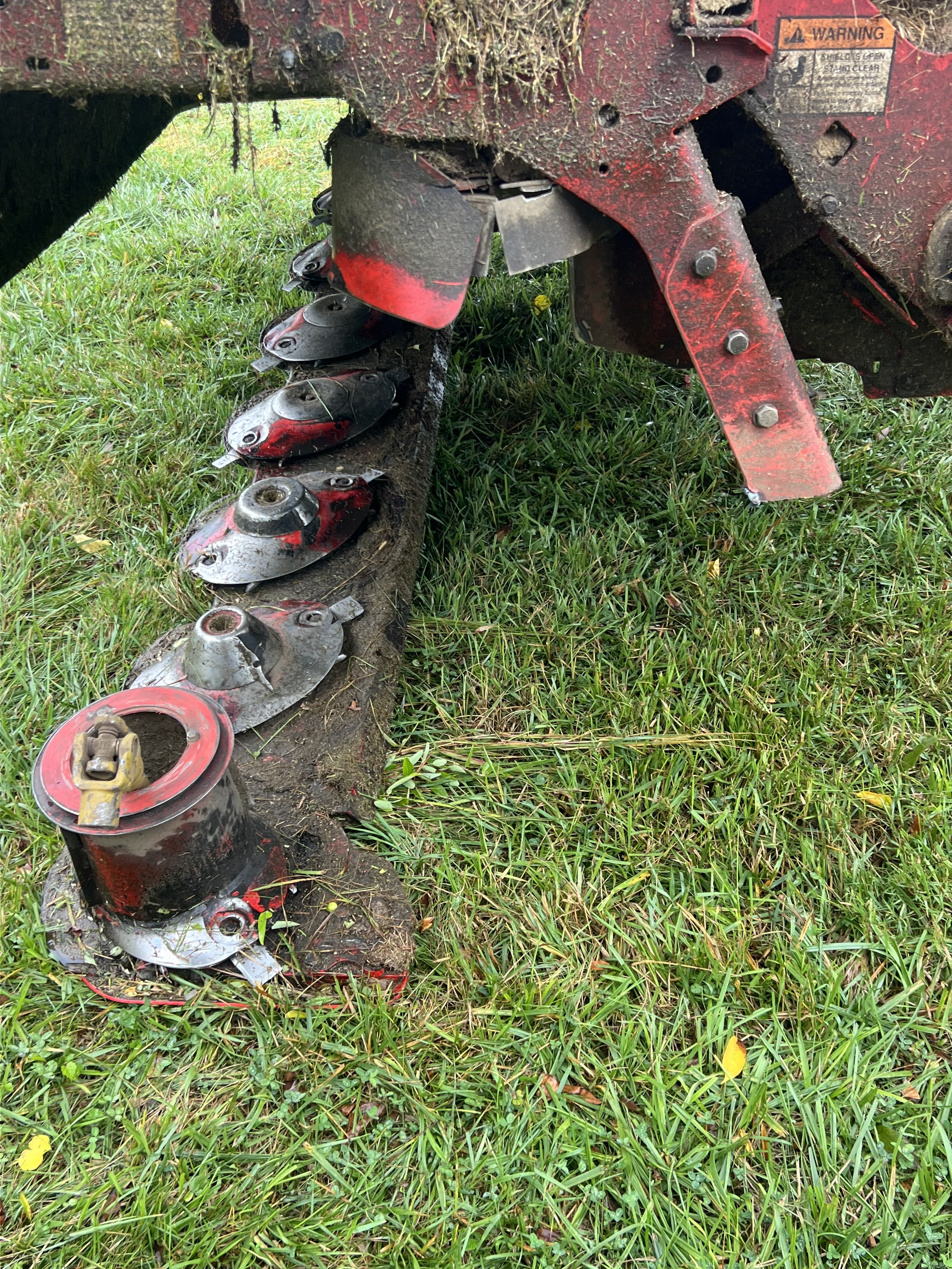

Another view

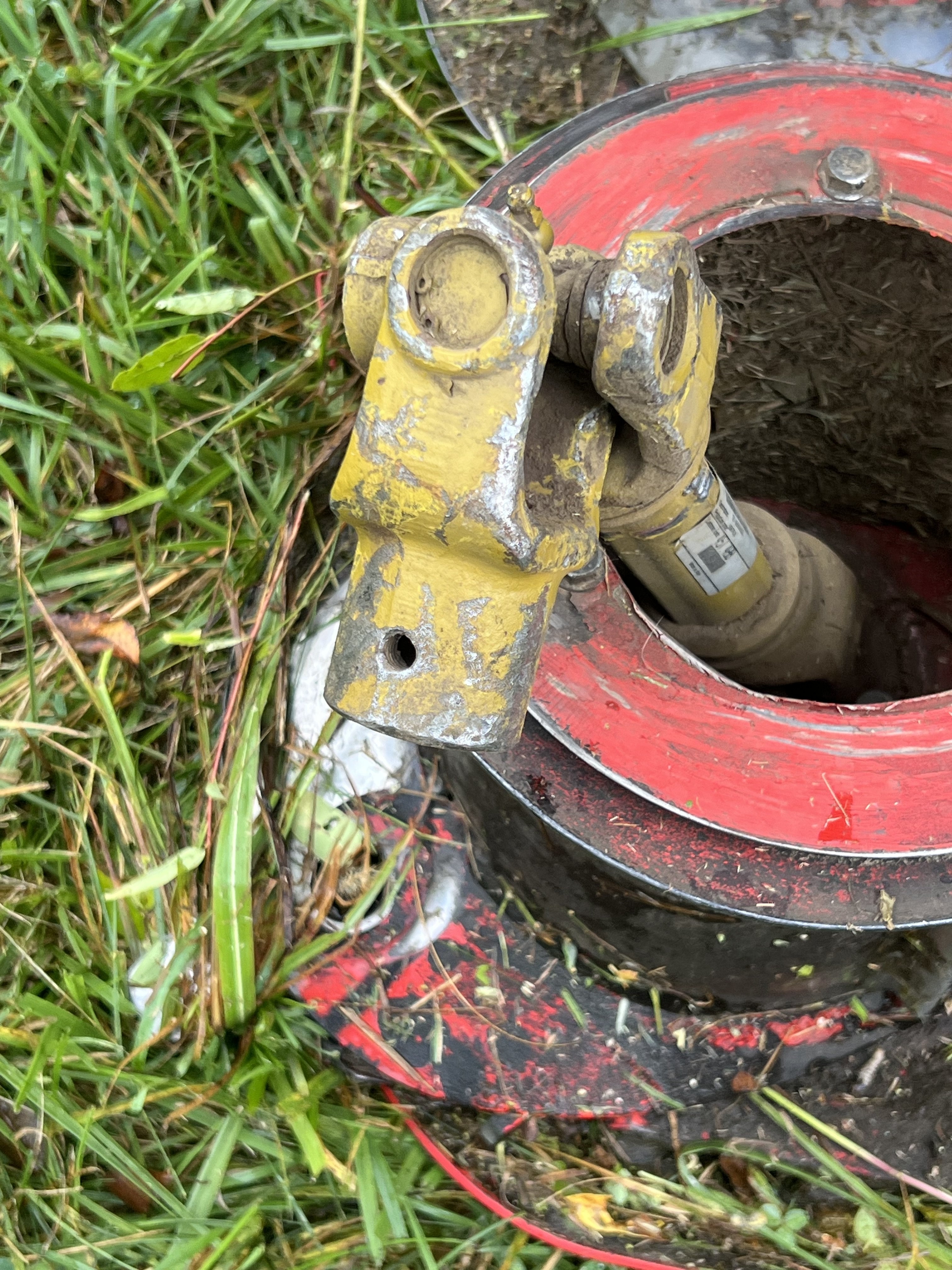

Closeup of where the metal fatigue is
Prop shaft seems ok
Good luck with the repair/upgrade hope they get it done promptly and reasonably.

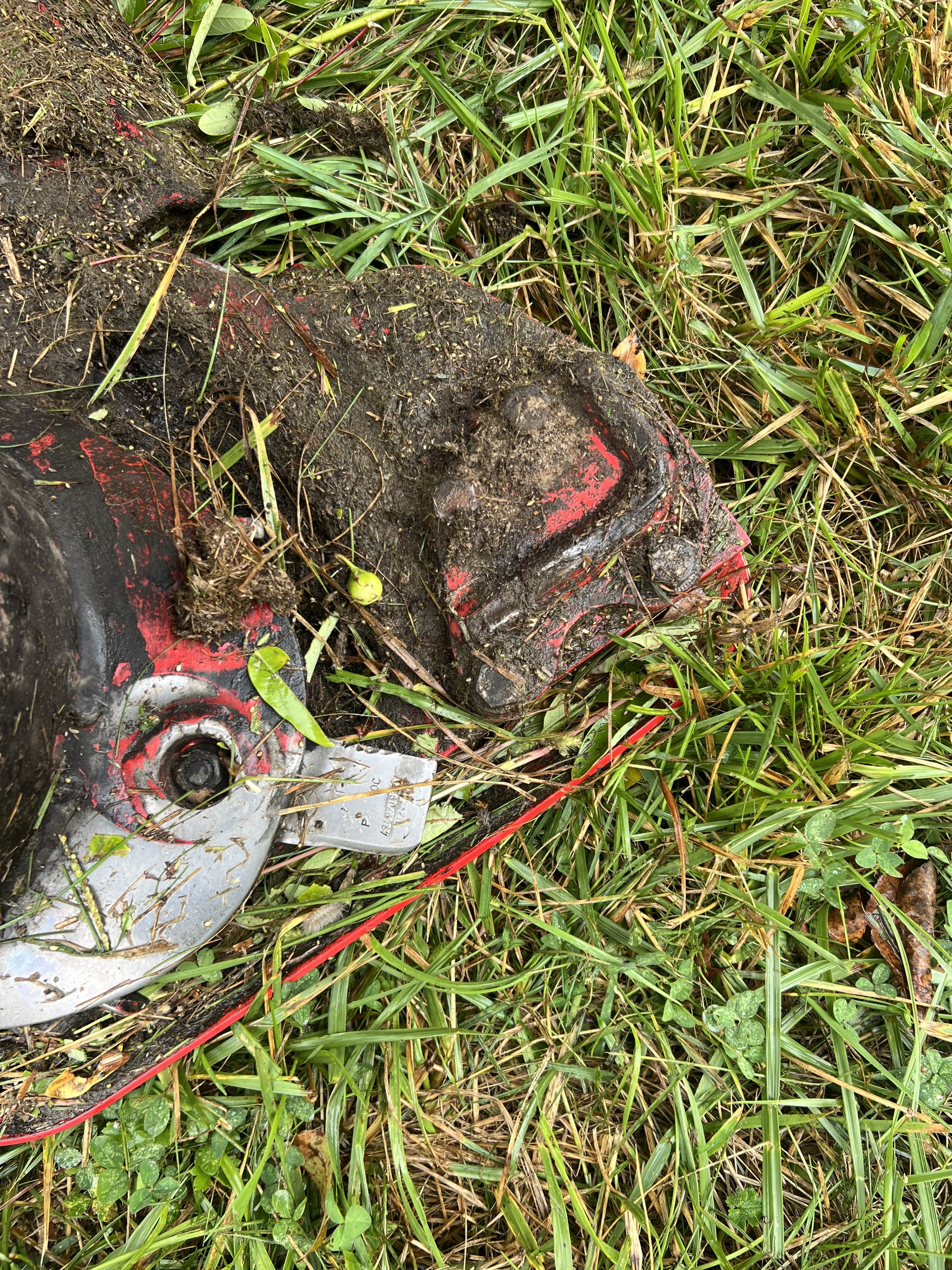

So it turns out the vertical prop shaft is toast. Splines are all carved up. Have to buy the whole assembly.
Bad day for HD.

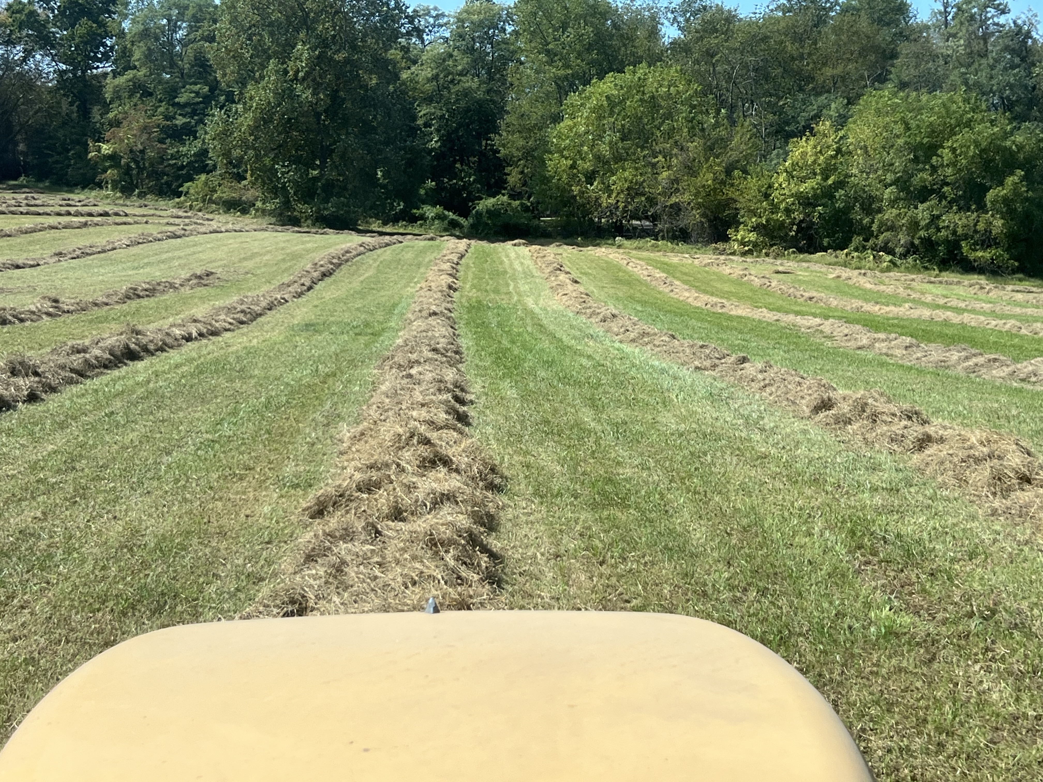

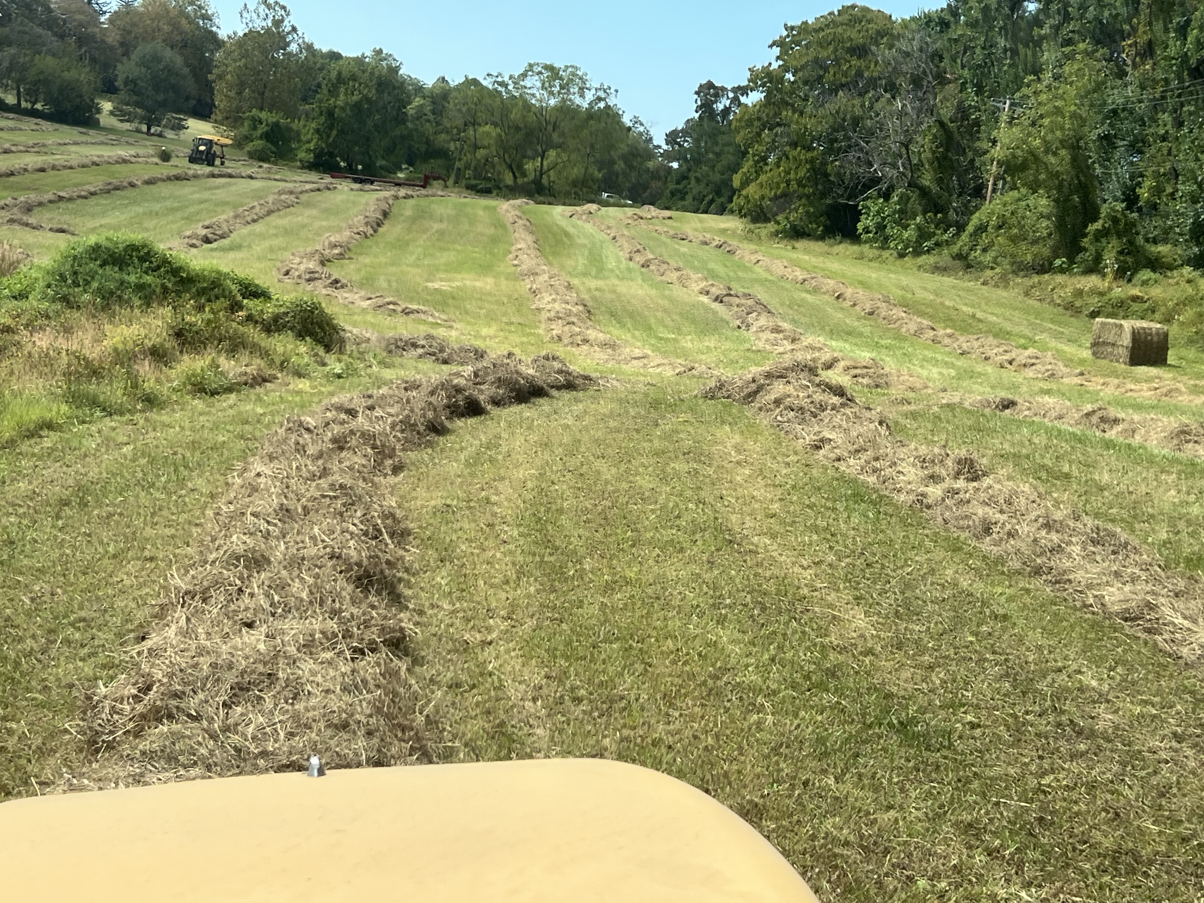

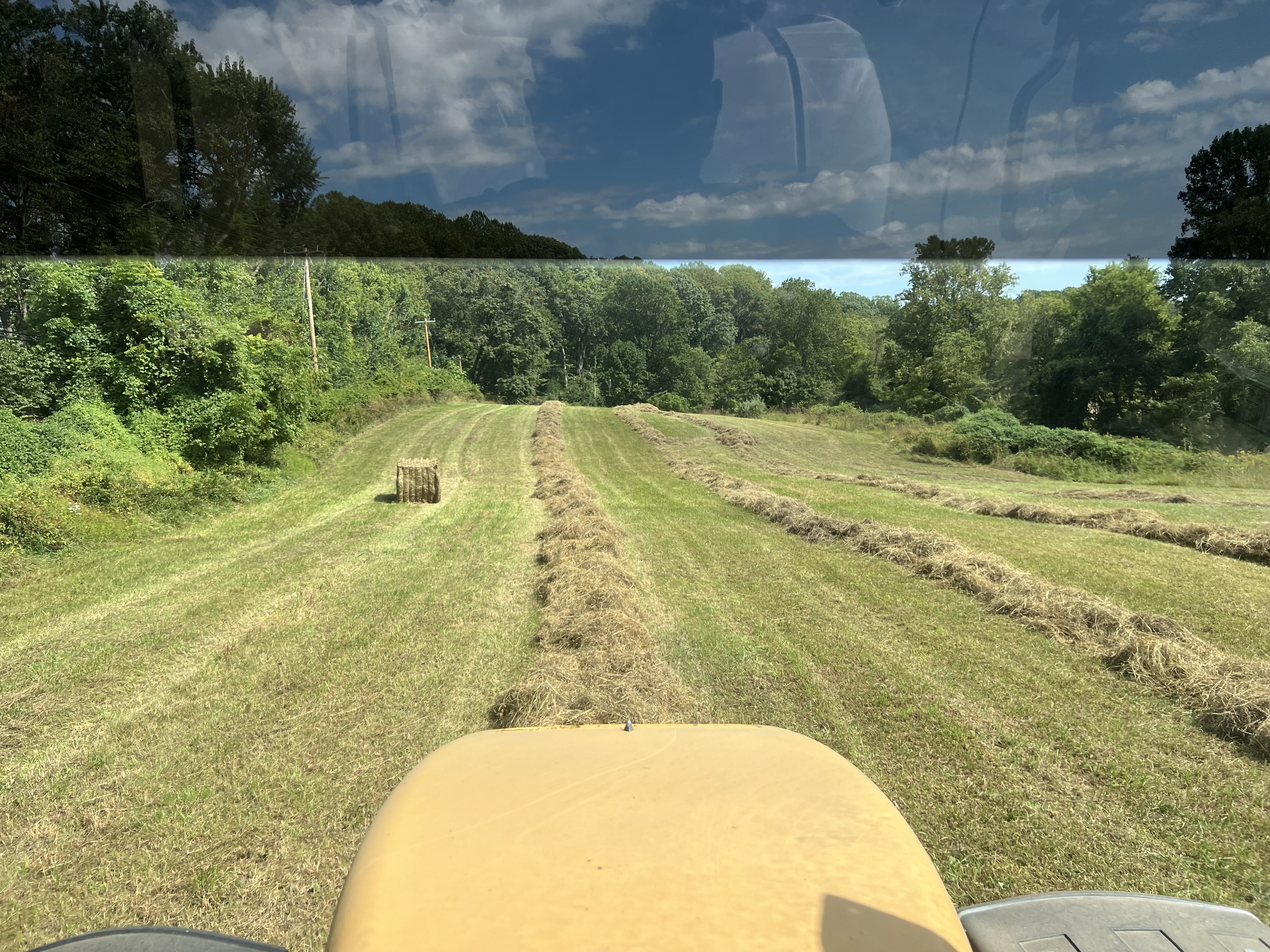

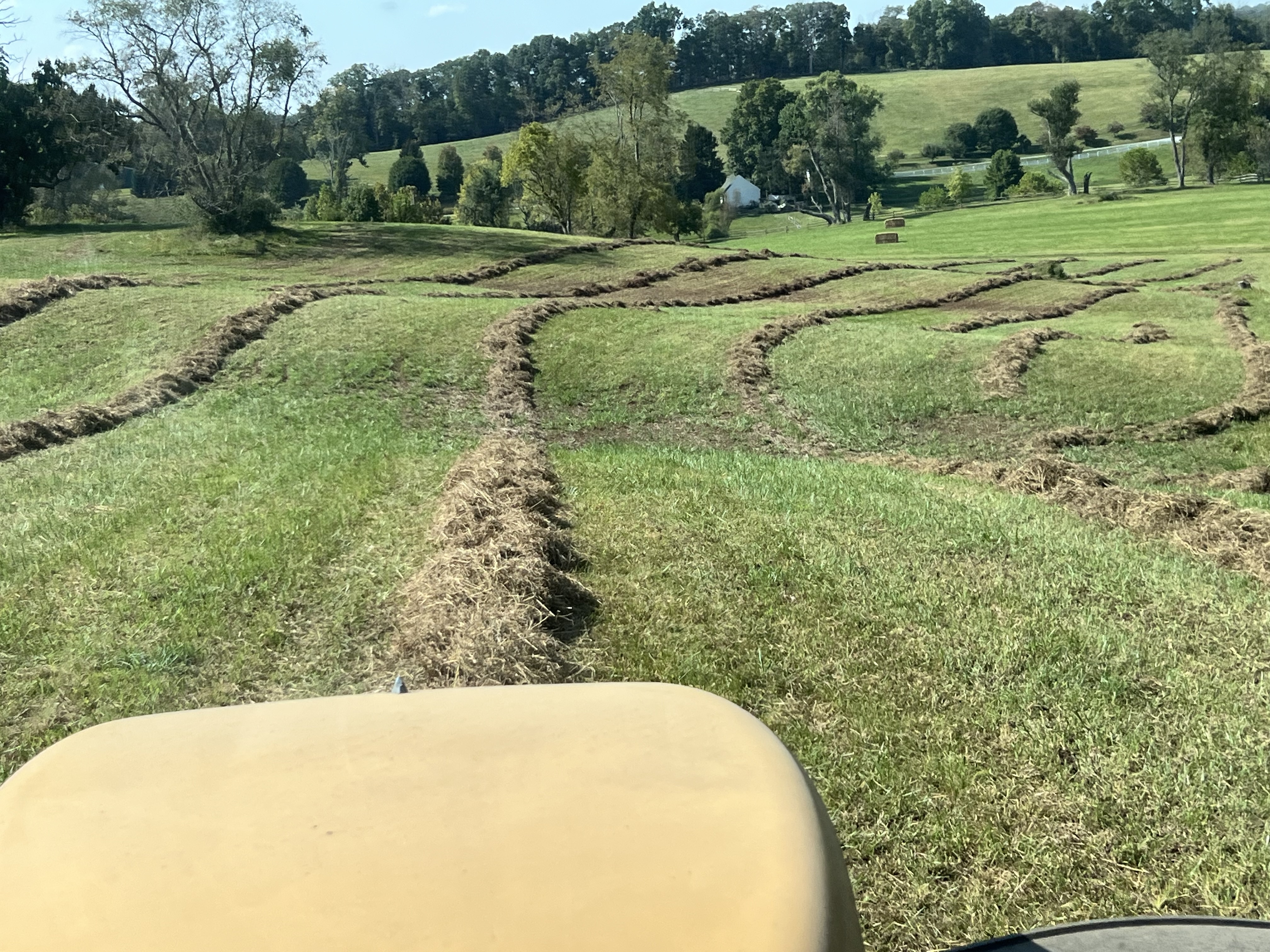

Back at it today now that the rain has passed.
A little raking around 12 o'clock while East Penn pulls a load nearby.

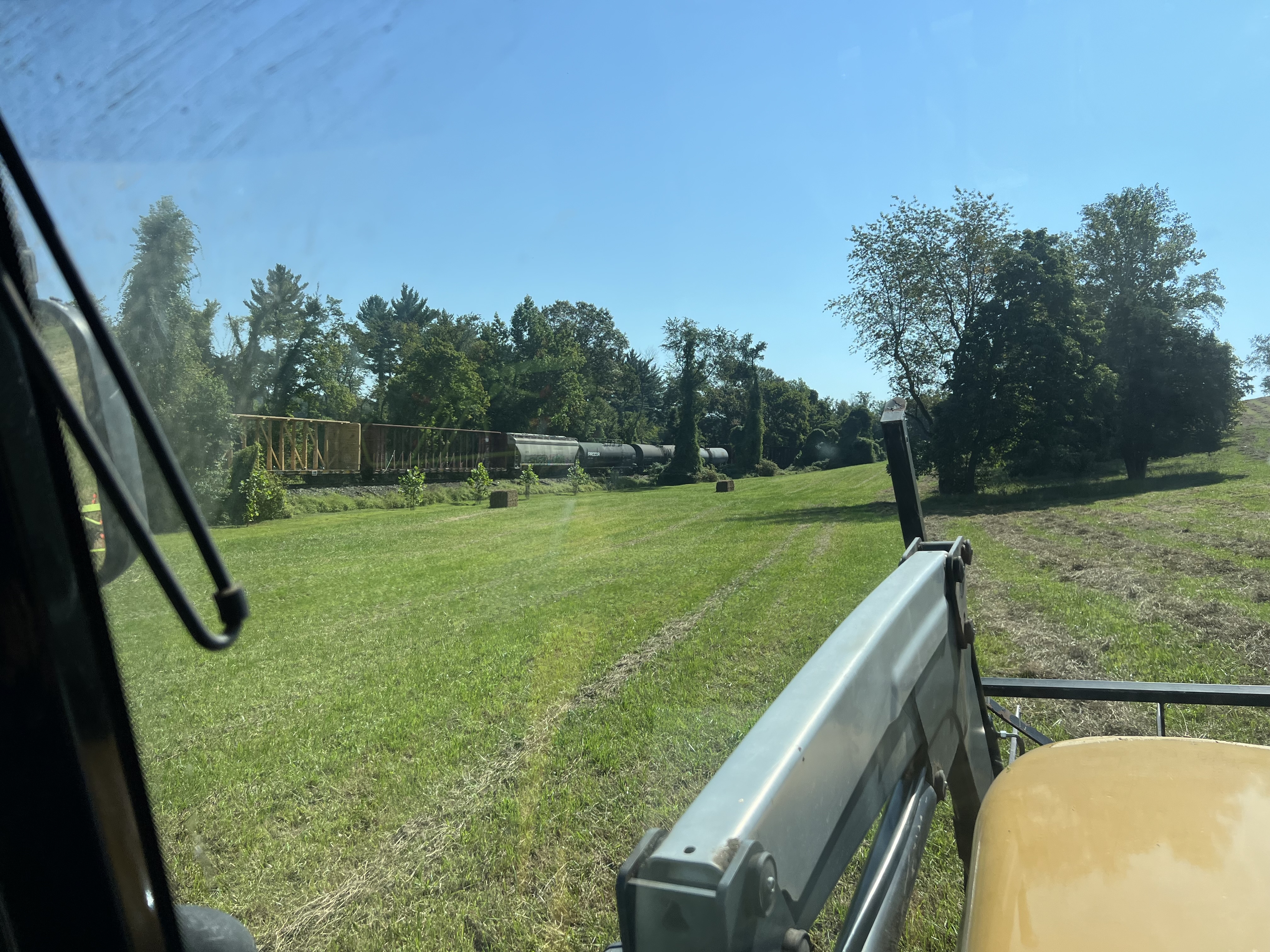

And now some baling….

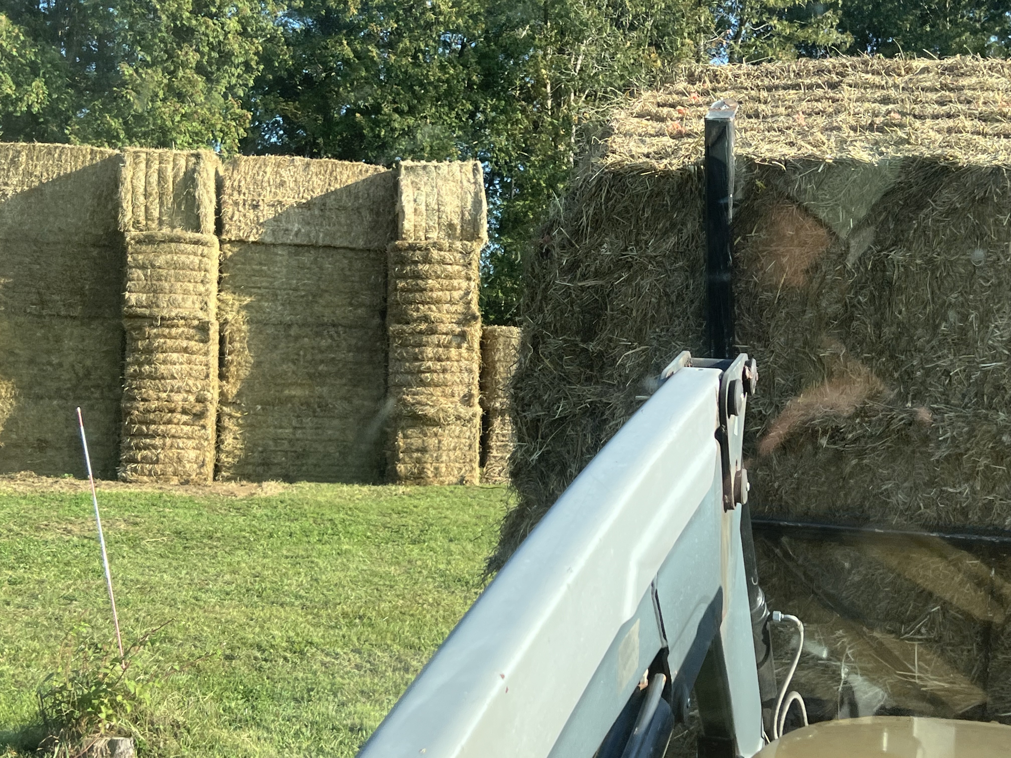

And some stacking to finish the day.

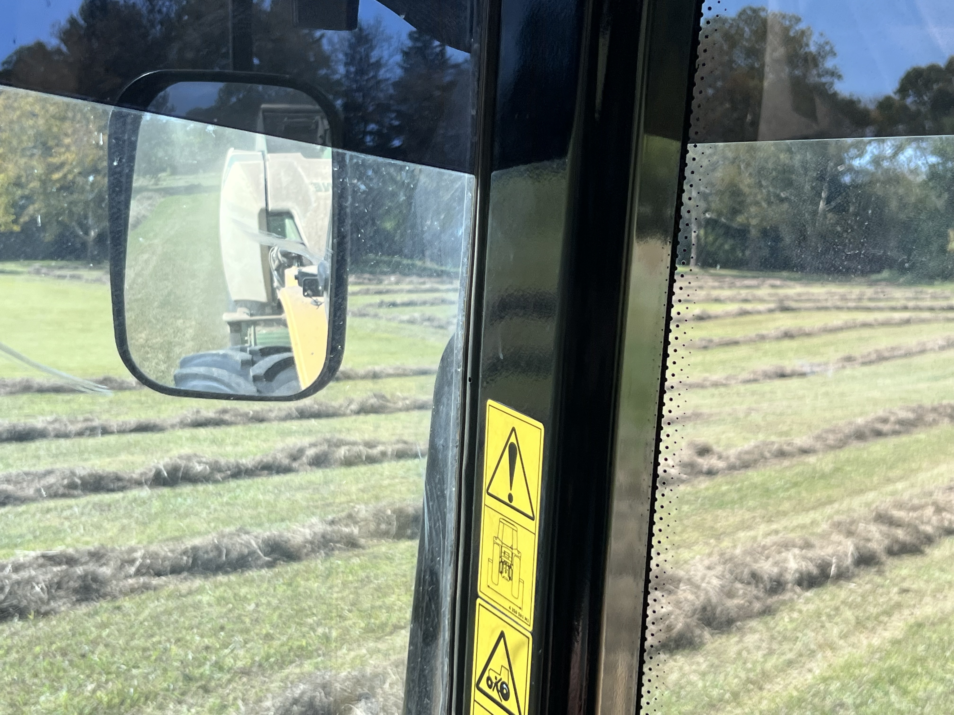

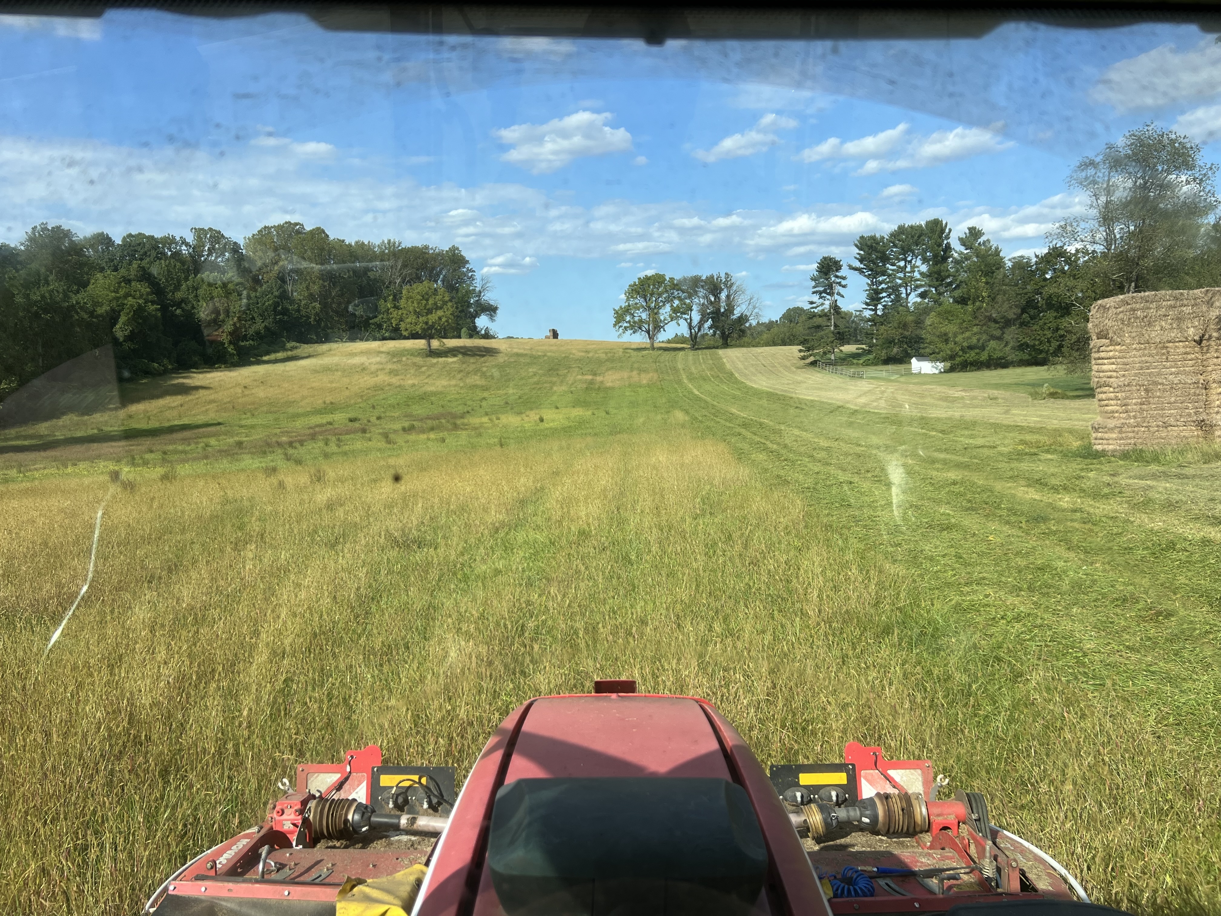

We’re in “beast mode” now. The weather has been good for a few days and finally getting into a good rhythm of raking & baling.
Finished the day by dropping another 25 acres.
