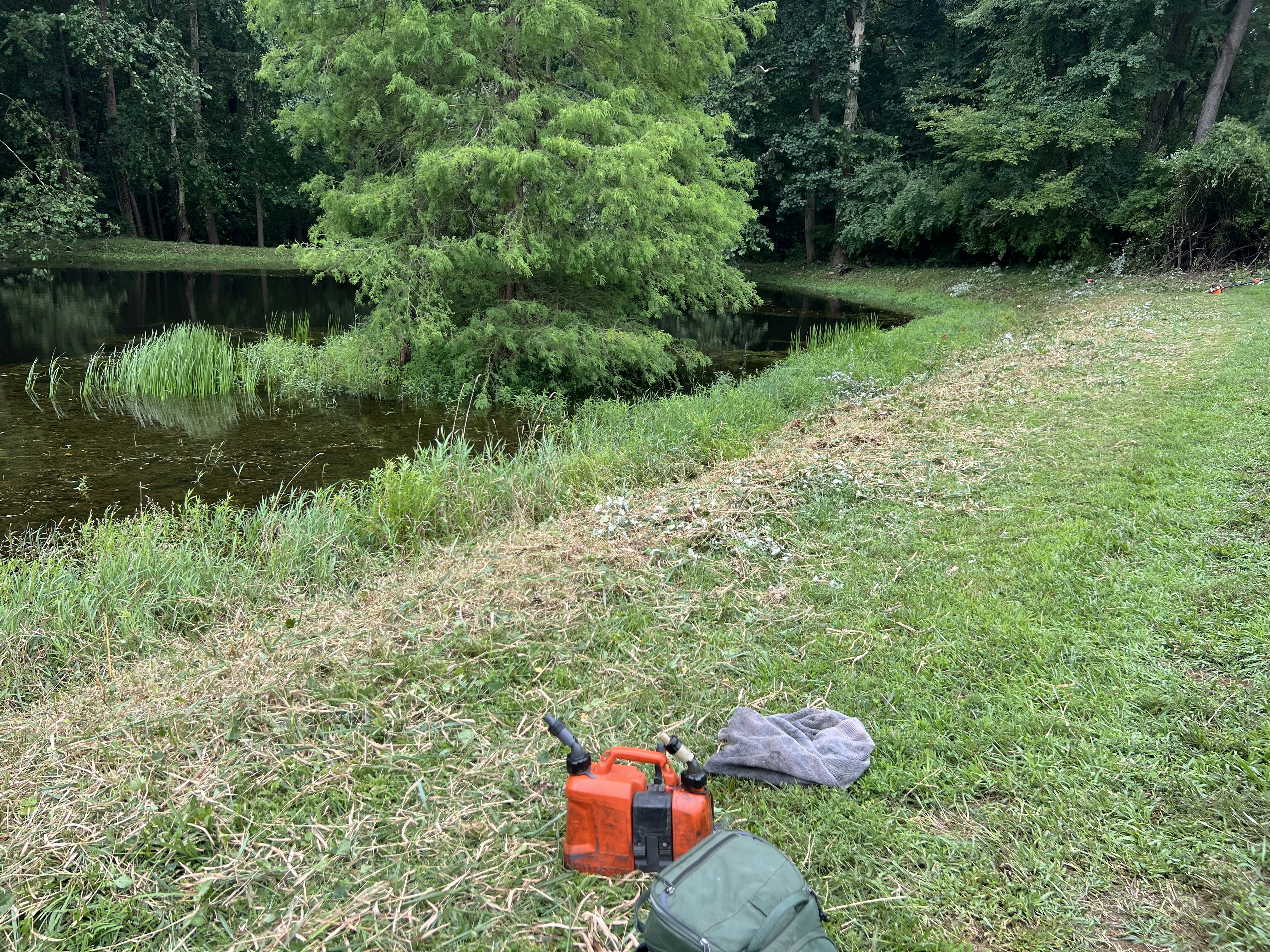

How about some pond weed wacking? About as fun as getting a prostate exam….
Luckily it was unusually cool only about 70 degrees, so it wasn’t too bad.
