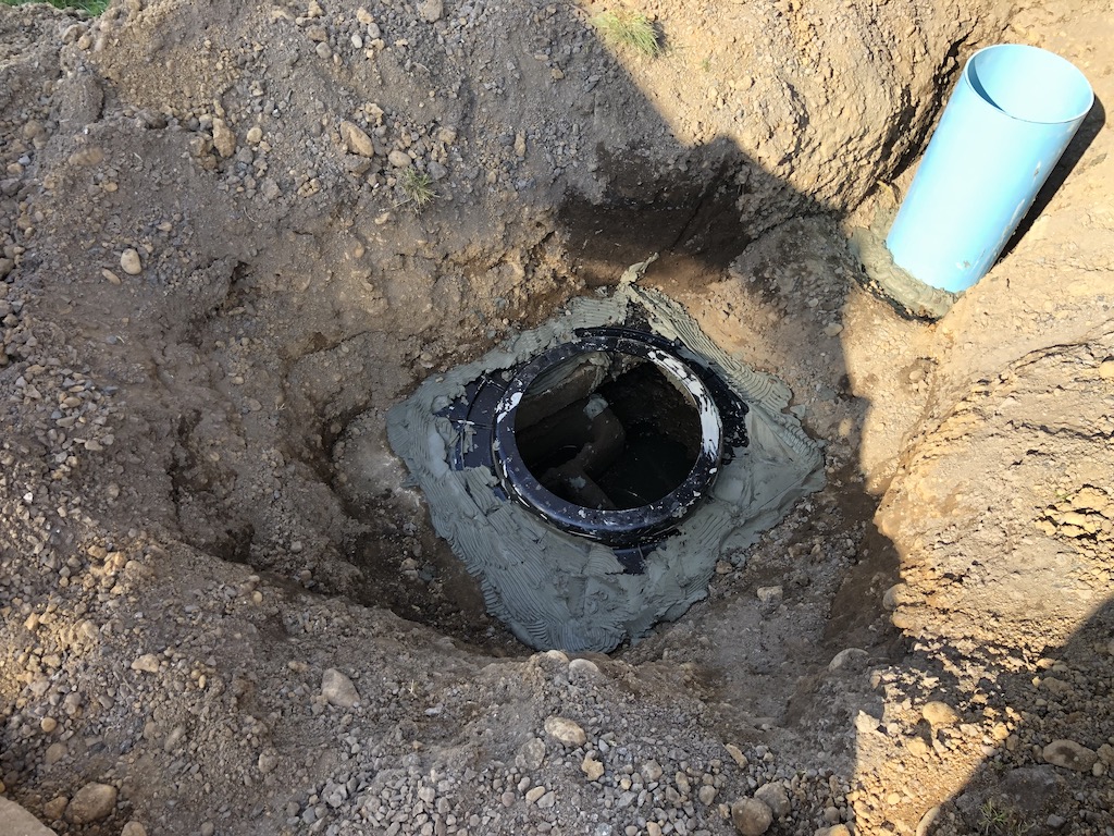

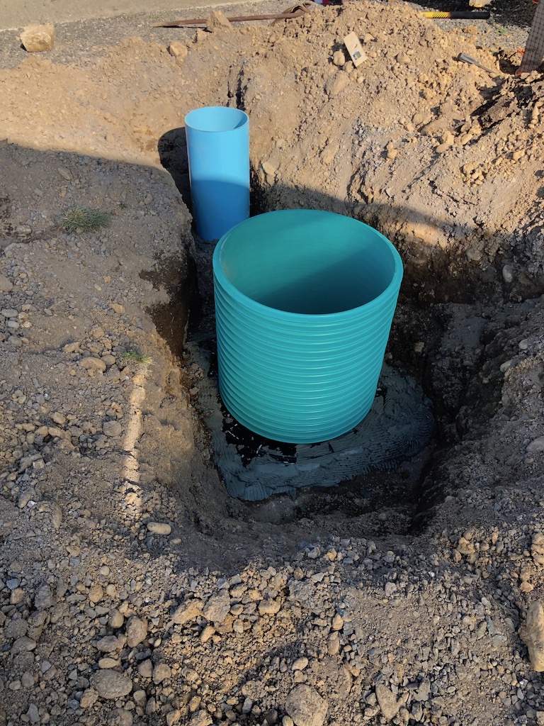

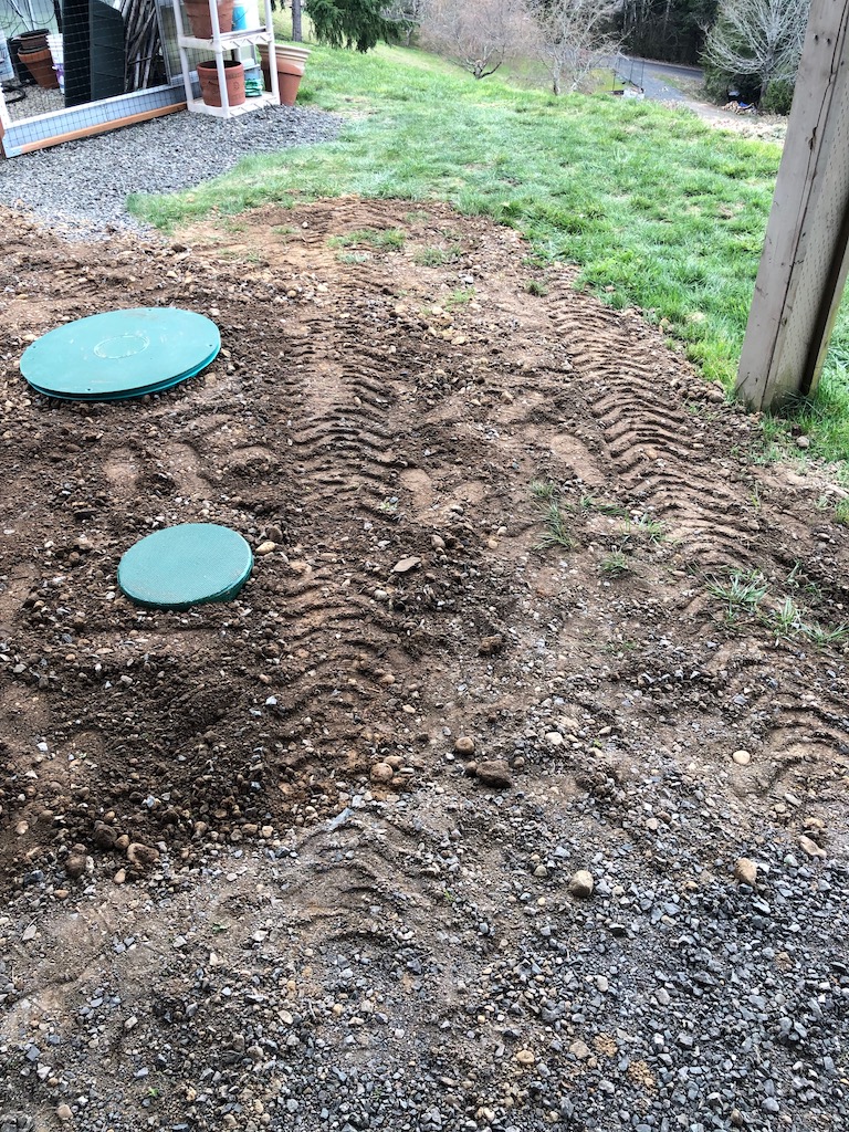

Okay getting you Yahoos (as my dad used to say way before the internet) back on track... Decided to go the dry clean route. I waited for the sun (yeah lucky break) dried out most of the dirt and then used a stiff brush and my shop vac to clean the surface around the two openings. Mixed up some JetSet mortar. Man, that stuff stiffens up fast! I learned the 'hard' way.
:smiley_aafz:

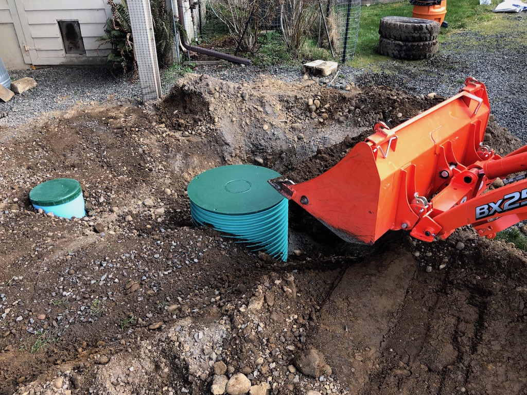

Set both the adapter plate for the 24in riser and the 12in riser. Let it cure for awhile. Then dropped the 24in riser on and caulked around the bottom on the inside of the riser with some silicone sealant.
Waited a bit and then started gently shoveling to backfill around the risers. It didn't take me long to decide to put the front bucket back on (no big deal w/ my trusty QA)! Pushed the rest of the dirt around and did some tamping.

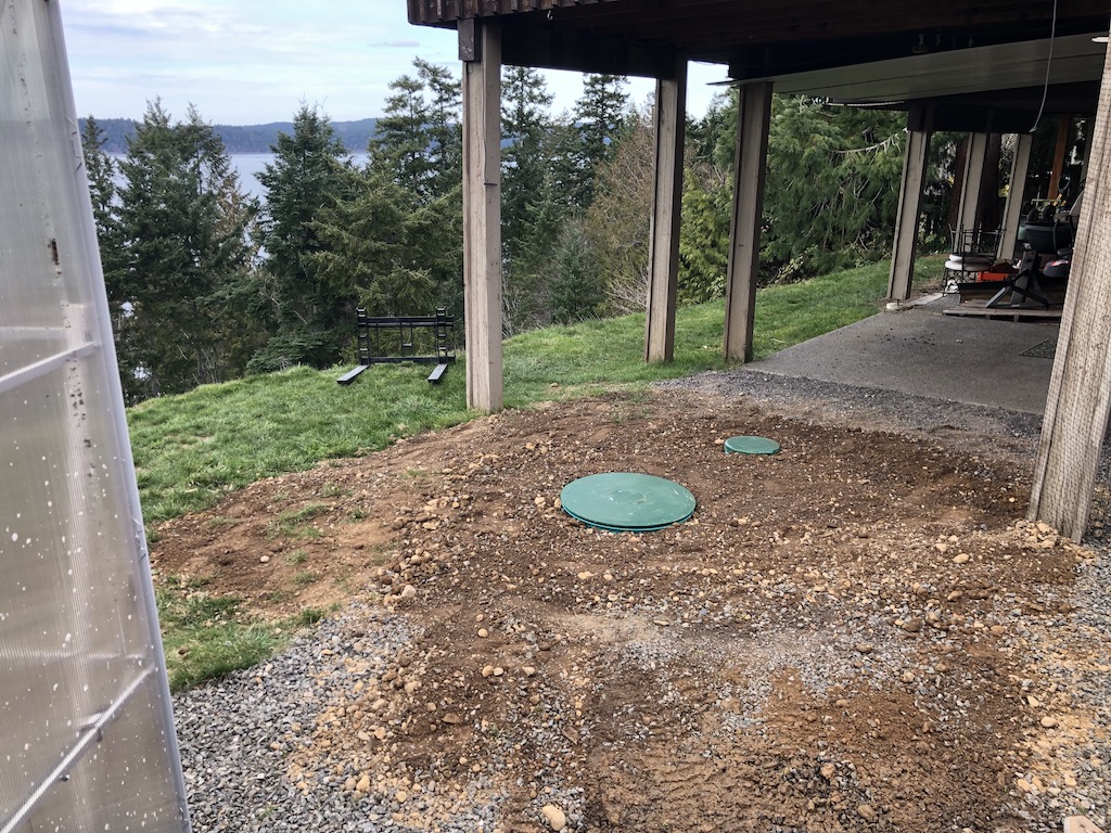

Final move today was to put the tractor away under cover and see if I could straddle or go around the covers. Ended up going around the side. Note the tracks No issues, yeah!

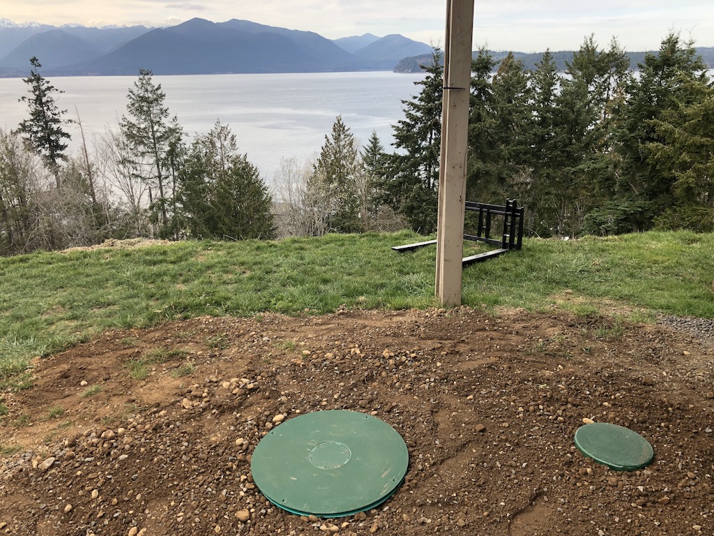

Time for a glass of wine and celebrate a job complete... well almost. I will let it settle and then throw a yard of 3/4 crush cleaned on to level it off and toss some grass seed where the dirt spilled on to the lawn during the dig. Rains are coming tomorrow... glad I knocked it out today!
