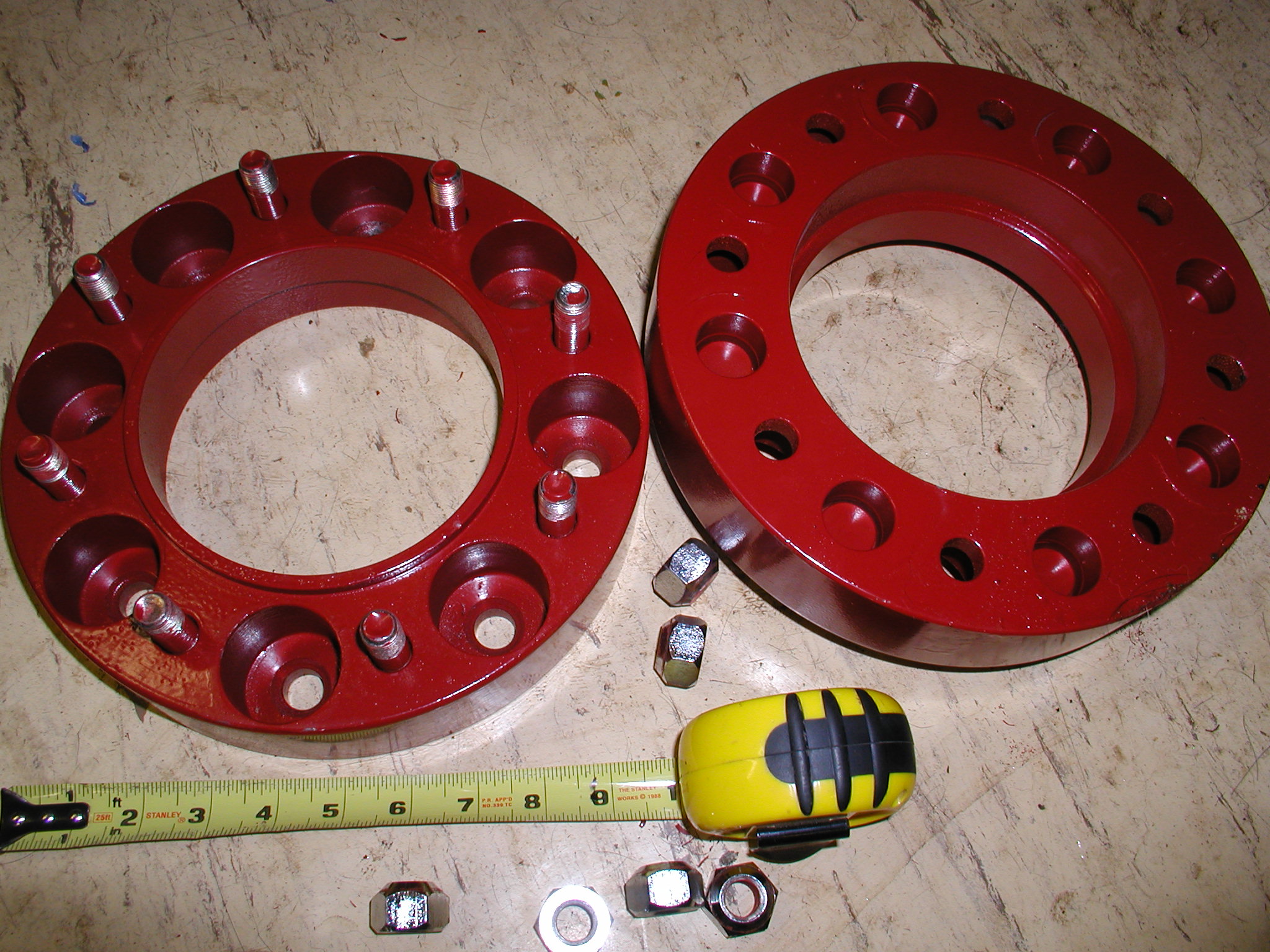

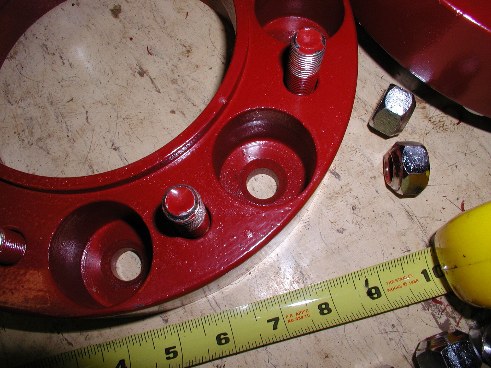

Maybe I should put the calipers away and go with the 9/16.
Dan

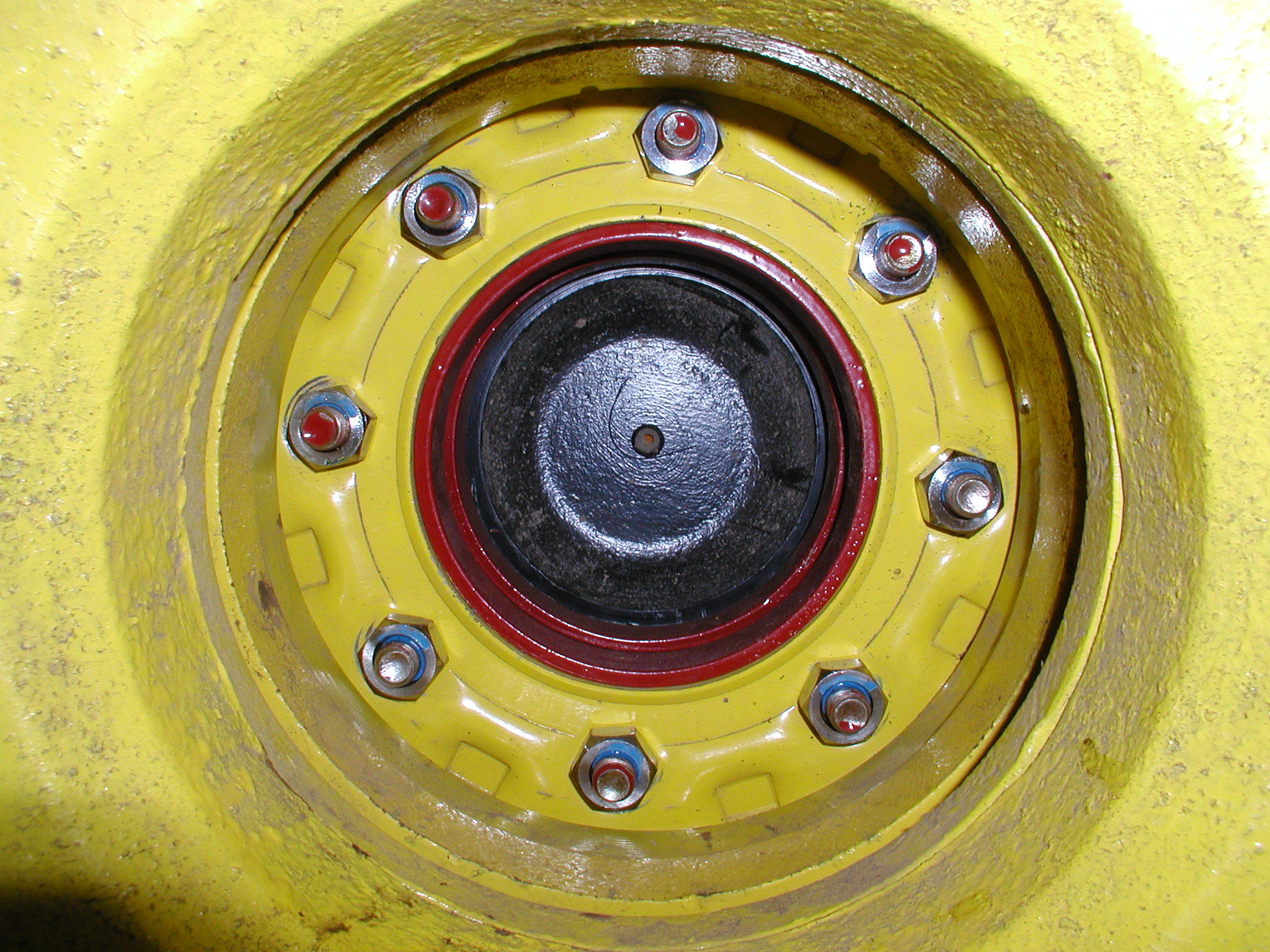

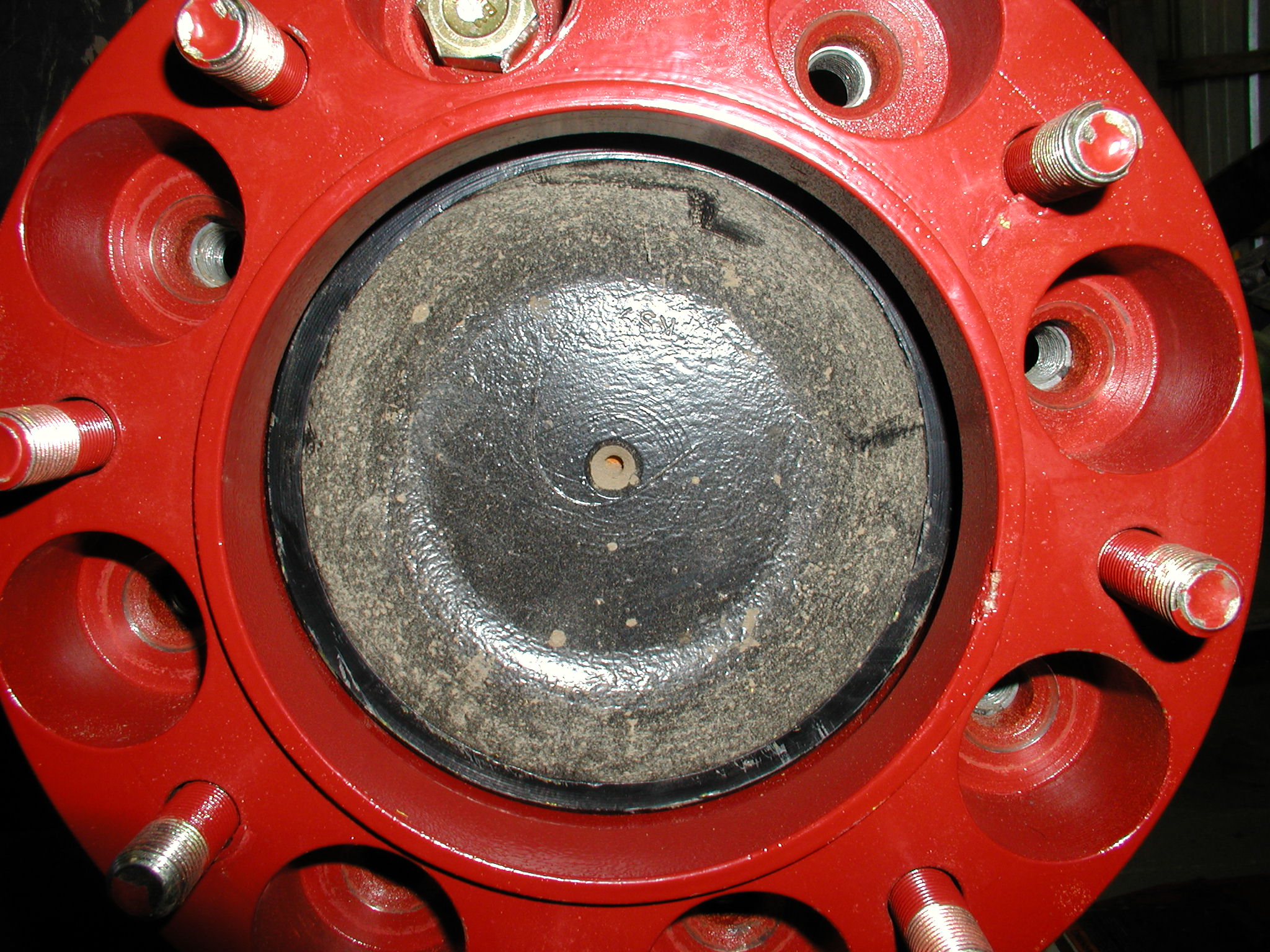

I did the caliper measurements like you and Jim Gerkin and concluded the 9/16" is the closest fit to the JD studs so I ordered the red spacers made for 9/16" bolts. Mine should be delivered in the next day or two. :)
/ The JD Cut Wheel Spacer Answer Thread #43

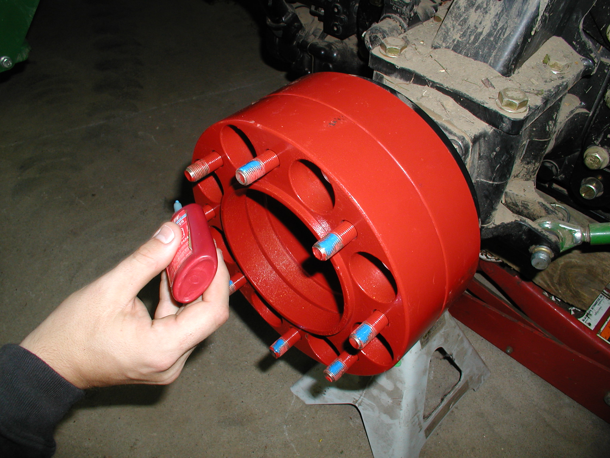

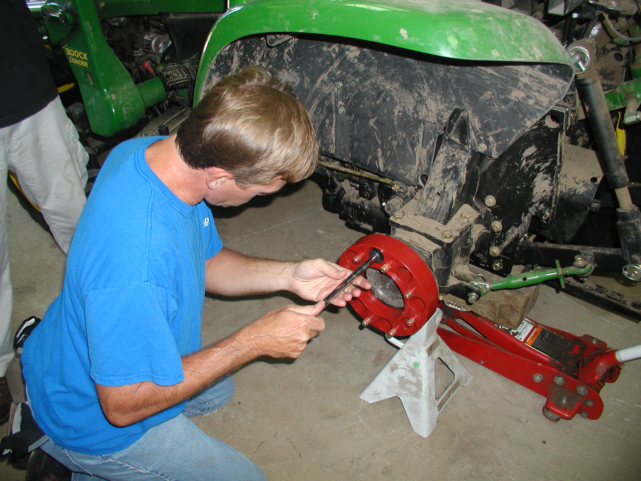

Received a set of spacers (4 total) a few days ago from skidsteersolutions.com and installed them today. I put two spacers on the 3720 and two on the 4320 both of which have rimguard for ballast. My wife helped hold/balance the wheels while I bolted on the spacers. All in all it took about an hour for the 3720 and about 1.5 hrs for the 4320 -- zero issues. So the 3720 went from 55" to 59" width and the 4320 went from 71" to 75" width (outside of tread to outside of tread).

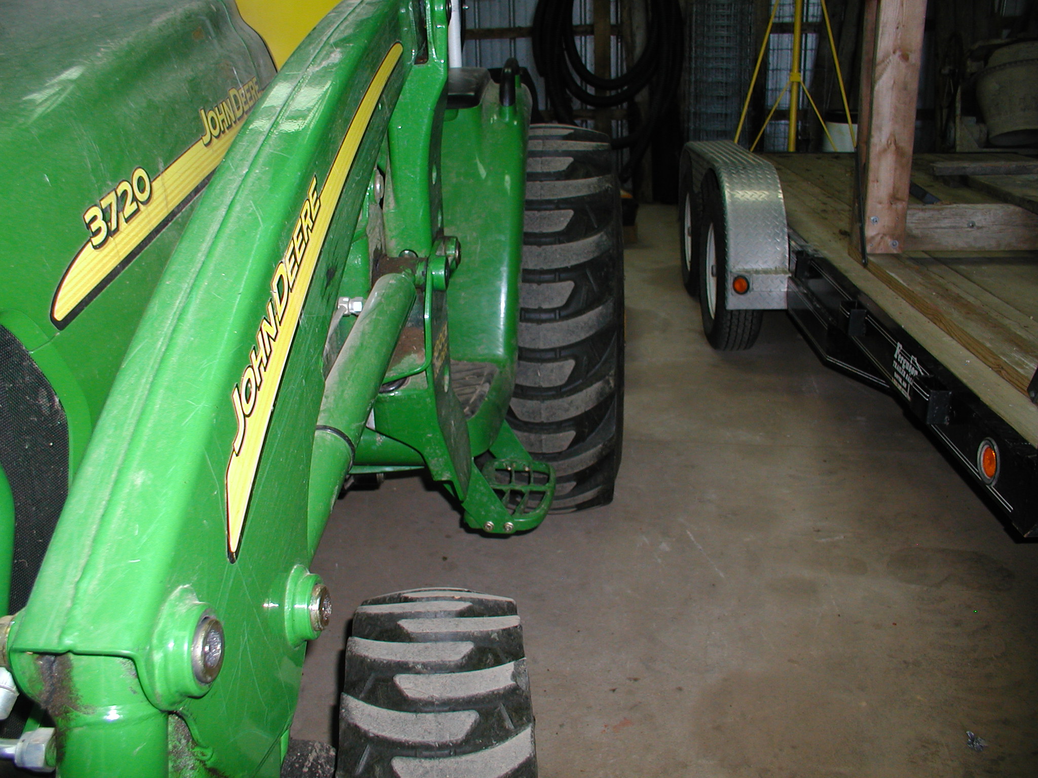

Recently I flipped the front tires inside out to see how much inside width I would get from that. Surprisingly, the inside to inside dimension went from 37 inches to 43.5 inches. Outside to outside went from 53.5 to 60 inches. I was more interested in the inside dimension because I wanted more clearance to the corn rows. I am going to plant 30 inch rows, so the extra space is nice to have. I realize that the extra width up front does not add to stability, but when driving it down the gravel road at speed, I noticed the tractor reacted to the bumps much less. Don't know why.
/ The JD Cut Wheel Spacer Answer Thread #47
Thats because when your wheels are out wider, if a wheel goes up a bump four inches, the center of the axle lets say goes 2"up. When the wheels are closer it might go up say 3".
I'm sure we could figure out the exact amounts but that was just for reference.
and with the wheels wider it will help stability, but only after a rear has already lifted, if a back wheel comes up and tractor tries to go over, the front might just save you. ( don't ask how i know this, and it's happened more than once)!

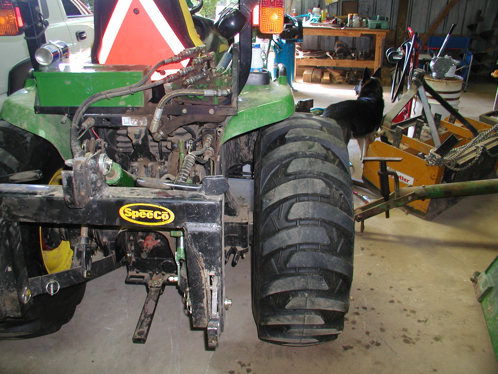

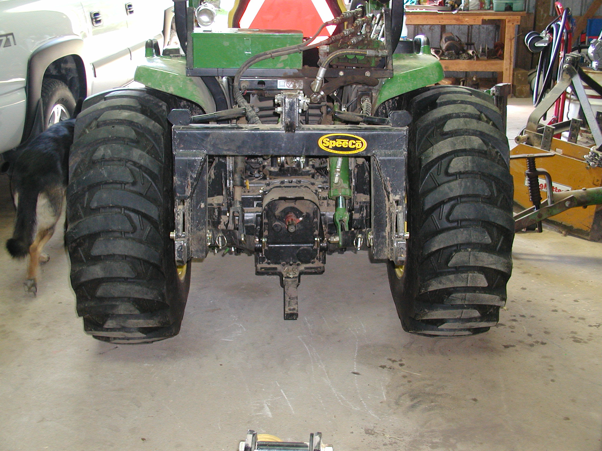

Just a quick thanks from the sunny Adelaide Hills for this thread.:)
As a direct result, my new tractor underwent a transformation today. I don't think it's an overstatement to say that the stability has probably improved immensely. My peace of mind certainly has.
The only downside is that I had to amputate the back RHS anti-scalp wheel on the self-connect MMM. Not sure how vital this is, but it will be welded back later in a slightly altered position.
Before:
After:
I know the altered perspective looks like it was designed to emphasize the changes, but it that wasn't my plan - just happened to be the way I took the pics - might have been some subliminal psychology.:eek:
Anyway, I'm rapt that I will feel so much safer, having read lots about the "tippyness" of the 3000 series AFTER I signed the contract to upgrade from my previous 2320.
Cheers
Tony

Thanks for the comments and welcome, guys.:)
Yes, Jim, I used the full 4 inches per side and would count that as the minimum I would be content with now. I wouldn't say it feels 100% safe, but much, much better. On a particularly uneven bit of ground it still managed to feel bit tippy. I was very glad I had the spacers on.
Dutch, I simply cut off the right rear anti-scalp wheel. I'm mainly mowing pasture of several acres at a time and I don't think I'll miss it. There's not much incentive ATM to cart the deck to an engineering workshop to get it welded on again in a slightly different position to clear the tractor back wheel - but I might do this later......or not.;)
Anyway, I hit a stump with the mower and traumatized it a bit the other day. I was able to get it functioning OK again, but it's probably only a matter of time before it's in the workshop for repairs etc - so that might be a good time to get the amputated anti-scalp wheel re-attached.
