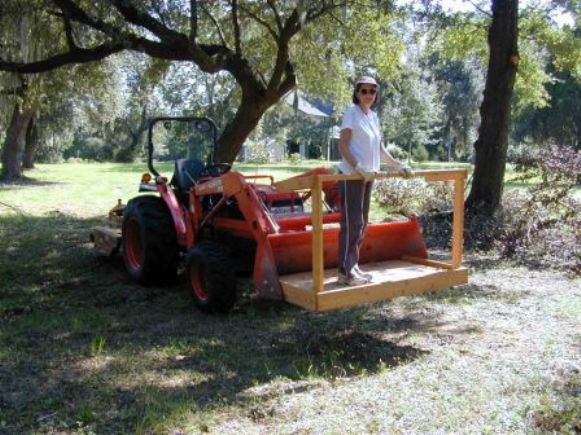

The strap is bolted to the bucket but yes it is the only thing that holds it in. I will use a safety chain later.
/ The Handiest Thing I ever Built (Manlift) #22
Nice job but you need to add some 6" toe boards around the bottom. They will keep anyone from slipping of the platform.

Yup thats a condor lift. I have license for 1 of those. You can actually catapult yourself out of the basket if you don't know what your doing. Tire flex alone is several feet in the basket. 7 feet of lanyard is perfect for pounding you pretty good on the outside of the basket.
Just a note on using a pallet as a platform & I do not recommend it at all but the bottom boards are more important than the top ones to keep it from flipping off your forks

...Unfortunately the tractor hydraulics are not designed for this type of application.:( :( :(
Fill me in, Egon. What's different about this application vs. simple lifting and other stuff we all do with our FELs

The difference is people. Who cares if you drop a load of dirt. Tractor loaders don't have pilot valves on the cylinders so if a hose or valve breaks the loader or bucket just falls rapidly.
I had the fun of watching a 4 ton pallet of bananas drop when a relief valve crapped out on a forklift. They fell as fast as if you had dropped them. Not a big deal for a couple of feet but once you get up a bit its easy to get injured.
And the original poster is right, ladders are pretty dangerous too. I'm not sure what would be safer based on statistics.
/ The Handiest Thing I ever Built (Manlift) #33
I think the bananas fell so fast because of the shear weight of them 4 tons pushing down is different from a 200# man. I no expert but such a light load would not compress the hydraulics as fast. Either way I have worked out of forklift mounted baskets a lot and plan to build a man lift myself.

I was wondering how you guys get in and up? Do you have someone else operate the tractor then?
Thanks for the explanation.
I think of the options available to the major majority of us, yzbdsbp is the safest because he's got the cage.
I'd wager that nearly all of us have used our FEL as a Manlift/Ladder at one point. We've just all done it without the added safety of the cage.
I'm sure someone who does this stuff professionally will post with the fancy schmancy OSHA **** approved personnel lift that is sooooo much safer and will put us all to shame. For the rest of us who can't/don't/choose-not-to afford the schmancy man lift, I think yzbdsbp has the right idea.
/ The Handiest Thing I ever Built (Manlift) #36
Don't kid yourself, 2 gallons squirts out of a 1/2" hose mighty fast.
Yeah I have a friend of mine who can drive my tractor better than I can!! hahah :confused:

Yep slowzuki, I agree, but a fall off of a 8' or taller ladder would pretty much have the same effect! I just like the mobility of the cage, I dont have to drag ladders around in every occasion, but if you dont have a friend who can operate the FEL "very good" my manlift is useless! :D :D :D So I use ladders sometimes and when he (my friend) is around we use tractors, but you cant just trust anyone when this cage is to its full height.
