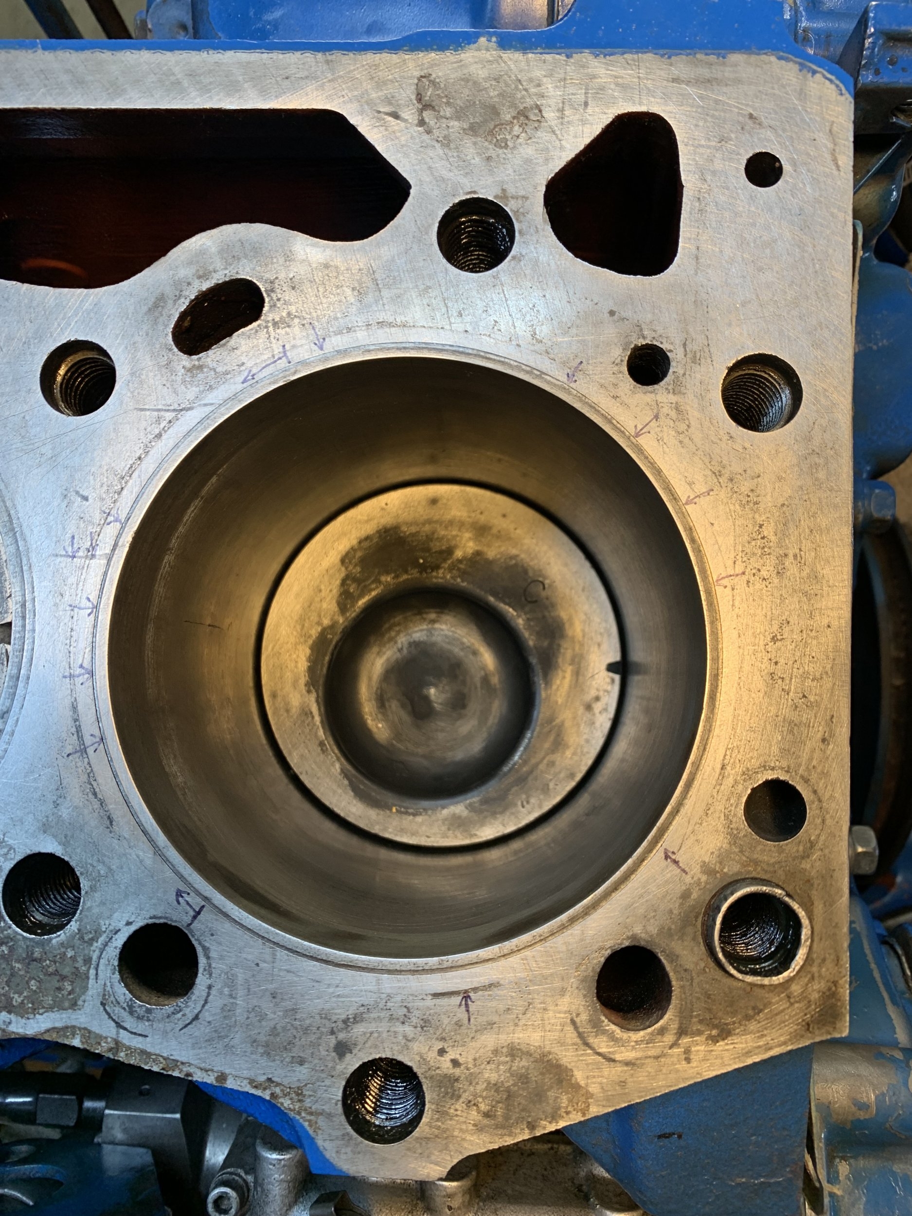

The guy that put the engine internals together says "The rings are not seated yet end the smoking is normal. Just give it a couple hours of work"

Well I have turned the wrench for over forty years overhauled 1000s of engines never used abrasives to seat Anything. I use a light oil not engine oil usually marvel oil
Stuff gives enough lube till running and engine does the rest no smokers no boom boom no blow by
They run as long as customer lets them

A question for the OP. How long a warranty did this guy give you ? I,m thinking he is trying to push you along with lies til the warranty is over. Whoever the guy was that tried to do these repairs for you is a quack. Hopefully you haven,t paid him any money, and take it to a real mechanic. It is the only way to properly fix this mess that you are in.

You can not just assemble an engine like you would a toy model kit. It is the mechanic responsibility to check clearances, rod,main bearings should be checked with plastie gauge for proper clearance. If you were there you would have seen this. Also ring end gap is important. Simple to check these important parts. Alot of other things I could could go over but I think you get what I"m saying. Sorry to say this but I hardly think that engine is going to somehow heal itself.

I have built a LOT of engines from lawn mowers to locomotives. It doesn't take much to seat rings. There is stuff missing from this story like a shoddy valve job. There are a BUNCH of reasons a 'fresh' engine could smoke and for some of them it will only get worse.

I recall a mechanic who rebuilt a tractor engine (International C) or the like. Baking soda was poured in the intake as a fine abrasive to help seat piston rings. End Gap. 0.004" per Inch of Bore.

So you are saying that all cars and trucks made in the world will smoke until you work them a couple hours. Ha!Ha!
If I bought a new car and it smoked they would get it right back.
Sir you have a problem, dont buy anything from a backyard mechanic and please dont pour anything down the intake you will further destroy the engine.
Have a reputable mechanic disassemble the engine and reassemble it correctly.
