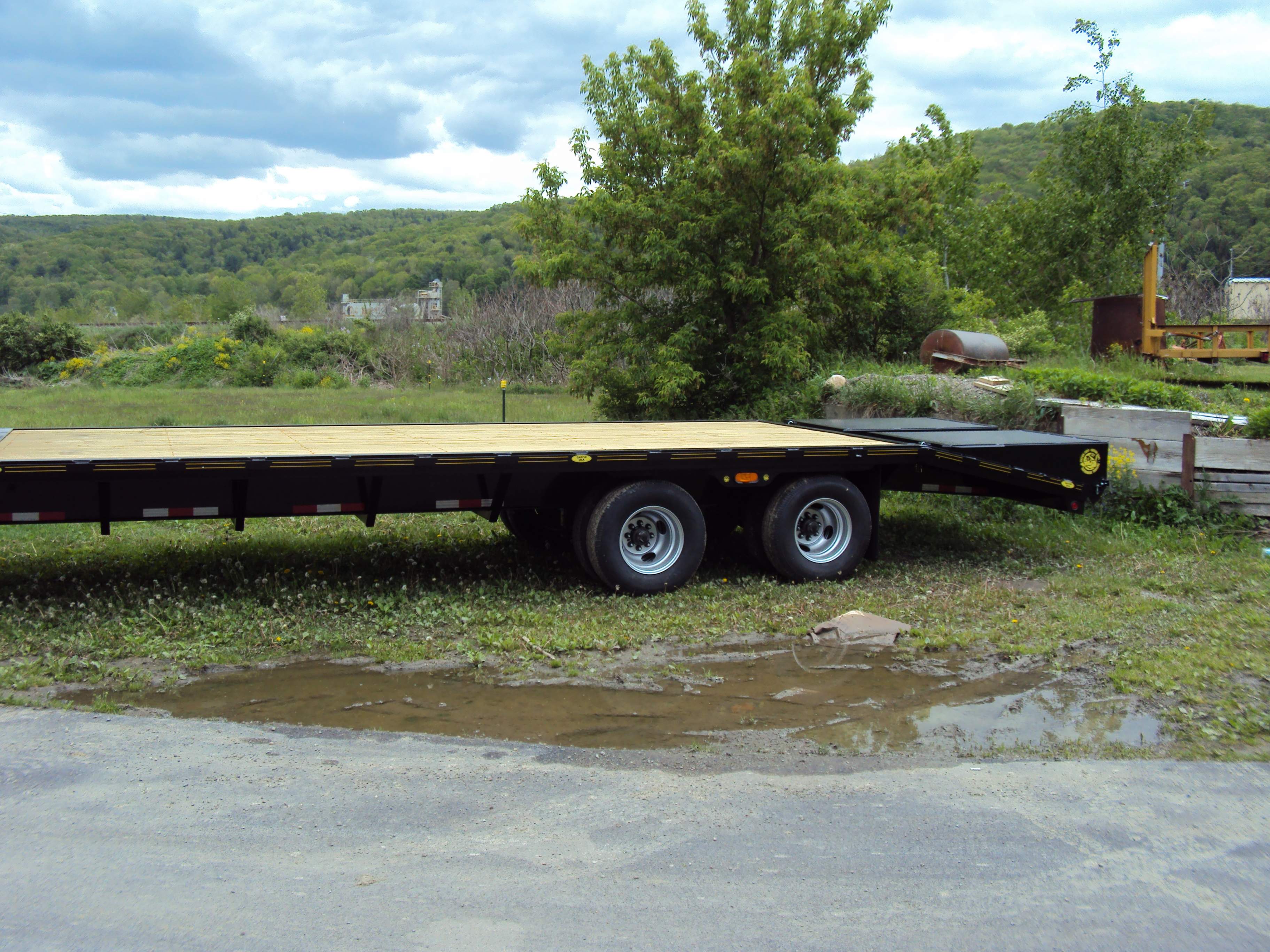

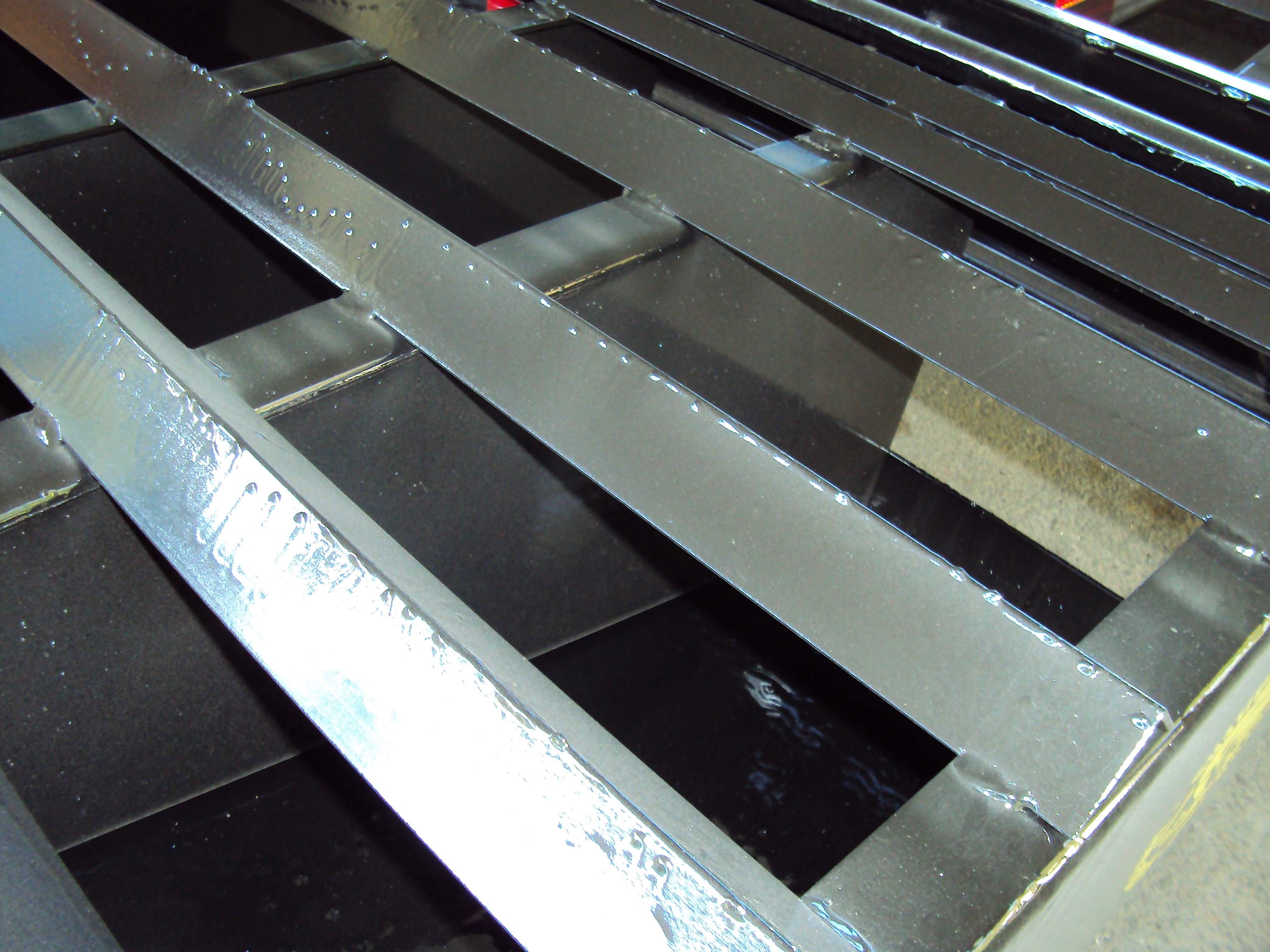

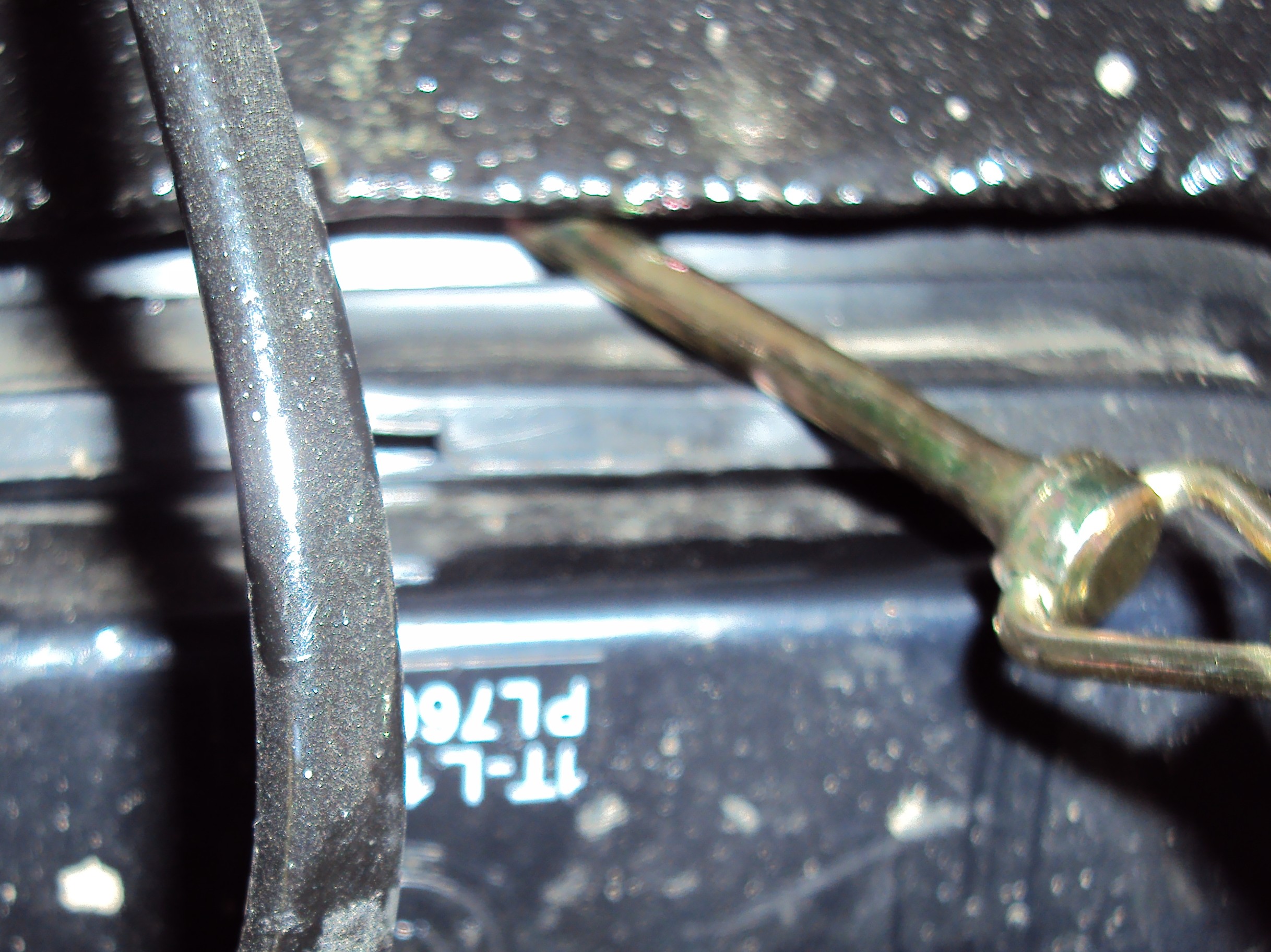

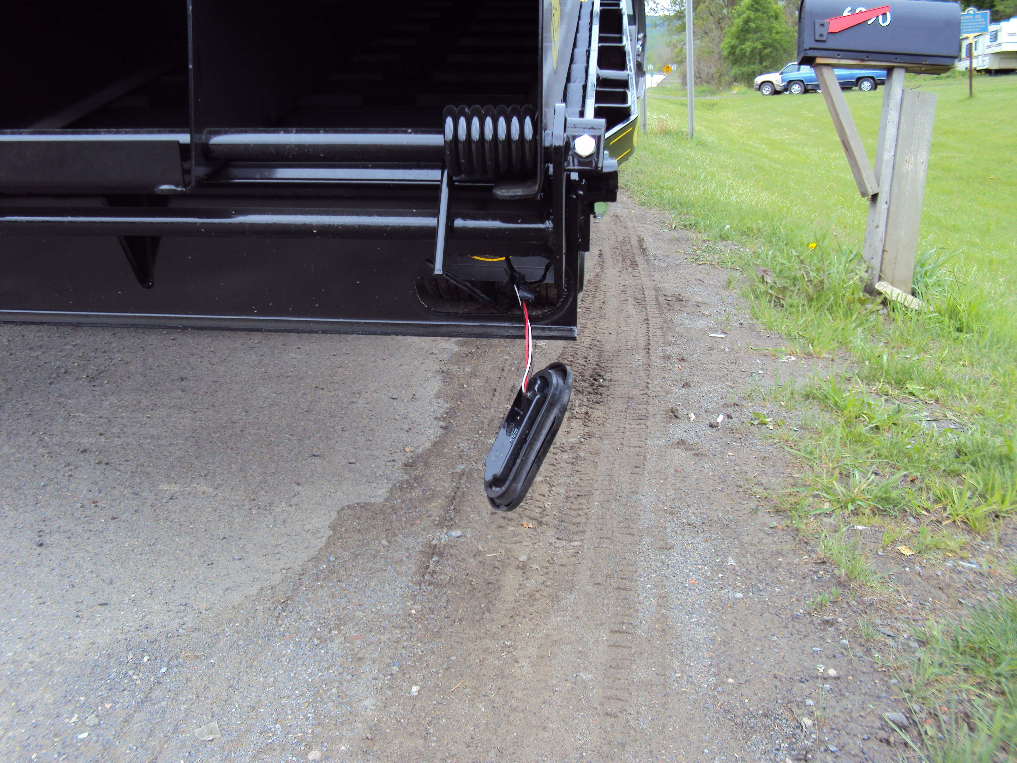

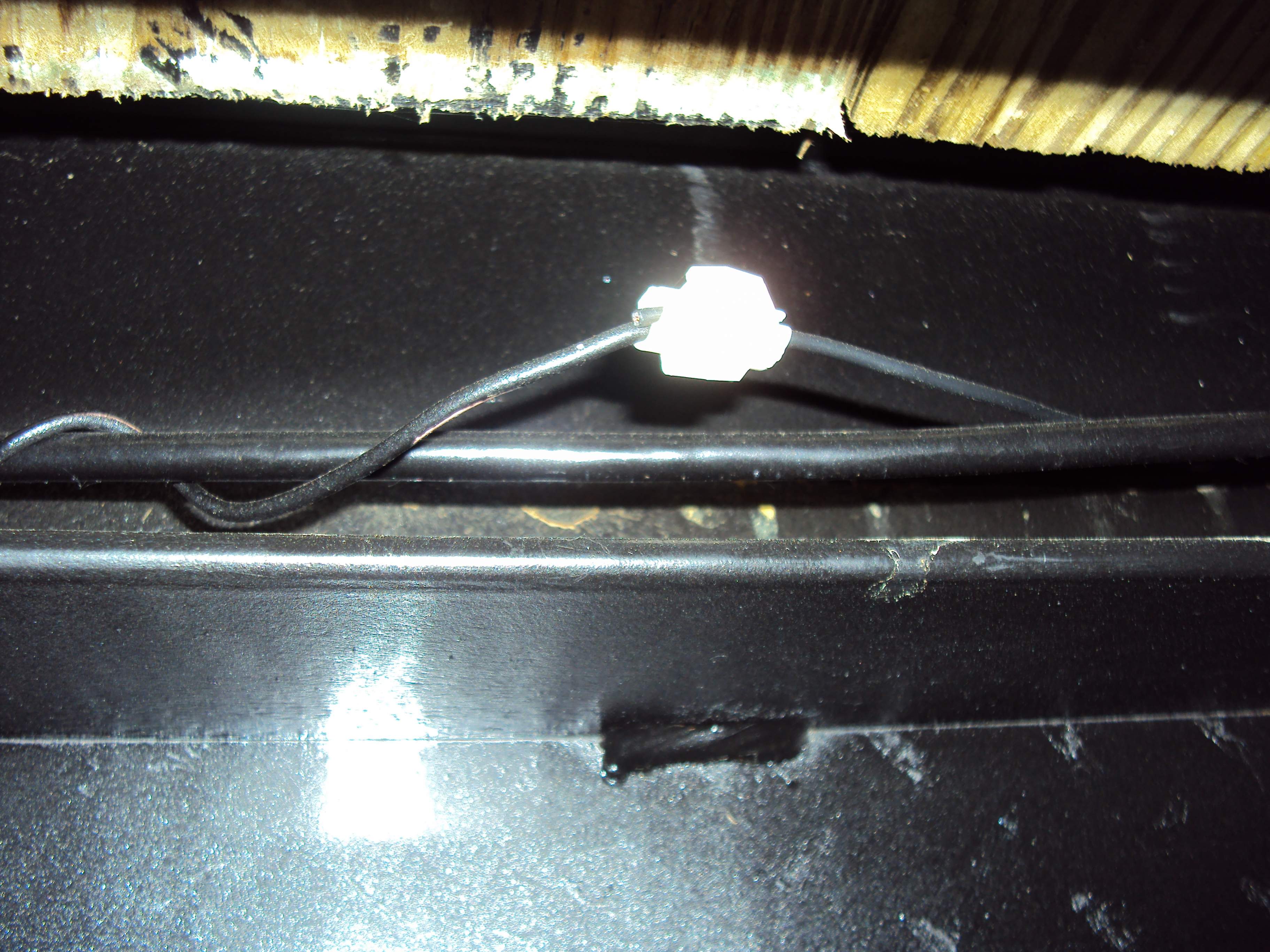

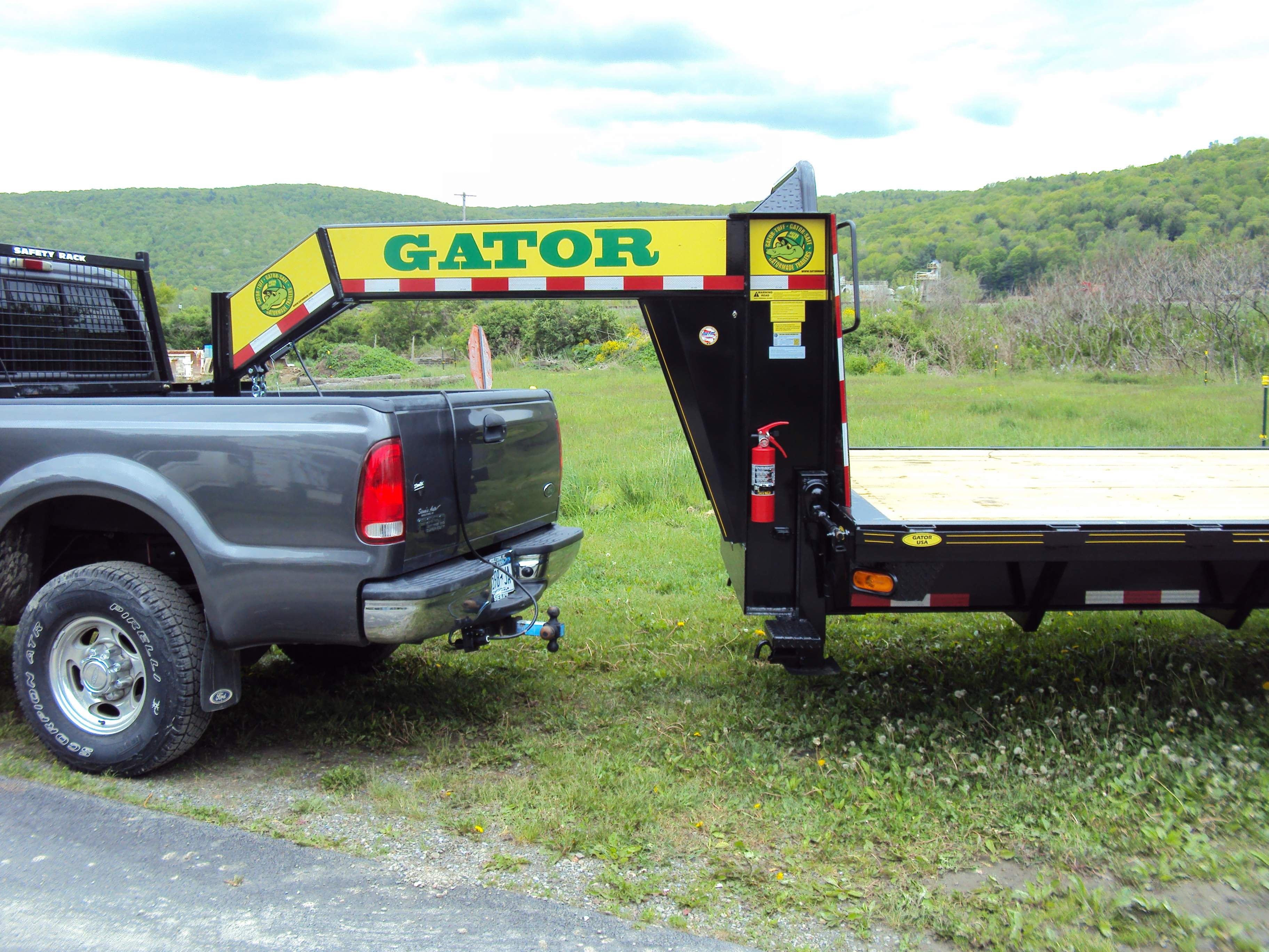

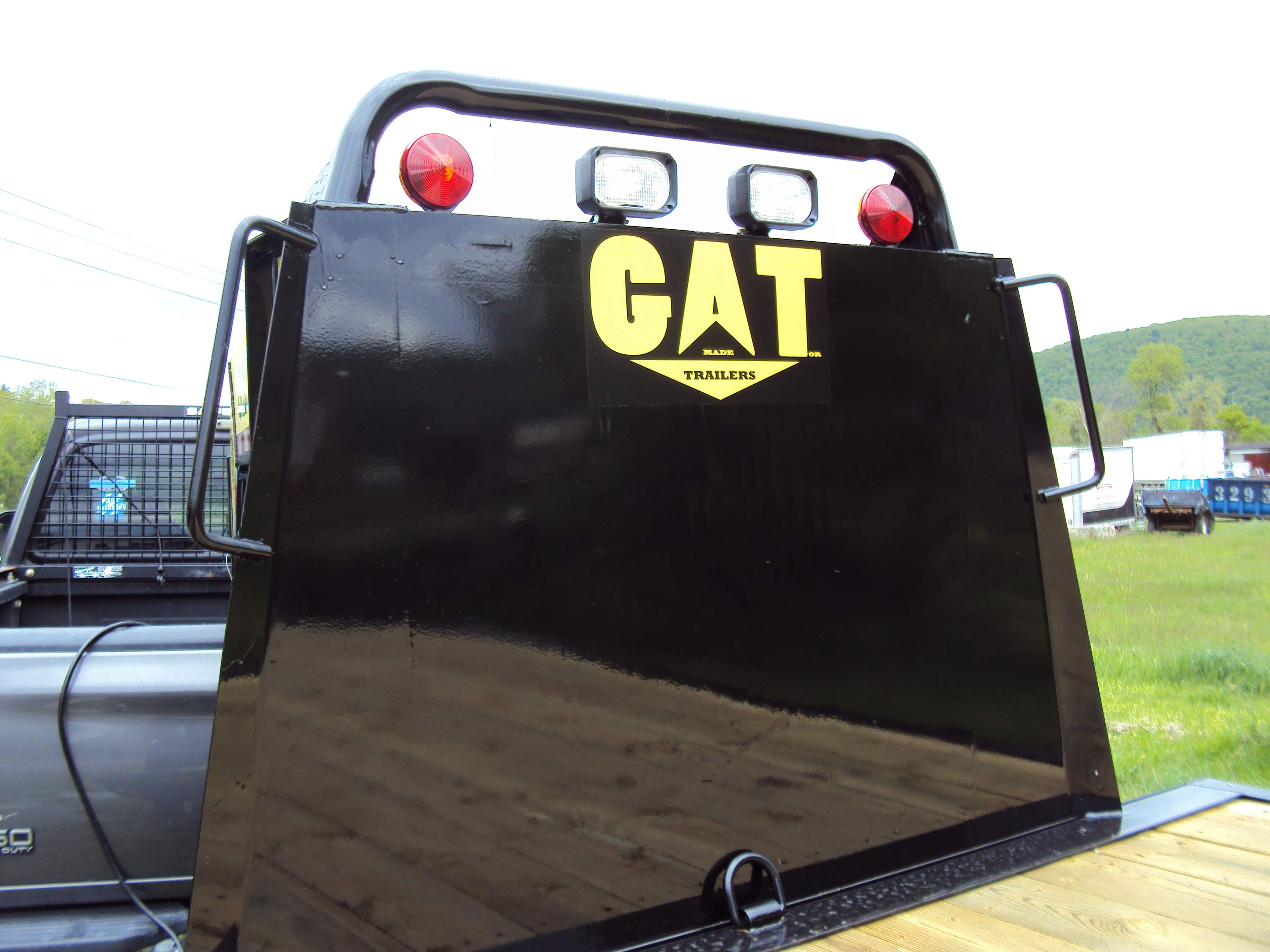

I am sorry, it took so long to post this, but I was trying to give Gatormade a chance to get back to me. I picked up my trailer at a small lot that turned out to be 200 miles from my house. It was a little rainy, which turned out to be a problem. At first glance, the trailer is quite impressive. it is very solid, and well built, as far as the frame, and welding are concerned. I was also very happy with the extra wide spring assisted ramps. As I looked closer, I noticed that the paint job was absolutely horrible. I do not exaggerate, when I say that the runs cover the entire trailer. Little alarm bells were going off, so I looked underneath, to make sure the frame, and cross members were painted. They were, and since it was raining, I did not dilly dally under there. I wish I had. We tested the lights, and the ramps, and I checked to make sure there was oil in the hubs. I did another quick walk around, and I got in the truck and headed for home. On the way home, I stopped for some roadside BBQ, and what do you think I saw while walking back to the truck? Why I saw that a rear taillight had fallen out. Yup, hanging there by the wires. I got down to look, and I found that the holes for the lights were 3/8 of an inch to big. On both sides. I must have hit a bump, and it was enough to jar it loose. I put the light back, and taped the back of the lights to the frame, with duct tape. I then tried to call the salesman from Gatormade, and the guy from the lot, with no luck. I headed home. Once I got home, I inspected the trailer from top to bottom, and front to back. Guess what I found? Scotch connectors. I had specifically asked Paul at Gatormade, if this thing had scotch connectors, and he told me absolutely not. Because of the rain, I did not want to take the time to crawl around under the trailer like I had wanted to. Once I saw that they had painted the entire bottom, I got out, and never thought to look to close at the wires. I had planned on walking away, if I saw one scotch connector. I called Paul at Gatormade, and very calmly explained to him what I found, and asked what he was going to do for me. He asked me to e-mail him the pictures I took, which I will post here, and he would get back to me. when I here from him, I will post the response. These pictures show the bad paint, the scotch connectors, the taillight hanging from the rear of my trailer, and the space between the top of the hole for the light, and the top of the light.

/ The Gatormade expierence. #5
What a POS.
I can understand crappy paint, welds, electrical connectors, etc on a $1K landscape trailer from HD or Lowe's. But this Gatormade GN is an expensive hunk of hardware that you'd expect to have a lot better quality. As usual, caveat emptor.
I know what you mean flusher. I can't believe a company even a small company does not have anyone doing Quality control. This is their most expensive trailer, if I was the salesman, I would have checked the trailer myself, before it left. Of course, I will hard wire the scotch connections, there are 4. I can fill those holes, and then silicone the lights in. I must admit, it is a rock solid trailer. The brakes on the trailer, are strong enough to jerk my truck to a stop, going down hill with 10000 lbs on the bed. and those ramps, are the nuts. Its just that I feel like I paid what they asked, and did not get what they promised. If I don't get an apology, and some kind of consideration, I will make it my mission, to discredit them on all the sites I belong to including Ford truck enthusiast,and the diesel shop. I am not expecting a substantial amount of consideration, but they have to do something.

I'd be pretty torqued if I paid that kind of money and didn't get what I was promised. I;d follow up on the discrepencies and not let it rest. I'm not a nit picker but the paint an, scotch locks and light falling out would put me over the top. Let us know how it pans out.... Good luck.
/ The Gatormade expierence. #8
Man how things have gone down hill. I have never seen runs like that on any trailer by any manufacture. The scotch lock will always be used by manufactures because they are quick and cheap. The lights not fitting is a new one for me.
I would make them build a new trailer with first class paint and all the little things fixed delivered to my home or a file a law suit.
The only thing you do not have going for you is you took delivery of it. I hope it does not come back to bit you in the arse.

Edit: it also looks like they forgot to put the red/white tape on the back of your trailer.
/ The Gatormade expierence. #11
on the 4th pic on the top. . . are the drips running up? thats weird! Sorry for your trouble. I hope they make it right for you good luck.

tractorboy5500,I bought a Gatermade 16'- 7K trailer a month ago and here are a couple of things I found out. They advertise a wiring harness special for the trailer? Well they use a wire like a extension cord but with 6 or 7 wires in it and just tap into that with scotch locks. I removed about 18 of those things and soldered/ shrink wrapped all the wiring. As far as the Dexter axles, well at least on my 3500# brake axles they are Dexstar and made in China, and so are the wheels, I think the tires are from China too. For the price it cost, the welds are good and so is the paint. I like the trailer and would buy it again. I don't like the China products but I guess that's what you get when you try to save some money?

Dexter - Dexstar ?! That's about as bad as the sticker on the back of the neck that has GATor on it that looks like the CAT symbol. CAT - GAT. I peeled mine off of there. I guess when a salesman says a trailer has Dexstar axles under it, it sounds like he is saying Dexter.
The drips are not running up, I had to hold the camera on a weird angle so the drips would show up in the pic.
#20
I spoke with paul at gatormade, they are sending me new tail lights. and an owners manual. They went with led lights, that were supposed to fit those holes, but obviously did not. I am supposed to find out soon if I will get some "other consideration." I will keep you posted. I have a question for you guys. What oil is used in the wet hubs on these trailers? Paul at gatormade told me 90 weight, but the oil in there looks a lot thinner. I was thinking of using the synthetic stuff I put in the rear on my truck. what do you think?
