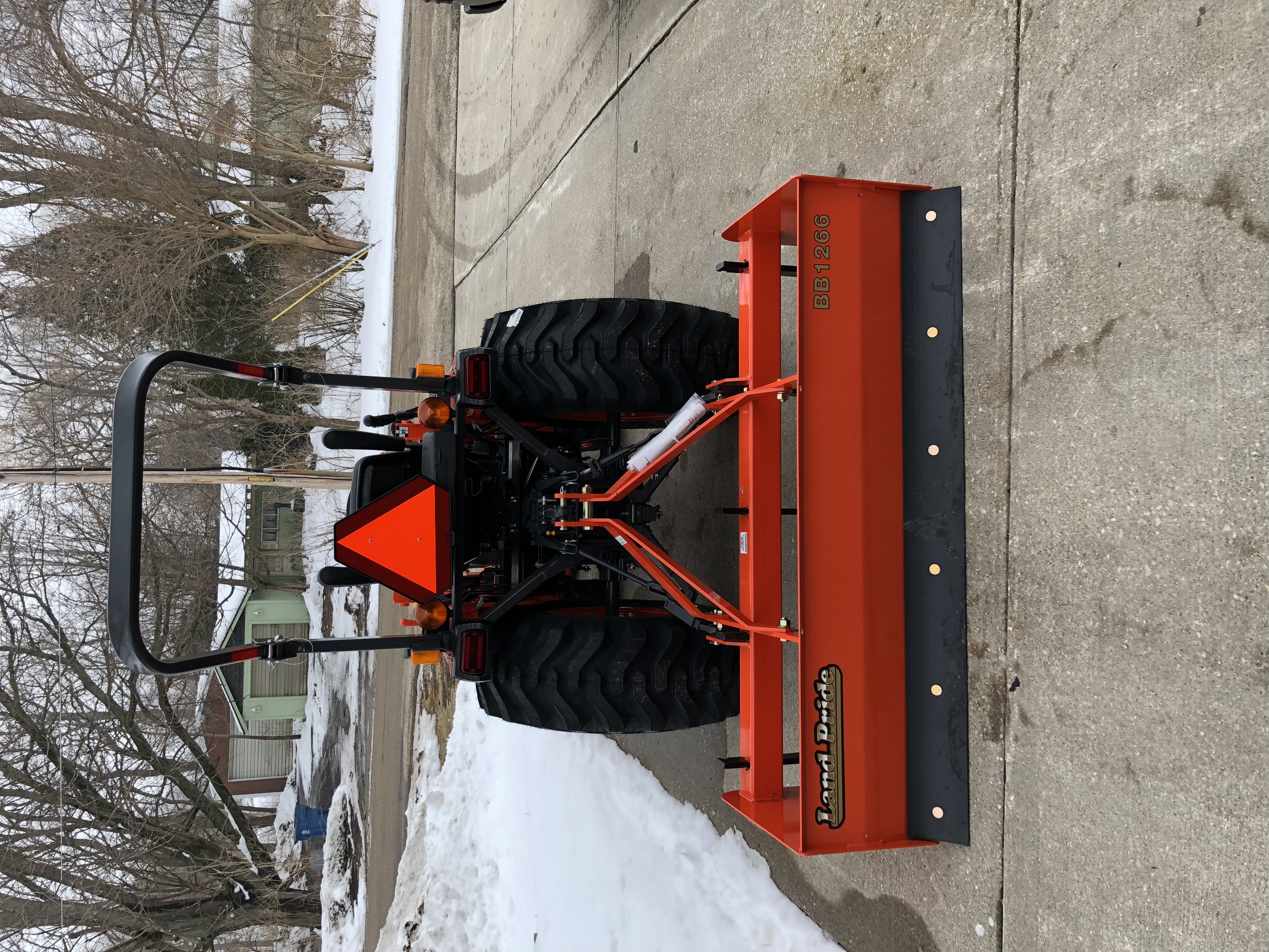

WOW
The tires make a huge difference! Looks so much better and feels more stable.
Hopefully these two side shots show some difference. I already got 1 tire filled with washer fluid.
36 gallons in no time. What a slick setup. I bought the slime valve stem adapter for 10$.
Used my tow behind sprayer to pump in the fluid. No spill no mess. Even utilized the pressure gauge on the sprayer pump to see where I was at to know when to bleed them.

Hey Dan. Looking good. Gotta be nice to have your complete setup. Congrats. Nice looking boxblade also. Just looking, are your front tires mounted on the correct sides of the tractor?
/ The B2650 count down has begun! #245
I will look when I get home.. but according to the pictures it looks they are not... how did I miss that?
/ The B2650 count down has begun! #246
Thats what I thought that they are backwards. I am sure you are so glad to have them you didnt look!!!! Haha.
/ The B2650 count down has begun! #247
Just got home and checked them out. They are definitely on backwards! I will swap them tomorrow and give the dealer some heat lol!
