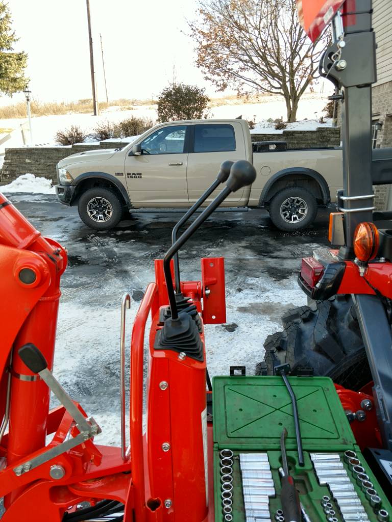

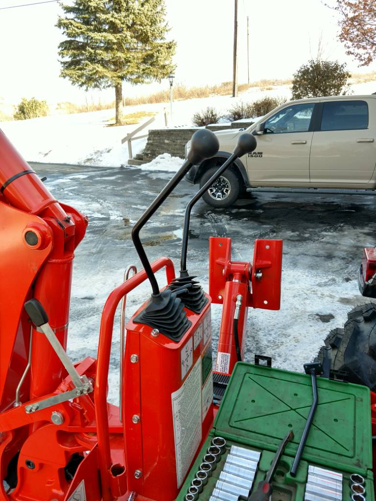

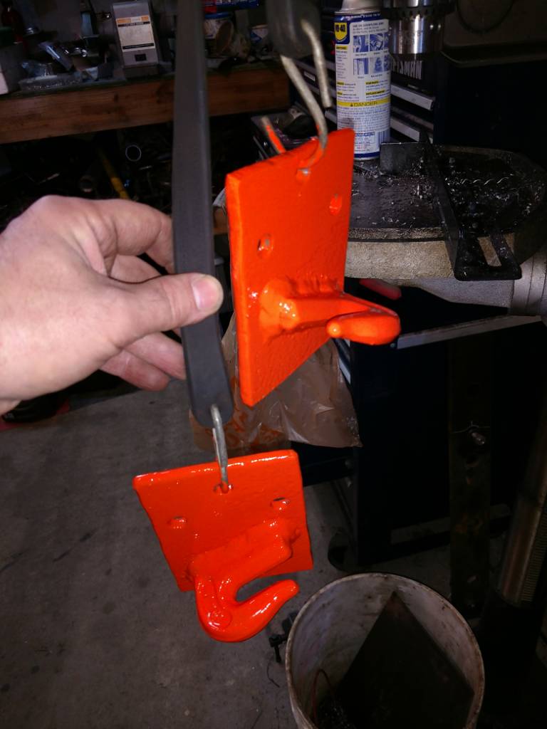

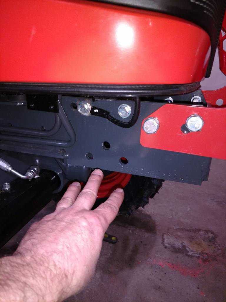

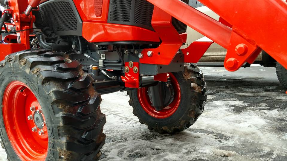

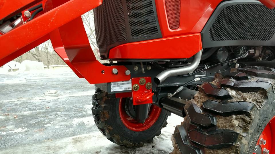

Just to make sure you all notice it, I don't like scratching paint so I made chain hook mounting plates that bolt to the frame where the steel shipping crate was attached. No modification to the tractor, simply bolt on and I have a place to set 3/8" chain for binding to the trailer. You may wish to create a similar item for yours so that you do not have to damage paint. IMG_20180210_093805715_HDR.jpgIMG_20180210_093750341_HDR.jpgIMG_20180204_173547445.jpgIMG_20180204_173609845.jpg

Looks good nice job on the hooks and d rings

Good addition of the hooks.

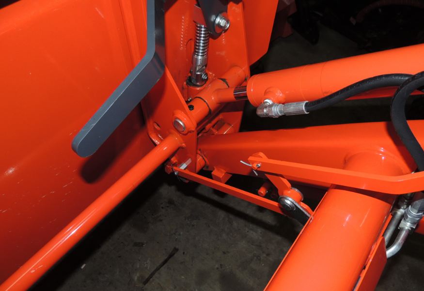

I got my plow frame all cut apart and put back together correctly tonight.

Hey Rock,
If you ever want a MMM for the B2650, you might have to remove or redesign the chain hooks......because that's where the hardware for the MMM front link hooks up. But you probably already know that........just sayin'

I have the oversized tires, so the MMM miss out of the question. Once you upgrade to the bigger width and diameter tire package, the tires are occupying space that a MMM would need. That said, I would find a MMM to be a miserable accessory, on and off with a 3 point finish mower is seconds, while on and off of a MMM is a process. For a person that will install a MMM and leave it in for weeks or months, I can absolutely see the attraction. For me it would be pain.
