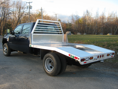

thanks for the input, took the plunge.
ordered my 422 yesterday.
tazwell told me i need a 12 ft flatbed for tractor & snow blower (140" oal hooked up),
can i get away with a shorter bed if load the blower on the side of the truck & then
drive the tractor on and articulate the front end of the tractor next to the snowblower.
trying to save a few bucks on the truck I'll be buying.
thanks, any and all input is appreciated.

So the truck is for after you have received your pt to haul it around. Hmmm i hauled my 422 w/bucket in a 5' x 9' trailer. It was a very well built u-hall trailer with ramp and sides. Dropped the ramp, backed the pt into the trailer all the way to the front of the trailer up against the pallet i slipped in between the pt and front. Chained both sides from the rops support down to the hooks in front on the bed. Unhooked the bucket, slid it into the trailer right in front of the pt under the lift arms. Put the ramp up on the trailer then let the pressure off of the lift so that the quick attach plate rested against the ramp.
Don't know about the snow blower but if i had to put something next to the tractor it would have been sitting on top of the tires. Anyway maybe that give an idea of the foot print.
/ thanx & advice #6
My 2001 model PT425 is a few inches shorter than yours I believe. When backed into the bed of an 8' pickup truck bed the rear tires are well within the bed, but any attachment is hanging off the rear almost completely. That's with no tailgate on. So 12' will give you just enough room.
When I load my PT425 in a pickup truck I have about an inch clearance between the inside of each wheel well, so the width pf the tractor is truly less than 48". I drive through a 4' gate several times a year with a couple inches clearance on each side. Gotta be careful with the articulation.
I would say if you want to load the blower from the side of a flat bed and then cock the tractor next to it, you could probably do it on an 8' bed, but the weight distribution of your load may be a bit off.
Also, even though they say the tractor can lift X inches high, that may not be enough to put an attachment like a blower up on a higher flat bed, so be aware of that. Even if it is "just close enough" to work on flat ground, you may encounter a loading area that is not level and those few inches could make a difference.
One more thing.... loading a tractor up and down steep ramps in winter is precarious, as it is very slippery. I know my steel ramps on my car hauler trailer have expanded steel covering and grip is pretty good in winter, but the diamond plate steel deck is still slippery as snot with a little snow on it. :shocked:

Just a though if money is more important than convenience: Use a 4WD full size pickup and either of the following:
1. small trailer for just the snow blower. This would significantly reduce any trailer issues.
2. use a bed extender. Mine is rated for 500 lbs but I increase safety by ratchet strapping it to tie downs on the bed rail. You would have a couple of options. You could remove the tailgate and load the PT with blower attached and then attach the bed extender to rest the blower on (still attached to the tractor but strapped separately). Or you could span the bed extender and bed with wooden planks. I would be very careful with that, checking the design to make sure everything can handle the shock loads of bumps as well as the temporary loads during loading.
Personally, I would probably pick #1 or purchase PT snow blower attachment(s) to leave at their house(s).
If they are very small driveways, a small self-propelled snow blower might be faster by the time you took into account loading and strapping time.
Ken
/ thanx & advice #14
How about something like this?
From this website....
NETD - Flatbeds
