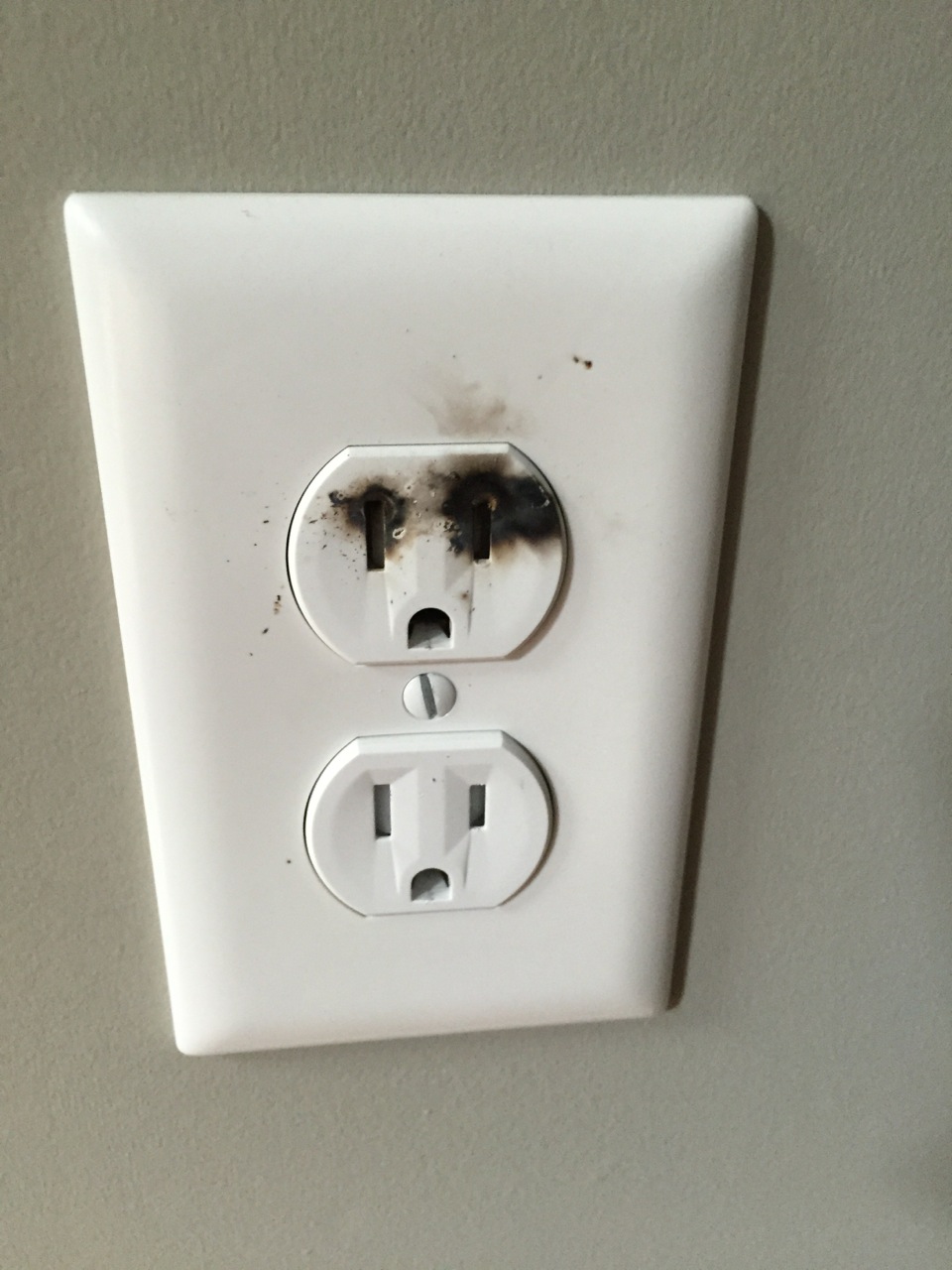

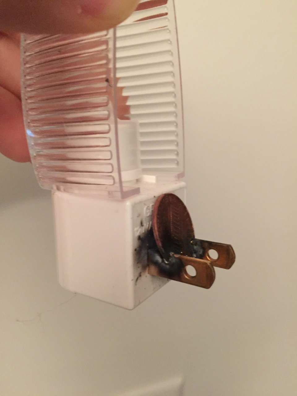

Anybody have a good procedure to test a breaker to make sure it trips?
My two year old daughter, who has all the makings of a tinkerer like me, managed to drop a penny across the two prongs of a night light plugged into the wall. The penny melted about halfway down the prongs before the whole thing fell off the wall. Pics below. This may actually be a good thing as she seems to have no interest in wall outlets now. Anyhow, the breaker on that circuit never tripped, which is not unreasonable, but I sure would like to verify that it will trip somewhere in the neighborhood of 15 amps, just for assurance. I have never run into a safe procedure to test that though.
The only thing I could think to try was put my compressor on the end of a long extension cord -- I know that SOB will trip a breaker when I am in the middle of a project if I don't have a heavy enough cord -- but damned if it didn't start (albeit with minor grumbling) on every 15A circuit I tried in the house, including the one in question. I didn't want to do that more than 3-4 times since it's not good for the motor.
By the way, I tore apart the old outlet when I replaced it with a new one, and there was no sign of arcing or damage inside the outlet, and all the wiring looked fine. So I do think this was a relatively quick event with only external arcing, and the nightlight must have popped out of the wall very fast. Our only clue as to the event was my daughter coming and telling mommy that she "heard a noise". She's a real punk... All of this happened in the space of 30-40 seconds when my wife left the room to refill my daughter's zippy cup with juice.
Based on the date on the penny, it's a version that is primarily zinc with copper plating. I have no idea how well zinc conducts, but the penny would have needed enough resistance to keep the current below 15A if it didn't trip the breaker, assuming the breaker is OK. The brass prongs on the nightlight had small divots, but it seems the penny bore the brunt of this encounter with electricity. I sure wouldn't trust a modern penny to bypass a fuse like people did in the old days!

I would have thought a short of this nature would trip a 15A breaker too -- have seen it in the past when wires got accidentally cut for example -- but I wonder if this is one those cases where an arc fault interrupt would be required due to low current. We only have arc fault breakers covering bedrooms in our home. I understand that as of 2014 NEC, they are required in all living spaces in a home.

I don't think GFI would have done a thing in this case, since it really only detects a difference in current between what's flowing on the hot and what's flowing on the neutral. If they don't match to within a tolerance, it assumes current has been diverted to ground and trips.
/ Testing elec breaker to verify trip #12
The circuit breaker operates on a time/current curve. It's conceivable that the zinc penny may have initiated an arc when it first hit and the active arc was of a high enough resistance that the current was below a value that would have tripped the breaker instantaneously. The burnt outlet and the fact the light fell out when when the metal connection in the outlet lost their springiness due to heating lends the idea that there was arcing and heating going on, so perhaps the amps, while high, wasn't sustained long enough to trip the breaker.
I've a feeling that if the penny were real copper it may have bridged the prongs with little or no arc and tripped fairly quick.

It's a thermal-magnetic breaker. Two distinct protective functions.
Testing the thermal trip aspects of the breaker by applying an overload condition (hair dryer, etc..) does nothing to test the (magnetic) short-circuit overcurrent protection function of the breaker. It is this function that failed. Not the thermal function.
