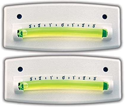

Alright, I admit it! I'm a crybaby when it comes to running any of my tractors on an incline. I'm terrified of tipping the machine on its side (or worse!). I know, fear is a good thing, but I get the heeby-jeebies whenever one of the rear wheels goes over a rock and the machine lifts up just a little on one side. On the 4600, if there's a little incline I'll often put down the stabilizers so if it does begin to tip, it will have something to rest on before it goes all the way over. Also, I'll turn the backoe over to the high side to add counter weight. Tires can be loaded, wheels weights added, and the wheels set for a wider track. All these things can, and should be done. But what about a way to measure how much the machine is leaning?
I find it odd that I have never seen any references to putting an inclinometer on the tractor dash. Has anybody done this? What about something like this? Amazon.com: Sun Company 201-F Lev-o-gage Inclinometer | USA-Made Level for Off-Road Vehicle, Jeep, Truck, RV, Camper, Trailer, or Boat: Industrial & Scientific
(I have no interest or involvement with promoting a product. I'm just asking.)
The problem is unless you know what the tipping point is this isn't going to do much good.
We had them on the Destroyer I served on and we knew what the point of no return was.
You have stabilizers so I suppose you could do some empirical testing to determine where the danger zone is, mark your gauge, and then do what's needed to mitigate the danger should you approach the line.
   / Terrified of tipping - how about an inclinometer? #74
I'd shop for one with a smaller range of measurement. A smaller measuring range would give you better accuracy within the range you will actually be working in.
The one shown goes to 45 degrees. At 45 degrees you had already tipped the tractor. I won't do 30 degrees of slope with my Ventrac-- even though it is rated for that. I'd bet you have a high pucker factor on your tractor even at 15 degrees.
15° is my personal "tipping point"! I go very slowly.

No 30 or 45 degree meters for me. If I get one, it will be more like this.
It would be useful for grading and leveling.
Bruce
