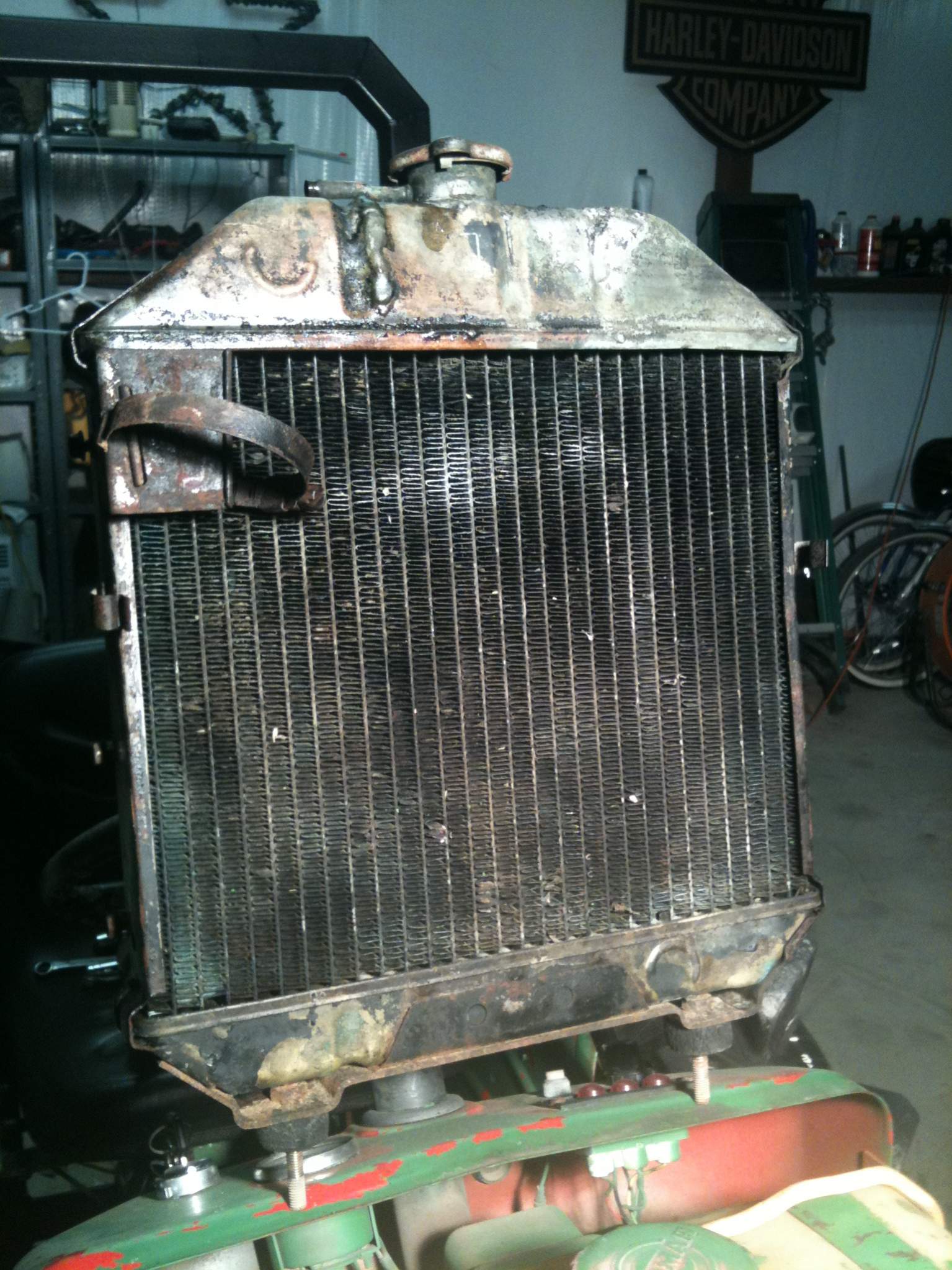

Radiator looks rough. I know it leaks a little bit around the top cap and it looks like it has been repaired a few times. I know a good little radiator shop nearby that takes good care of my family, but if they can't fix it and make it look decent I might just have to get a new one. I have seen them for about $250+.

If I were you I would spend the money on a new radiator and original-type sensor, and forget a new gauge and waterpump. The designers knew what they were doing. There's no need to modify it away from the original design.

That's my plan. I just ordered the new sensor and upper and lower radiator hoses. Hopefully in a couple weeks I can order a new radiator.
