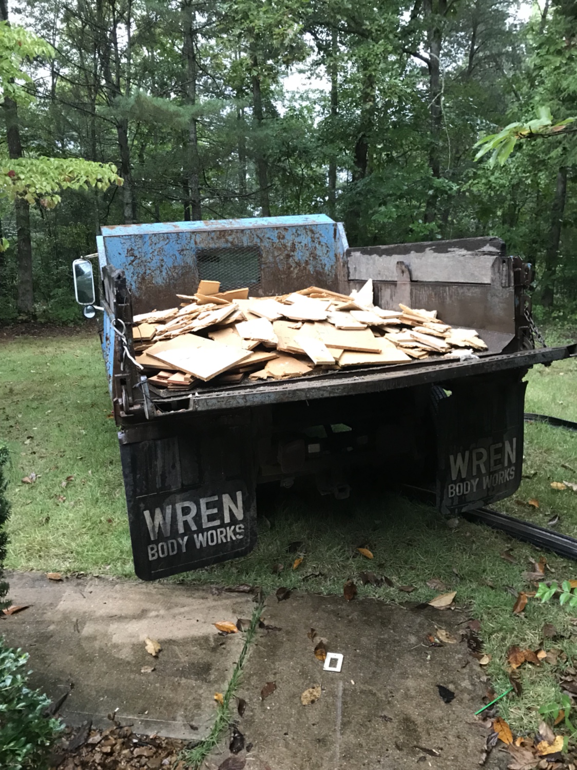

Agreed. Although I’d prefer a flatbed dump. My dump truck isn’t a beauty queen, but it’s the most useful truck I’ve ever had.IMG_0060.JPG Unloading this load of soggy particle board in the rain by hand would have really sucked.IMG_0132.JPG Dumping in this field stone would have destroyed a regular truck.IMG_4659.JPG And not having to unload anything by hand saves me a bunch of work.IMG_4657.JPGIMG_4658.JPGIMG_4660.JPG
