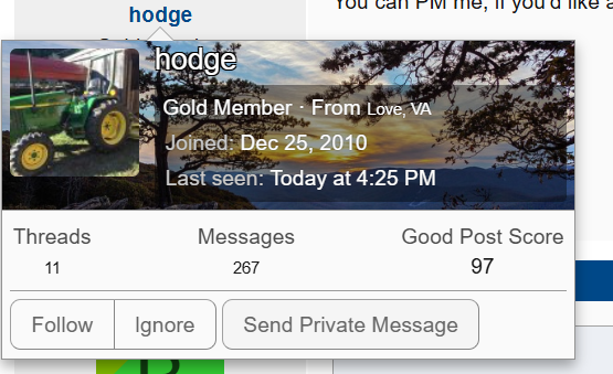

Could you provide me a quote? I’m not a techie. Not sure how to pm you.
/ Telescoping 3 point stabilizers for LS MT122 #6
Mouse over his username "hodge" then click on "Send Private Message".
