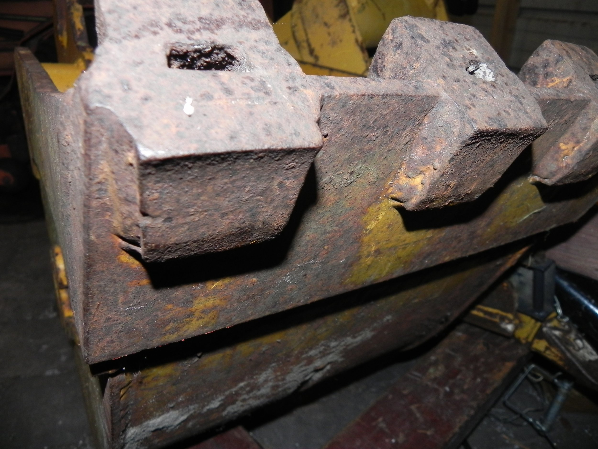

Greetings everyone. I recently acquired this bucket, and someone did me the displeasure of cutting off all the teeth. I do have several buckets, but as this is the smallest size I can use with the thumb installed, I would really like to have some teeth on this one. What are my options for adding teeth? I do have a hypertherm 65 plasma, but these might be too thick for even that. And cutting the end pair might be hard to remove without cutting through the side of the bucket. Open to any ideas other than buying a new bucket, or spending the rest of my life filing these down with a hand file.

Air carbon arc cutting is what I would do. You can remove the weld and pull the part out without damaging the bucket
I takes a little practice but it's easy and once you get good at it it moves quick

Call heavyquip and get some teeth. You're just missing the teeth. That part stays on the bucket. Teeth are replacement items.

It would appear that what you have is the mounts for replaceable teeth.
You should be able to find new teeth to fit those tooth mounts.

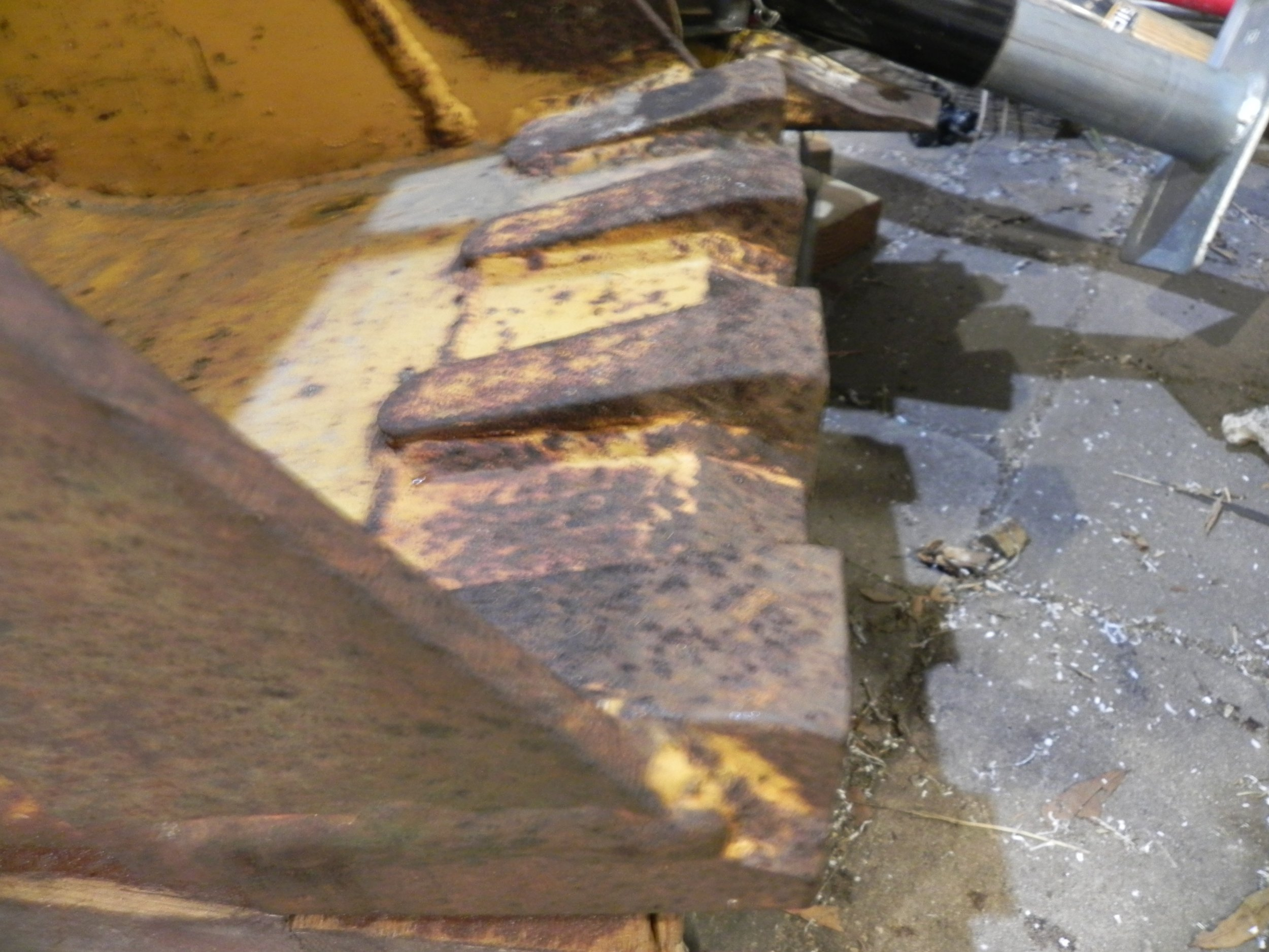

I’d cut the whole cutting edge off the bottom and replace it or if I didn’t want to go through that much work I’d just weld new teeth beside the old ones.

Common folk with old school tools and a bit of talent would use an oxy-acetylene torch to cut the old shanks off. Then stick weld new shanks on that accept the tooth style of your choice.

Your hypertherm plasma cutter can cleanly gouge out the welds of the old shanks with the right nozzle and settings. Check your manual or online. Rated removing pounds per hour so will not take long. Hypertherm has great customer service and will help you with information. They make flush cut and hyaccess nozzle consumables too. Then weld whatever shanks and teeth you want.

You need bucket teeth and shanks. You can prob cut the weld right at the bucket. Trying to save the cutting edge that's in the shank is going to take forever I think.
You could buy shanks and a section of cutting edge then just cut the whole edge off and start over.

NYONE has most of the correct answer, and you already have most of what's needed - if your Pm65 came with a scarfing tip, you're there. Once you've used a scarfing tip on a plasma you may never wanna use carbon arc again. Two main reasons: Quite a bit more "surgical" control, and no need to wear ear plugs AND muffs so you can still HEAR when you're done.
That was MY reaction the first time I used the scarfing tip on my PM45; yours is bigger, it's possible you could get enough weld out of the way to get what's left of the shanks off with a hammer and chisel, or an air hammer/chisel.
It's too bad your shanks (the part new teeth get pinned onto) got cut off, or you could do what I did on my 2' bucket - the previous owner had kept digging after teeth came off the shanks, so the old shanks would no longer support new teeth...
I went around each shank weld with a thin cutoff disk, watching carefully NOT to go deeper than the surface of the cutting edge of bucket - First, vertically using the side of the shank as a guide, then 90 degree cuts with the disk nearly parallel to the cutting edge surface - once that was done, I smacked each shank a couple times with an 8 lb. hammer and they popped right off. (This was BEFORE I got the plasma -)
Once those shanks were out of the way, it was fairly easy to grind the remaining weld beads down flush to the cutting edge. New shanks welded back on, new teeth pinned back on, done.
If I had that job to do over, and knowing how well the plaz works with a scarfing tip, it'd be a no-brainer... Steve

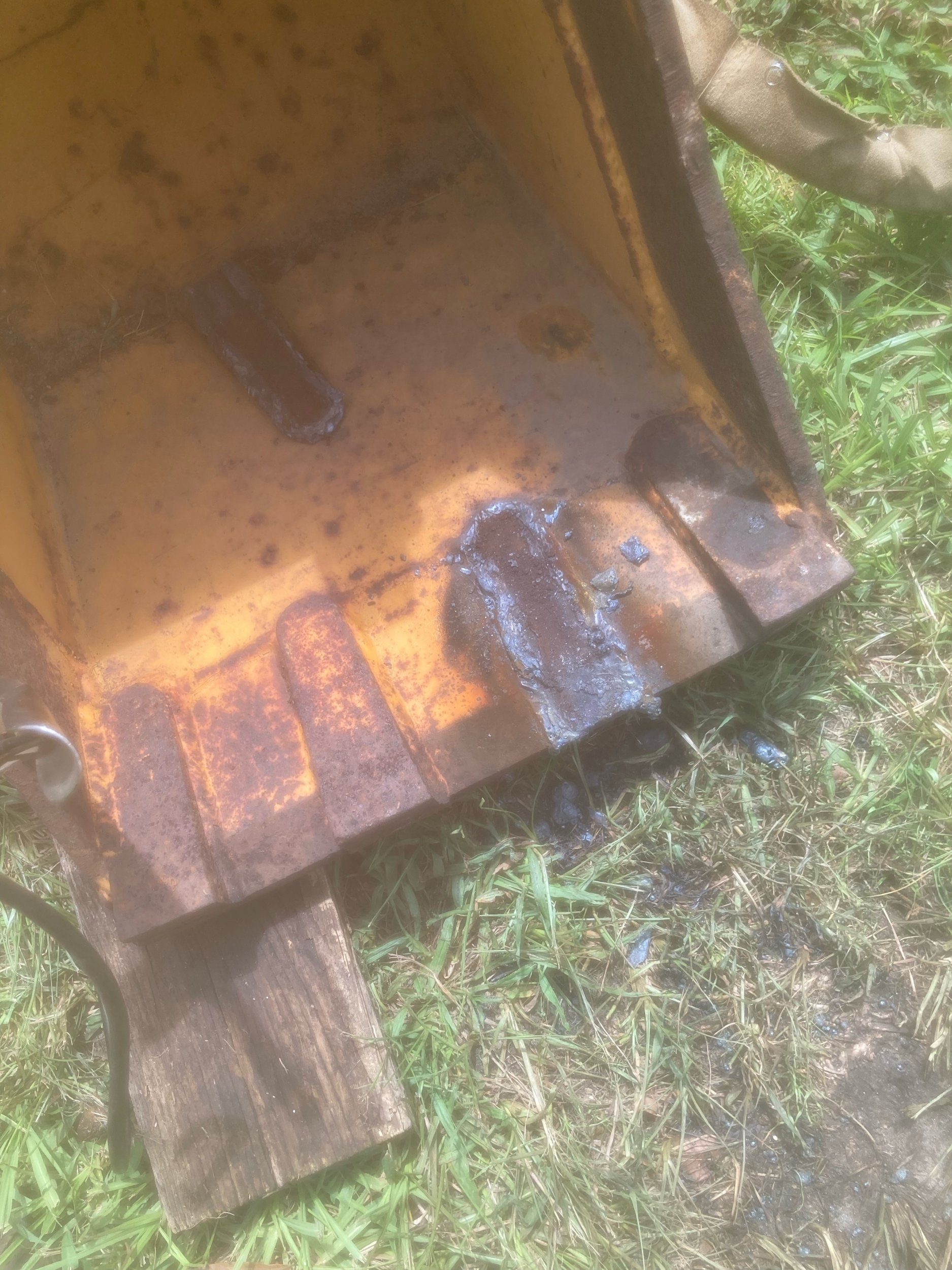

Any teeth would be better than no teeth, but they should be at the edge of the bucket, and leaving the 'stumps' would make it hard to cut through much of anything, so they really would have to go... but I did not think about removing the entire bottom edge, but thought that would be plan B.
Thank you to all who responded, I ended up removing all the pieces today.
I did not use a stop watch, but would guess a few hours. The center pair of the upper/inside came right off. The bottom four were harder, as I ended up having to use a cut off wheel to cut a grove just below the bucket lip/edge to give me somewhere to start the chisel. The upper/outside pair took as long, or longer than all else combined! A few neighbors thought I found religion, not because I was swearing 'Jesus', but when hitting the bucket sometimes it would ring like a church bell!

Was this all air-chisel work cutting the welds?
We need photos!

I would think that short of having the proper tools a grinder and a cutoff wheel would have made way faster and quieter work than chiseling then off.

I used my plasma, but it was tight getting the torch/handle in the bucket to shoot away. If I cut towards the bucket, the molten metal would just arc of the back of the bucket and land on my hand, or arm. A large 7/8 hand chisel and short handled sledge hammer split them apart/ off the main piece once most of the weld was gouged off. I only took one pic, sorry.
