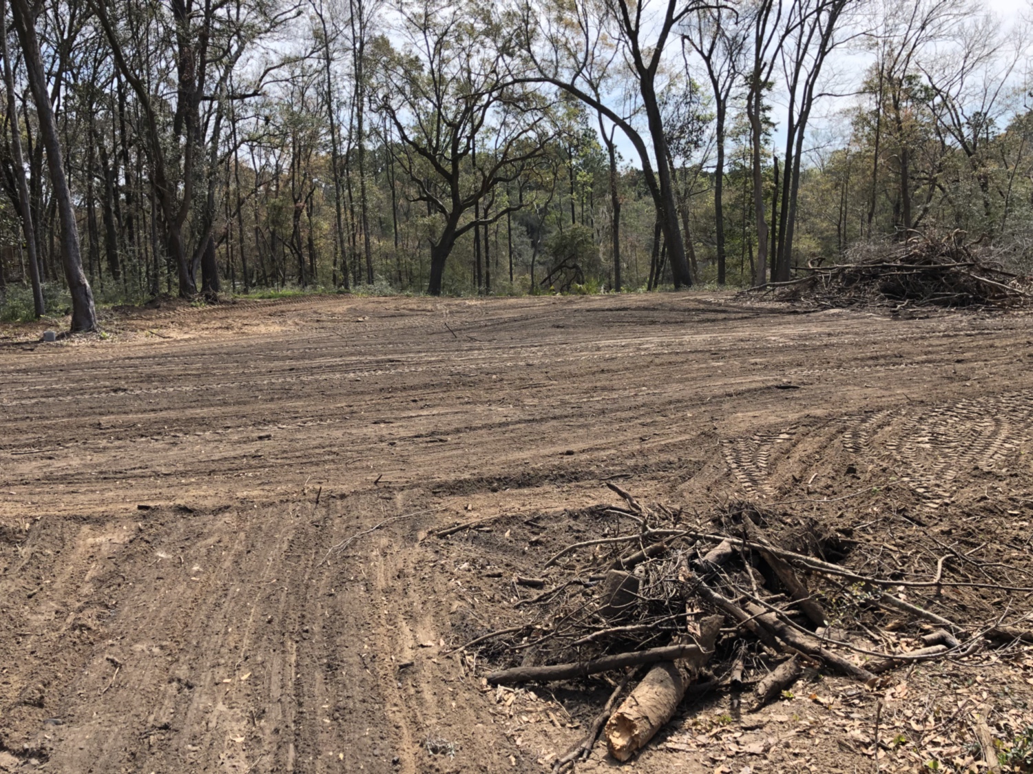

I've got the same question as the OP. I have about 3/4 acre to 'level'. Biggest elevation change in a 40x40 area is about 8" that I would want to make level. You can see it a little bit in the foreground of this picture. Want to know if a box blade is the best tool for this.IMG_4072.JPG
/ Techniques To Leveling Dirt #48
ssbogger - the land shown in your uploaded picture IS level. I would say that you could smooth it by dragging something behind your tractor. A pallet, set of old bed springs, a spread of old logging chains or probably the best - - a drag harrow.
To get the land pictured "more level" - you will need laser equipped equipment. Such as a Trimble Laser controlled agriculture grade equipment - $$$$$$.

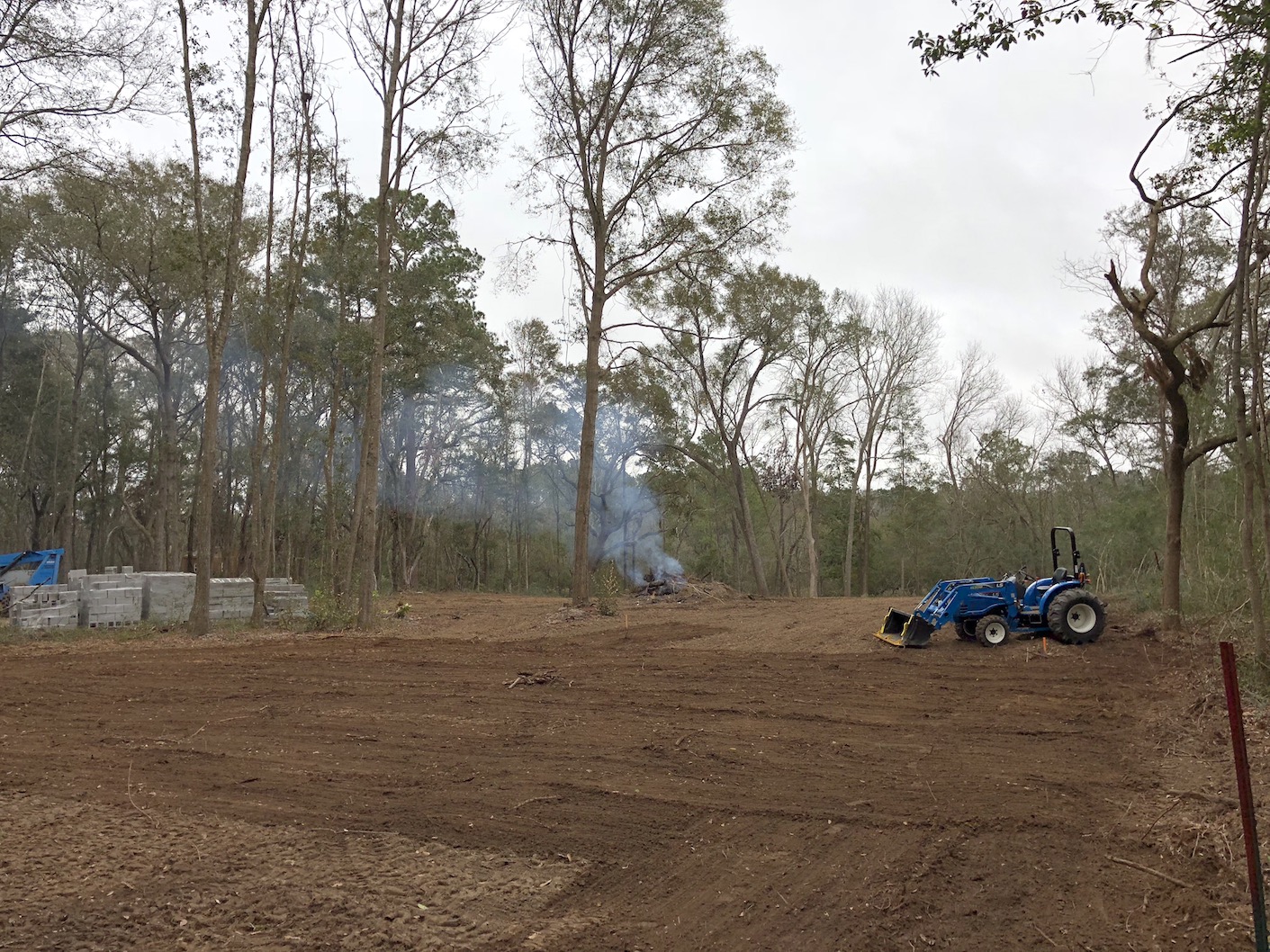

I’ll try to get a better picture. That part is not that bad, probably 3” elevation difference in a 40’ square. The area way back near the burn pile is worse.
Today I tried using my grapple going forward almost level and the back dragging at a little more angle and had decent results.

Got a box scraper. Watched a YouTube video from one of the fellas on this forum on how to set up a box blade. That had me moving dirt in no time. I’m very glad that I got this and not a land leveler. IMG_4326.JPGIMG_4327.JPG
