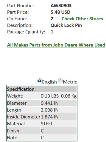

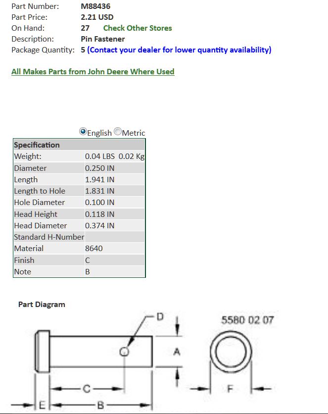

/ Tech Manual for JD 521 Loader #11
All I see listed in parts for attaching timing rod is parts key #5(M88436) and parts key #12B (AW30903) which appear to be easy straight forward R&R. Rod can be removed without cutting by removing attaching pins from mast & cylinders from holders(parts key #10). Could your bent timing rod be secured by "spring pins aka roll pins" instead of pins listed??
/ Tech Manual for JD 521 Loader #12
The rod is held into place by standard cotter pins... 1 on each end.... a flat head pin at about 1/4" diameter and 2 inches long with cotter pin at the end
The pins inside the rotational joint are the same diameter as the rod.... 1 inch diameter with similar cotter pins to hold in place on the outside of the arm... I'm guessing these shorter pins are probably 4-5 inches in length
The long rod might come out without cutting by driving one of the short pins in deeper and driving the bad rod into the other short pin on the other side and allow it to fall past its support hole... other than that, cutting might be faster...
