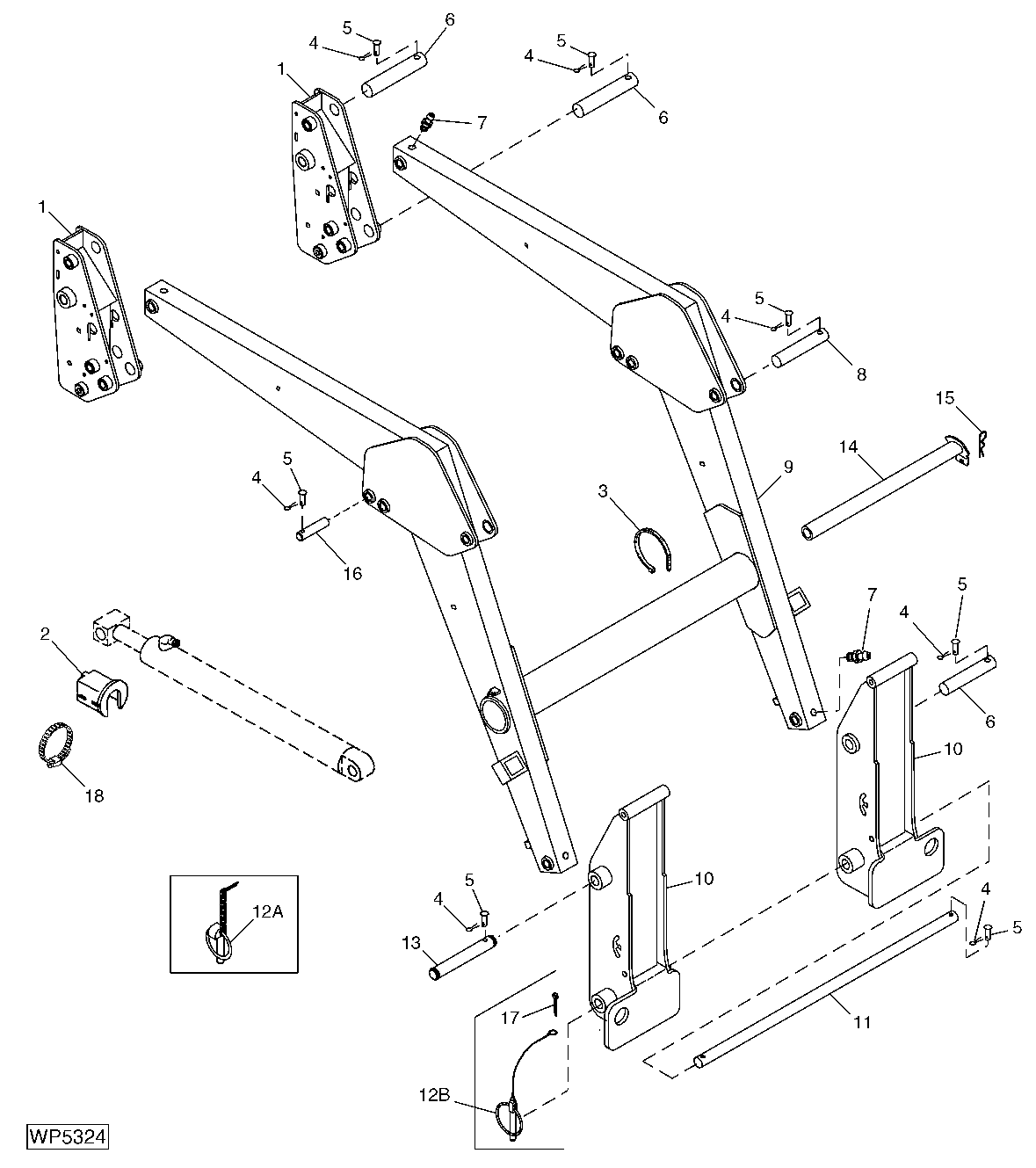

i am not the original requestor, but i have an issue with a 521 loader and not sure how to proceed
i managed to bend a support pipe that helps maintain the distance between the working arms of the loader. i ordered a new pipe from JD and it seemed a bit short to what i was expecting.
the pipe only goes between the 2 arms, and does not go thru the 2 arms as i would have expected. i am guessing there are short pins inside the rotating arms that need to driven out so the new pipe can be inserted.
i am not totally sure of the correct procedure without having a diagram of what is actually inside the joint and do not want to cut the pipe to get it out and start driving parts out without a bit more knowledge.
at this point the entire unit is still stable and usable, so i do not need to do this in a hurry, but i will be doing a bunch of tree removal shortly and using the front end loader forks a lot and would rather have everything in perfect order before starting this project

Is item 11 what you bought, need to replace?
yes, #11 is what i bought and based on sight, i thought the pin went through both arms.
closer inspection today, it's obvious there are separate pins on each end that hold the arms in place.
i just wasn't sure what the proper technique to use in replacing the bent section.
logically it would appear that i must cut the pipe and then drive out the short pin on 1 side and slide the #11 pin through the arm and re-insert the old shorter pin.
for some reason this shorter pin setup is not shown in the diagram, or any other diagram i found of the same part display.

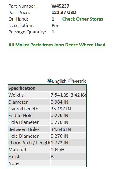

Technically all rod(parts key #11) is intended for is to time both attaching brackets when changing attachments such as bucket or pallet forks. Here's the part spec's if you want to check to be sure you have the correct part.
The drawing shows 11 as the only part, but separate pins would be more logical. If you have separate pins you should have four retaining pins (number 5). One for each end pin and two for number 11. Does yours have four retaining pins?
I would NOT cut the center bar. I would remove both end pins, then the bent bar. I would have the bent bar straightened.
/ Tech Manual for JD 521 Loader #10
The pins in the end look like #6 and #13. The number of retaining pins is not the relevant issue. What I thought I had was a single 1 inch diameter pin, when in fact i have 3 1 inch diameter pins, 1 long and 2 shorts
I have the correct center part , and its in my hands.
I HAVE to cut the center bar. That is why it's being replaced. It has a severe wiggle in it, and therefore there is no way its going to go through the mounting holes in the arms. Also, the end pins cannot be pulled out, they must be pushed out from the inside, so the center bar MUST go. I expect that this part probably rarely gets replaced as it is fairly protected, but during a clean up of heavy tree limbs, something got in there and bent things up.
I just thought someone might have taken this area of a front end loader apart before and knew what to expect when I pop one of those shortie pins out. Not sure if lining all the parts back up will be a major issue. Do all the parts need some sort of support so heavy items don't go flying?
I guess I will move forward with what makes sense and just cut and pop pins and see about making it all look pretty again. I am also surprised that after charging a fortune for a piece of pipe with 2 holes in it that JD didn't even paint it JD green. They just left it unpainted

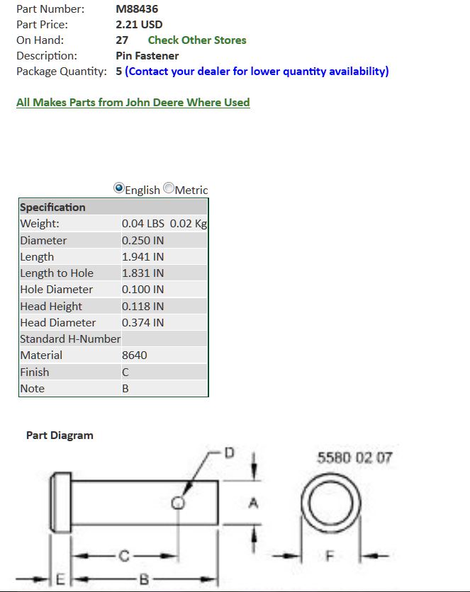

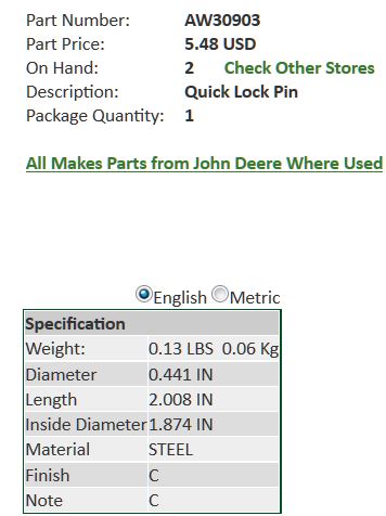

All I see listed in parts for attaching timing rod is parts key #5(M88436) and parts key #12B (AW30903) which appear to be easy straight forward R&R. Rod can be removed without cutting by removing attaching pins from mast & cylinders from holders(parts key #10). Could your bent timing rod be secured by "spring pins aka roll pins" instead of pins listed??

The rod is held into place by standard cotter pins... 1 on each end.... a flat head pin at about 1/4" diameter and 2 inches long with cotter pin at the end
The pins inside the rotational joint are the same diameter as the rod.... 1 inch diameter with similar cotter pins to hold in place on the outside of the arm... I'm guessing these shorter pins are probably 4-5 inches in length
The long rod might come out without cutting by driving one of the short pins in deeper and driving the bad rod into the other short pin on the other side and allow it to fall past its support hole... other than that, cutting might be faster...

It is the timing rod-a bar that extends between the loader quick attach brackets. It is JD part #W45237.
