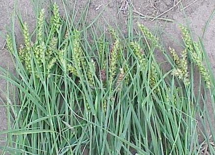

Depending on the season and what's growing and what's not, with my RH discharge mowers I sometimes do the first few rounds CW to prevent discharging Sandburs into flower beds, on the walk, into the house etc.
