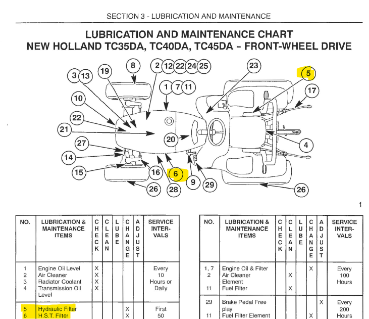

I have a 2000 model TC33D with busted HST elbows. When the factory rubber hose elbows burst 15 years ago, I knew nothing about NH's fix, so I bought two brass 1/2" elbow fittings and used reinforced fuel line. That repair has lasted 15 years. I live in Texas and don't really use the tractor in the winter.
Recently, one of the hoses burst, and I repeated the repair. After 2 hours it burst again, this time obviously from high pressure. I think I should also replace the HST filter inside the R rear wheel with the improved one you mentioned. Does anyone know the part number?
Thx.
/ TC33DA leaking hydraulic oil #39
For the TC 35, 40 & 45 the hydrostatic filter is on the left side kinda by the starter. This is a higher pressure filter so don’t just by an oil filter.
The hydraulic filter is bigger and by the right rear tire.
