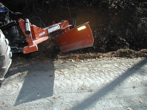

Buckee, Congratulations on the tractor. I recently purchased a TC40DA which I am really enjoying. I have a box scraper and a rear blade and so far have found the blade to be better for grading my gravel road. As you pointed out the blade is better able to pull material from the edge of the road to the center. Also my blade offsets and this has been super for getting into the ditches while keeping the tractor on the solid part of the road. The blade was expensive but for my needs I think it was well worth it. I have included a picture of me cleaning the ditch with the blade offset, tipped and angled. With top and tilt it is even easier to make adjustments.
Good luck and enjoy your seat time. By the way my boys have both taken safe rides on the tractor with me.

I think you'll find the rear blade essential. One with tilt however doesn't seem necessary as most of what you need to do as far as tilting can be done manually with the tractor's three point. Hydraulic tilt is a nicety that can sometimes speed up the work but seldom essential. The ability to offset is a real great feature, but not found on many blades today. If you're really planning on pulling in with the blade, and can't get the tractor that far out because of the ditches, then it becomes essential. Otherwise, most of the time you'll just angle the blade to pull either left or right.
