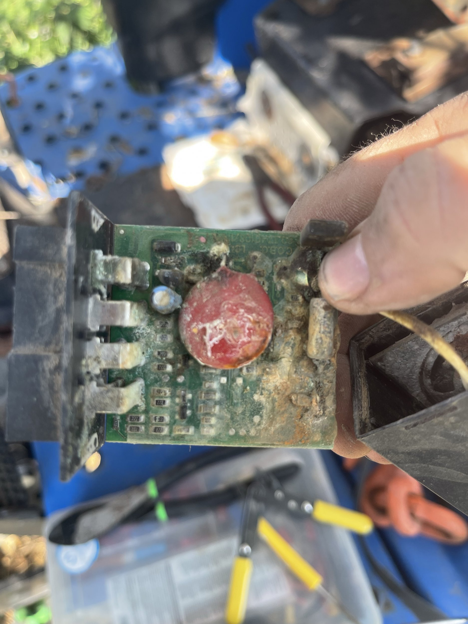

Back at it again . Found this under the steering column.

Sorry I never got around to updating! Honey Do took priority. Finally got around to working on this today. I did replace the ignition with the NAPA (y) Still wouldn't start! Next I went to the fuse holder...I do not have my original Owners manual but I've got one from Messicks.It shows the first three fuses to be 7.5 (top to bottom) then no fuse in the next two positions then a 20 amp and that it? I know originally all or most of the fuse positions had a fuse. Looked on line and found this View attachment 768518
Replaced all fuses with the correct amperage and bam! she lit right up It appears all is good for now. I would ask if someone could please list the actual shot of the the fuse box or at least a top to bottom listing of fuse order. Thanks all for the replies.

Oh my, looks like you have some rodent friends trying to help you with your electrical conductivity.

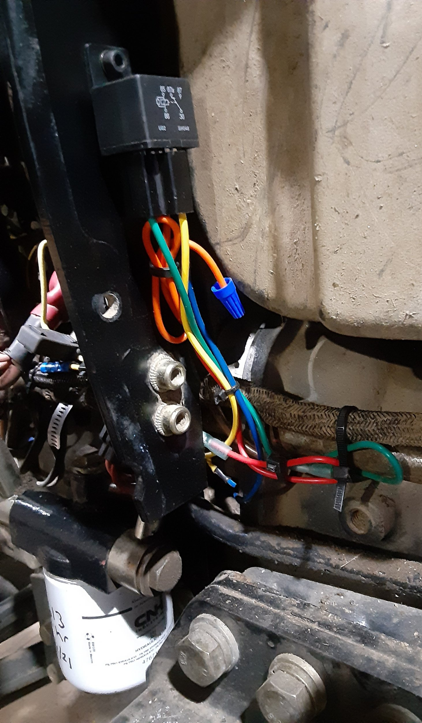

Almost got it all rewired . De pinned and pretty much re built the harness.

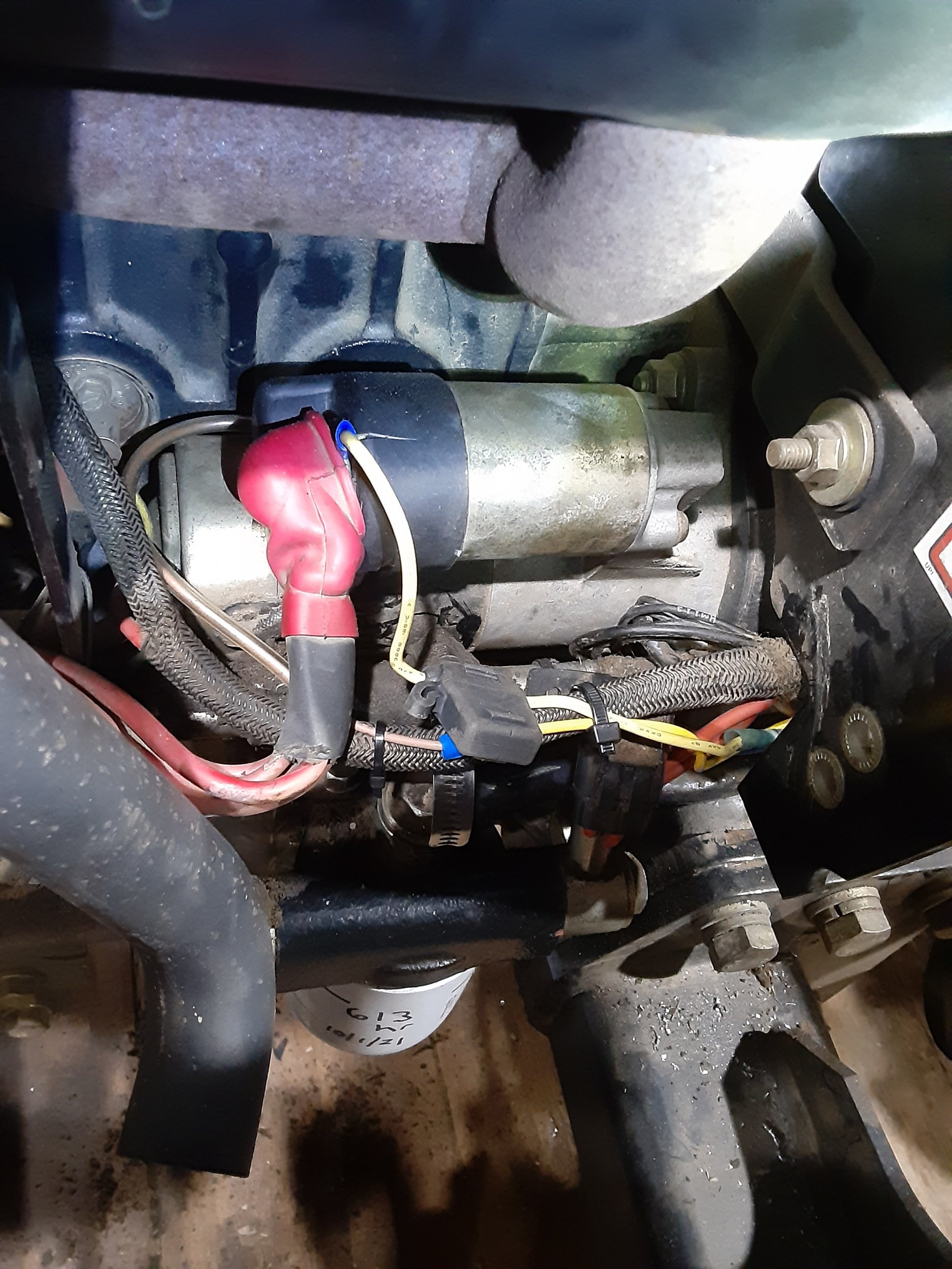

Update as promised:
I installed the Dedicated Starting Relay modification. The tractor started right up. But it ran only for 12 minutes (2/10 hr) and then died. Would not start after that. Would not even crank (heard clicking but it did not turn over).
Have good voltage at battery and at Starter (12.5+). I also checked voltage while it was running, had 14.5+.
I now suspect the Fuel Shutoff Solenoid. Will test today or tomorrow and possibly replace that.
I also suspect I have a short somewhere.
Reason for suspicion: I have continuity between the battery positive and engine ground (with battery negative disconnected). Am I wrong to believe this is NOT correct? Doesn’t this mean I have a short somewhere? Does anyone have a script or directions as to how to find a short on a TC30?

@Papasmirf (post 11/21/13): I know it has been 10 years ago since your post, but I would sure like to know just where you found that “small ignition relay“. I have a 2004 TC 40 DA that I have searched pretty much anything and everything electrical on and it has been weeks but all it does is click, when you turn it to “on“ and there’s nothing when you turn it over to start.
I have a 2007 TC30 that did the same. After a 1/2 day of searching I found a small relay that is for the starter start circuit. I replaced it...all ok now
