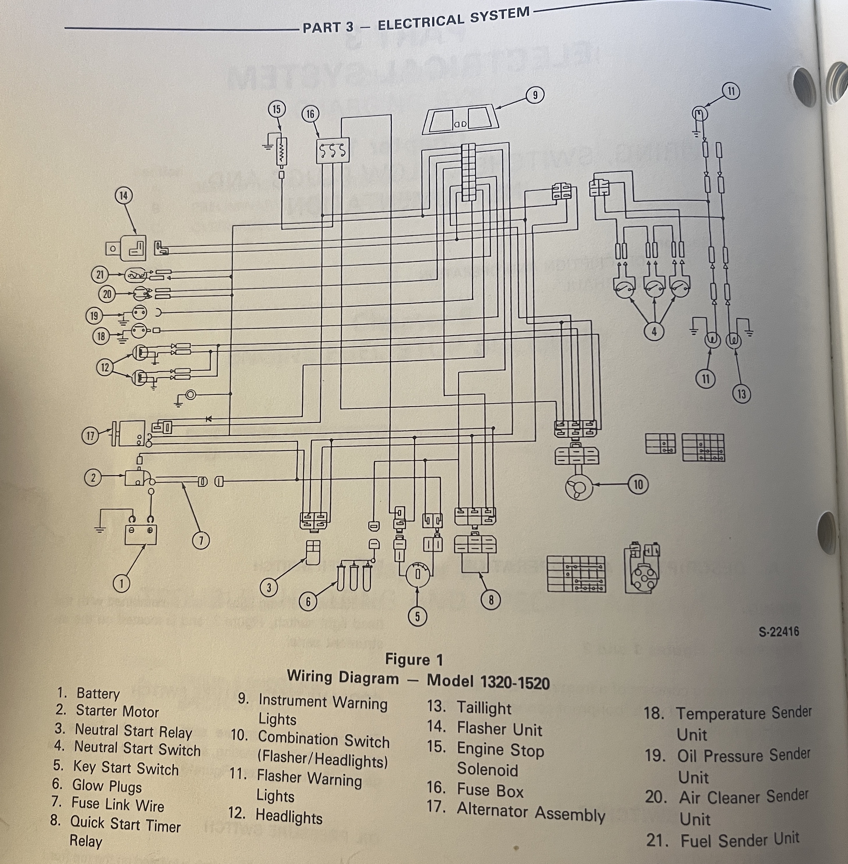

I have a 1995 model 1520 I've owned since new. A year ago I also bought a used T1520 (both are hydrostat) which I've learned has the safety controller (the 1520 does not have a safety controller). Previous owners of my T1520 had disconnected the beeper and jumpered the seat safety switch and the parking brake switch. I have also jumpered the H-M-L transmission neutral safety switch and all seems to work fine for now and the T1520 now operates the same as my older 1520, which is fine with me (push clutch pedal with both pto's disengaged to start).
Regarding the safety controller and its high replacement cost, after looking at the tractors and the wiring diagrams for each, it look to me as though its a fairly easy job to eliminate the safety controller by adding a glow plug light timer and doing a little re-wiring. The safety switches and relays all look to be the same parts as on my 1520. Note: that some safety features introduced since 1995 would be eliminated (i.e. seat switch & beeper) while others (i.e. neutral & parking brakes switches) could be eliminated or kept as desired. Currently, a glow plug light timer can be bought on Amazon for $20-$40.
This will be my plan should my T1520's safety controller ever require replacing. Wiring diagrams attached.
