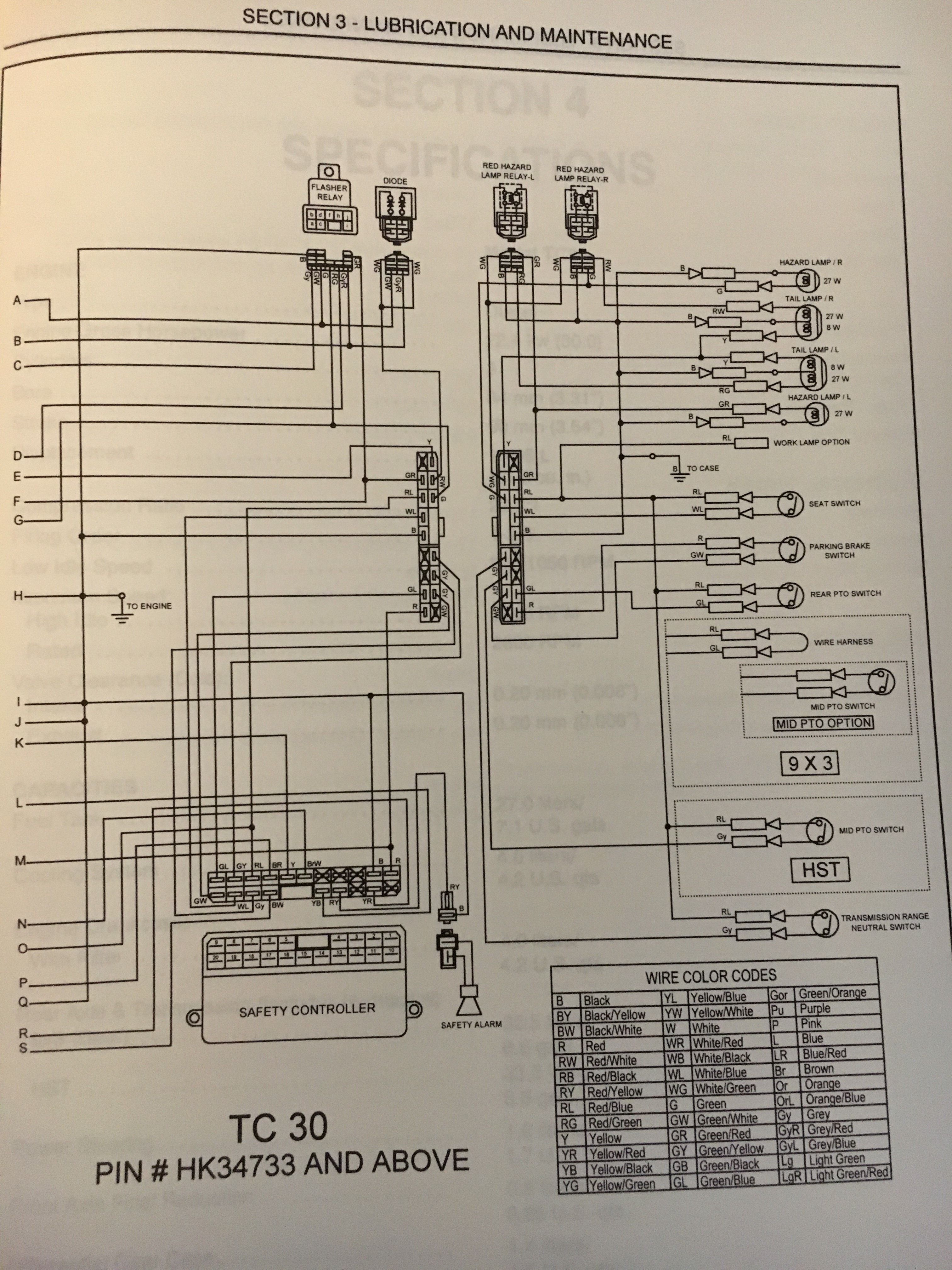

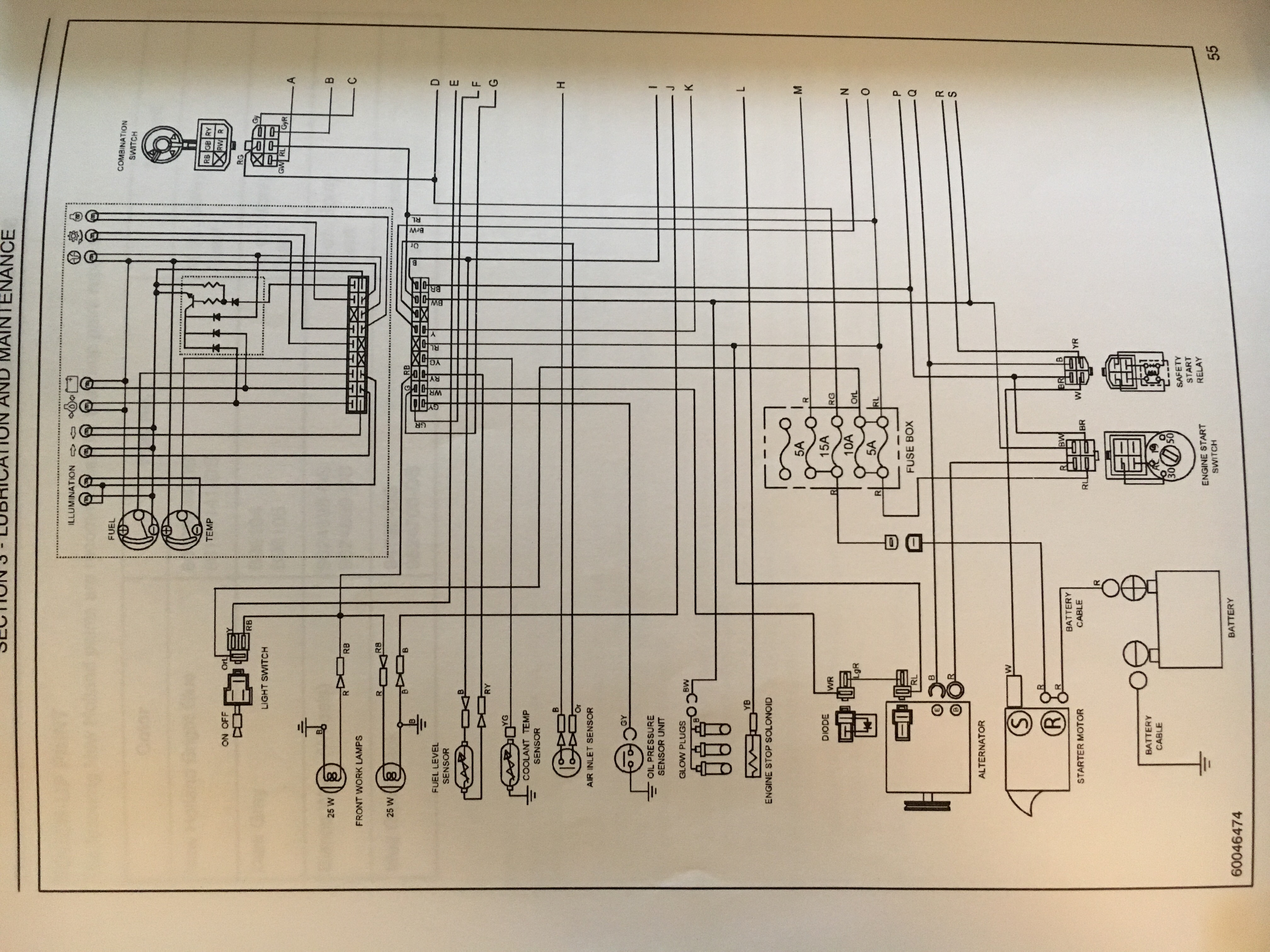

Schematics here
   / TC30 Won't turn over - Do I need a new Safety Controller? Big Bucks :-( #12
The Schematics are pretty useless other than showing external wiring connection. The controller is nothing more than digital logic (and gates, or gates, etc.) but the the manufacturers typically don't show this "secret" infotmation, not that it would help you very much. The whole controller must be replaced if it's broke. Digital controllers are much cheaper to manufacture than the older relay combination logic and have much greater profit margins when selling the replacement parts.
   / TC30 Won't turn over - Do I need a new Safety Controller? Big Bucks :-( #13
I was actually more interested in what circuits IT lookes at, vs looking at IT's circuits.
In any event.. it see,s it's a repair by replacement issue at this point.

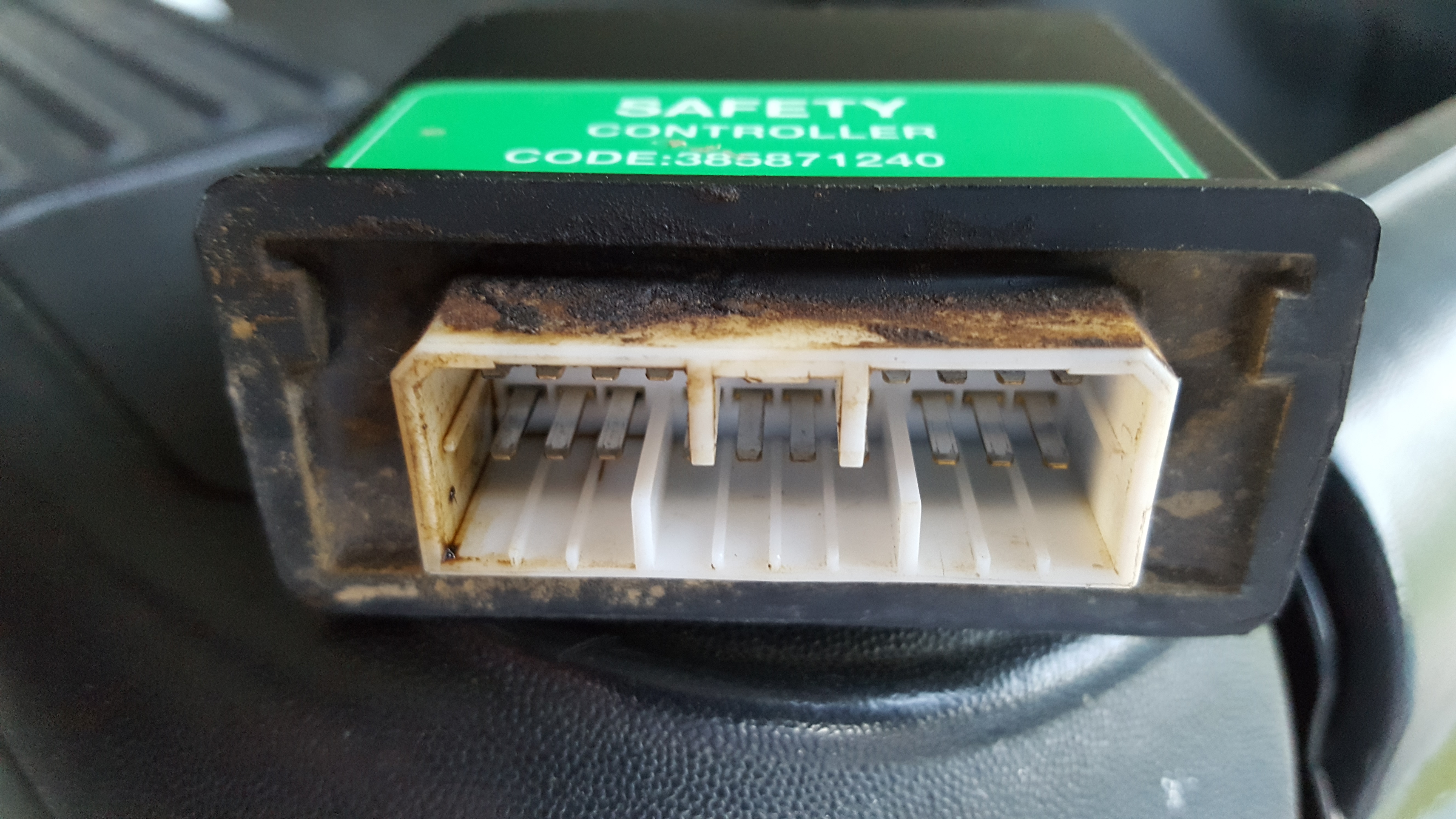

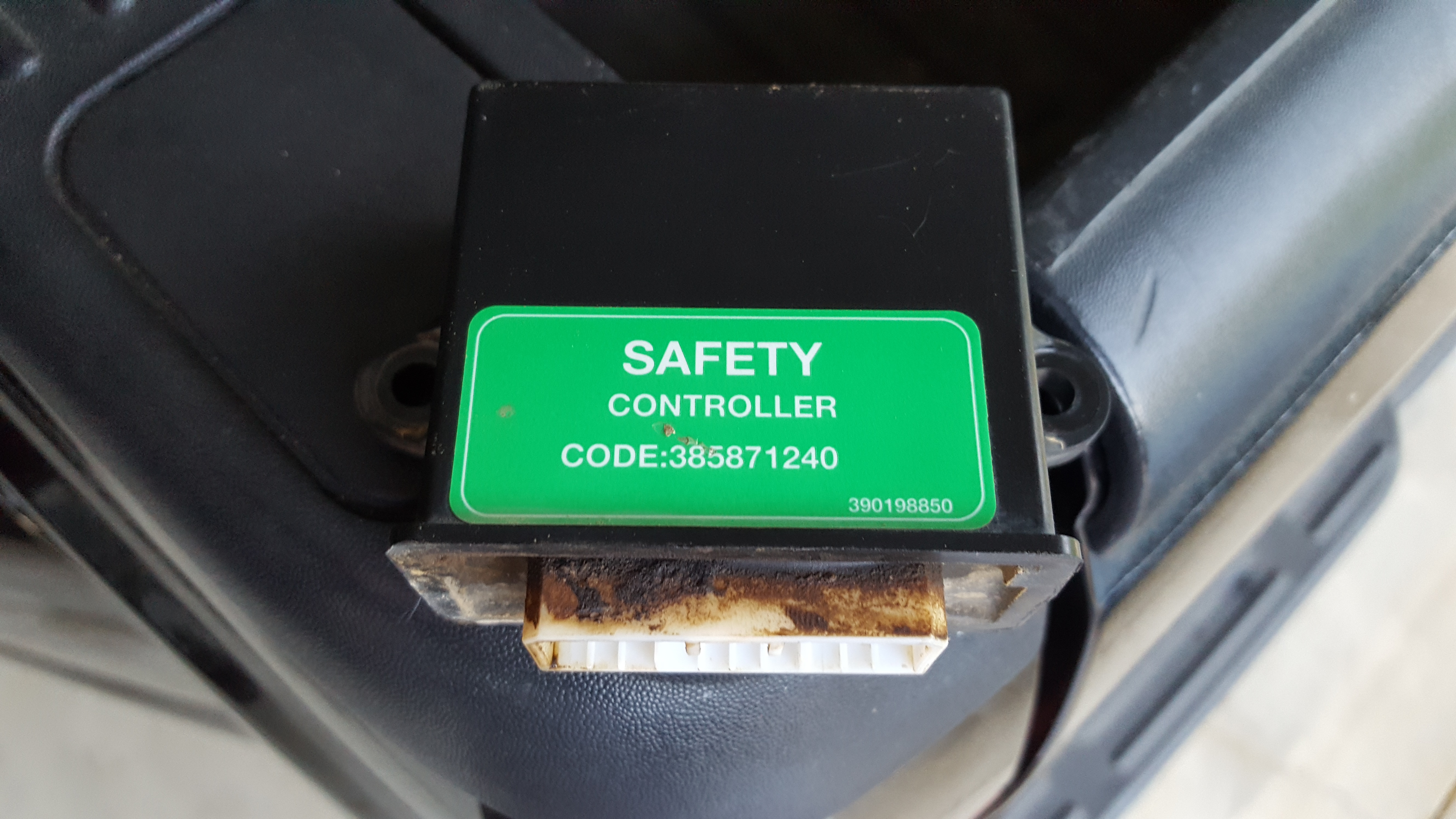

I'll let you know Friday if my $368 investment works. Mine smoked and smelled like a rancid carfire. I too wonder what made it go bad as all of my safety switches are bypassed.1496208349949.jpg1496208367559.jpg1496208385501.jpg

good luck. most likely, it sounds like an internal failure..

I replaced the safely controller on mine and it fixed the problem.
