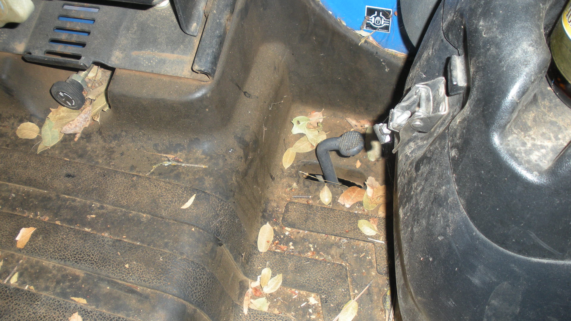

Hi Roy-I read the manual and it says step on the pedal. There is no pedal. It has what looks like a lever that needs to be pulled. Even the picture in the manual does not show a pedal. I am going to call the dealer and ask if no one here has experienced the same confusion
Nothing wrong with getting some clarification from the dealer...sometimes manuals are written for folks with a degree of experience. When one is a novice, better to ask for help then make a mistake.
While you're talking to the dealer, ask him about his advice on using the differential lock...

For what it's worth. A couple weeks ago I was trying to back up and my rear wheel started to spin and I did try pulling/twisting moving that "pedal" and didn't see any difference. After that I found the picture of it in the manual and you are right there is not a lot of explaination about it. So the next time my wheel started to spin I stepped on it to see if I could tell any difference and didn't notice any. Maybe I didn't get it engaged right. I guess I need to play with it some more so I can see for sure. Anyway, please let me know what the dealer says.

the "pedal" on my old kubota and on this NH TC40 was more a little metal lever sticking out...

On my 4400, it is a pedal. The old 670 and 790, it was a rod sticking out of the panel just below the operator's seat.
   / TC30 Keep it in 4WD? #25
Yup. the old Kub-B8200, and this TC40 have the rod sticking out, although it has a squished area to make it an extra 1/8" wider :D
On left side of platform(as sitting on the seat)...

Hey Ed; the T-handle looking thingie is a pedal!!! :confused2: Yup, he said you step on it to lock the differential. :thumbsup:Then you can take your foot off of it. When you stop, it "should" dissengage automatically. He said don't keep it locked for very long and if I could avoid turning that would be best since it is almost impossible to turn when both rear wheels are moving at the same speed (unless they are slipping).:cool:
