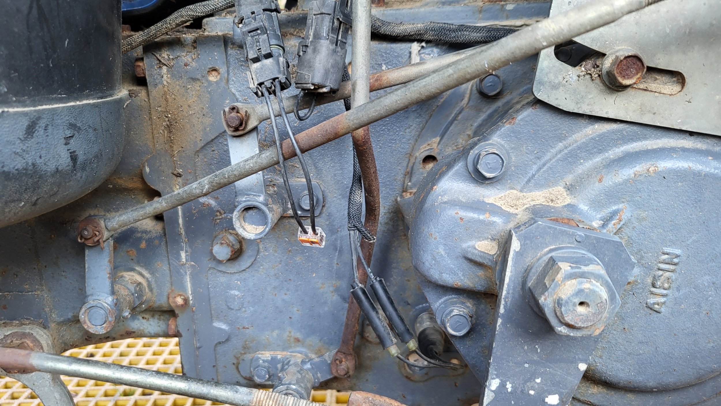

I have a TC25 I am working on for a buddy. My tractor is a Kubota, so I am not familiar with this tractor. He started it and got it off the trailer, but by the time he got it to the garage a wire had broken on a safety switch, for range, and it would no longer turn over. Wire broke right where it goes into the switch body. I found that the switch in question costs over 100 bucks so, for now, I bypassed it by connecting the wires for it together. Engine still will not turn over, so I am looking for the rest of the safety switches. I know about the PTO switch, but are there any others, such as on the gear box, clutch, brake, etc.?
I have checked and found all fuses along the right side of the firewall are OK. I do not know if there are fuses anywhere else besides the one beside the starter, in the harness.
Thanks,
Chris

Behind LR wheel....mid pto switch, gear range switch, rear pto switch.
/ TC25 Safety Switches?
I am not getting power to the switches on the left side. I'm guessing that the mid PTO switch is the one factory bypassed, since I don't have one of those. Mid-PTO seems to be the last one in the line, since it goes straight to ground from the connector. Haven't pulled the harness sheath apart to find out which is the first one in the line yet. Trying to avoid that, if possible. All fuses one right side of firewall have been checked again, and are fine.
Starts and runs fine if I bypass the starter circuit with a remote starter switch, so the fuel solenoid is working fine.
Anyone got a wiring diagram?

I have grounded the circuit already, at the PTO wire, which is first in line, per the schematic. That all seems good. Now back around the the start relay, which seems to have no power at all. Just purchased the service manual and am studying that for additional info.

It's looking like the ignition switch is bad. When you go to start positions, one of two terminals that are supposed to be hot, are not. The one that's not is the purple wire going to the start relay. I jumped the dead terminal on the back of the ignition switch and the tractor started right up.
The problem now is the weird series of diodes that appear to feed back into the circuit so as to power the glow plugs, but on this tractor it is exactly opposite, in that the glow plug circuit is getting power directly from the switch but the purple wire may get power when fed back through a diode. It's quite confusing because some of the wire colors don't match either.
It's almost like this tractor was supposed to have a glow plug timer and they did some rigging the eliminate that and drive them directly from the ignition switch.
