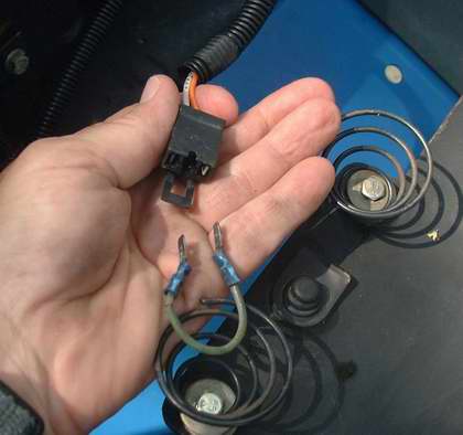

Jeff, earlier you mentioned cutting the wires off the seat switch and jumpering them together. I have a different solution. Disconnect the seat switch as shown in the photo below and jumper using two spade connectors on the ends of a wire. Then set the wire out of the way. If you ever want to hook it back up, just pull the jumper and plug it in. That's a whole better way of doing the seat jumper than cutting the wires since cutting is a permanent thing.

Thanks for all your help Jim. The #2 fuse was blown. A simple 7.5 fuse has shut me down for about 4 days. So glad I didn't have the dealer come pick the tractor up. Mowed all day and can now get the garden out! Appreciate the pics on the safety switch. That's a better idea!

Awesome! I'm glad I could help.:thumbsup: What I and others have done is to replace that fuse with a self-resetting circuit breaker. I would suggest a 10-amp CB instead of the 8-amp. NAPA's part number is: NAPA part # BK 7823120 , $6.49 each, but several other auto parts stores carry them now. It can save you from being stuck if the fuse blows and you don't have a replacement. The CBs are the same size as a fuse and have legs you can break off so their length will fit exactly as the fuse would.
They look like this below:
