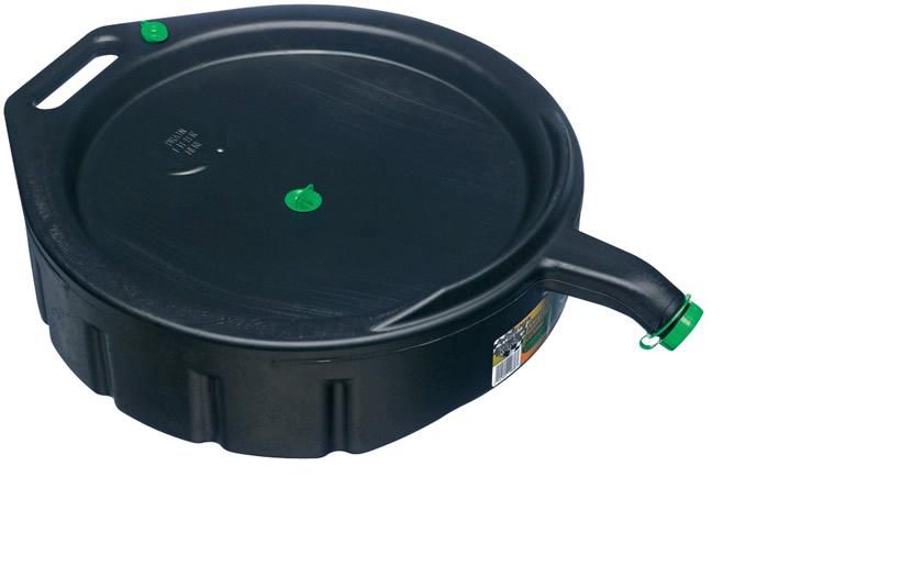

Nice.. I have two new cement mixing pans I can use and as Pony stated some sort of drain hose so I can pinch if off while I rotate.. ;)

It would not be hard to put a ball valve into your drain line so you can switch containers without making a mess. There will be some mess slipping the hose over the drain. That will be less if the valve is open when you slip it over (obviously with the end in the container). Another option would be to siphon the oil out until you get to the last few gallons, raising the outlet each time you switch containers. The negative is you will likely leave more gunk behind unless you use the end of the hose to scrape along the bottom as you siphon. You could also use a pump to drain it.

With a tube, it isn't hard; you just lift the end above the tank. I put a drain pan down when I first backed the plug out to catch the drips before I could stuff the drain hose on. You won't lose too much. Wear nitrile gloves, and you can put a thumb over the end as you move from container to container. I confess I used a small drill power pump to speed it up, but it went pretty quickly with out it.
If you are thinking of a big container, make sure that it will fit under the drain plug...

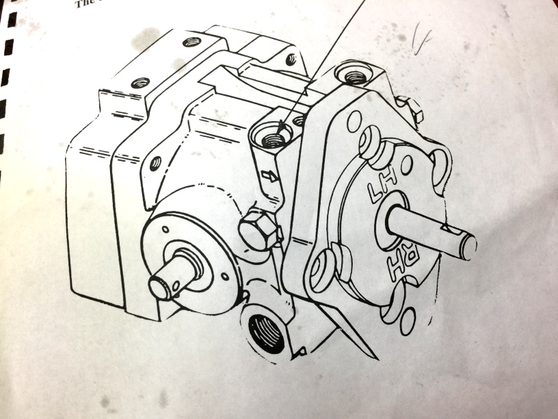

I did the oil change out today thought I would be done, go figure. When I bought the machine the guy had a hose in the box.. I figured it was the air bleeder hose .
Guessing from the large fittings it was a by pass hose you need when moving the machine so you don't damage the pumps.. Guess I'll have to wait until this week call Terry and order a bleeder hose to finish the job.. Bought this little drill pump but it was so slow I just went ahead and removed the hex plug.
Turns out the oil didn't have sludge like I first thought. Turns out it was pretty clean with the exception of I did see some tiny metal specs .. They may have been break in metal from the new drill pump. Thanks for everyone's advice and help. Now on to Synthetic oil change for the Kolher engine. :cool:

One thought, on re-priming the pump afterwards, if you took a air nozzle like you would use to blow off dust and wrapped it in the shop rag or some plastic, you could stick it in the fill hole and slightly pressurize the oil tank to help prime the pump faster.

Yeah I should have been more clear in my description ... Appears this is my bleed port and has a threaded nipple.. I have not taken the cap off yet .. Your thoughts do you see any reason why I can't just thread a section of gas hose onto the nipple here to bleed the air out and back into the tank instead of ordering a hose from Power Trac ... May even use a hose clamp ..

I would think any hose that makes an air tight & secure seal will do the trick. Could probably get a hose made at NAPA store too, save on shipping from Tazewell unless you need other things?
/ Tank Oil Change #59
The only reason I have fittings on both ends of my bleeder hose is that it doubles as my tow hose. If I didn't need a tow hose, I'd have just kept the factory-supplied bleeder hose that had just one fitting on one end, and a cut off hose on the other.
As mentioned, I guess when bleeding is you just want an air-tight connection where the hose meets the bleed port, and a hose that's long enough to get the other end submerged in the tank oil.
