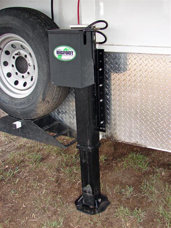

   / Tandom trailer blowout #26
I keep one of these trailer aids in my truck. Works great with my horse and flatbed dual axle trailers. Lot simpler than another jack.
Here is the best place to store it, right under the spare!

nice setup! what's the weight rating?

Just be careful using a ramp. I have seen it bend a spindle on the good axle due to overloading. It was so bent we could not get the rear bearing off. Had to cut it off then load the trailer on my GN and take it to a fab shop to have the spindle cut off the axle tube and a new one welded in.
