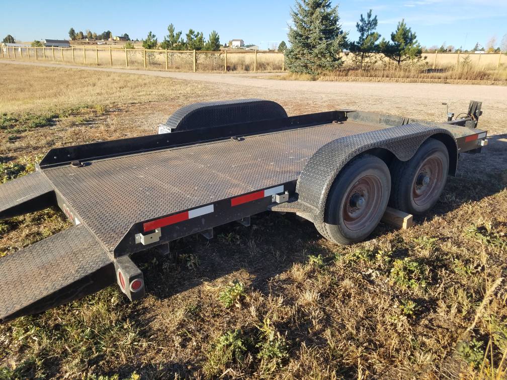

I figure the HH trailer (or equivalent) can do all of the above. I do like the swivel D-rings, the extra stake pockets, and the aluminum deck. It does seem to have a Torsion Axle setup, which, from what I gather, is lower-maintenance and more corrosion resistant (which is good since the trailer is more for occasional use and will live outside). Based on the design, it also looks like I won't have much trouble finding a WDH that will work with it, which I think i should still have for the heavier loads, and is light enough that my brother can use it w/ his SUV if he needs to (staying within his limits, of course).

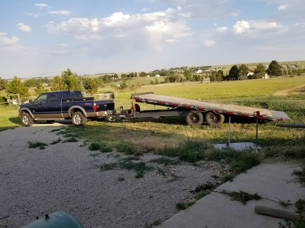

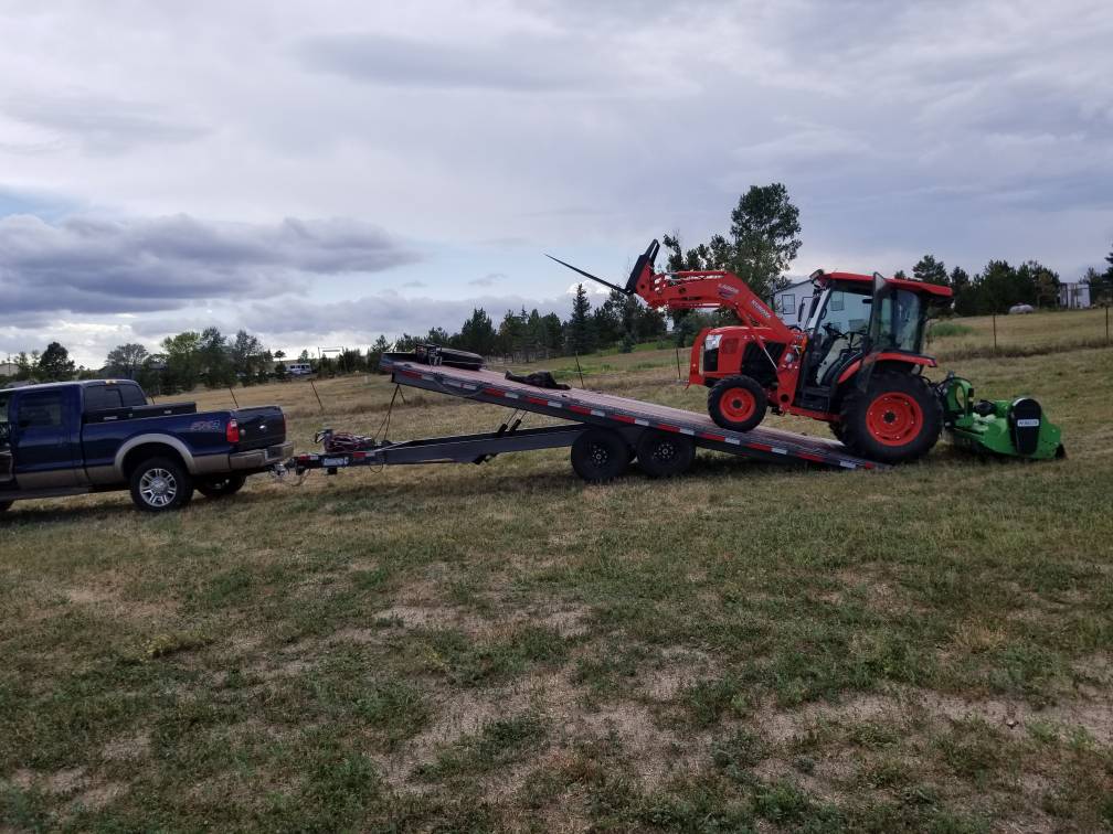

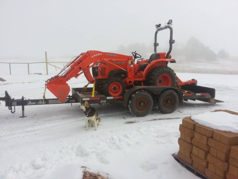

I would suggest a deck over more like whats shown in post #14. My list of reasons for having a trailer is the same as yours, and my trailer is about like what you posted there. It turns out (for me anyway) that the frequency of use is MUCH higher in the column you titled "2" than anything else. I find the fenders a big inconvenience almost all the time. I wish I had bought a deck over, almost all the time. You can load 1 or 2 pallets on it, that's it. Then a forklift/tractor is out positions from which it can approach the trailer because of the fenders. I would not buy this style of trailer as my only trailer. Lesson learned. If you can have only one, make it a deck over.
