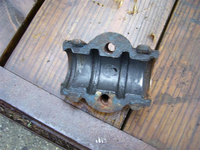

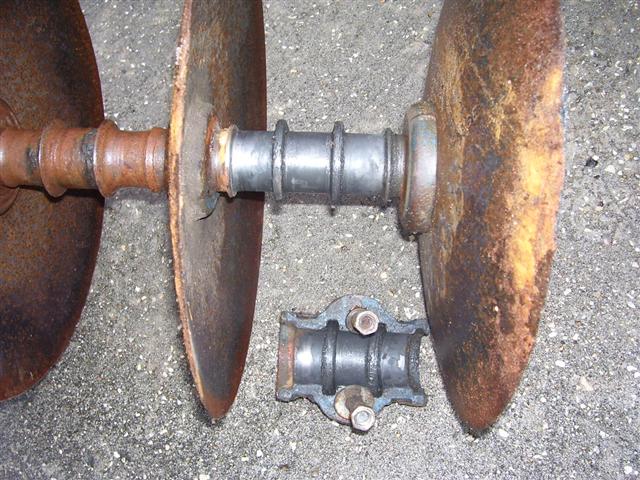

Speaking of discs and grey iron bearings.. who remembers wood bearing halves?

I've got about 50% of a 6' Ford disc laying in the scrap pile that has wooded bearings. They held up better than the frame. I dragged it here a few years ago when we cleaned out my uncles barn. It spent the better part of 10 years with a bunch of ammonium nitrate bags piled on top of it. Talk about rust.
Mines been reworked and worked on heavilly.. plenty by me ( reweld frame, and replace axles on one side and discs ) and befroe me i's obvious it was welded on and had bearing work.
If you ever make it out to your scrap pile could you snap a pic, and let me know the id number ont he tin tag, if yours is still legible.
I really should restore mine.. but last time i used it ( 4ys ago ), it was again ready for bearings on the other side, plus more welding. I had a bunch of old ford suitcase weights and concrete blocks chained on it for weight.. I've since scavenged the weights off for my 5000.. I have a feeling it won't get refurbed.. probably cost more to get parts than to grab a used one in better condition..
