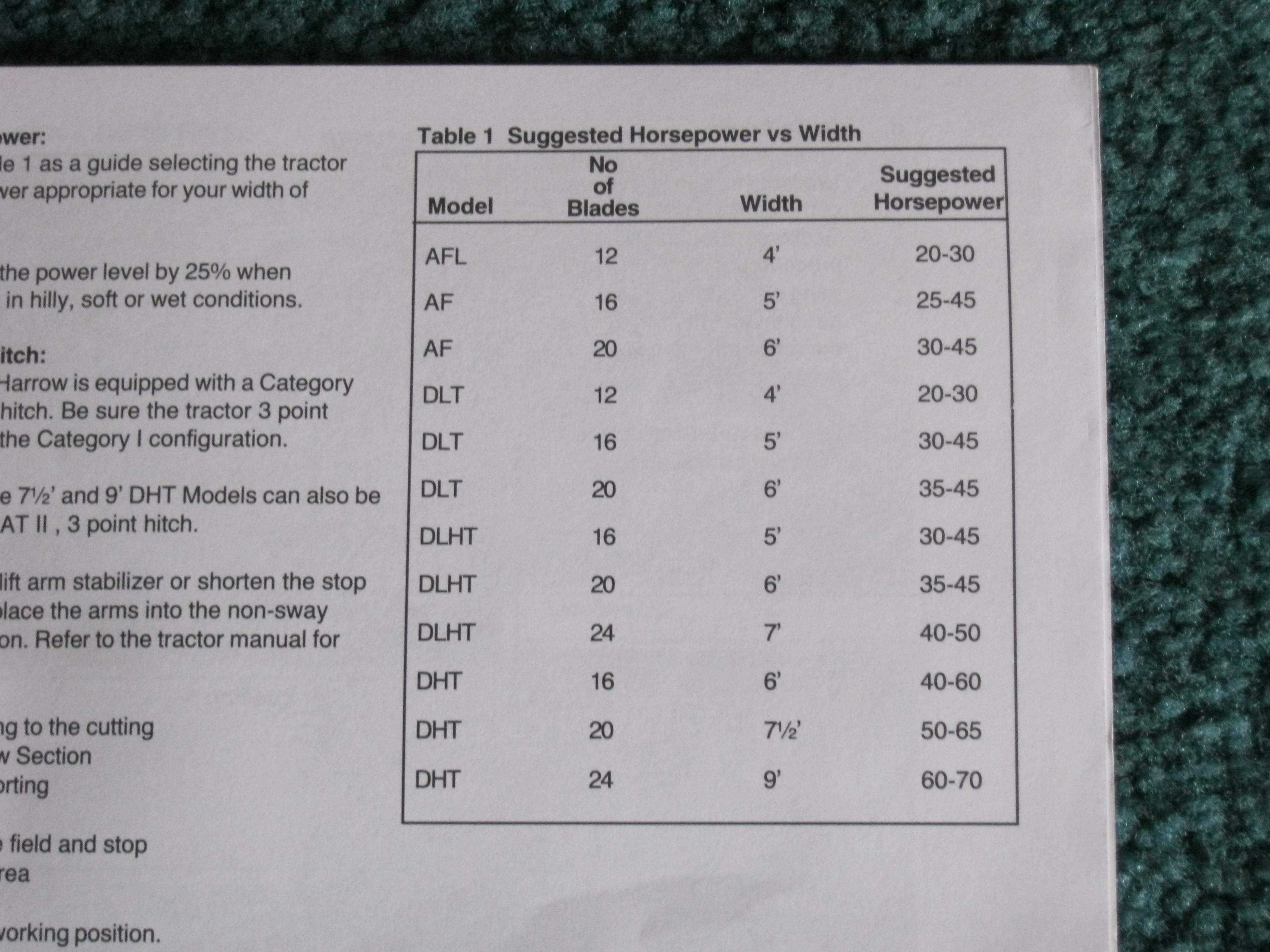

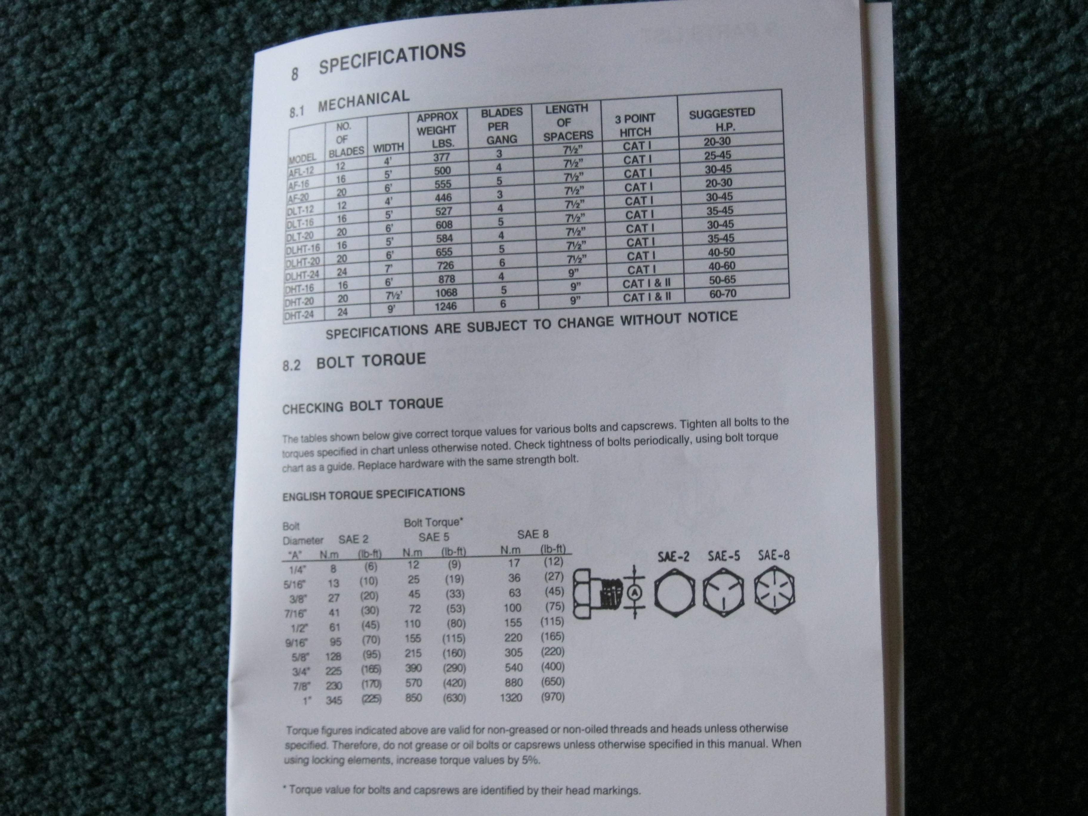

Heres some info that's on my Howes owners manual.

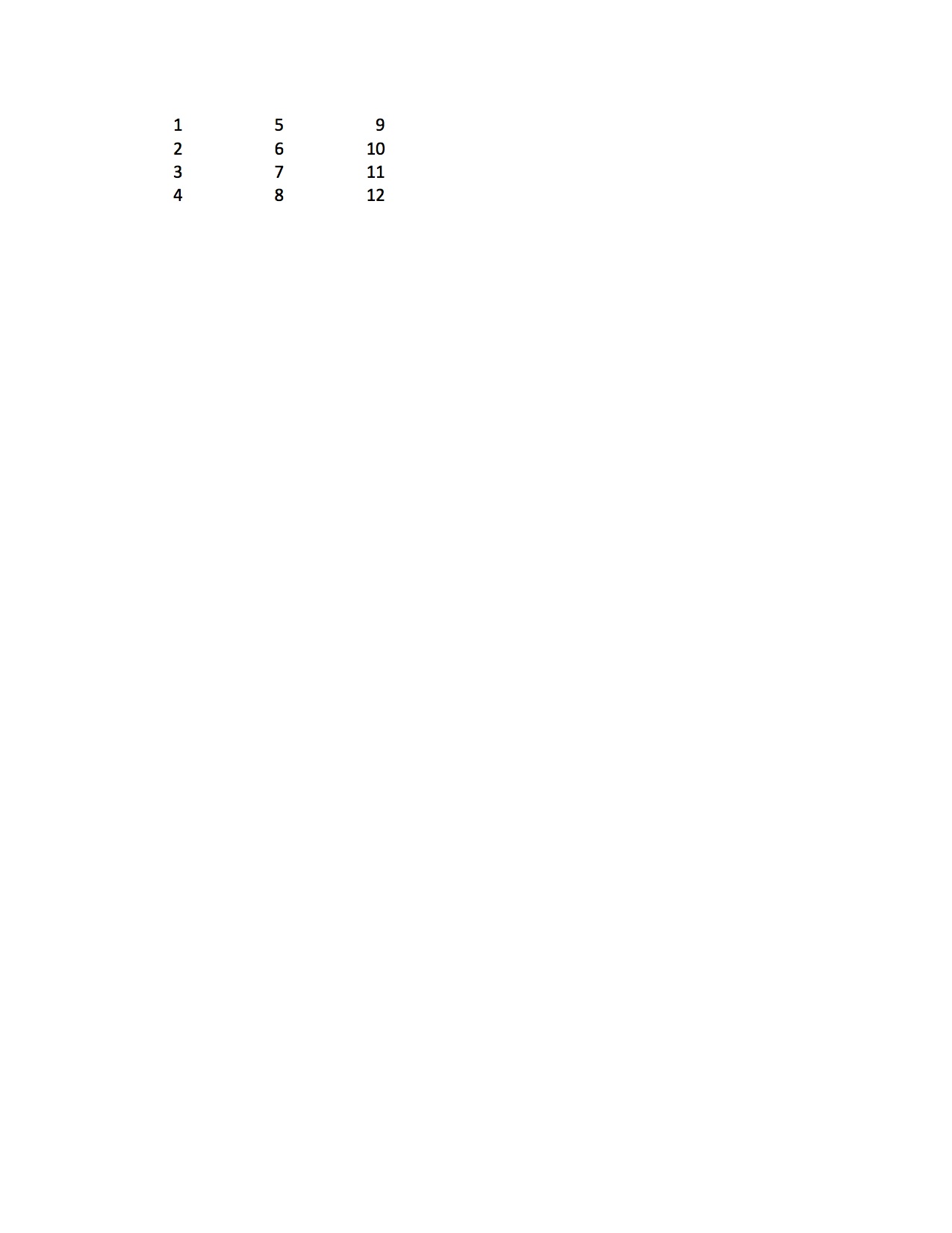

How do I convert an Excel spreadsheet into a .jpg file?

I saved this Excel spreadsheet as a .pdf file and them from Preview (I am using a Mac) I exported it to a .jpg file. The .jpg file can be uploaded to tractorbynet posts. Kind of a convoluted way to do it, but it works. I tried it with Adobe and it wouldn't let me save it or export it to anything but a .pdf. If you can't find an easy way to make the conversion, send me the .xls file and I will make the conversion for you. I think you can send the file by PM. If not, let me know and I will send you my email address.
