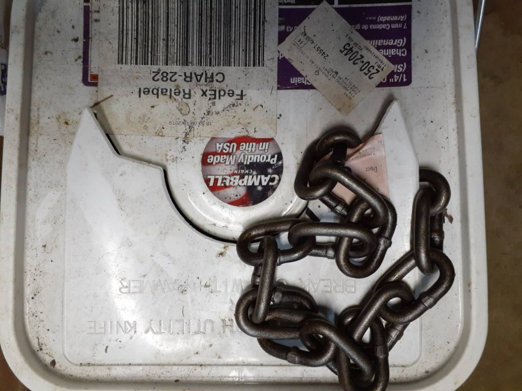

With the price of lumber these days, you don't need 6x6 extensions, 4x4 would be adequate. Your eyebolts would be fine but would allow slack to slide back and forth. I would just fasten the chan with 5/16" lag screw and washers.
Your chain is not galvanized. It will rust and the rust will drip down and stain the concrete.

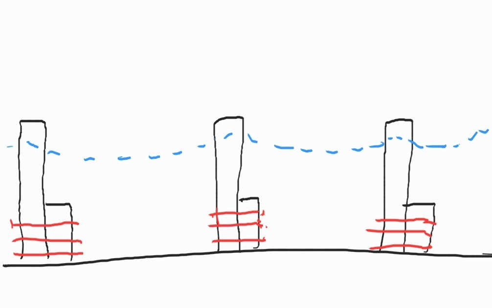

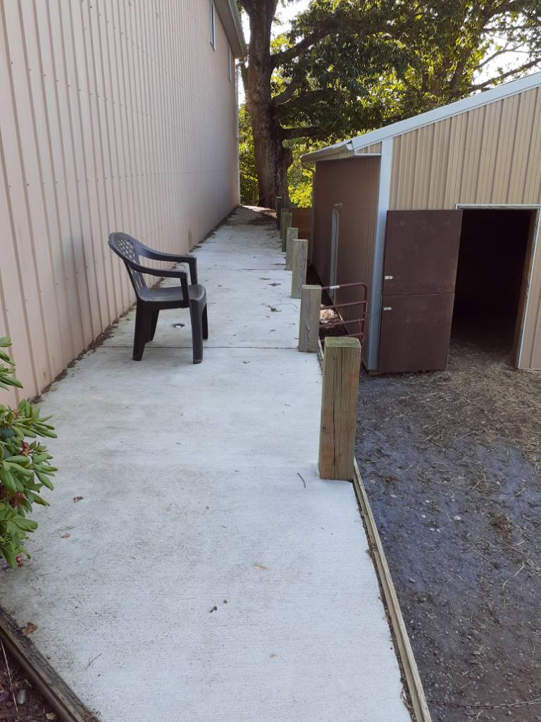

I have 100ft long sidewalk on top of a retaining wall just over 5ft wide and just over 6ft above a horse barn behind garage.
I had the construction co leave the 6x6 treated posts up, 12 of them 30" long.

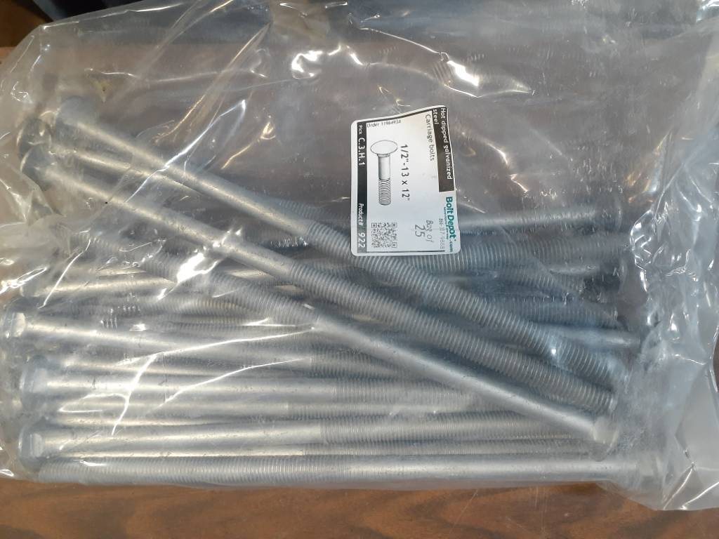

What I want to do is get either six 10ft or 12ft 6x6 treated posts and cut them in half.
I'll then parallel them to 30" posts fastening each with three 1/2" galvanized carriage bolts, nuts & washers, staggered so one close to bottom, one close to top, one middle offset. Of course, level...all straight.
I have over 100ft of 1/4" chain, 1" links I'll go between. Mainly safety...no fun falling >6ft.
I'm thinking ordering large galvanized screw eyes, chain at 4ft. up. I don't want to drill big holes through posts at top for chain.
Is this a good idea, or better thoughts?
Thanks....
View attachment 747321View attachment 747322View attachment 747324View attachment 747328
It will work. But, as others have mentioned there are some small issues with it but it will work fine.
I would consider just using 2x4's boring a hole in the top and running a pipe rail throgh the top,
and a mid board if desired.
Or go with your plan and get some plastic chain, much of that is rated for 200 #.

Thanks...but I'm trying to use what I have on hand. I already have chain (3,200# load limit), galvanized bolts, etc.
I can get six 6x6x10ft treated at a good price & cut them in half. Chain at 42" sounds good.
