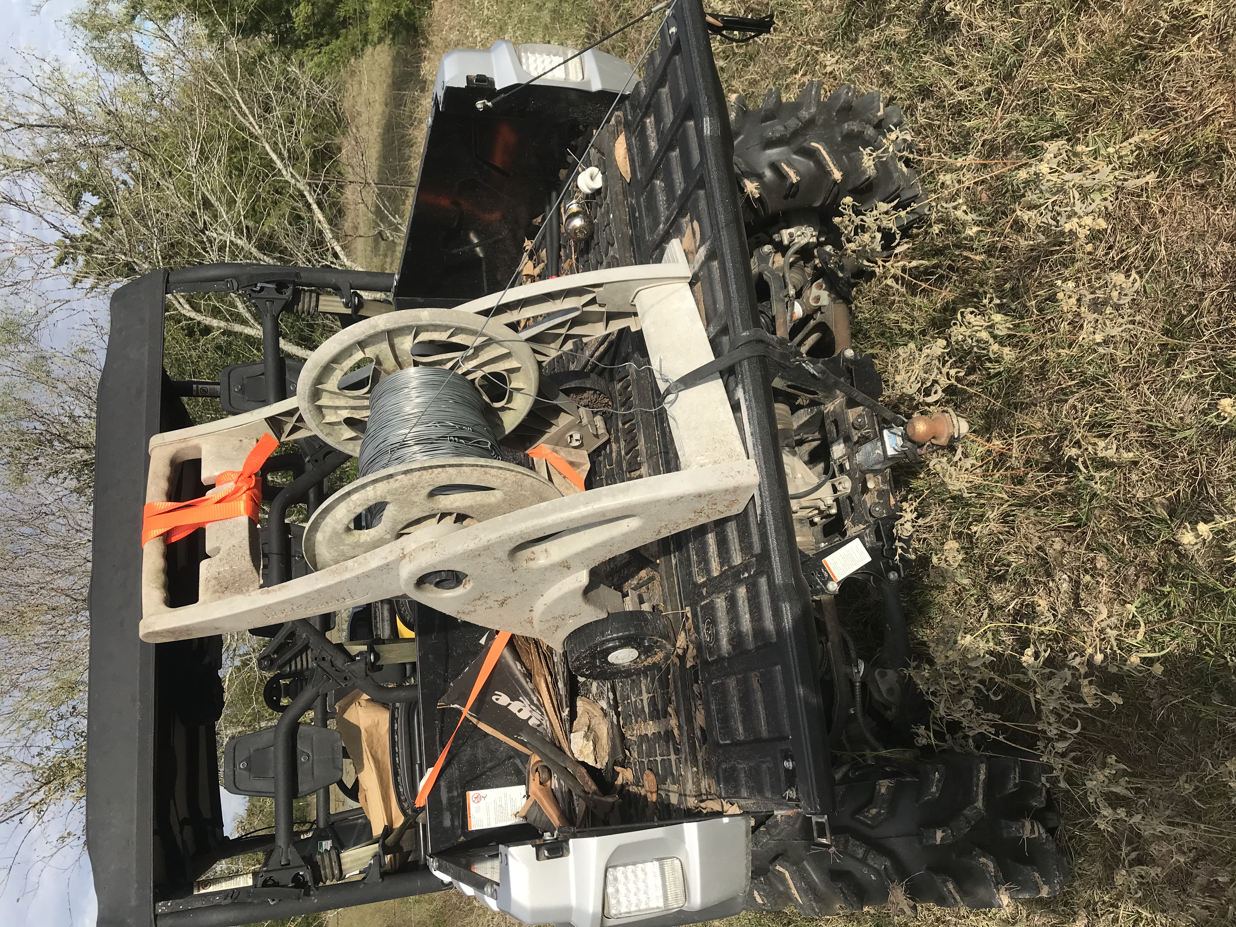

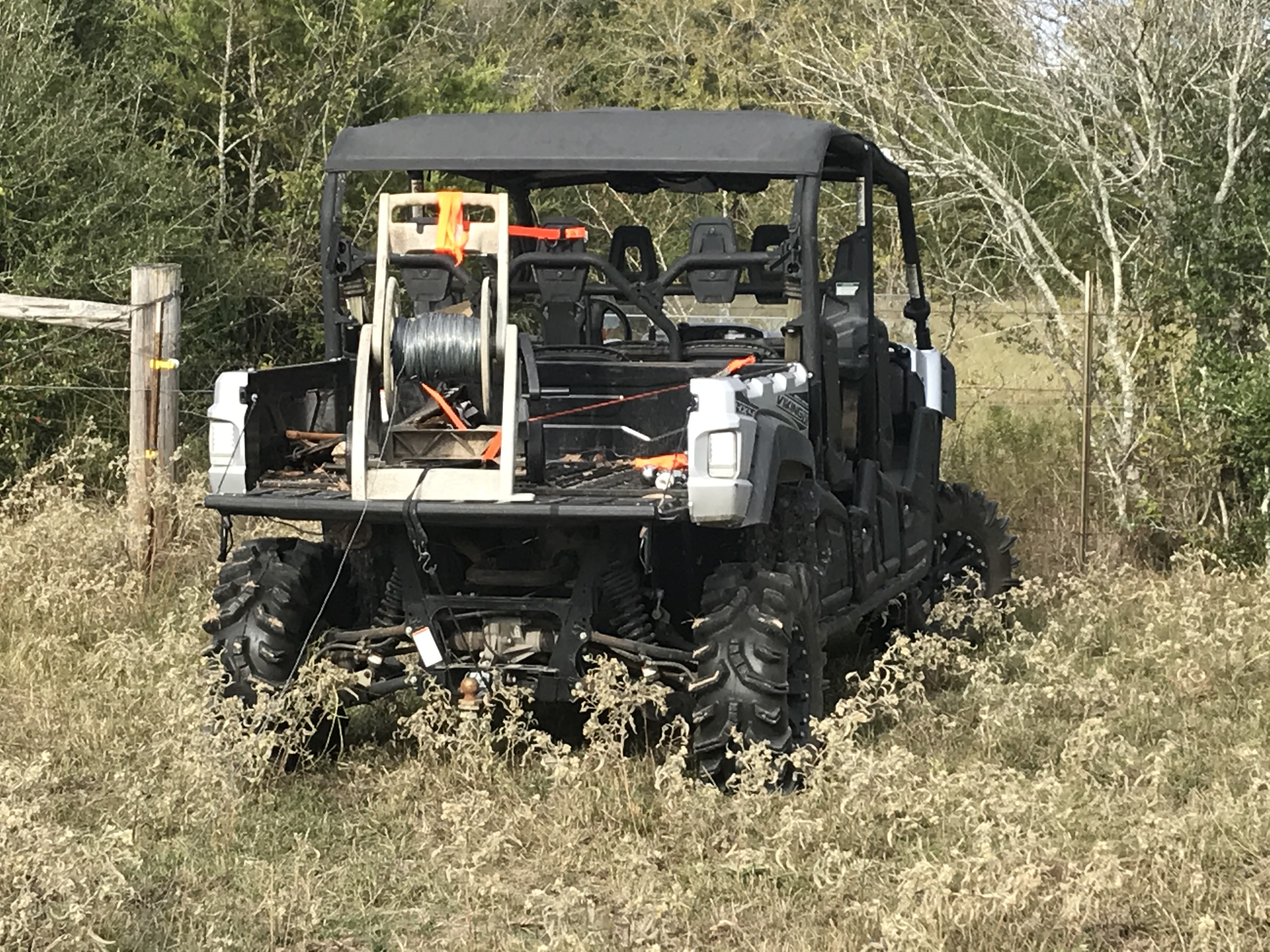

We have forty acres leased with some cows on it. The property is rectangular with the back fence probably somewhere between two and three times longer than the sides. Needed to take two strands of electric fence wire down and have been thinking on how to do it for a couple weeks. I made use of an old plastic water hose reel that probably hasn稚 been used in 10 years by strapping it in the back of our side by side. It worked pretty good although my arm was starting to tire. Feel free to laugh at the redneck ingenuity.

I'm not going to laugh. I wish I'd thought of it. I used a coffee can, some all thread, and some crossed 1X2 pieces to make something similar for the same purpose.
