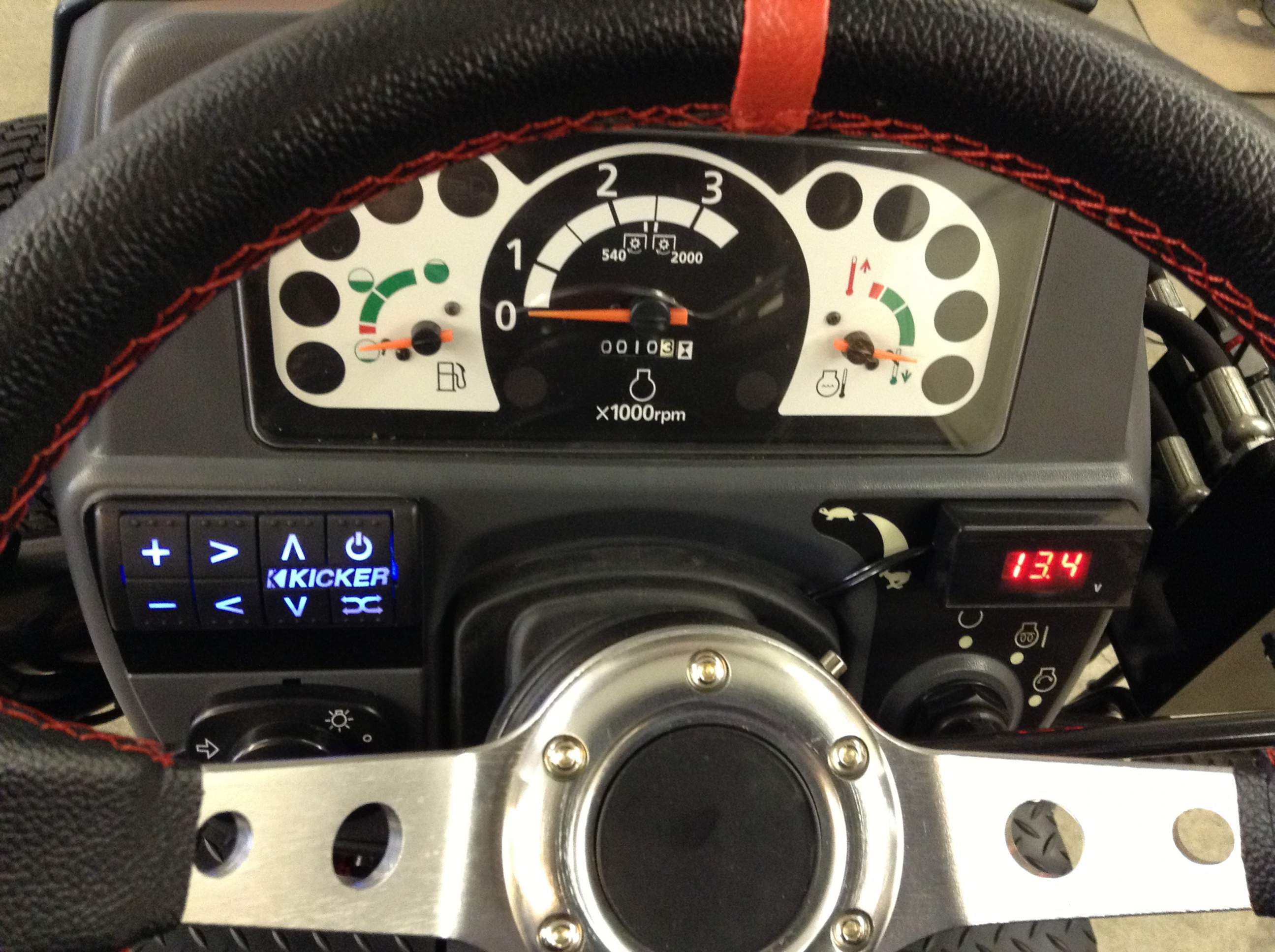

Did I see a pic with only 10 hrs on the clock? You need to spend more time using it. Does it actually run or is it just a looker? :)
When do you add one of these?
/ Takin it to the MAX
#42
Yes, it actually runs... It takes serious time to do just what I've done. Unfortunately it's winter up here, and the snow gods haven't co-operated. I've used the Plow once, a two hour job with my walk behind snow blower took less than 20 minutes with Max. Doesn't put a lot of time on the clock... I sorta feel like the guy who ran out and bought a snowmobile, only to suffer record highs and wait for snow. But if chance favours the prepared mind... I am ready. As much as I like it, I am unsure on what to use it for daily, in winter ? As far as going with your reactor idea, I choose to stay with Bio- Diesel, may be better for the environment.

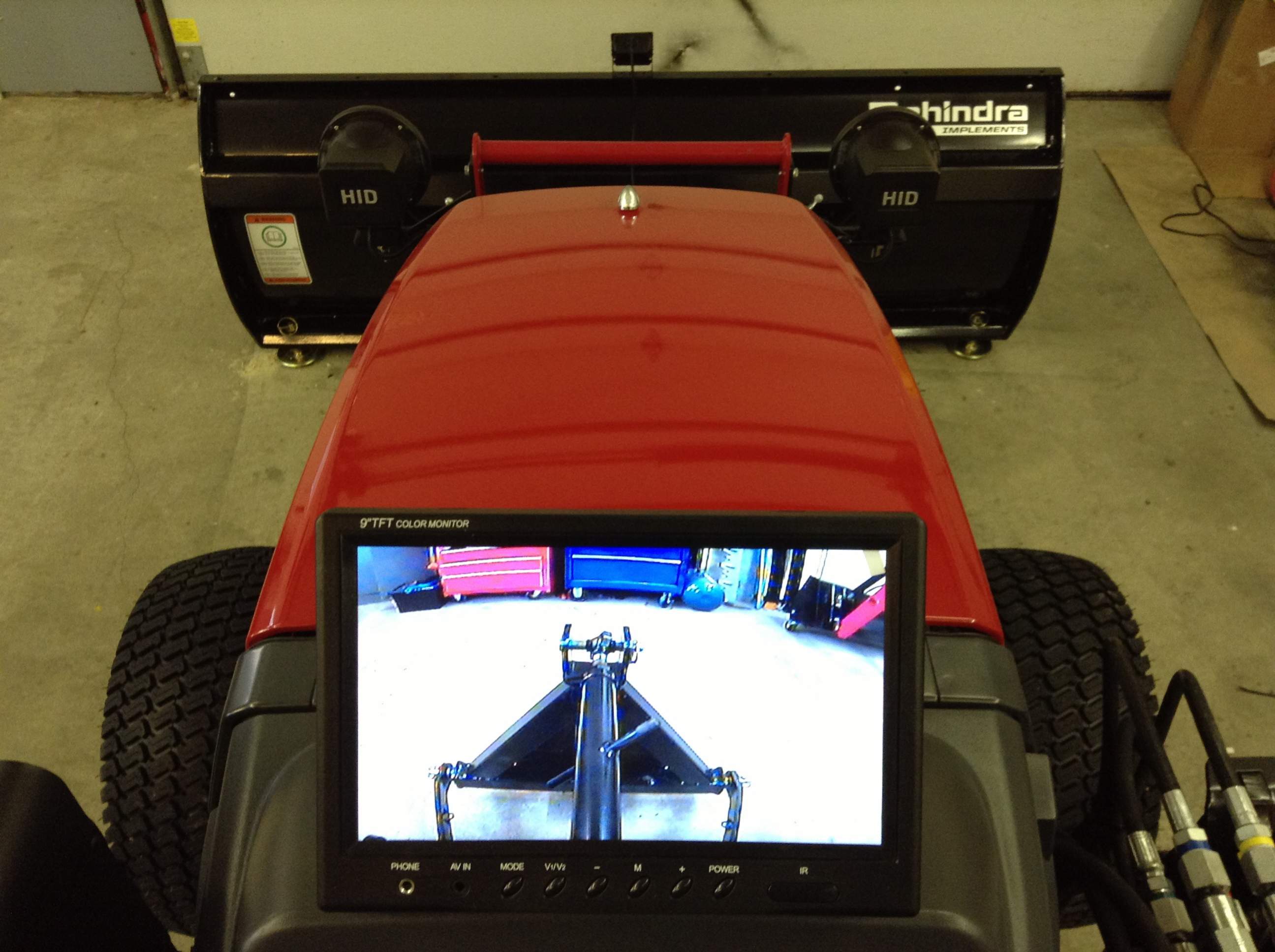

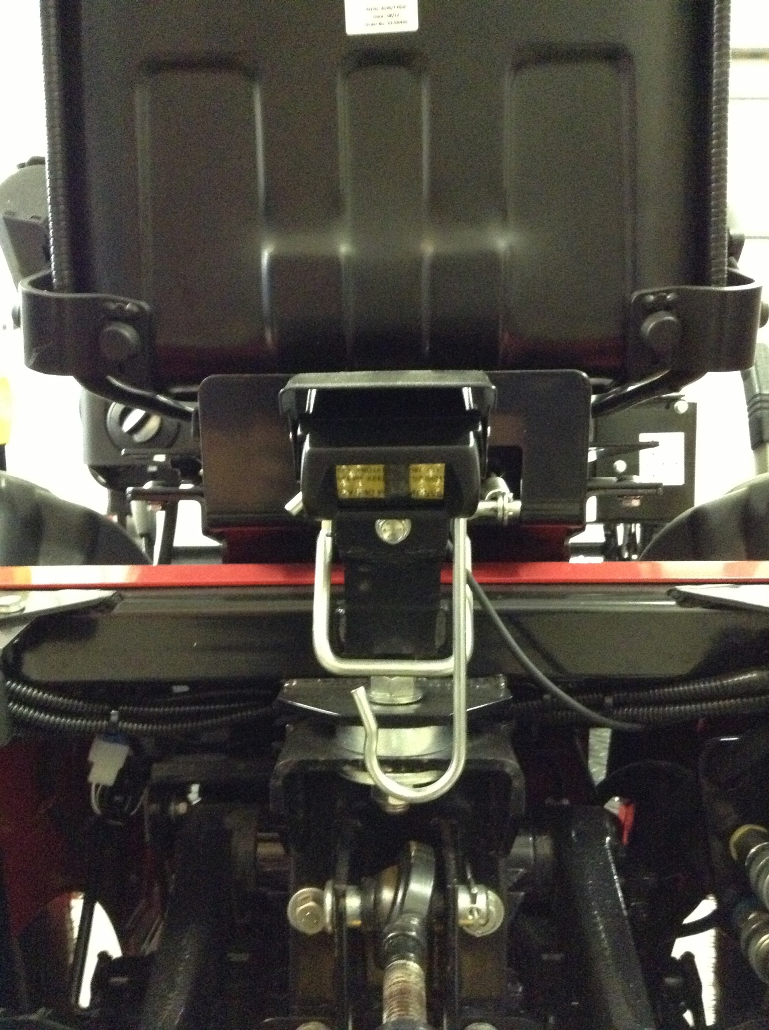

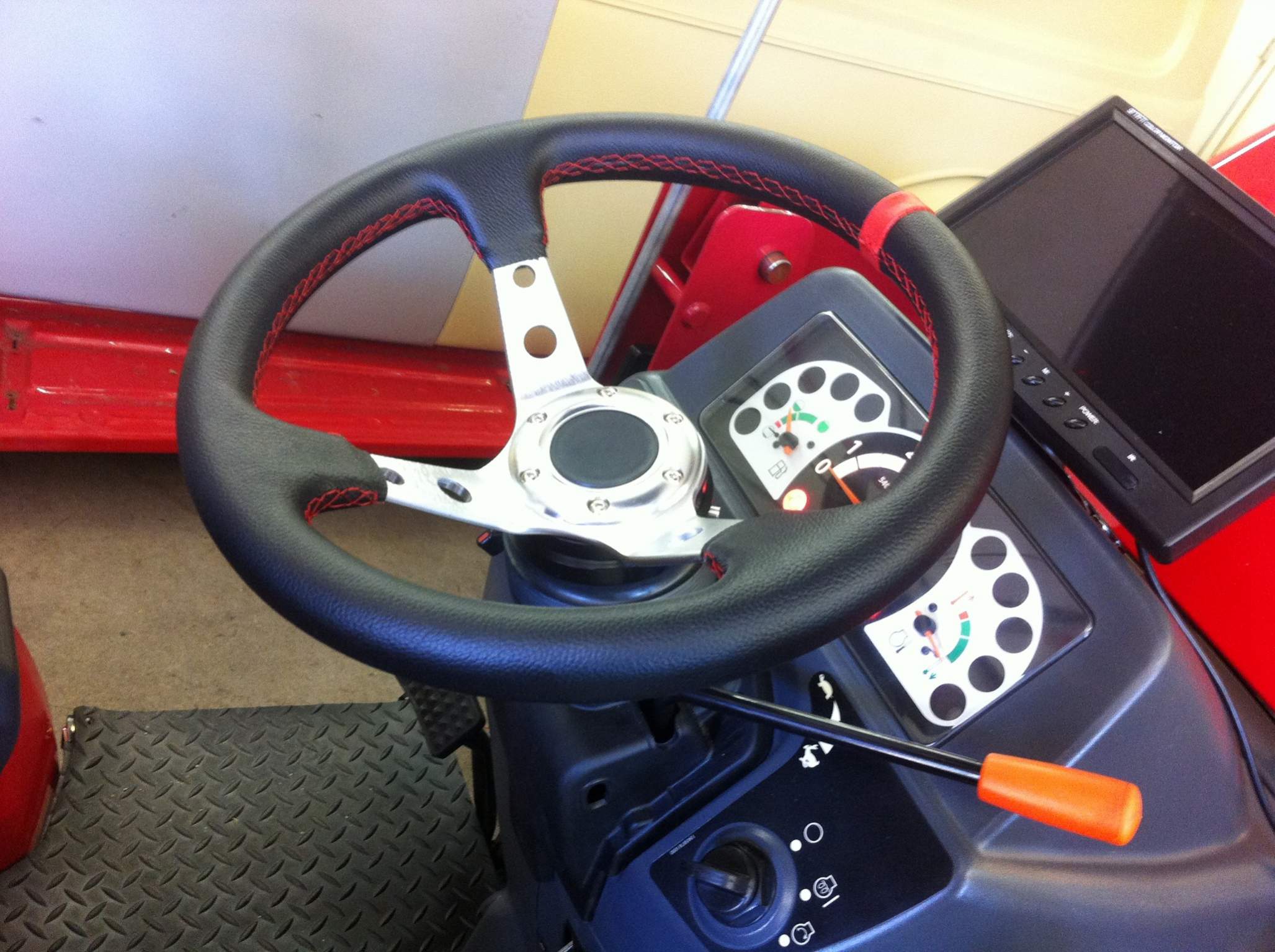

Perfect! These pics explain what I could see at first. I will be looking into a setup similar to this, but need to have a waterproof monitor as my tractor does get wet from time to time!
Monitor is mounted to the dash top, maybe you mean camera? Here is a pic of both. My neck is not so good either, big reason for front implements and rear camera for me. I only added a front camera to play with as it was made for both. If you do this make sure your rear camera is what they call mirrored, it keeps what you see on the monitor on the right or left the same as the right or left of your body as you sit facing forward on the tractor. It's important because a regular view camera will confuse his right and lefts. Hard to explain but turn around in your seat and you'll see your right side will change, a mirrored camera corrects that.

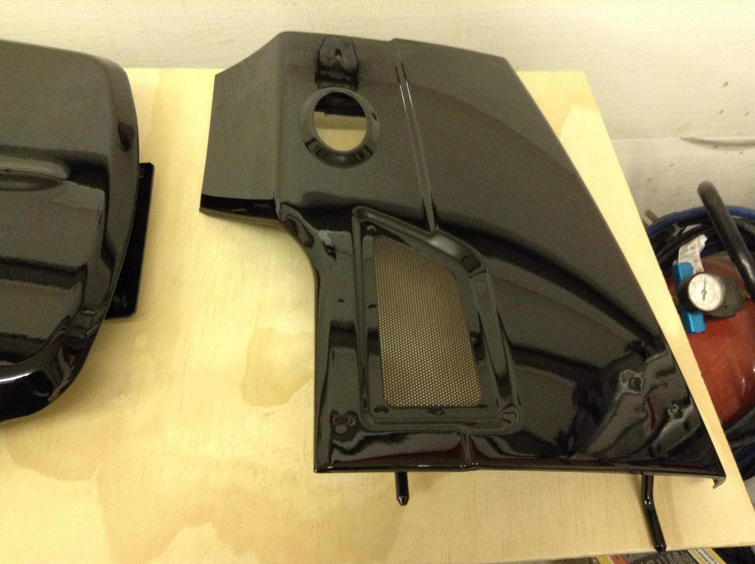

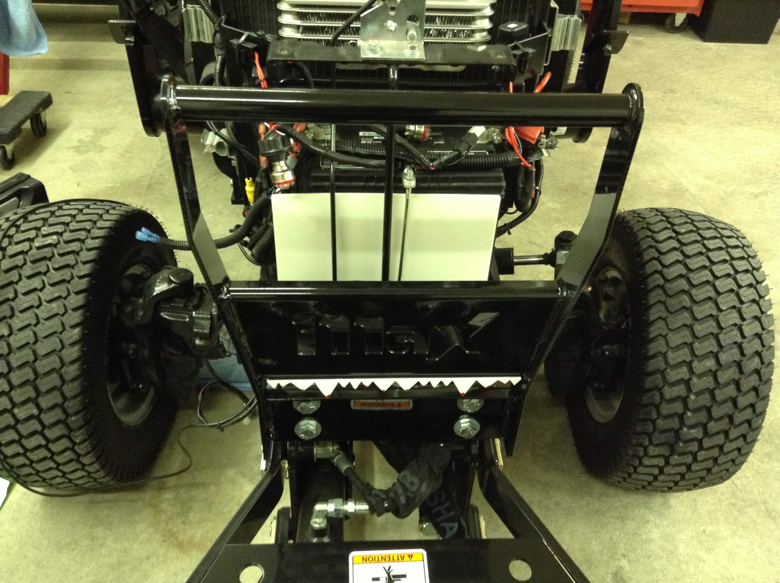

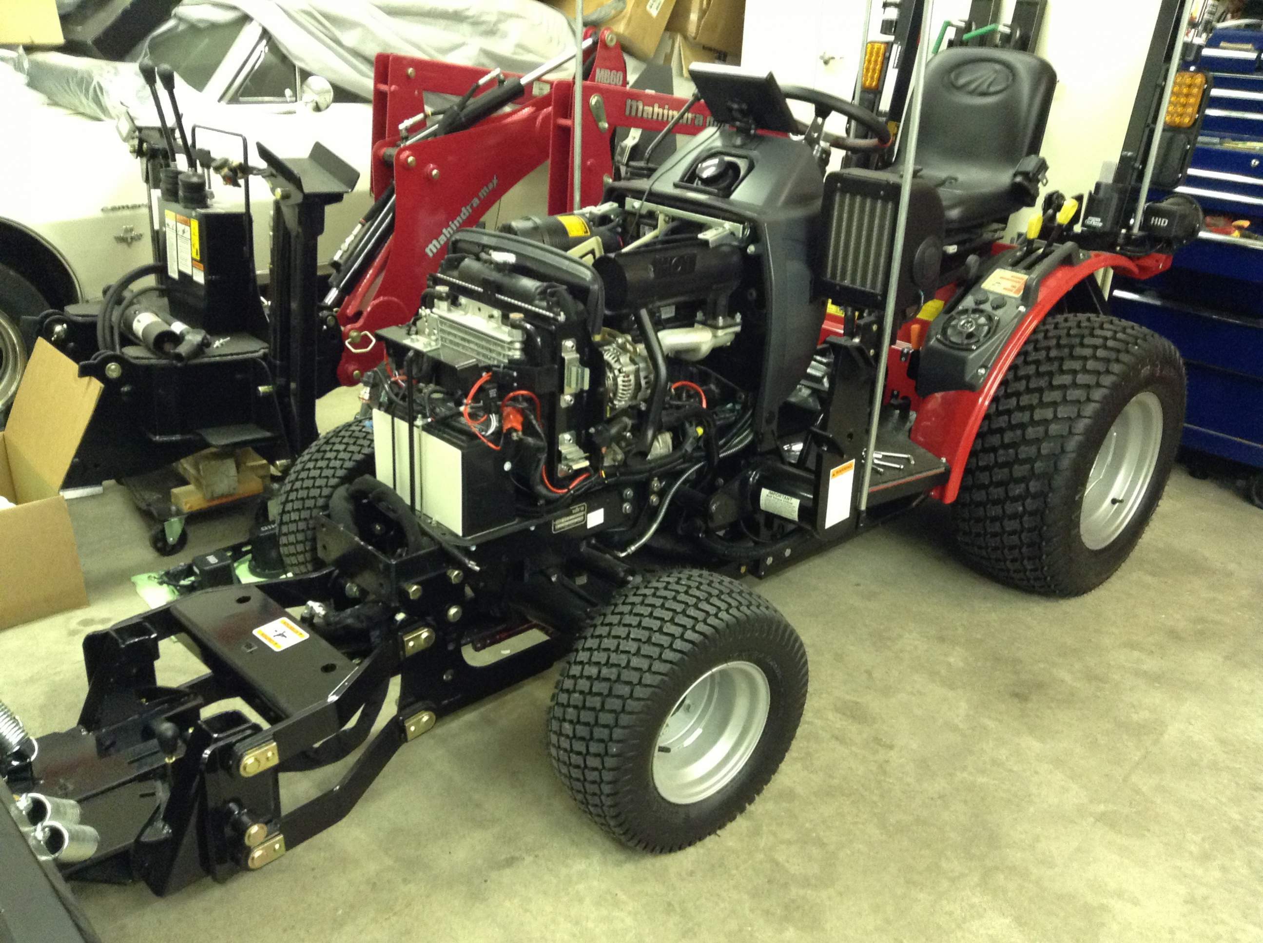

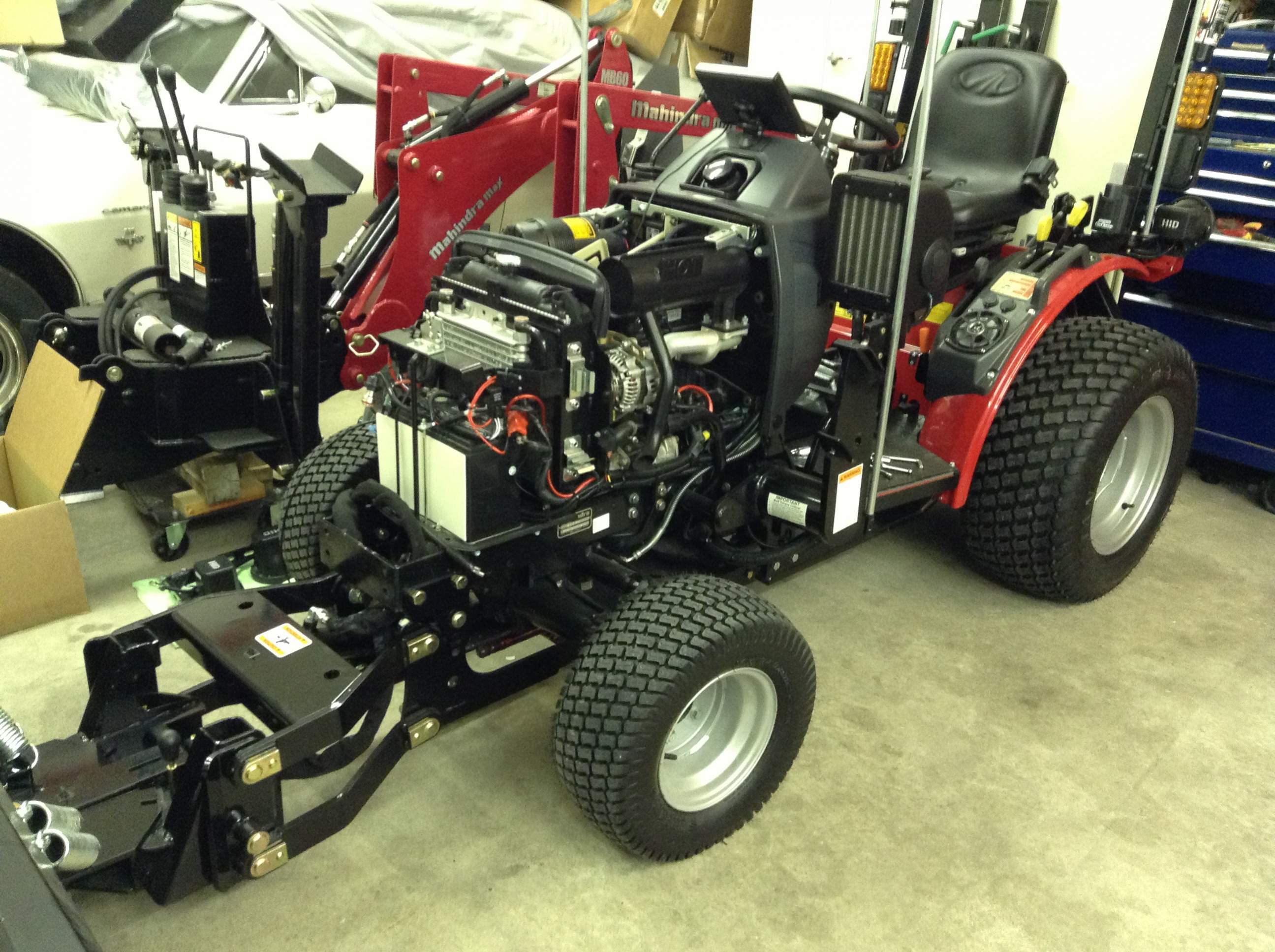

Here is an update for those of you following this thread, I decided to live up to my name... Black Max. Just teaser shots for now, not the best pics either, guess I'm a little woozy still from the clear coat.... I stripped the front of Max and started to paint everything that was red, Black !!

Just having fun, I said some things may seem silly..... Lol. But thanks ;) my only real complaint about Max was the paint, tractor was fine, but the KMW loader and backhoe kinda looked a little to pinkish to me. So I decided my tractor would match my motorcycle, truck, wife's SUV, and my son's truck, and be black. Not so crazy to me and I think it will look pretty mean when done.
After your 're done spraying the tractor, spray the rims black as well only leave the outer part of the rim silver. One cohesive look I tell ya. Now I'd only say this to a guy such as yourself: keep the lug nuts silver as well. I found the perfect match for the Mahindra wheel color with the Rustoleum "aluminum".

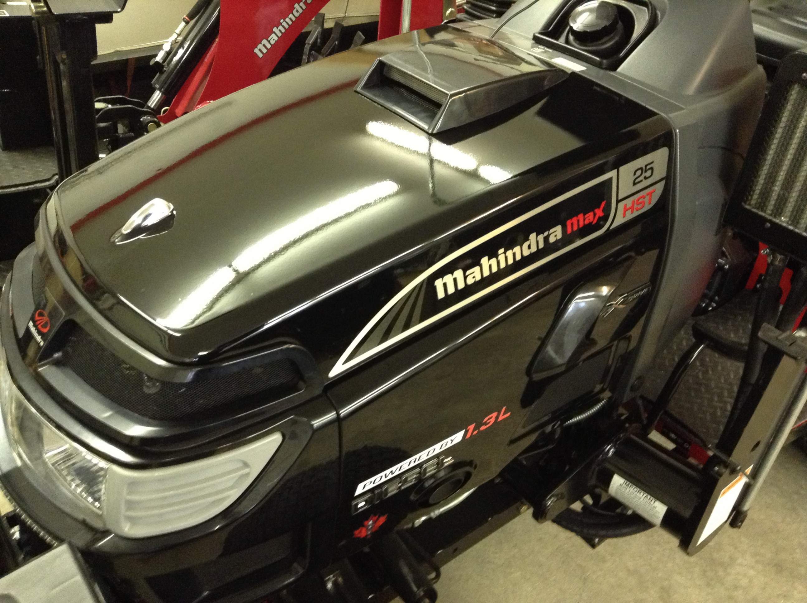

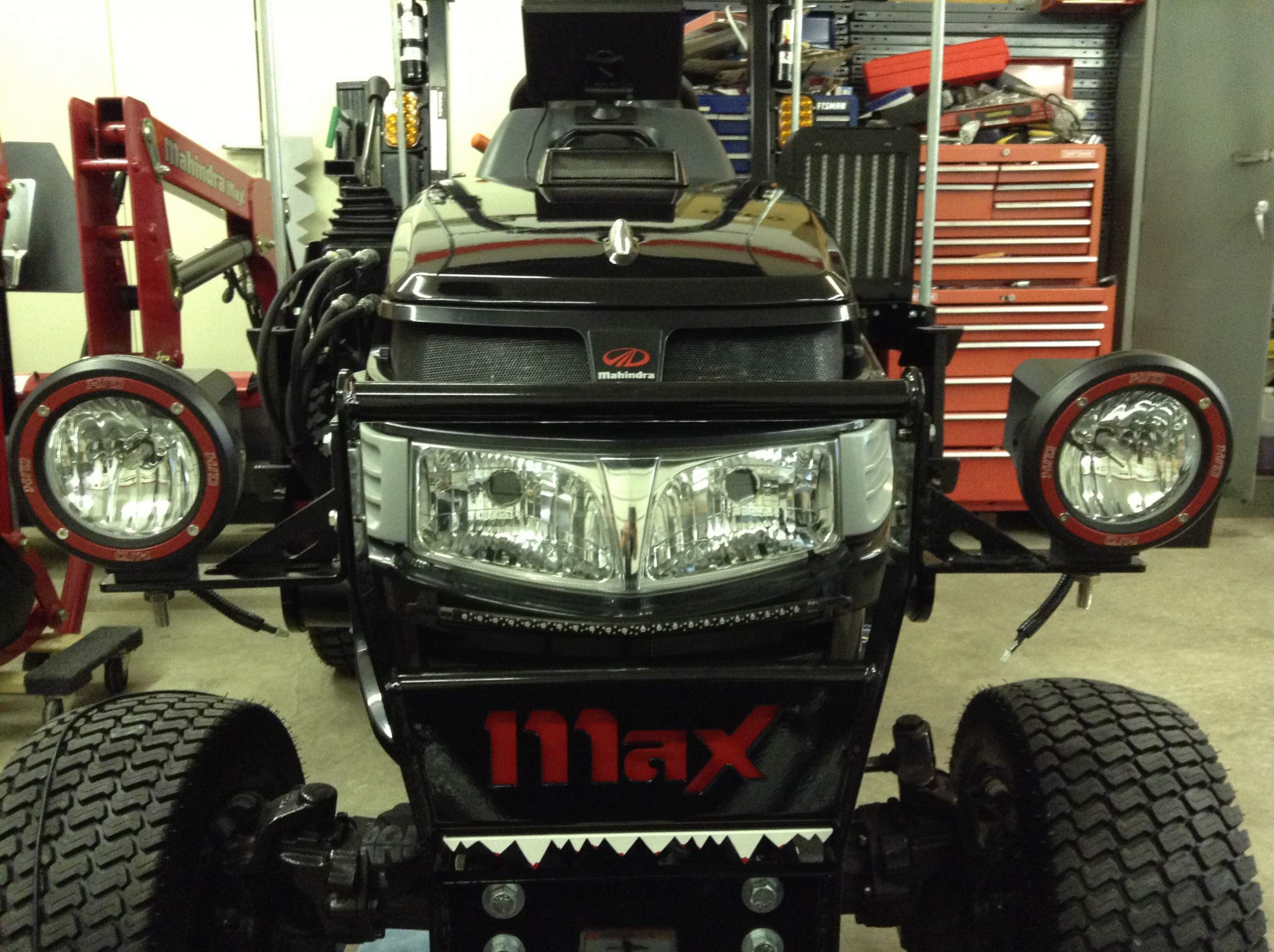

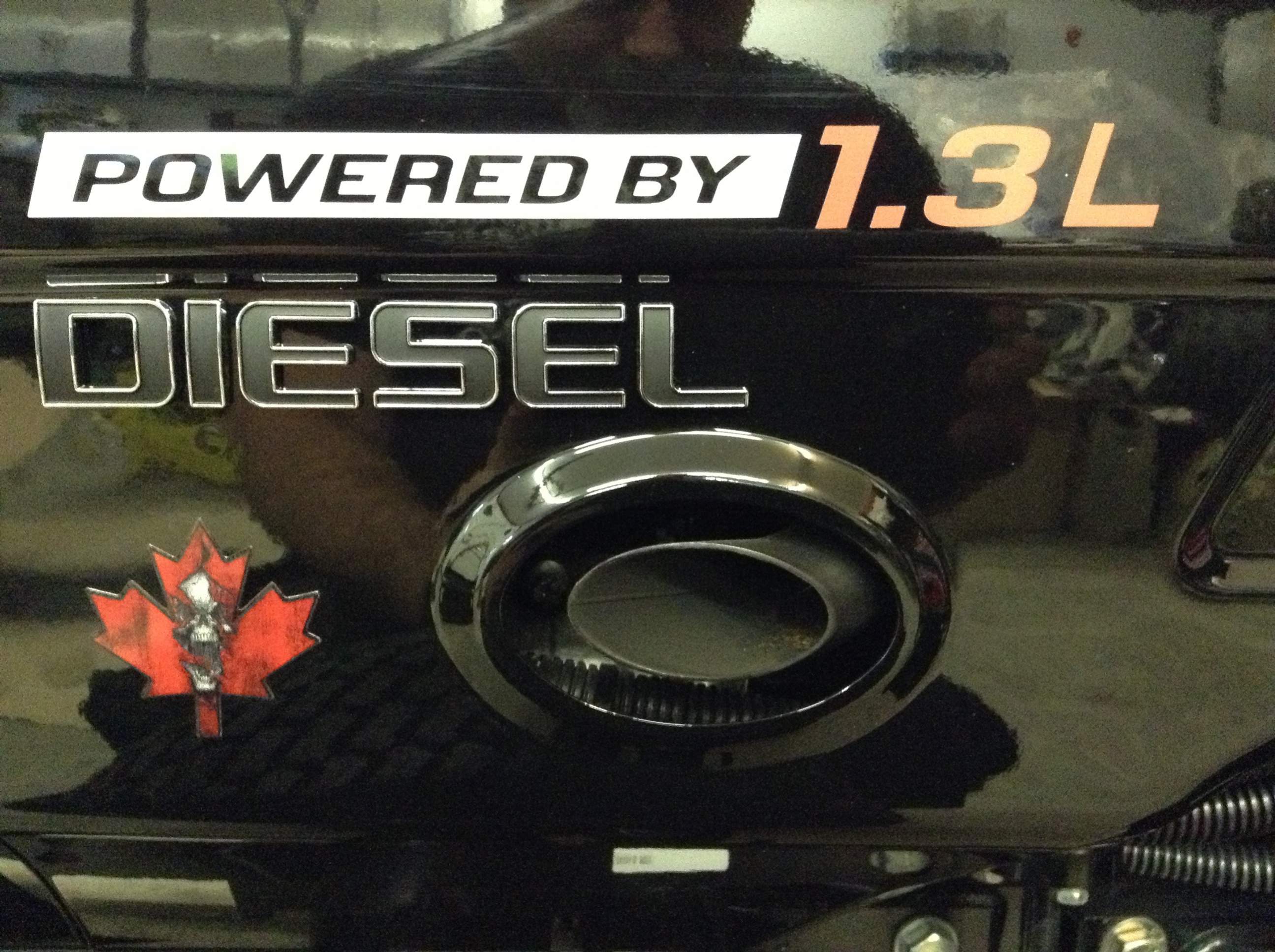

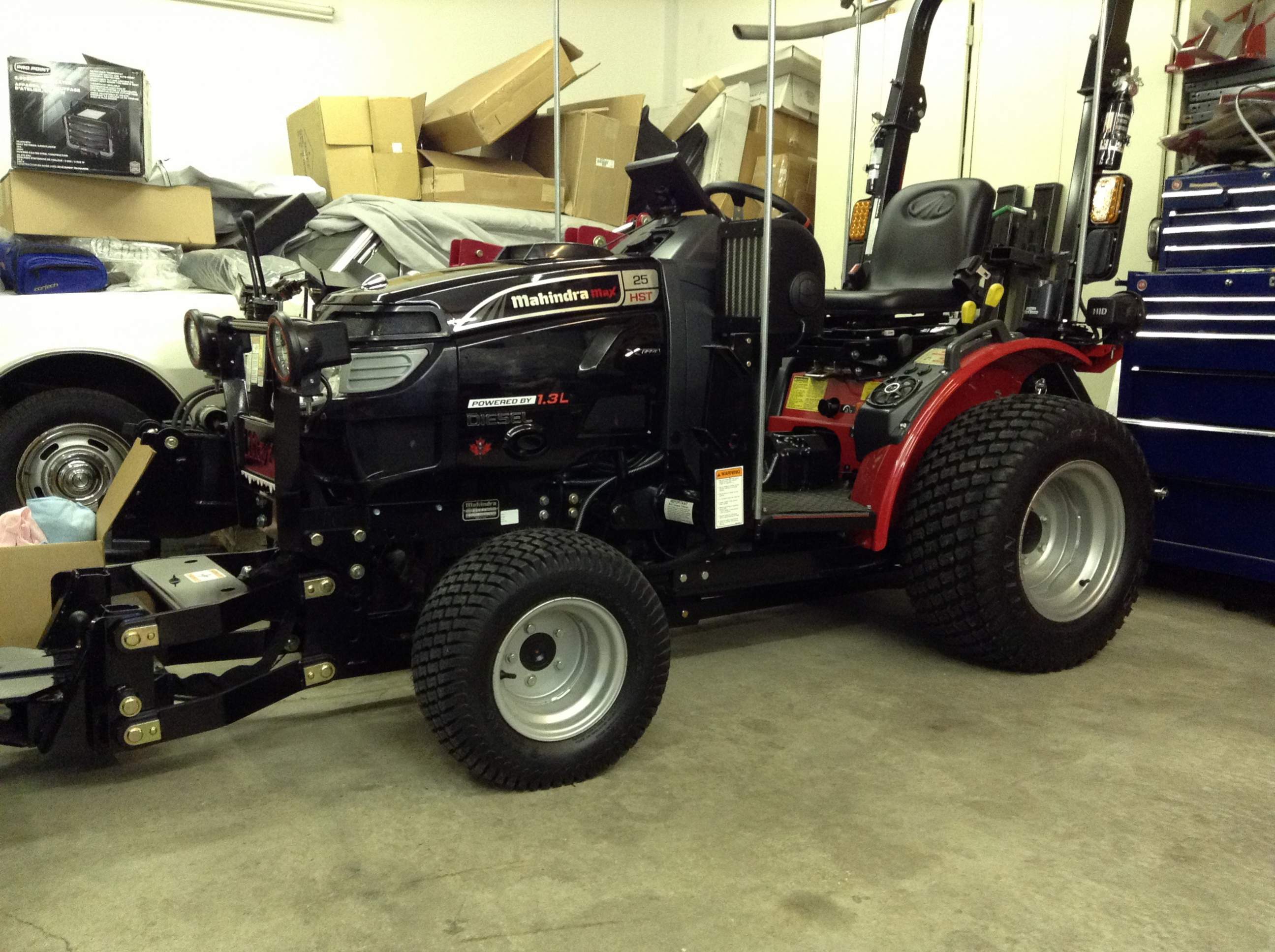

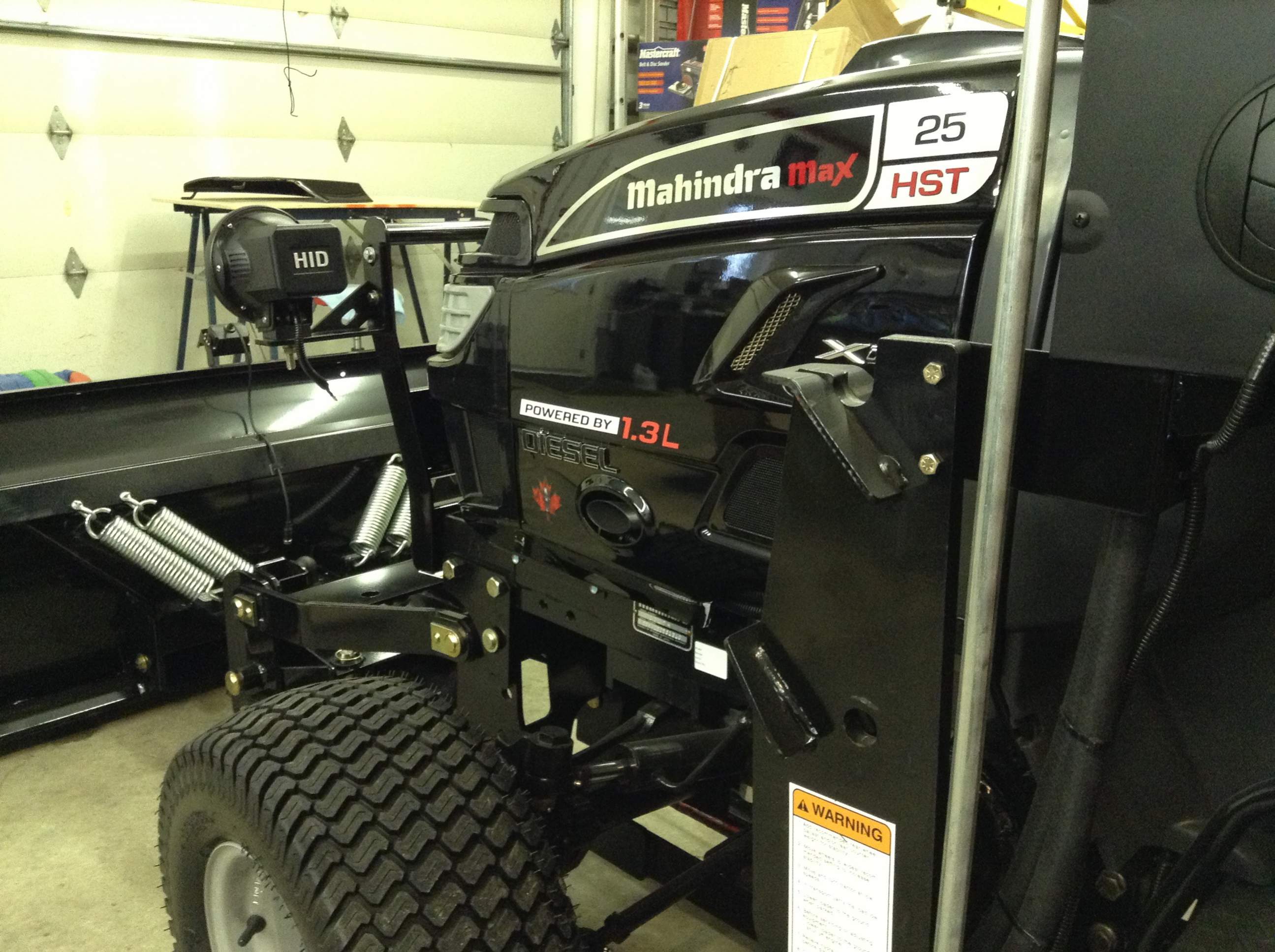

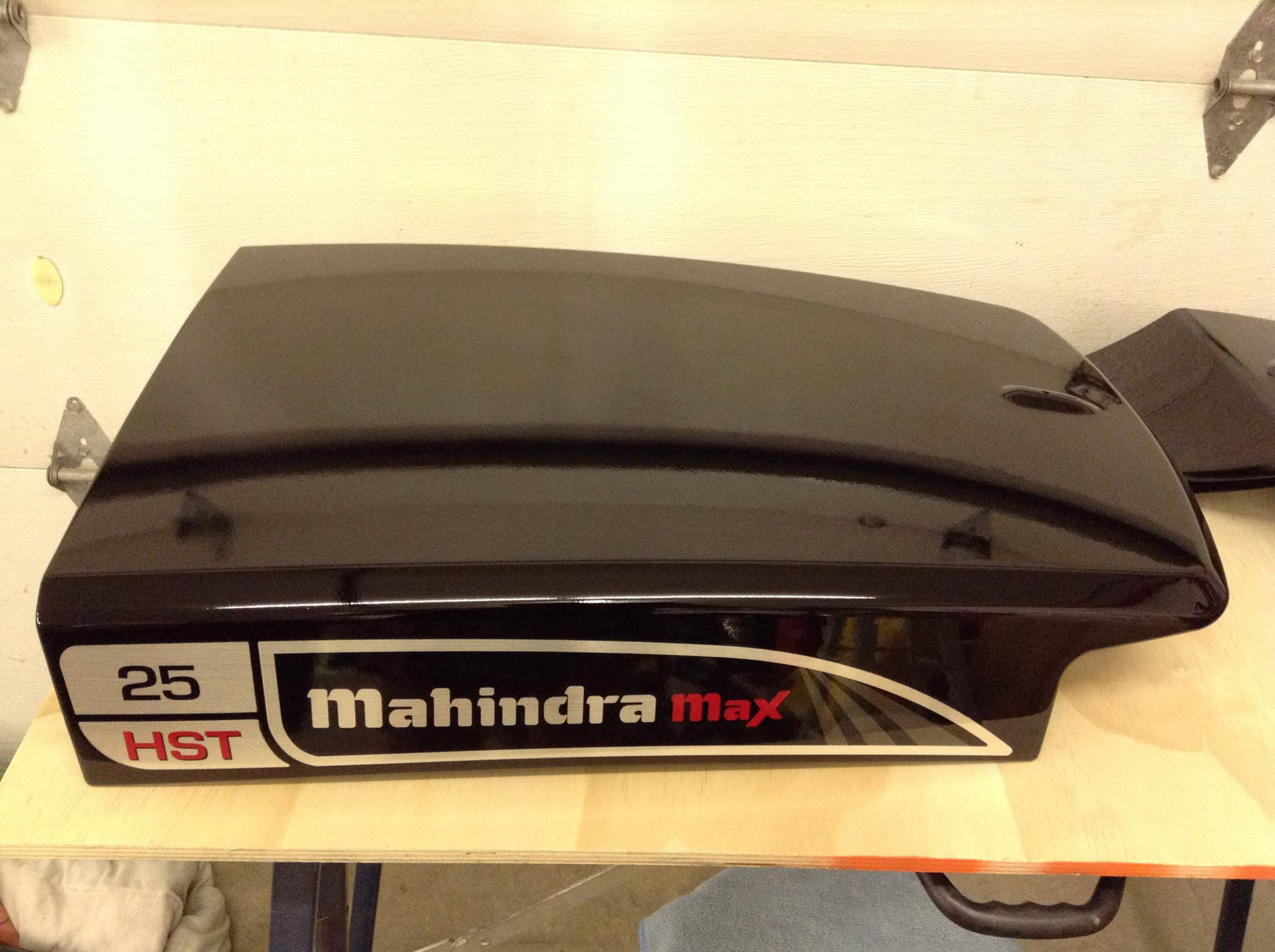

Paint has a ton of clear on it, in fact I buried the "Mahindra Max HST 25" decal in the clear coat. I expect some rash, at least I can sand and polish it if I want. Not really any different than scratching the red to me. This is not a show tractor, so chroming the crankshaft will not be done. Most of my mods have a function for me, comfort, operation, and more importantly visibility issues have been addressed. If I choose to make it look a little badass just for fun hey, it' my tractor. So, here we go, I decaled my side panels this morning and put the front end back together. Added some scoops as well to mean it up a little more, looks a little funny with a red ***... Lol. I think it came out good.

Paint work looks awesome. You just have to paint the rear fenders now. ;)
#57
Thanks, nothing is perfect but it came out really decent. First I have to strip the back, then I'll start to prep the pieces. My garage is a little full so I couldn't strip the whole tractor at once, there's like 23 pieces to do, including loader and backhoe.

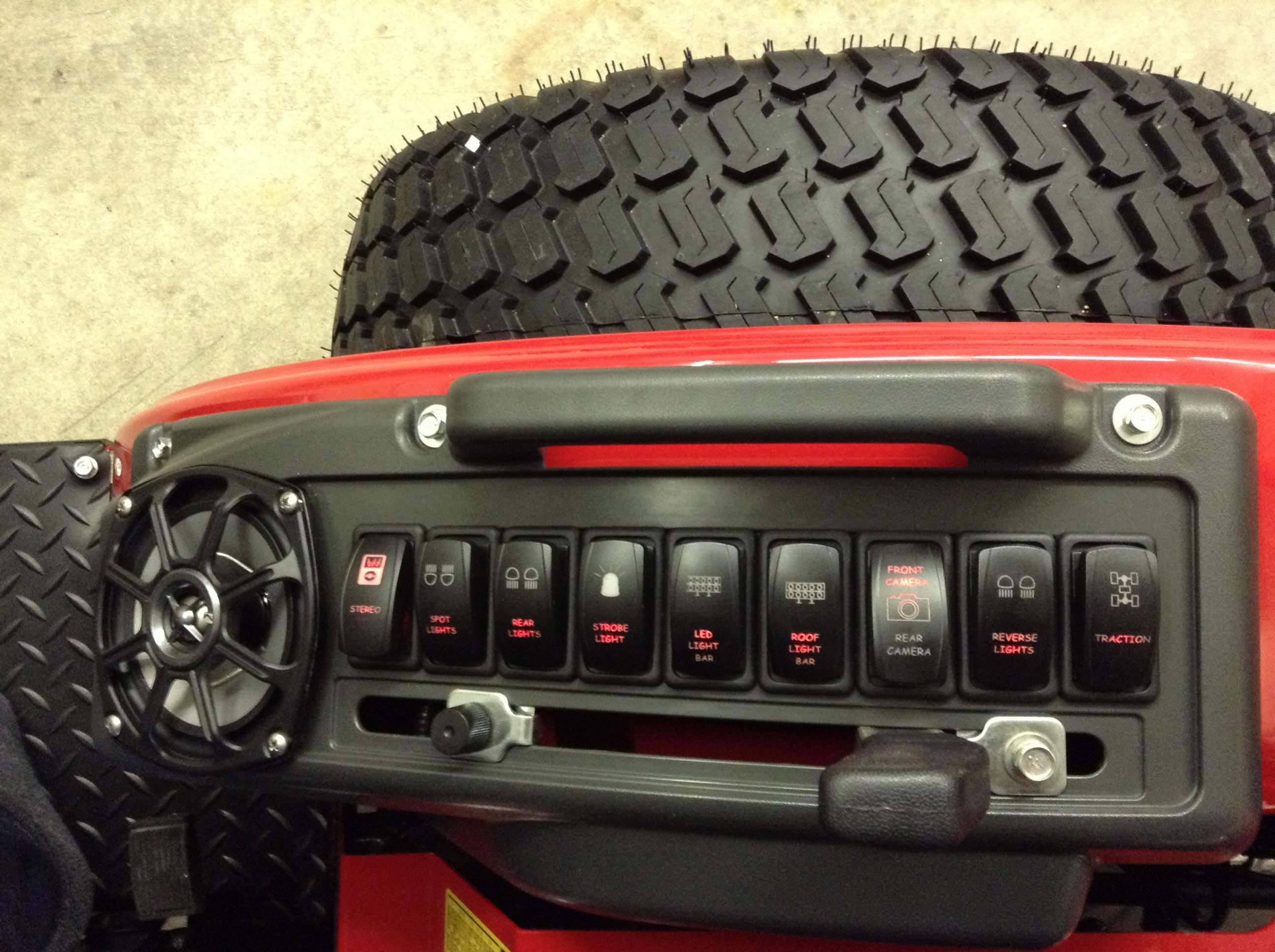

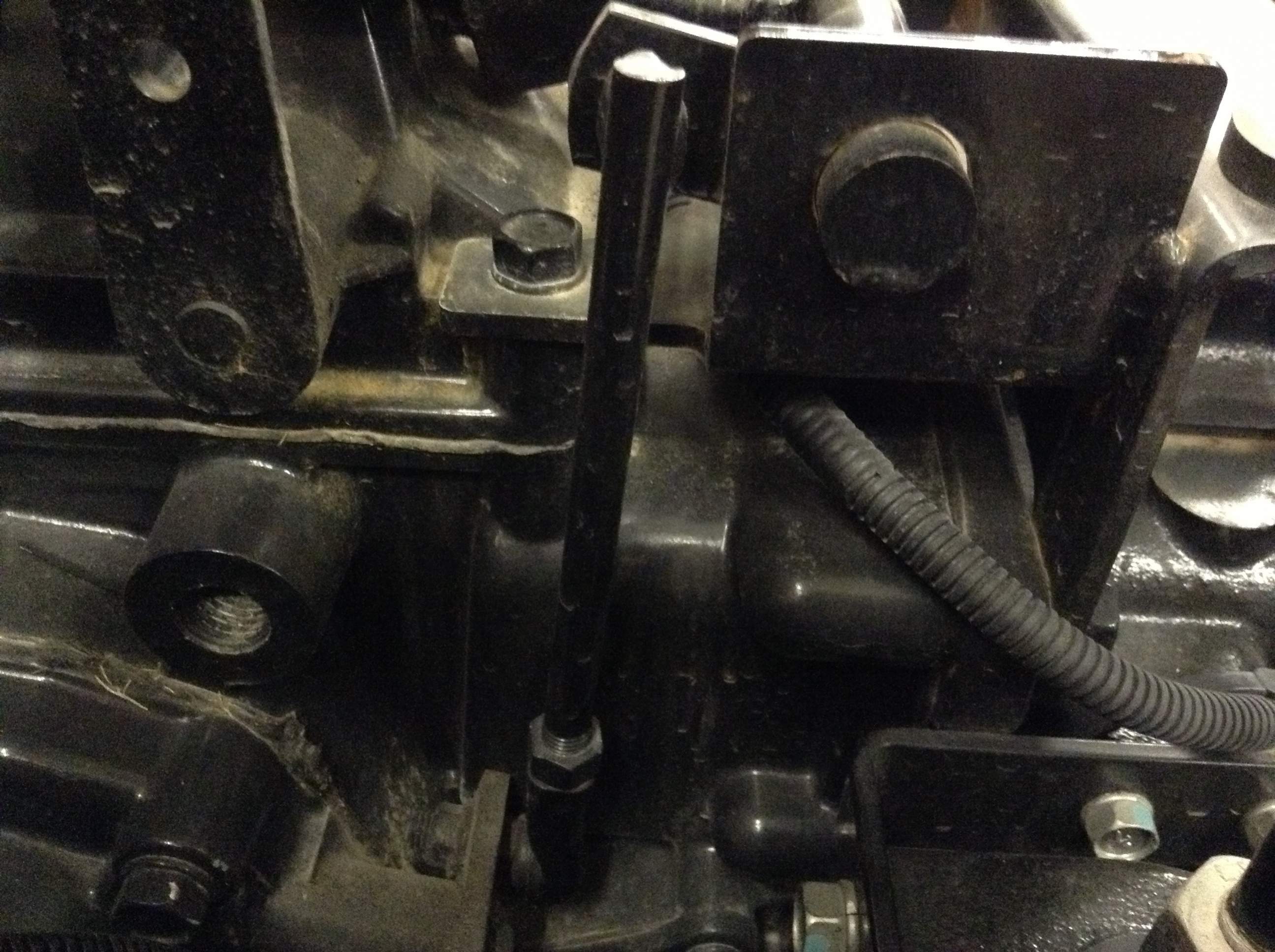

I am really surprised no one asked about my switch labelled "Traction". I found a better switch labelled " Rear Diff Lock" to replace it. That sort of gives it away but I intend to use a 300# linear actuator to replace my manual diff lock pedal. Think of it like an electronic Diff Lock, I hope it works like I imagined it would. Pic shows the actuating rod I intend to replace...
/ Takin it to the MAX #60
Didn't notice until you said it. Had I not known what your intention was for it, I do not think it would of been too outside (now knowing you) to consider you rigged up some type of solenoid for 4wd activation.
