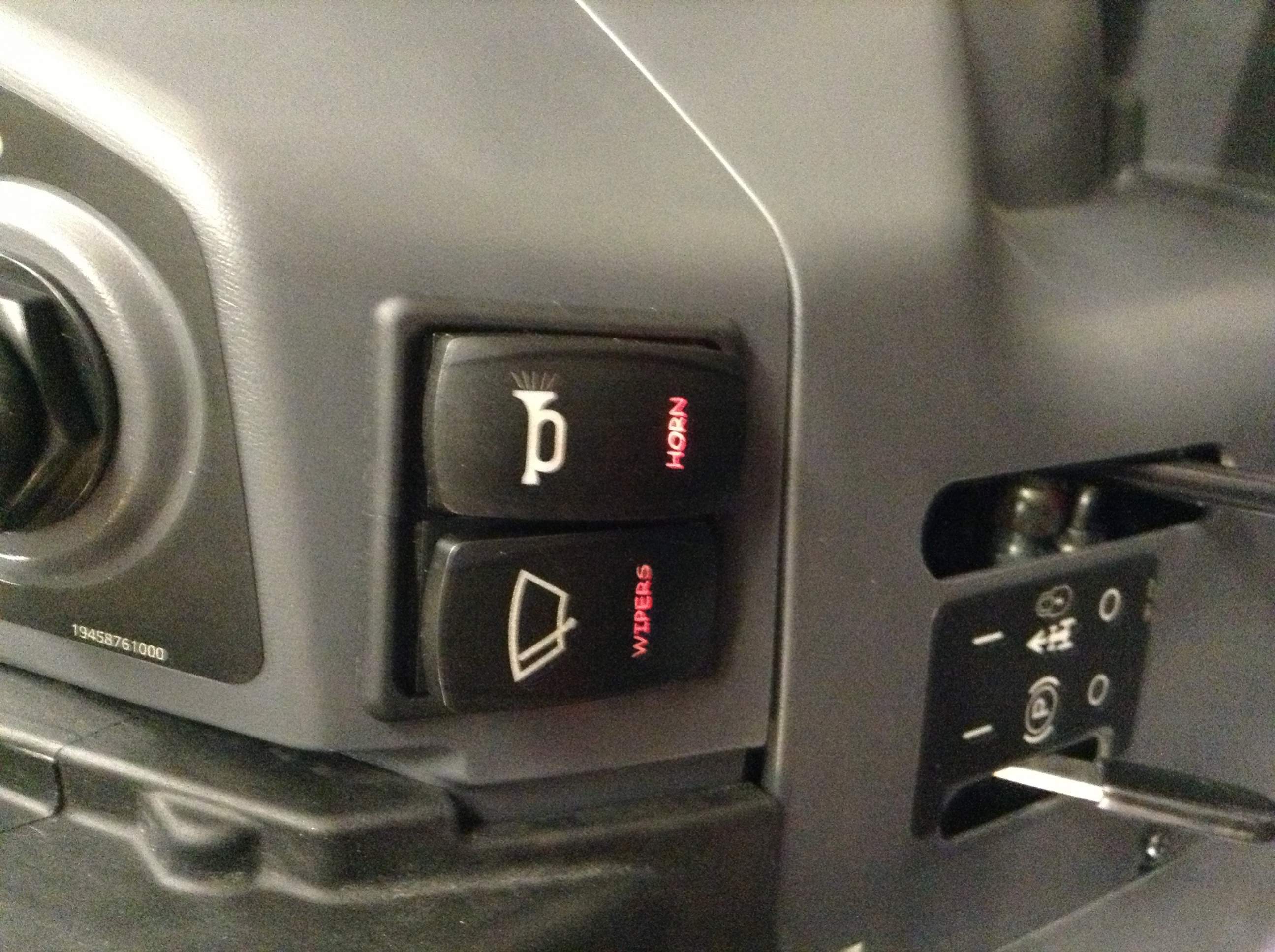

I added a horn... Air horn... I jumped first time I tried it. Ridiculously loud !! Not needed often but if I need it it's there. Wiper switch we'll call future use... For now.

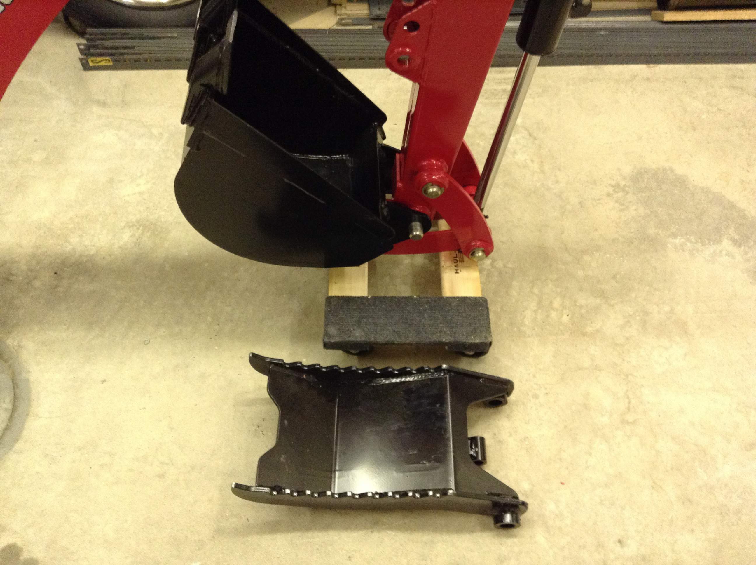

I have yet to install it, but here is a shot of the MB60 thumb for 12 and 16 inch buckets only... It's almost as big as my 12" bucket and heavy !! I appreciate Mahindra offering a bolt on thumb for this class of tractor and a great example of how they took it to the Max....

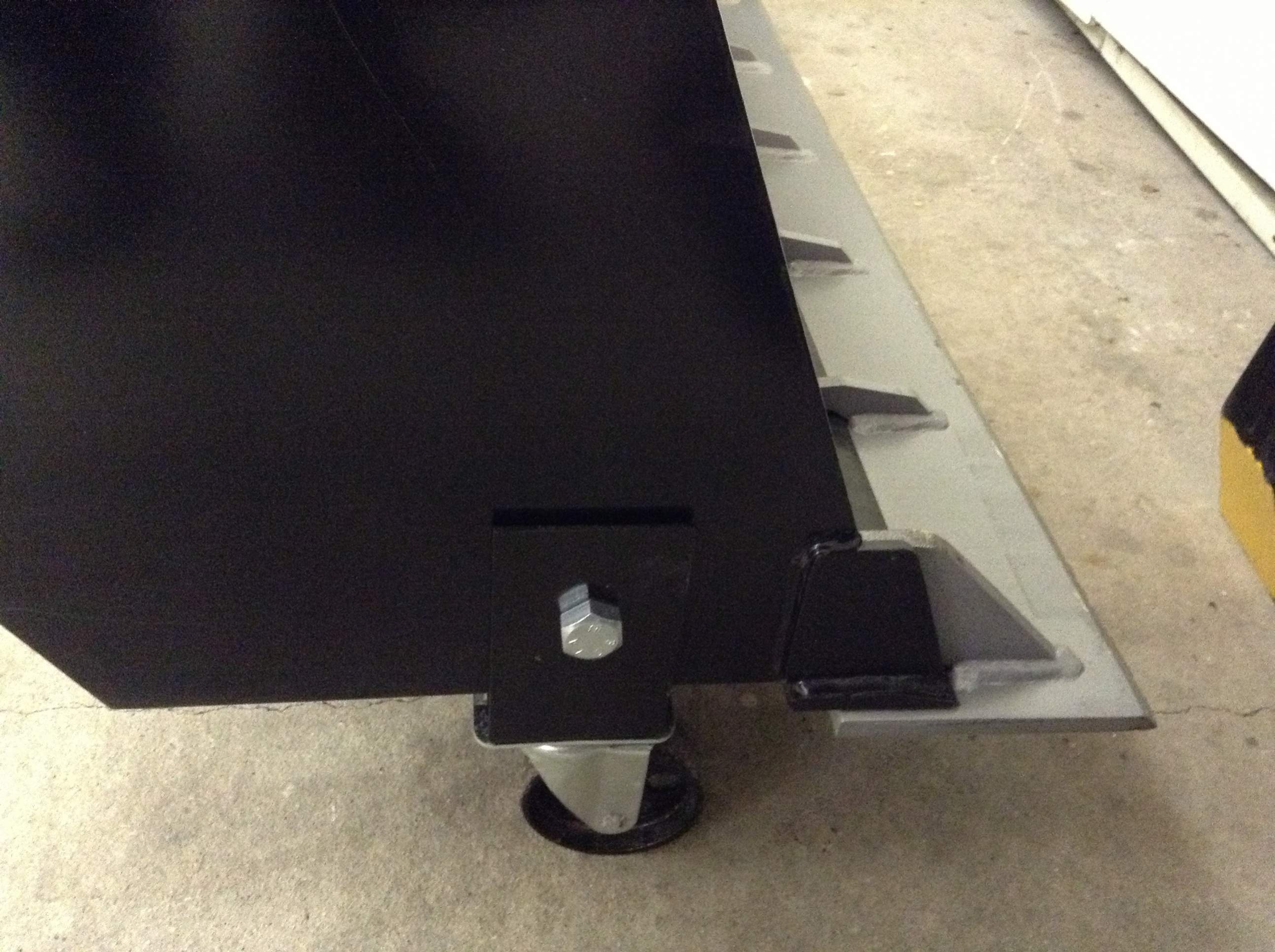

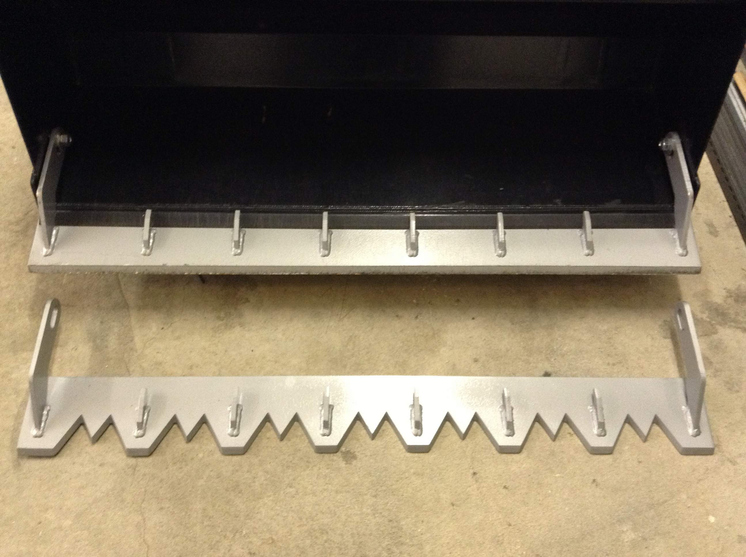

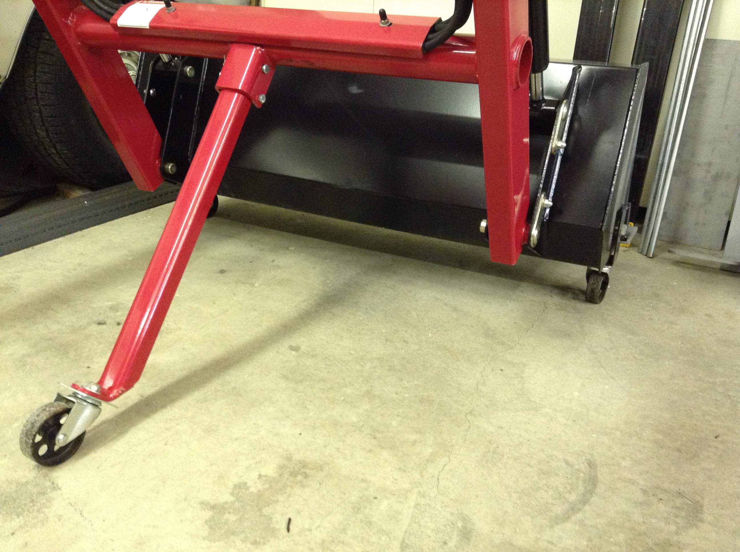

There is a great company called bXpanded that will build custom piranha bars for other tractors, give them your bucket size, 50" in my case and they deliver. What you may not know is they do straight cutting edges if you ask them, advantage being same company, same holes used in your bucket for mounting. Less than 5minutes to change around. I cannot say enough about the company and product !! I spent 6 hours back dragging my gravel driveway with the straight edge and barely wore of the paint !! I used their holes and bolts for castors to move my loader when off the tractor easily, very handy. One castor bolted right on to my stand for a 3rd wheel, and I disconnected the loader with castors in place only I rolled the loader away from the tractor instead of backing out from it.

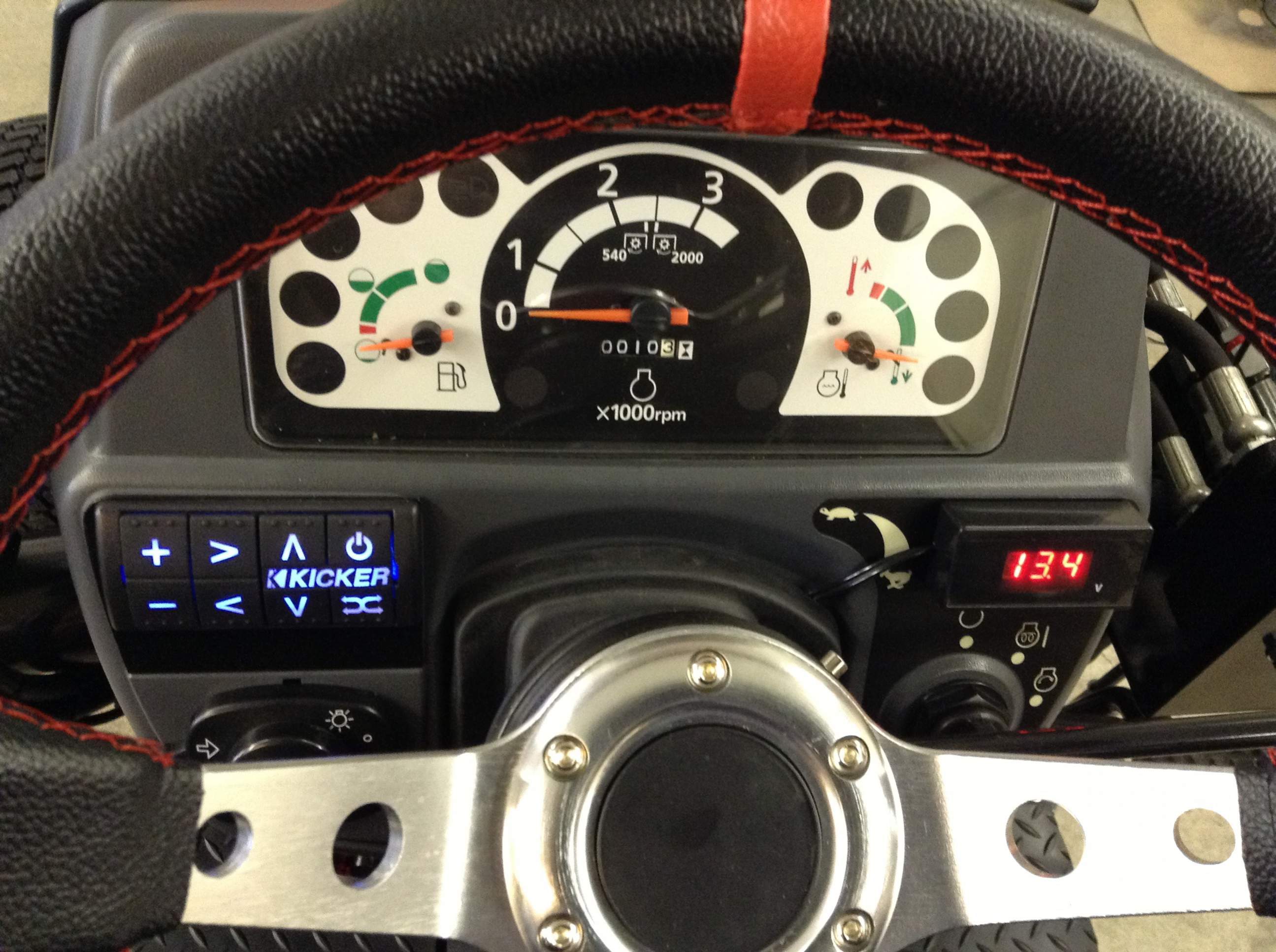

#24

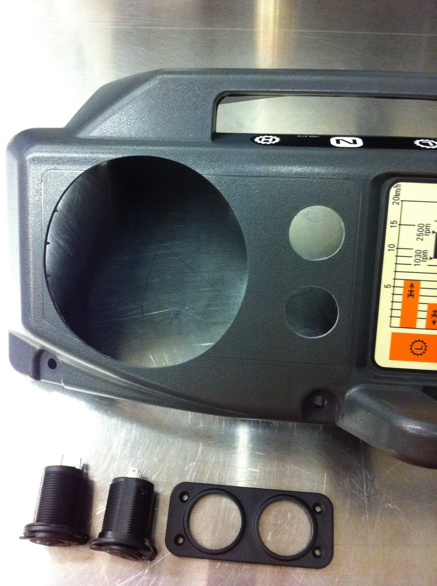

I bought this voltage indicator for my Victory Motorcycle and never ended up using it, works great on Max though...

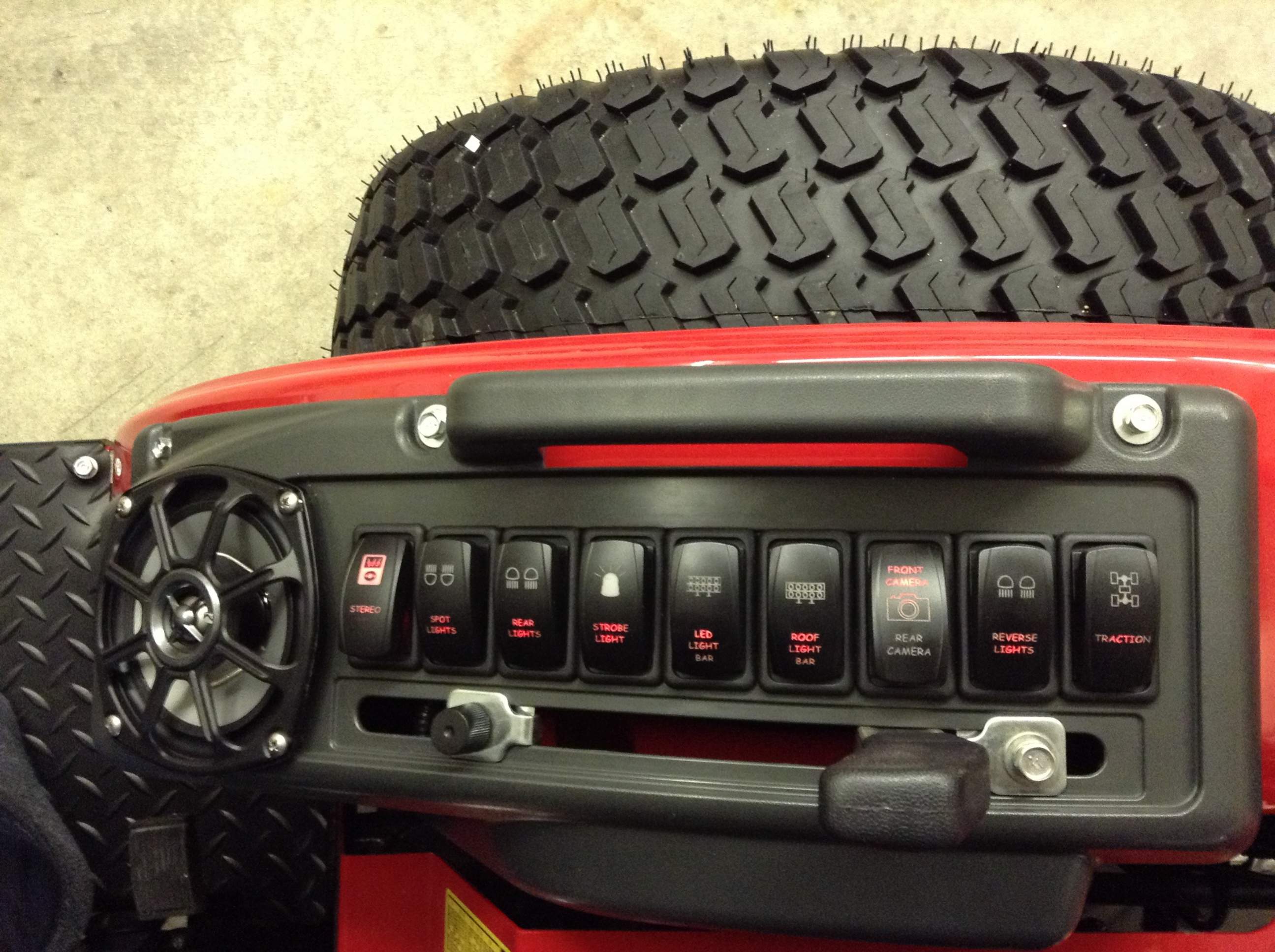

#25

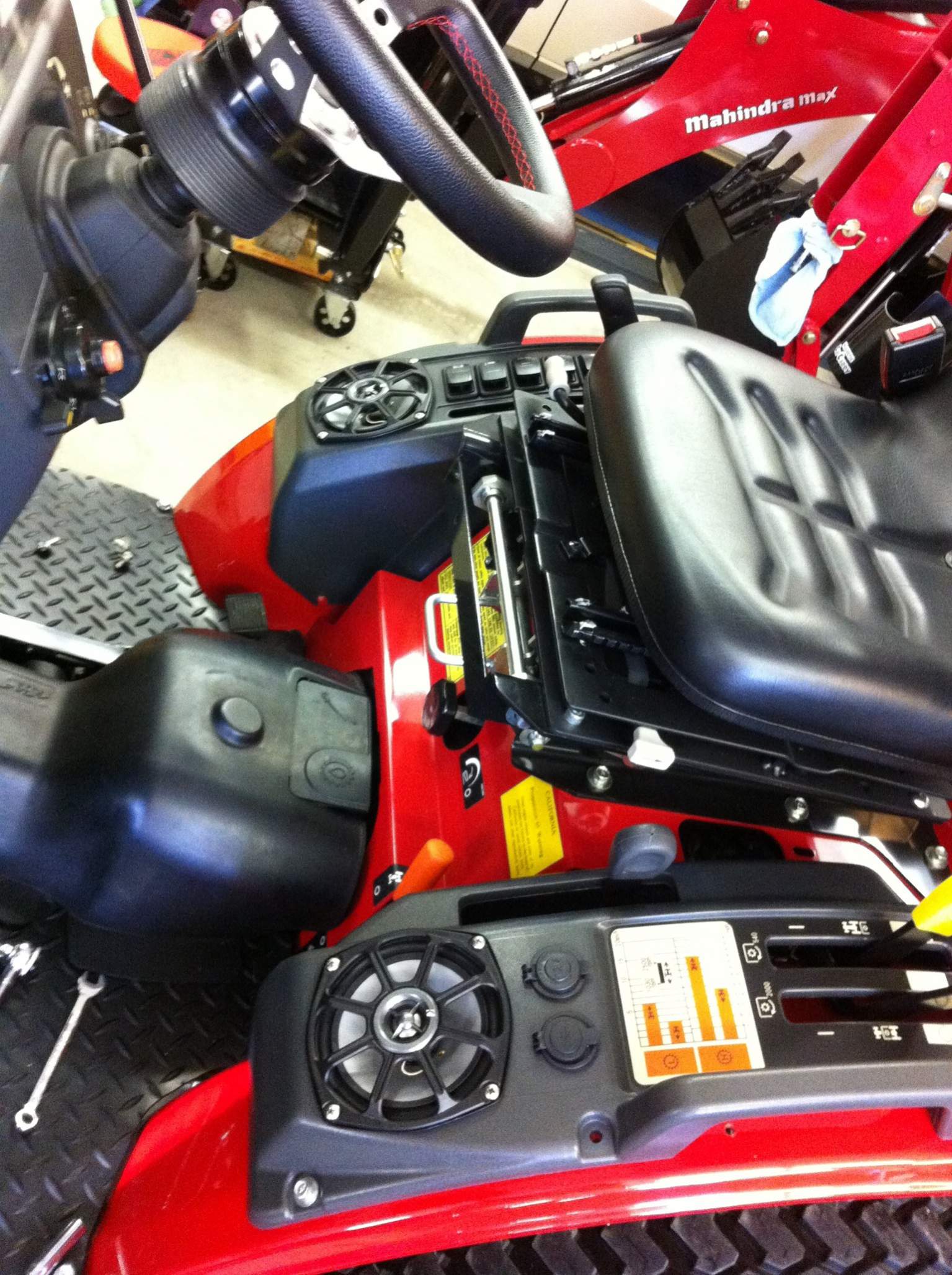

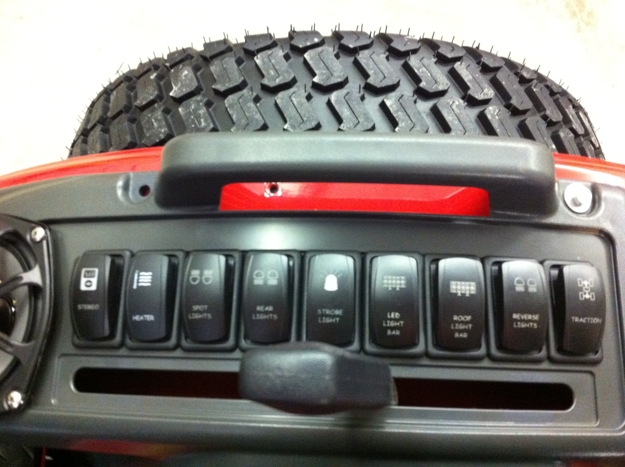

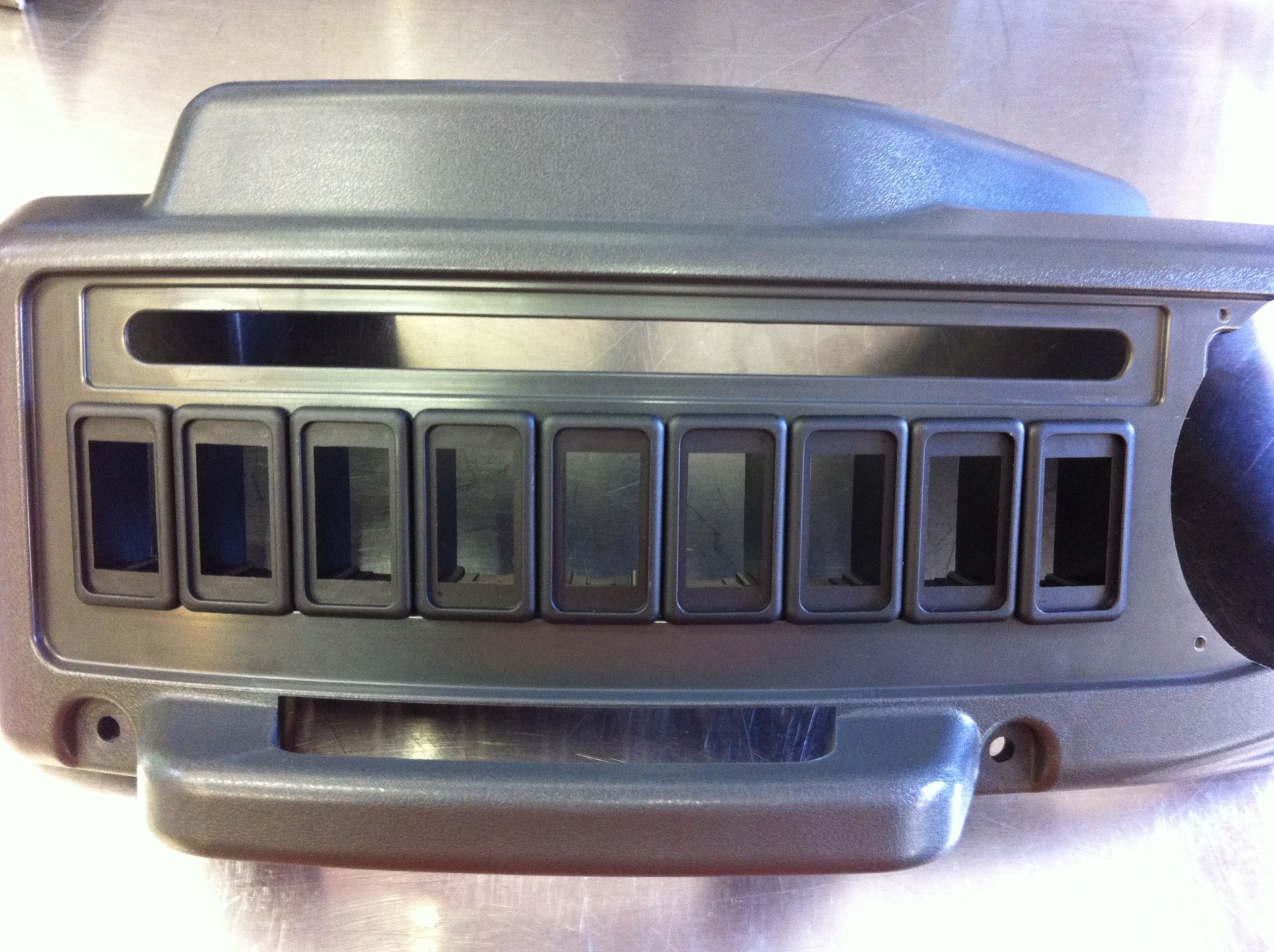

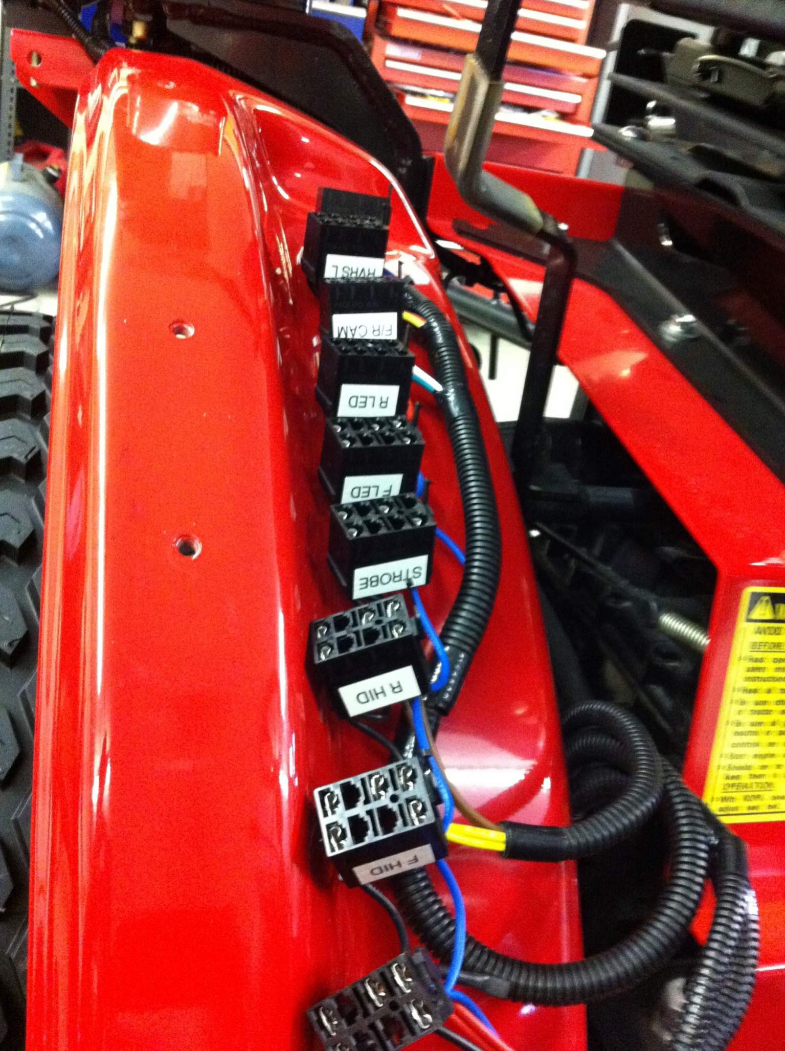

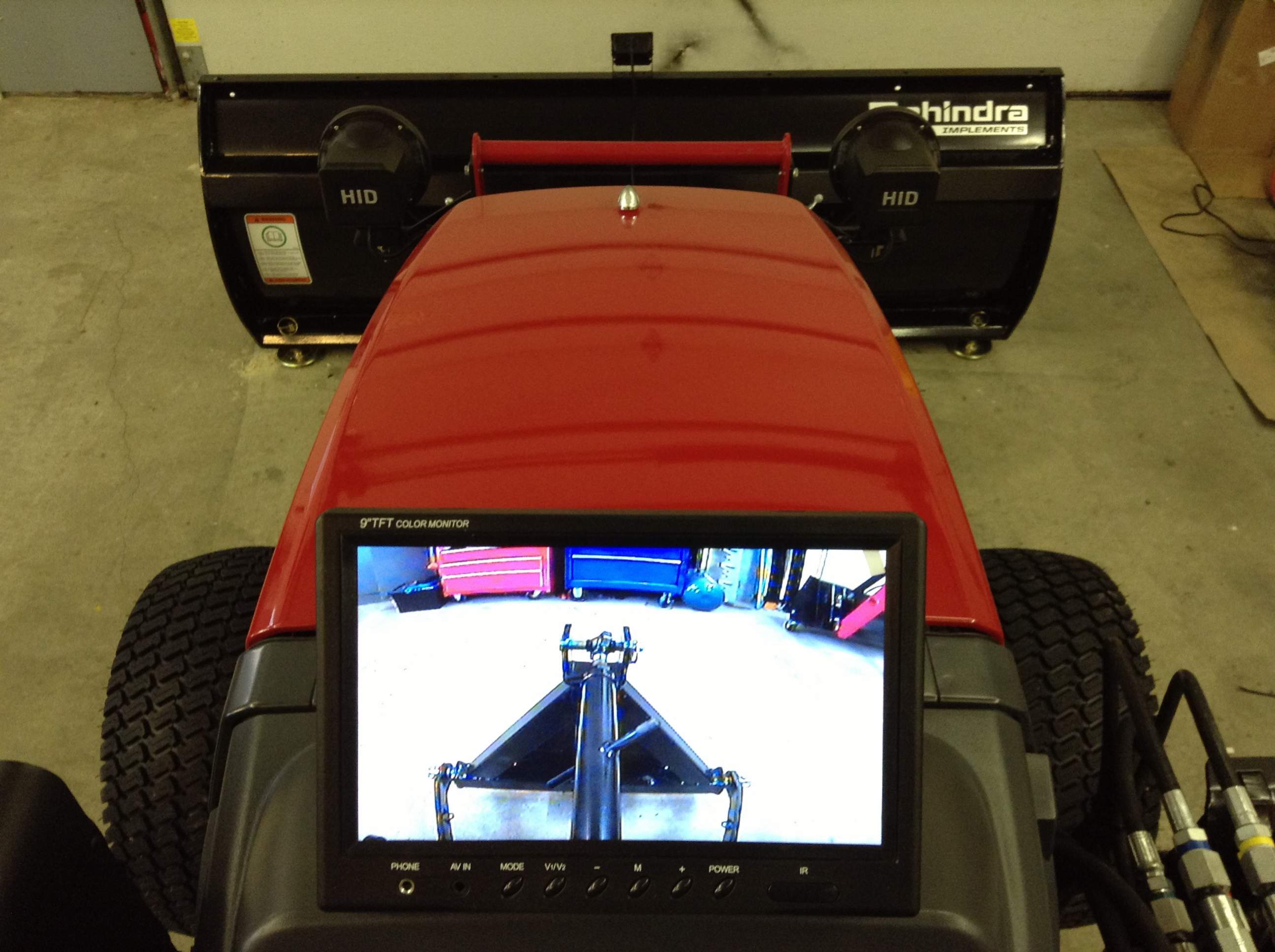

Here is my view with the rear camera... It is wired in with my reverse lights so when I back up it automatically switches to rear view from the normal front view mode. I also have a manual camera switch to over ride the automatic view in case I wanna watch what I am dragging behind me. Reverse light switch in manual mode acts as a low draw work light for behind the tractor, HID's only work when tractor is running, designed it that way to save the battery. This is my final switch layout in the control centre, has changed from other pics.
This is just the harness for all the switch plugs, every wire had to be crimped and fitted to the plugs, tedious job but allows panel to be removed for servicing.
/ Takin it to the MAX #26
Where do you source those switches from? They look real nice.

This is one awesome setup you have! I am drooling over the heater and backup camera setup. Where do you have the monitor mounted? My dad is 71 and not as able to twist around and look behind.

#31
Wow, that is a gold mine, thanks for the link! I have been hoarding some switches from an Isuzu chassis-cab commercial truck my dad bought in the 80's, but they all have a generic lightbulb symbol, and I am almost out of them.

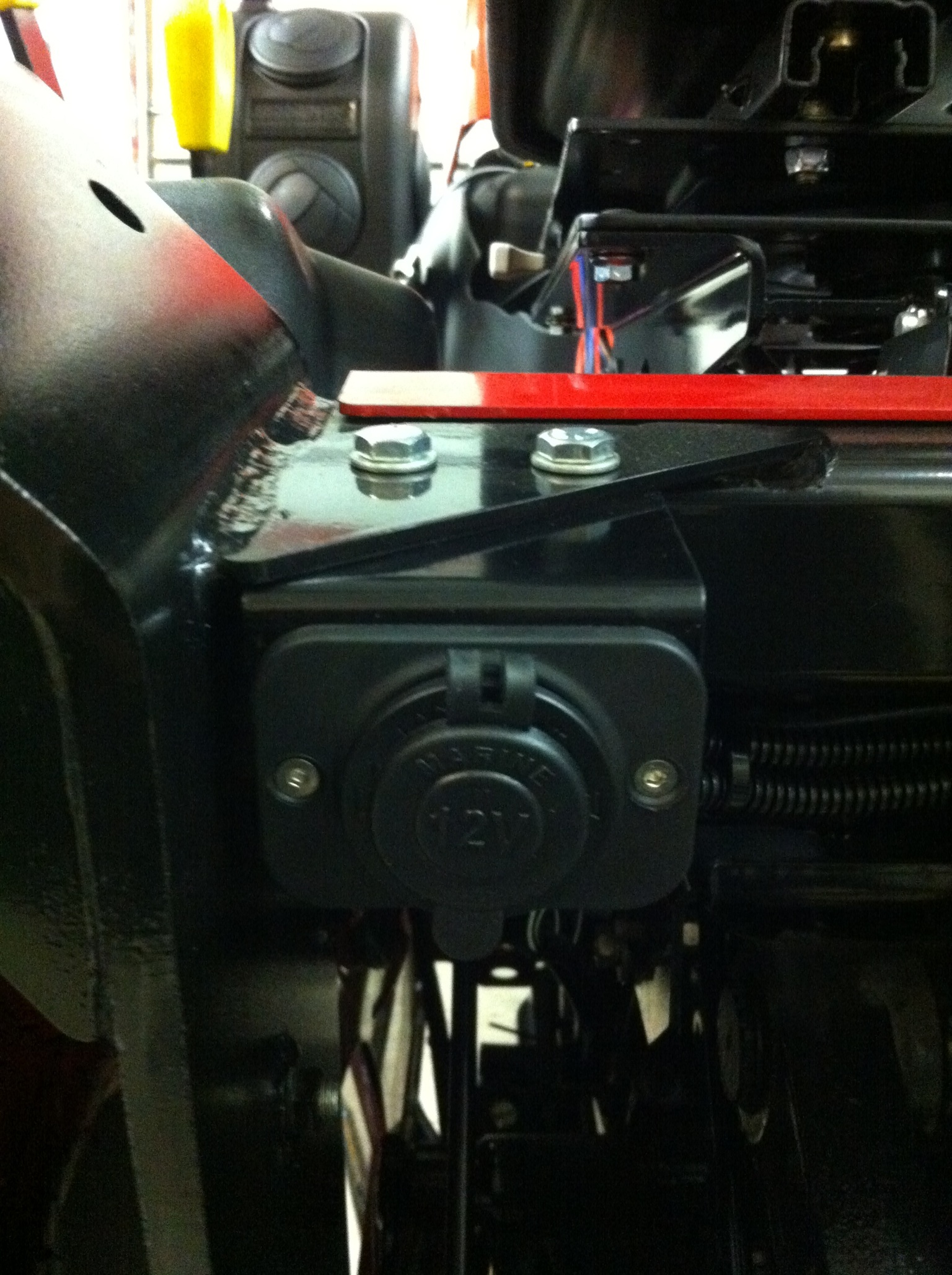

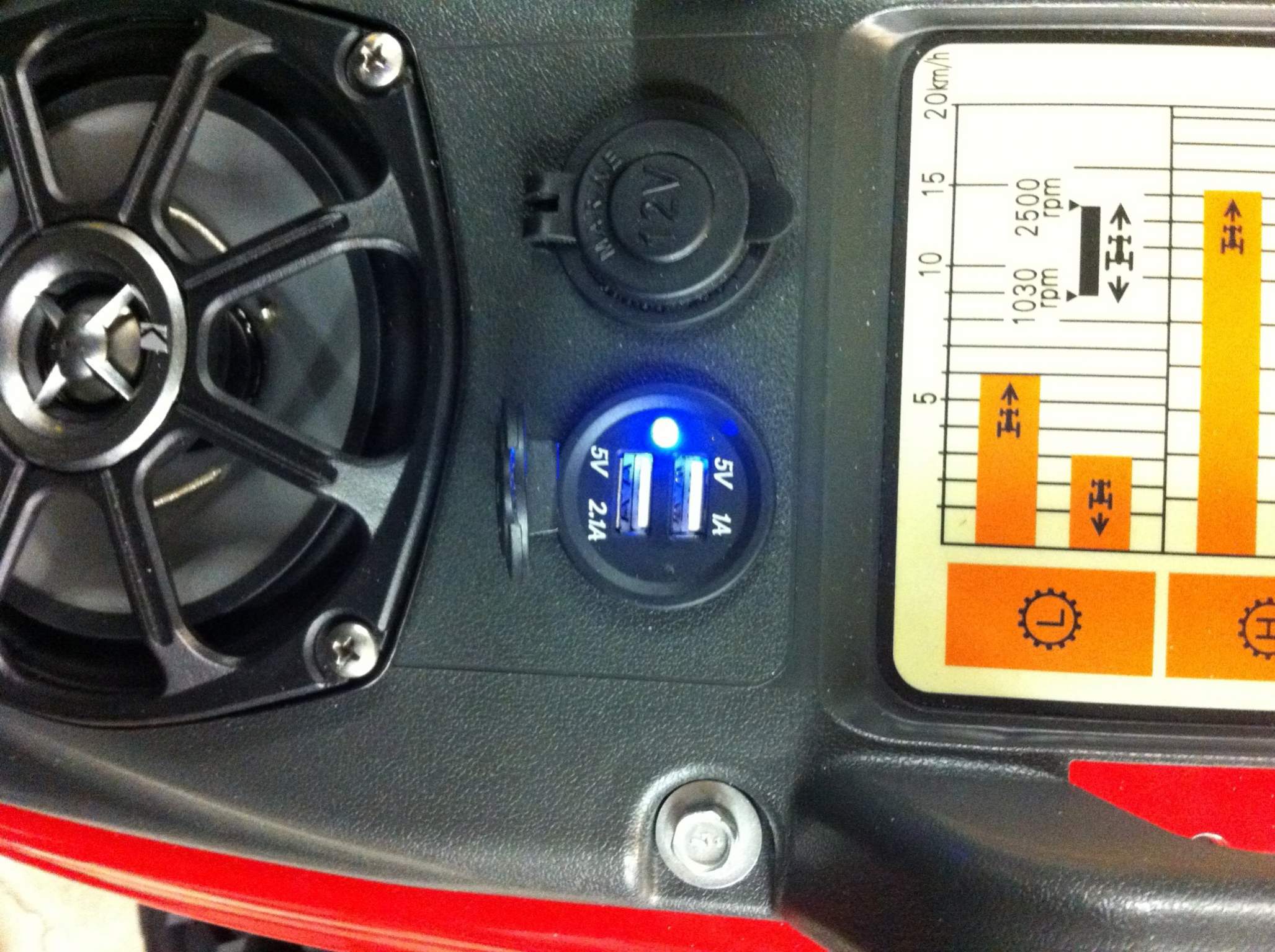

Your Welcome, if they don't have it I believe they will make it for you. A great source I found just be carefull, the cost adds up quick. I also sourced the USB and 12v chargers from them.

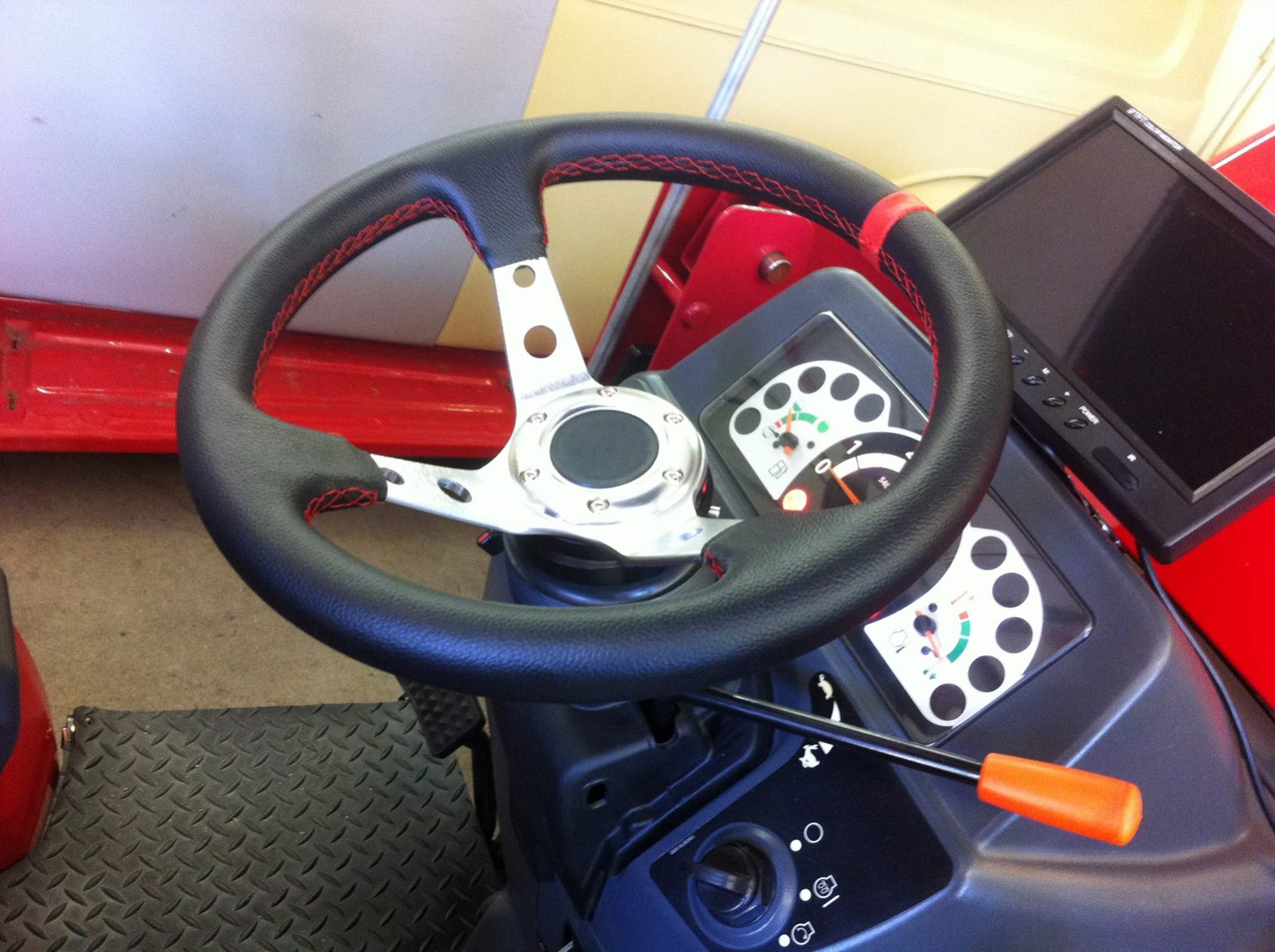

Monitor is mounted to the dash top, maybe you mean camera? Here is a pic of both. My neck is not so good either, big reason for front implements and rear camera for me. I only added a front camera to play with as it was made for both. If you do this make sure your rear camera is what they call mirrored, it keeps what you see on the monitor on the right or left the same as the right or left of your body as you sit facing forward on the tractor. It's important because a regular view camera will confuse his right and lefts. Hard to explain but turn around in your seat and you'll see your right side will change, a mirrored camera corrects that.

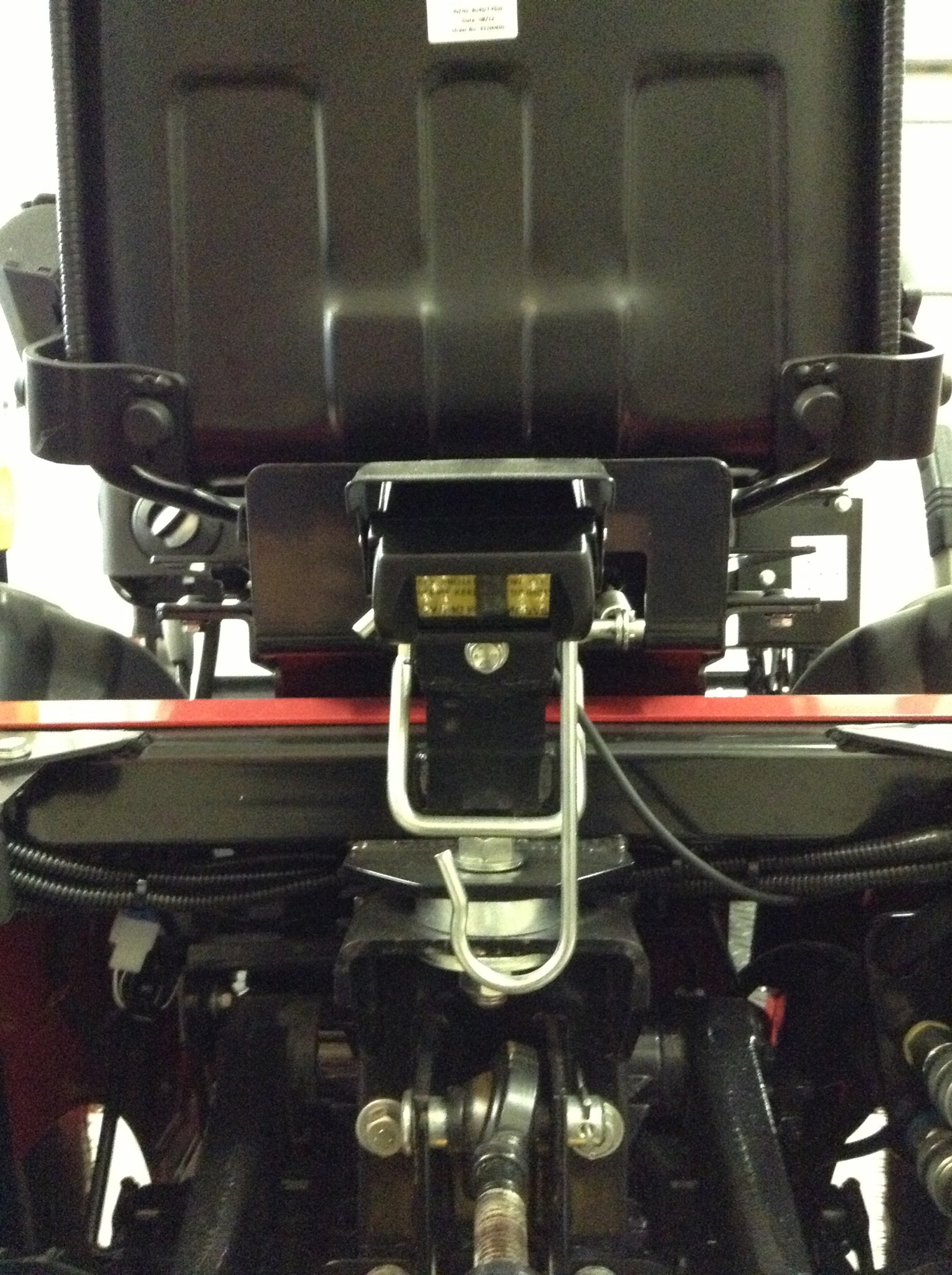

#33

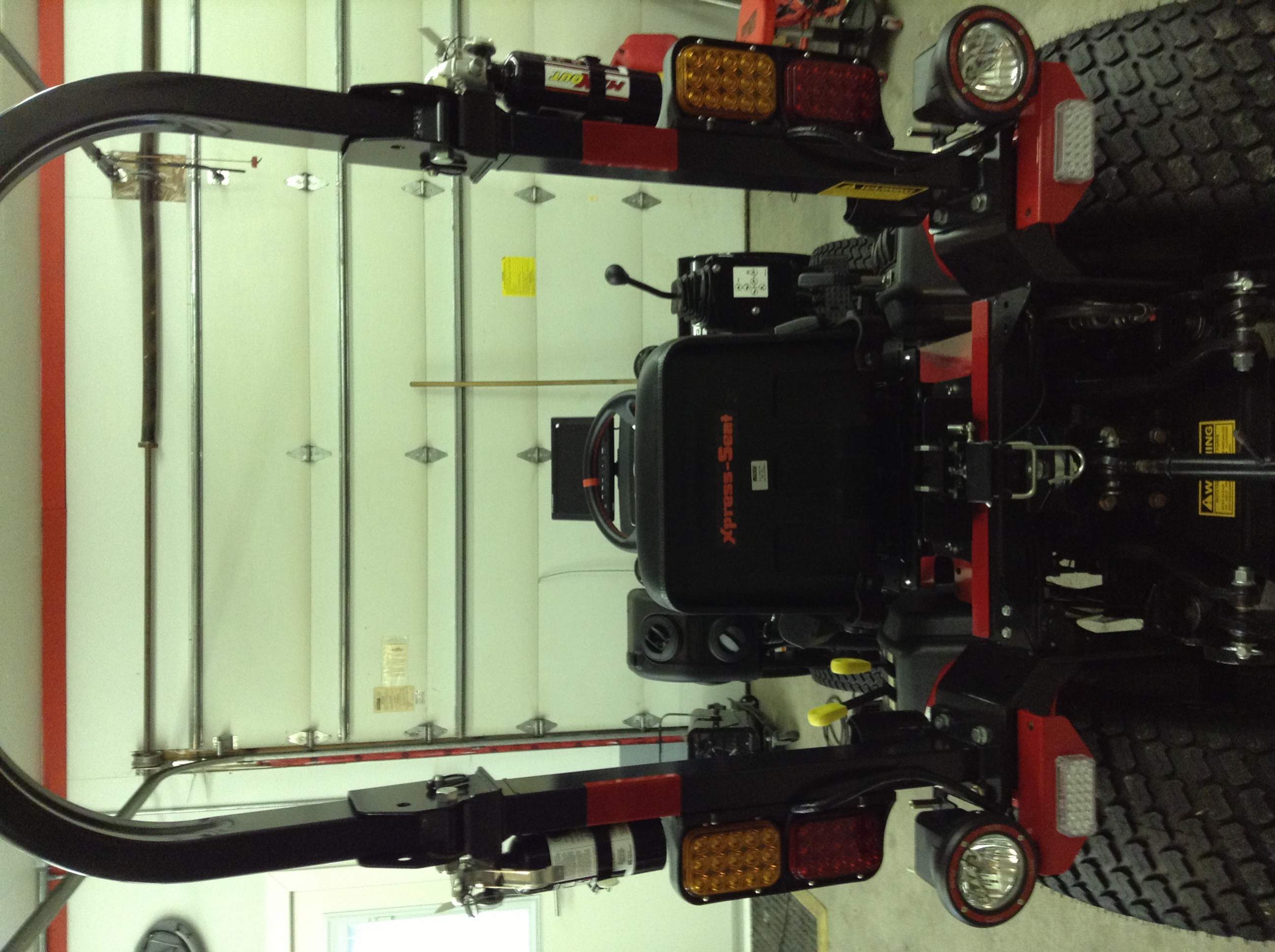

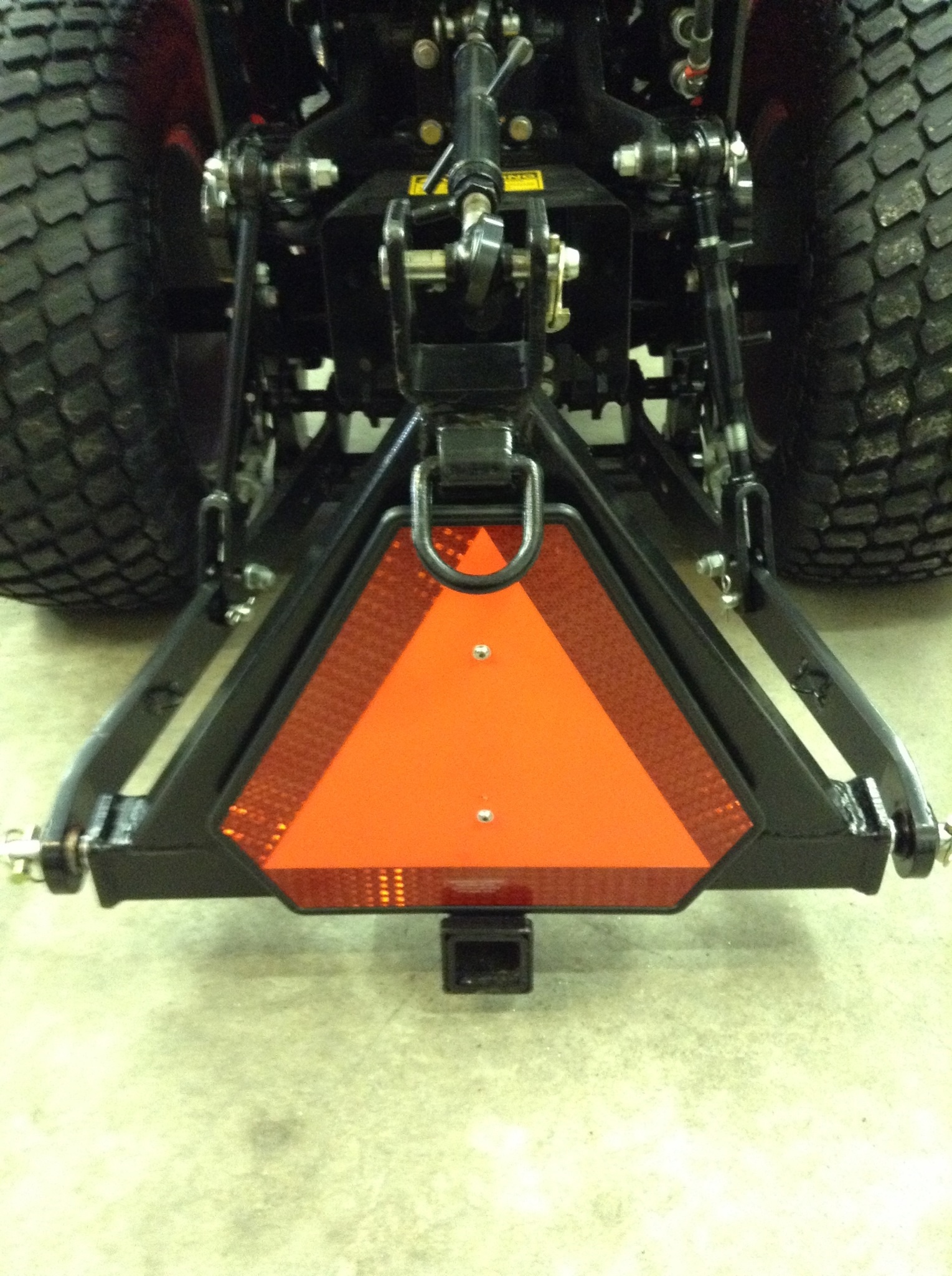

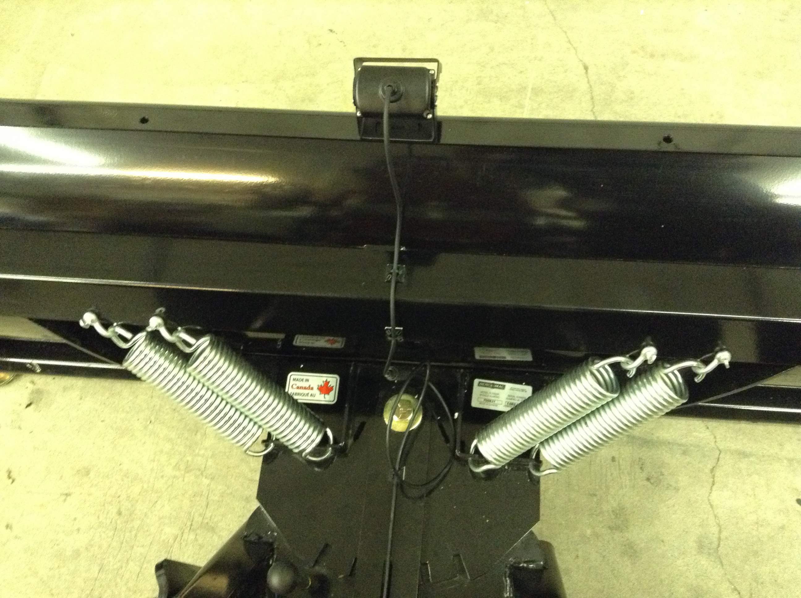

Another shot of the rear camera mount, I used my hazard sign mount for a no drilling solution. I still retain my hook for top 3 point arm. I relocated my sign(I have two, other stays with back hoe) to my receiver thingy.

This is exactly what I used, make sure to ask for a mirrored camera for the rear, seem to remember I did. You can spend more or less on other stuff, just don't fall for wireless cameras, they still need power wires ran to the camera so they are not truly wireless. Rear only kits are a lot cheaper, depending on monitor size. Oh... The camera cords given are long enough to do a motor home so be prepared to tie up some excess cable like I had to.
Reversing Kit 9" LCD Monitor 2 CCD IR Backup Cameras Horse Trailer Van Truck | eBay

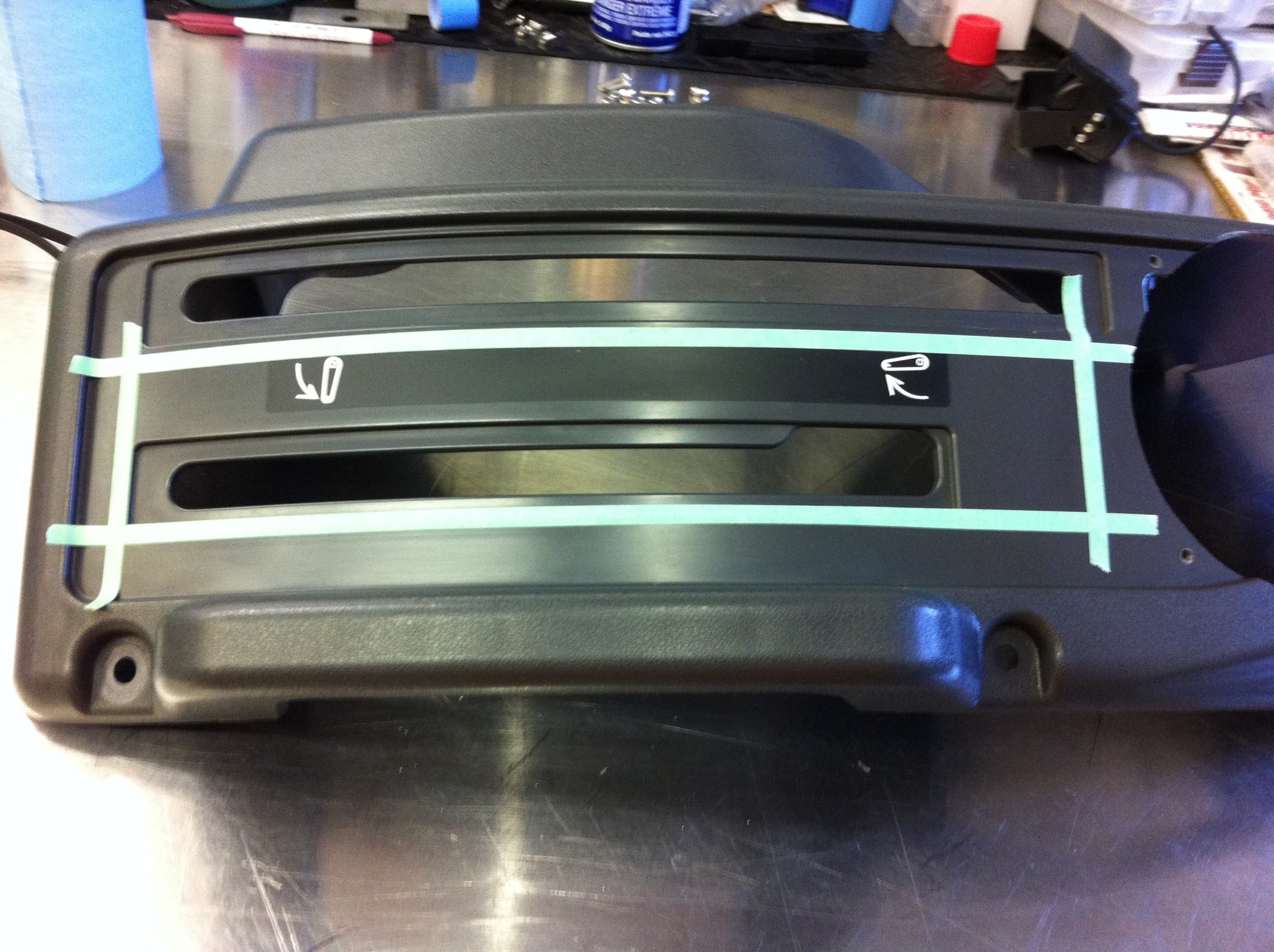

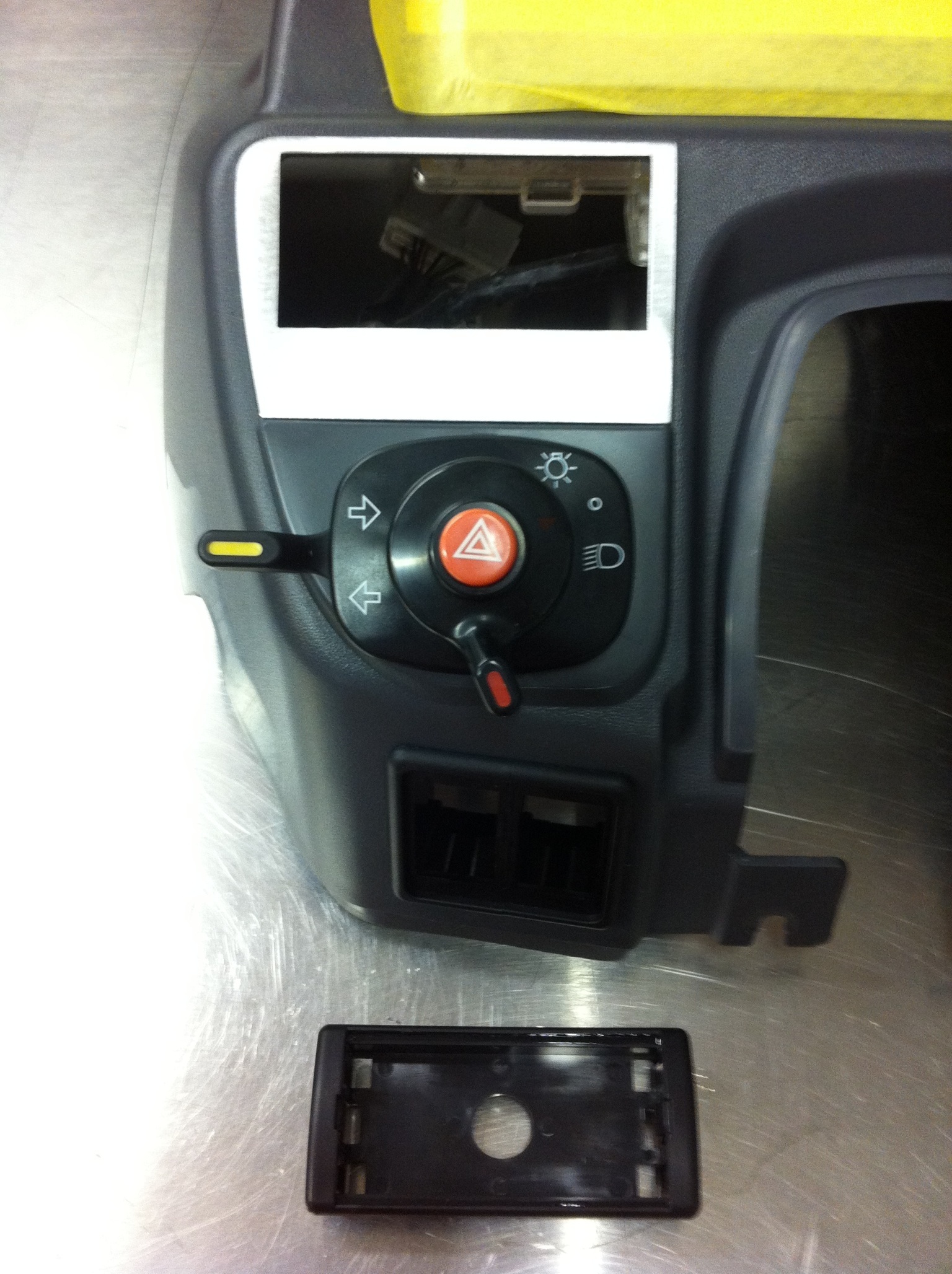

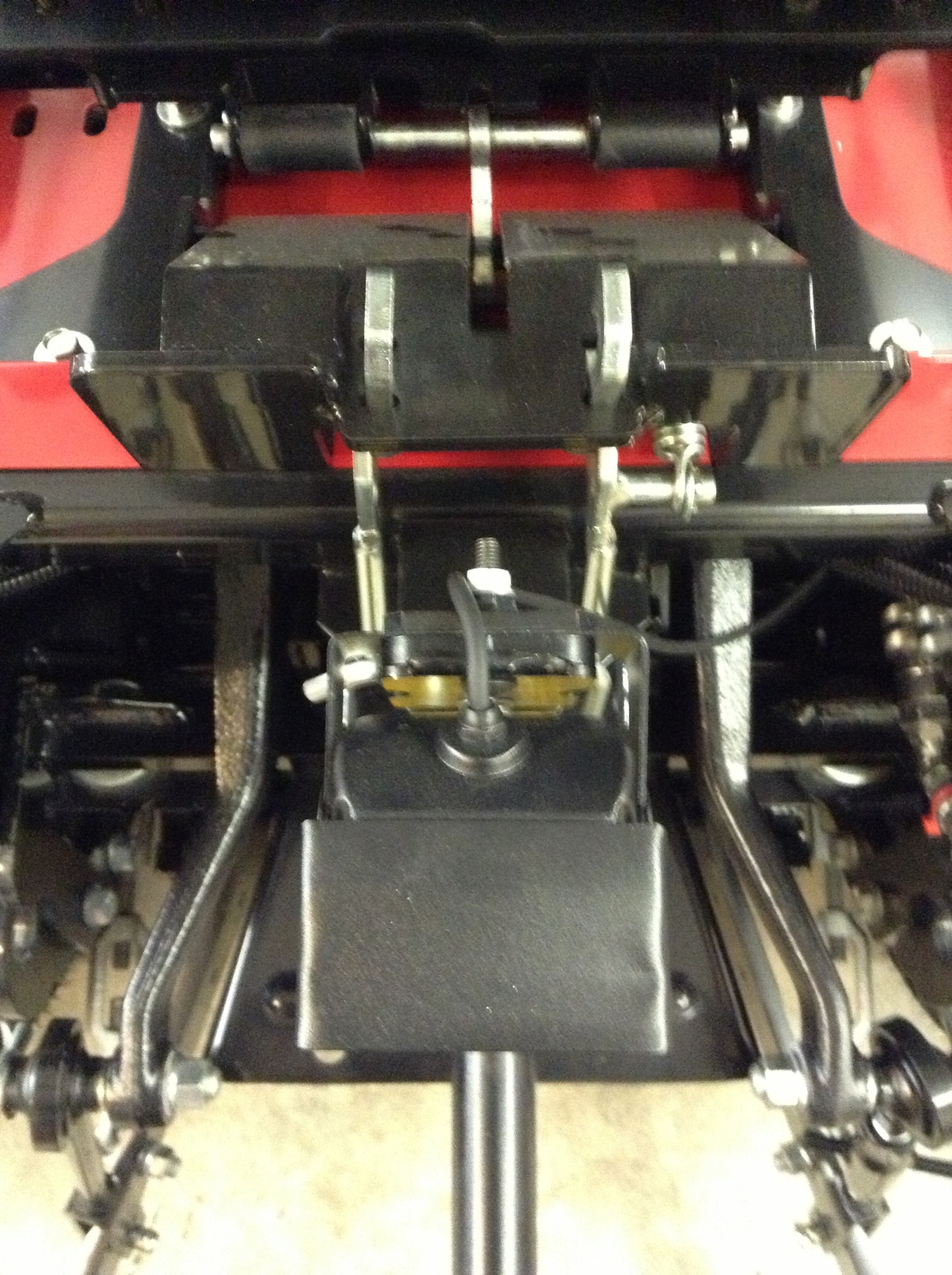

You sir are insane (but in a good way) Hah, and i thought I was doing something when I made a new, lowered seat pan on my 3016 so I wouldn't hit my head going in and out of the garage. That extra slot you made into the "World Domination Time Distortion Center", was for the Mahindra factory part install of the hydraulic top link control lever.
#37
Thank you for the compliment :laughing:. Wait till it's done, but insane works for now. I really appreciate you telling me what that slot was for, you should have been my dealer... Lol. Sounds like a nice option I will never use, thank goodness !! Covers can be replaced that I cut, knew that before I fired up the saw. Highly unlikely I will ever part with Max so I will continue with the madness, sickness, and disease that I usually invoke on my new toys. It's difficult for me to remember it's just a tractor... But it's gonna be a pretty cool one of a kind tractor, I can live with that. It's hard to explain but when I first saw Max, that instant recognition of possibility hit me, I knew I could mod this tractor. That was lacking in every other color of tractor I looked at, and why Max suits my personality...

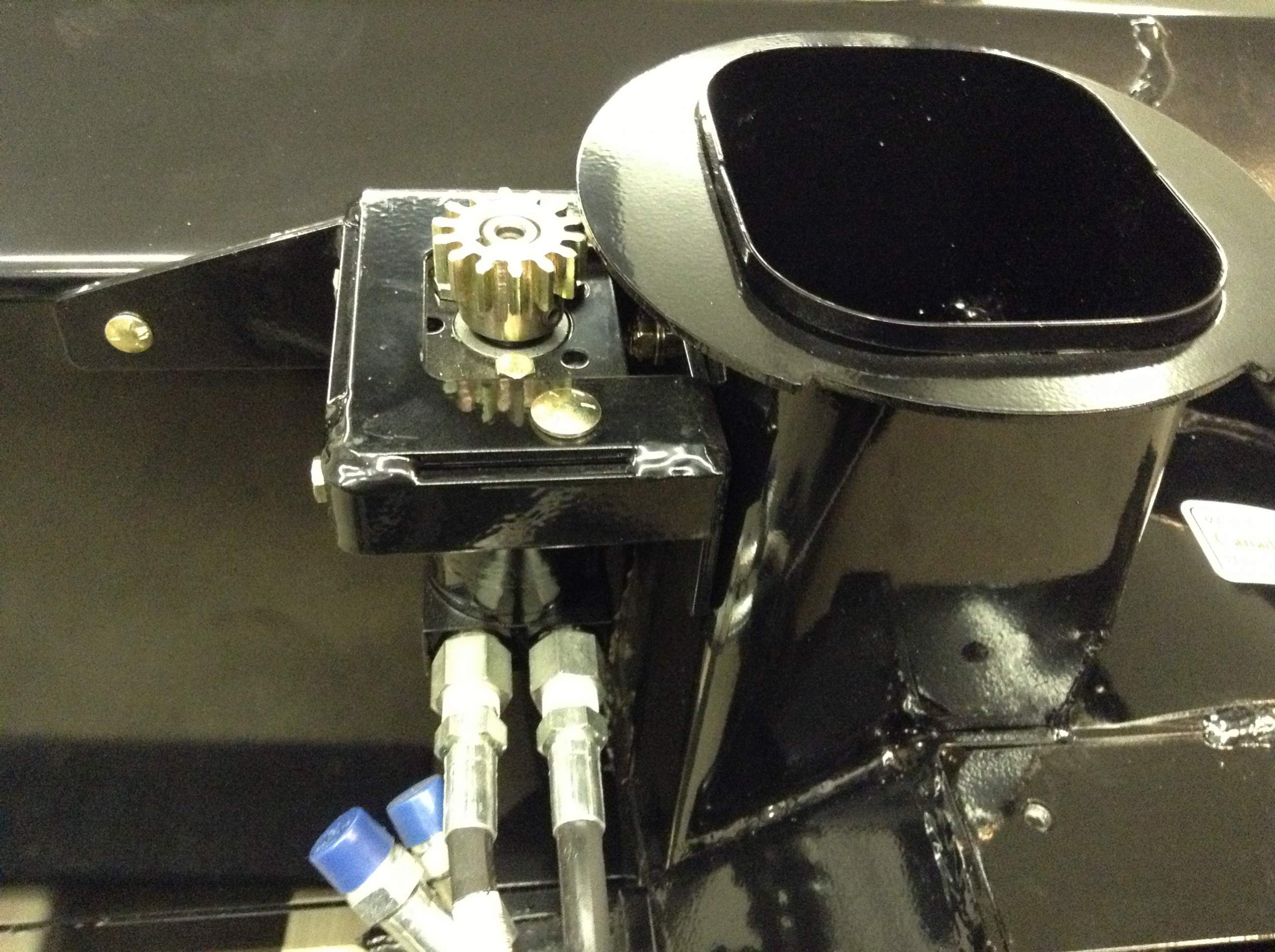

Hydraulic Shute control standard, electric, manual, or optional on other models...

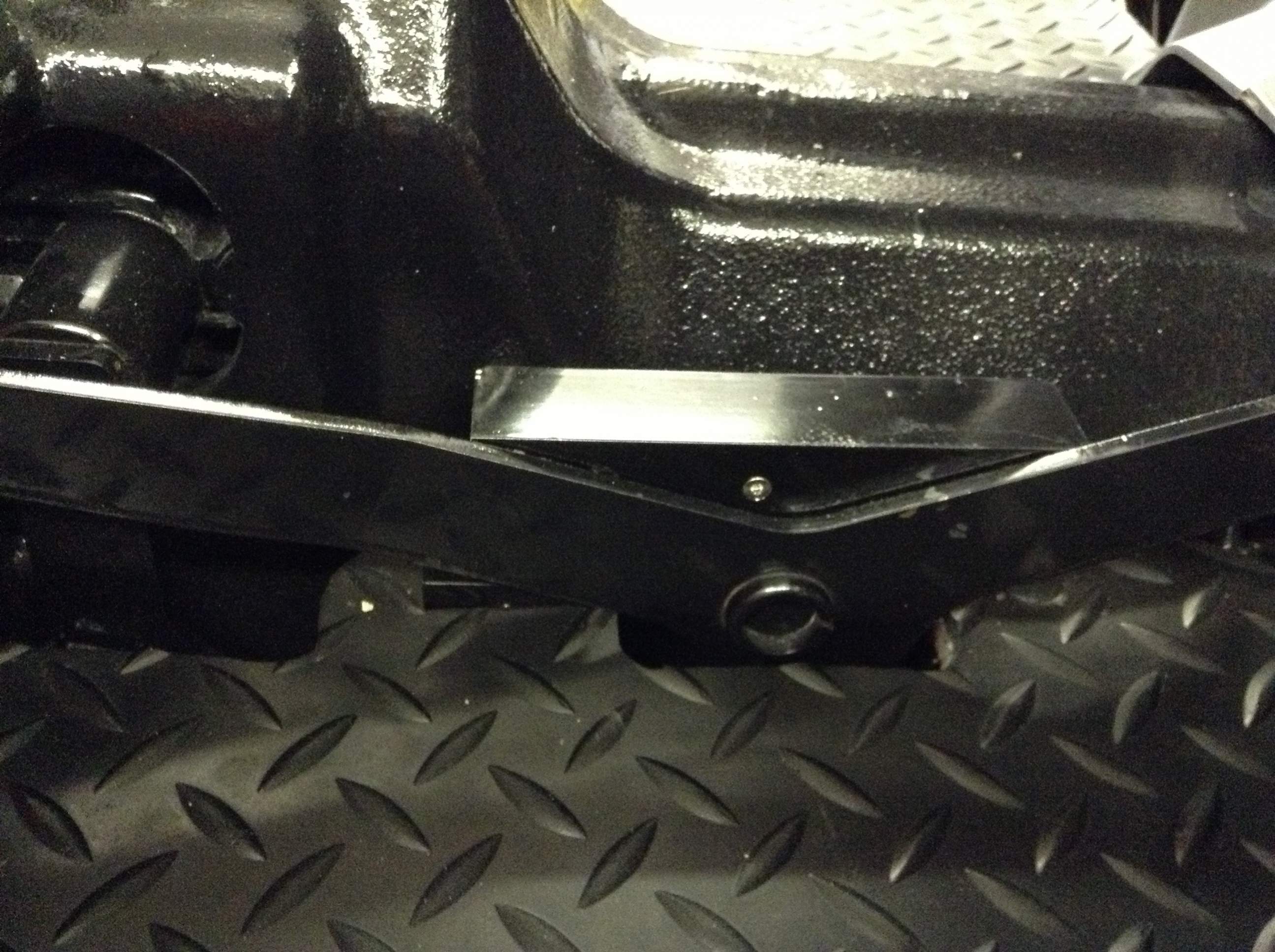

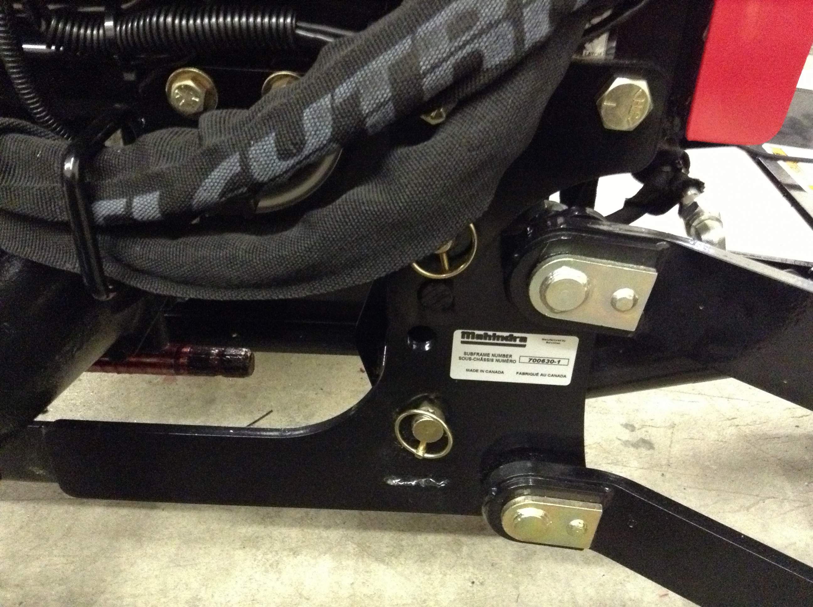

The subframe, yes it costs ground clearance but I am not just stressing my front frame rail like all others. It runs all the way to and ties in with the rear drawbar, and is built solid !! Besides I clear my path before I ever drive over it...
