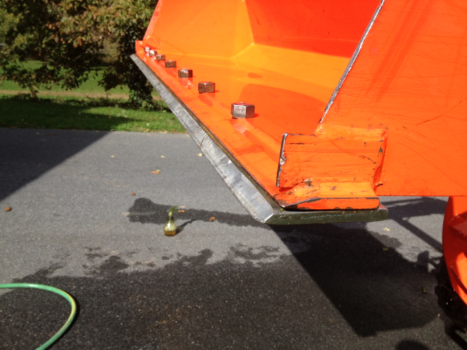

Let me suggest that you install a wear edge on the bucket. I used the loader on my last tractor for clearing snow the first winter without a wear edge and there was very noticeable wear on the bucket. Here's the one on my current tractor. Besides shaping the edge to an angled point, I also did a little grinding at the ends to round/soften the tips so they wouldn't be able to dig into the blacktop.

My old Yanmar would dig diddly until I installed a toothbar but my LS P7010 and Kubota B26 both dig very well without a tooth bar so I have not considered installing one. I do need to look at putting a wear edge on both of them for both wear and strengthening the bottom lip.

....................CHIM: What did you do to the bottom to recess the bolt holes.
This one has studs plug welded into the bar. I forget the size of the bar. It's a pretty beefy piece of stainless that I found in a pile. After welding the bottom of the bar was ground smooth. Nuts are on the inside of the bucket.
On my previous tractor the wear edge was tapped. Bolts were inserted from the inside of the bucket and cut off and ground smooth where they came out through the bottom.
Both methods worked well.
Thanks CHIM. I am thinking of making or buying one for my LS. The bucket is pretty weak on the bottom and a good thick wear plate would do much for strengthening it up a bit. Both ideas sound workable
