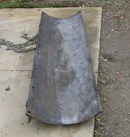

Yeah, I know. I was just makin' a funny. Looking forward to the pictures. You don't happen to have any without the primer, when all the rust was removed after brewing in the soup do you?
Glowplug here's a picture of the blade once taken out of the soup and hit with a pressure washer. Bare metal needs to be primed almost immediately or surface rust will start to form.
Sorry I didn't post sooner but free time around here lately is a real premium.

Hey,
I thought this post was about your haircut !!!
Looks good, You know every time I've used it was on really badly pit-ed stuff. It gets the rust but hard to describe it as looking new Sometimes holes show up in your project
Someone asked about paint removal, Ive always had good luck with it removing the paint but then the paint was in bad shape before it went in to the bath.
How are you going to apply paint ?

Nothing fancy John, brush on the primer, and follow with a coat or two of NH blue. Electrolysis will not remove base metal, so if the project had a hole that was plugged with rust then it will show up. Otherwise you will be good to go.

Are you gonna do any base metal prep (sanding, grinding, brushing, etc.) before applying the primer or is it pretty well prepped with the rust removed?
/ Take it all off
#46
Glowplug there's no rust now, and there's no grease or oil since it's been in the washing soda for better than a week. I already gave it a good hose down with the pressure washer so I should be good to go with the bare-metal primer.

Pine....Cool Man. That's a great experiment and looks like it works well. Did it affect the paint at all?
More pics please of the finished product when you can.
/ Take it all off
#50
Jim the process loosens the original paint so that it can be easily removed using a power washer. I'll be painting the blade today or tomorrow and will post some pictures as it goes back together.

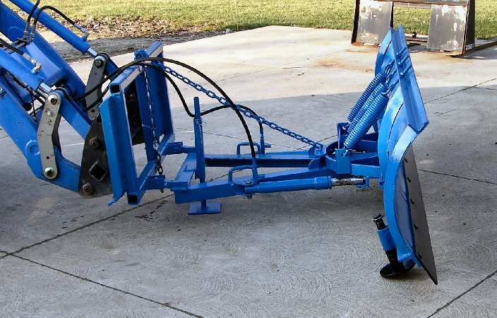

A few of you asked for finished pictures. It's now December and we have yet to have a good snow, so I was pushing my luck a bit by stretching this project out as long as I did. Here's a before and a couple of after shots of the old Meyers converted over to a NH plow.
Thanks for following along with this project guys.
PS I really like the electrolysis method of cleaning the rust from the steel. :D

Boy, that sure is BLUE!;)
Great ending to another great project. Well done.
/ Take it all off
#53
Thanks Kenny, we are happy with the way it turned out too. Not bad for a roller and a paintbrush huh? :eek:

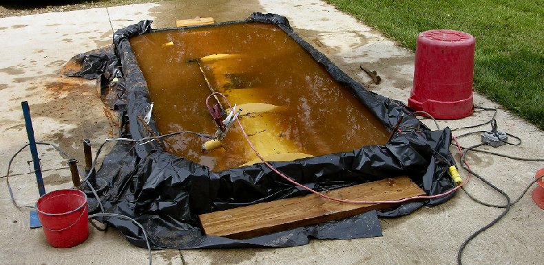

Hey guys: I FINALLY decided to give the ole electrolysis a try and see what it looks like when done. I hooked up my charger and put about a full cup of soap into a 5 gallon bucket with 2 hunks of rusty I beam, which is going to be the mounting plate MOUNTS for my trailer so I can mount my new 8K lb winch onto the trailer tung. these 2 - 12" x 6"x4"x1/4" I beams will be welded to the trailer rails and have already had bolt holes put into them to make quick on/off of the winch easy. that way the winch will stay in the barn clean/rust free. and all that
now my charger is a 2-10-50 amp unit, and has a 12hr timer too. I set it to the 50 amp just to see and talk about some bubbles :D I reset it back to the 2 amp as these parts arn't too rusty, just needed some surface cleaning. will pull them tomarrow afternoon & clean prime for paint/welding onto trailer.
