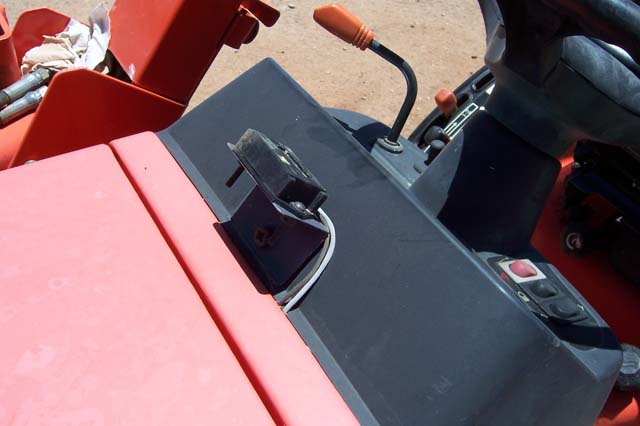

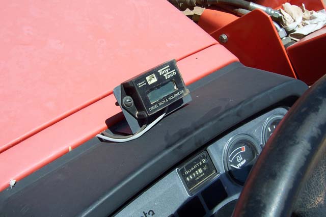

Here is how I did mine. Took about 30 minutes.
It's been out in the hot Arizona sun for three years and still works fine.

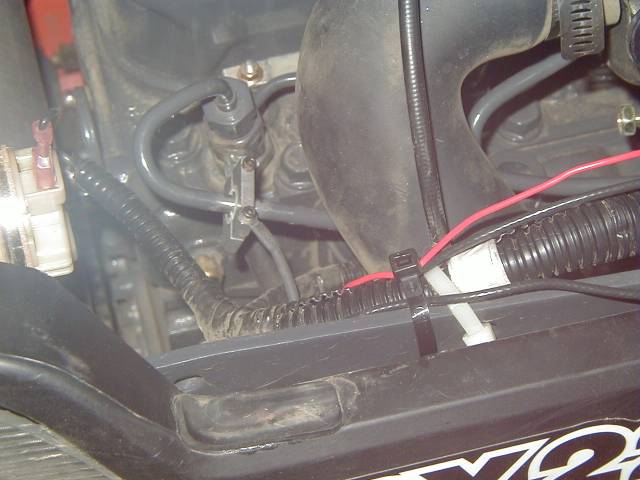

Here's a picture of the transducer installed on the line, doesn't matter which of the three you put it on, the instructions tell you to clean the paint off the area to be used. One wire hooks to transducer one to ground and one to battery.
