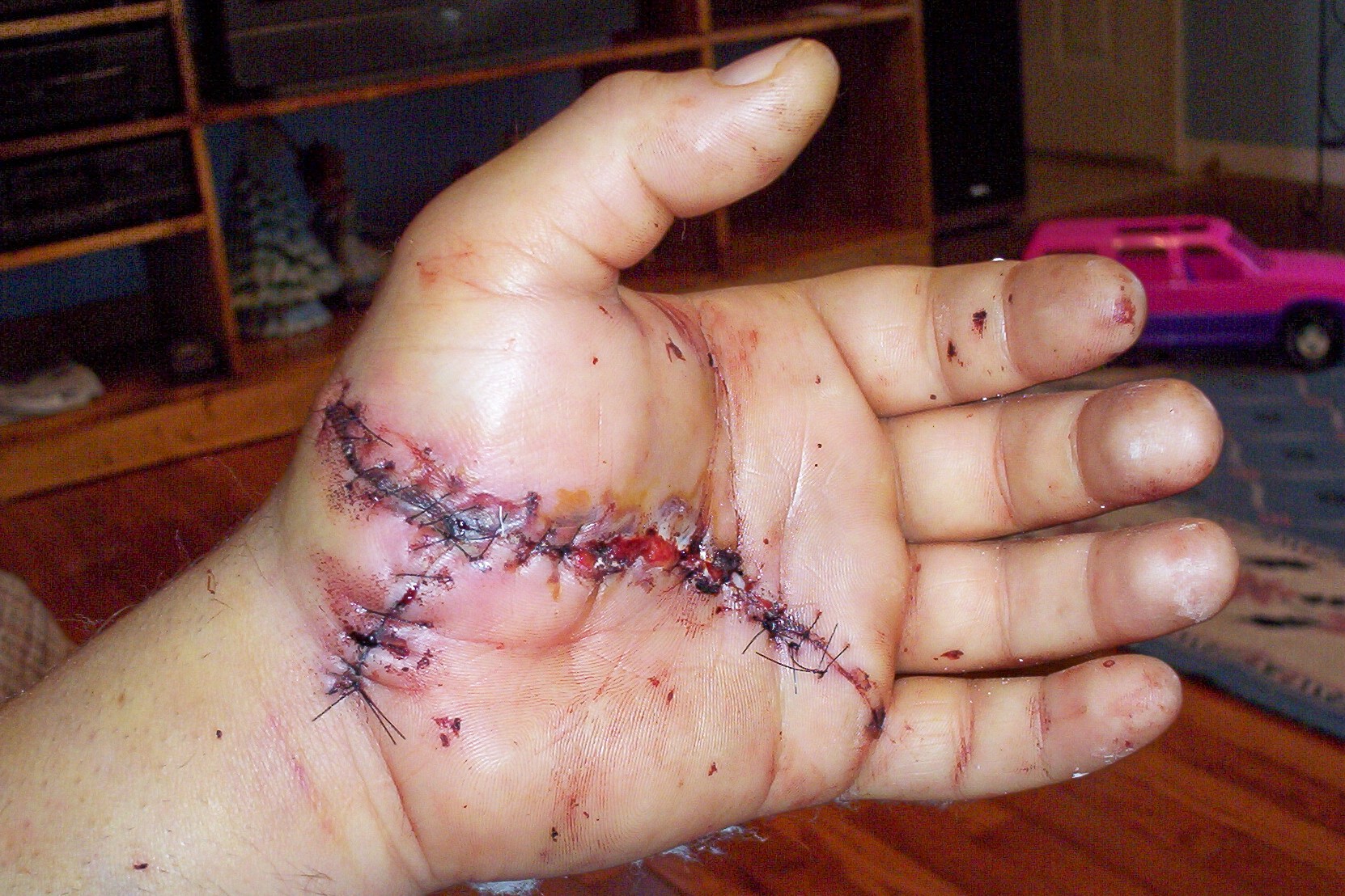

Thought I would post my table saw pic. My Orthopedic surgeon told me, after 3 surgeries, that of all his adult male hand injuries half are caused by a table saw and the other half by everything else on the planet. I am by no means a member of the safety police, but when I tell you it takes less than a second I am exaggerating, it was infinitely less than a second.
As bad and painful as that looks you are very lucky not to have lost any fingers or complete hand for that matter, :(
I've been operating saw's over 35 years and I always use a push stick when getting within 12-16" to the blade, I've seen the results from other folks who have lost their fingers,
I now have 2 saws given to me by people who stopped using them because of cutting off a fingers, they store them in their basement and hire me to do the work:thumbsup: and then tell me their story about how they lost their fingers and then show me the saw that "Done it to them" :cool: and offer to give me the saws, one saw is a older craftsman 8" radial arm saw, the other was a Makita 10" contractors table saw, I use both of these saws daily although the blood stains remind me of how quickly an accident can happen, so far "knock on wood" the only injury I have sustained is the loss of good hearing due to not wearing ear plugs throughout all these years,:ashamed:
