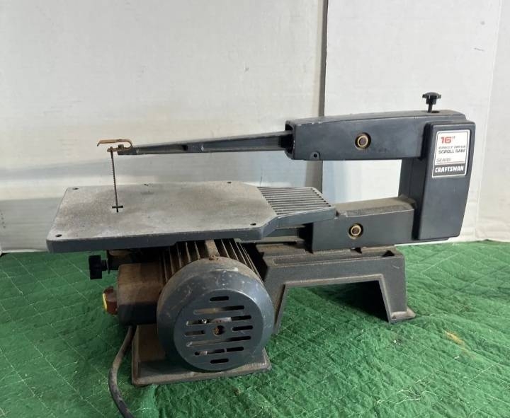

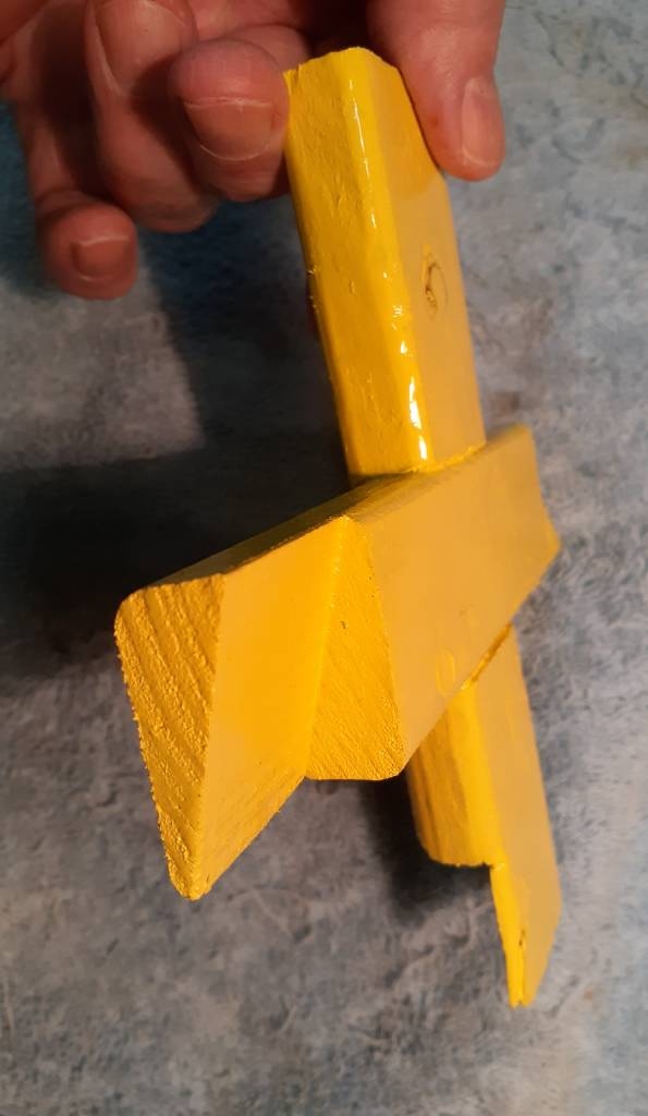

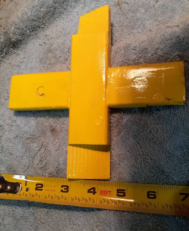

Sometimes I need to angle cut strips of wood like this pictured. Two 6"×1.5"×3/4". Center I cut with a table saw, blade lowered to 1/2 thickness so they lock together (that's easy because I move rip fence a little each pass.
The problem is the ends, I mark diagonal then scroll saw cut with blade at this angle 1.5" in, then cut half away. The scroll saw table tilts but not enough so it's "freehand", wood tilted...it works but I need it more precise. Wood I cut different dimensions so angle will be different. What I need is like a scroll saw rip fence with adjustable angle and a stop. That way it cuts evenly and stops at whatever I set it (1" to 3").
Any woodworker know of something like that? It would be clamped to scroll saw table.

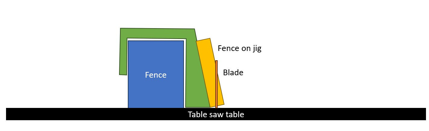

This would be an excellent application for a type of tenoning jig that rides on your TS fence. Add a toggle clamp or 2 to hold the piece. If you are not familiar with the type, I can dig up some photos, I'm sure.
Heck, here ya go. This one the fence is set at your angle and the blade is straight. You could flip that around and keep the jig straight and angle the blade too. Set the piece on the green angle face up against the fence at the back and mount a toggle clamp or two onto the fence to secure the workpiece. Add handles or whatnot on top to keep your hands away. Just make sure not to cut through any hardware or that could get ugly...

It's hard to explain, photo is better, but drawing 1) I mark diagonal, 2) I cut along diagonal about an inch in, then cut out/discard half of it
4) table saw works fine for center, cutting both pieces together moving fence until the two lock together tightly at exact center.
Cutting end a table saw is too rough for small wood pieces. Scroll saw cuts smoother but without fence hard to keep exact angle. I'd have to cut an awful lot of wood at different angles to make the right angle fence.
This would be my solution as well, but on the bandsaw. Put a stop on the backside and you get consistent cuts to the same depth every time.

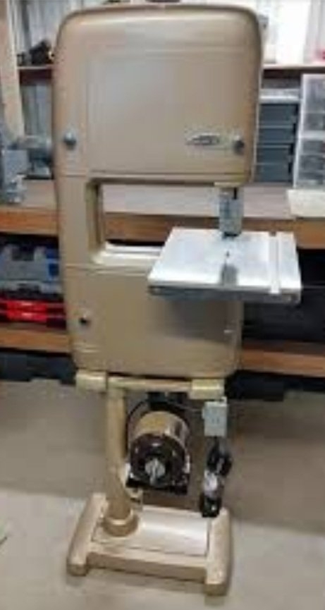

Not a bad idea except the green part that gives the angle would have to be adjustable because wood pieces I cut are different dimensions. My bandsaw (guessing) probably from table to blade guide is 1.5"-2" max. It's similar to this 60s Craftsman. Table doesn't tilt & no groove.
Scroll saw is best. I'll fabricate something.
